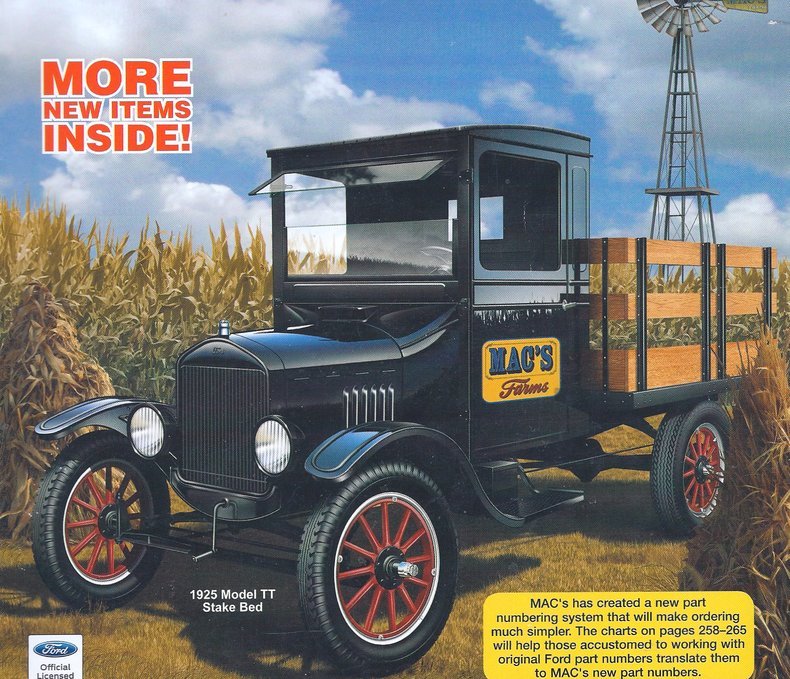

Clarifying - Only one U-bolt per side to hold down the bed. Additionally.... The original 'steel stakes' with sideboards for the flat-bed are almost impossible to find. If that is your desire, we can provide pictures and dimensions if you were to have them made. I've also found a source for new bed strips, which top off the top boards. Mac's had a '25 pictured on one of their catalogs, below.
