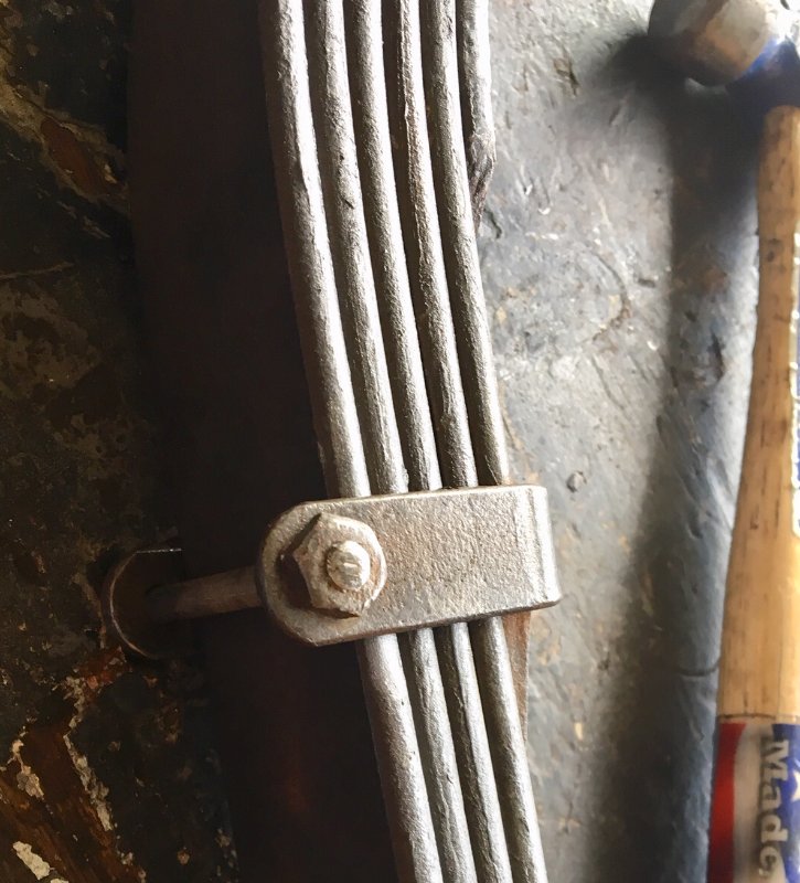

Yesterday I made a big push to get the rear springs done. Cleaning them up on the wire wheel was nasty work and left me covered in dust...looking like a coal miner. I don't mind getting that filthy occasionally, but I figured I'd limit it to just one day this weekend.
Here's how it went:
I finished cleaning all the leaves late last night then I painted them with graphite paint. I've never messed with that stuff before. It's pretty neat. I might paint the underside of my mower deck with it. If anyone in the Houston area needs some, let me know. I'll never use the gallon that I have.
They were dry this morning. I installed new bolts in the clamps. The old weathered nuts from the original set were in good shape and cleaned up nicely so they got re-used. My practice with this car is, if it's sound, safe and re-usable, it gets re-used...even something as small as a nut.
Then I installed the main bolt that holds the whole set together. I didn't have the strength to clamp down the whole set enough to get the main bolt started so I used another long bolt to press them together, then clamped them, then removed the long bolt and installed to correct bolt that I got from Langs.
I then cut off the excess bolt material and peened the clamp bolts and the main bolt. It'll now get a coat of flat black. I need to install new bushings and new grease cups and then it'll be ready for installation.
Here's how it went:

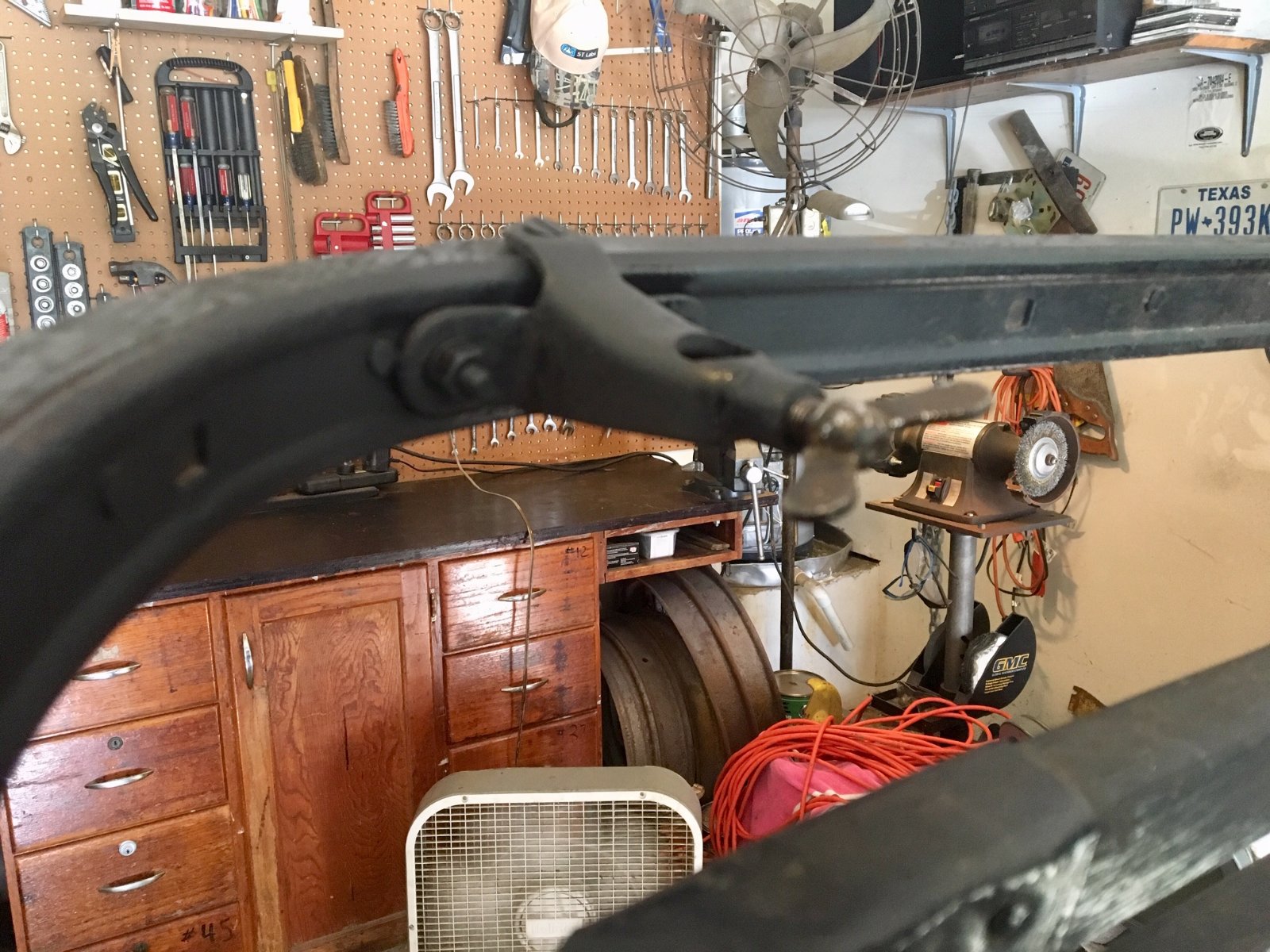

I wrapped up the day by continuing the tack rail project. I’m building the driver’s side curved piece out of plywood laminate like I did the other side.
I also installed the brake drums on my “new” wheels.

This weekend was the first time the weather allowed me to push the T of the garage to get a look at my handiwork now that the rear axle rebuild is complete.
I love the spindly, awkward look of a stock Model T from the rear...it's so goofy and cool at the same time. I'm no purist by any stretch and have built several hotrods, but part of why I don't like T hotrods is that when you lower them down and put big wide tires on them, it ruins this "spindly" look...and that's a lot of the charm on a pre-war car.
A nasty head cold had my number this weekend so I didn't accomplish as much as I wanted, but I did finish all the little details with the rear end assembly. When I installed it a couple weeks ago, I finished super late in the evening and didn't properly cotter pin everything and fill up the differential with 600W oil. So, I did all of that, and made some more progress on the tack rail project.

Another thing I was pleased with since the rebuilding and reinstallation of the rear springs is how much nicer the car sits and how fluid and smooth the spring action is compared to before.
Not only was there a broken spring leaf in the set, but the factory applied slip paint had long ago faded away. Add to that the completely dry and trashed spring shackle bushings and you had a very squeaky car that had almost no suspension travel. The car is now completely silent and has a nice range of motion as you rock and actuate the rear suspension. I'm excited to get the front suspension rebuilt and experience what a fully functional Model T suspension feels like.
I've ridden in John Mays' excellent 1911 Touring and was amazed at how comfortable it was and how capably it handled a dirt road. I'm hoping mine turns out to be similar.

I had about an hour of T-time on Sunday so I picked one little project I could start and finish in that time. That turned out to out to be the top-to-windshield post clamps.
My top bows/irons set were repaired a long time ago. The repairs are very well done and made the set very sturdy...maybe even more sturdy than a stock set. These came from Dave Hanlon's dad's stash so I'm assuming his dad made the repairs...but I could be wrong about that.
The forward-most bow has been modified in a way that made correctly placing the two windshield post clamps a bit difficult. On a stock set, the placement of the clamps is set and obvious. On this set, there was no indication as to where they belonged. I had to find a way to center them while maintaining the proper spacing for them to match the windshield post spacing. To make a long story short, I rigged some uprights to help find the center of the bow, then worked out from there.
I managed to finish the project in my allotted time and then test fitted the open top on the car. It worked fine.
