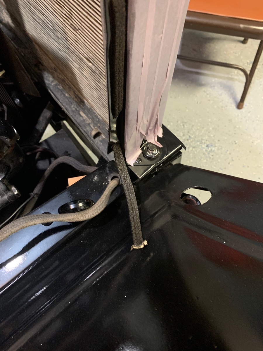

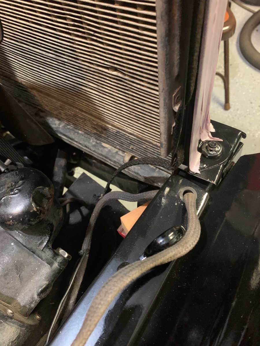

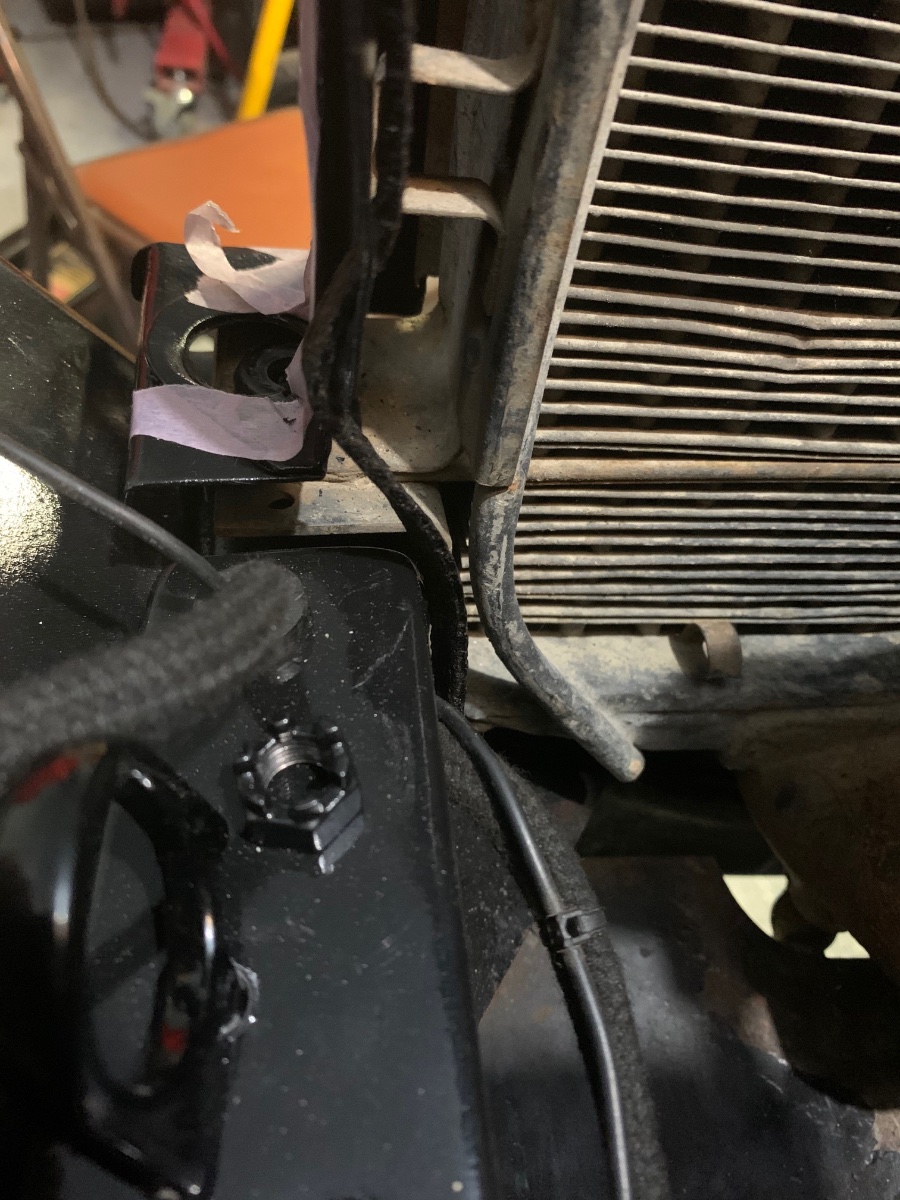

Put on new lacing on my radiator shell but not sure what to do with the two ends, do I just trim it close to the end and just let it hang or wrap it around ?
Thanks,
Bill...

jiminbartow
Posts: 2486
Last Name: Patrick
Location: Bartow, FL
Re: Radiator Shell Lacing
Post by jiminbartow » Thu Aug 27, 2020 12:44 am
Trim ends even with the bottom of the shell flange. The purpose of the lacing is to prevent metal to metal contact and the noise that would occur from intense vibration. Jim Patrick

Posts: 7315
Post by Allan » Thu Aug 27, 2020 2:05 am
Just cut it of an inch or so from the last hole. It won't go anywhere.

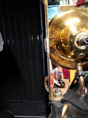

Post by DHort » Thu Aug 27, 2020 5:43 pm
The lacing is wax impregnated which made it stiff enough that I just bent the last 2 inches or so and stuck it between the shroud and the radiator. It isn't going anywhere.
cntbill
Posts: 15
Joined: Tue Mar 24, 2020 12:39 am
First Name: Bill
Last Name: Burkhardt
Location: Sinking Spring PA
Post by cntbill » Thu Aug 27, 2020 8:14 pm
Makes sense, Nice headlamp !
Posts: 2976
Last Name: Hjortnaes
Location: Men Falls, WI
Post by DHort » Thu Aug 27, 2020 9:06 pm
My car should be all black. A previous owner plated the headlights, shroud, and side lights. 1920 - wanted it to look like a brass car.
Adam
Posts: 1608
First Name: Adam
Last Name: Doleshal
Location: Wisconsin
Post by Adam » Fri Aug 28, 2020 10:42 am
I believe the original lacing wrapped around and tucked between the shroud and the lacing on the loop above it.
