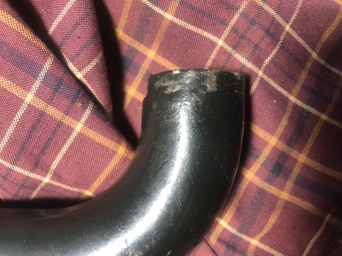

Re: Hot Air Pipes

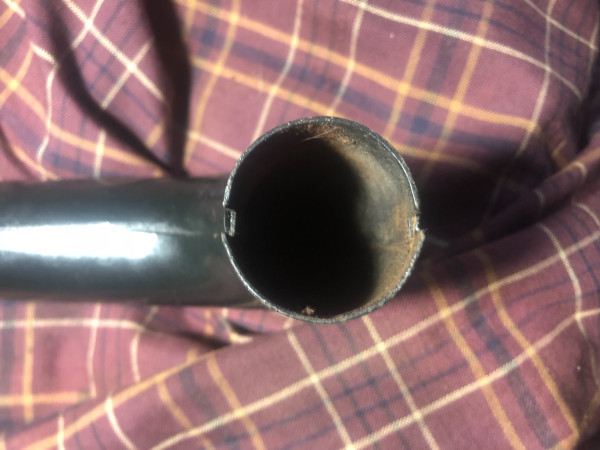

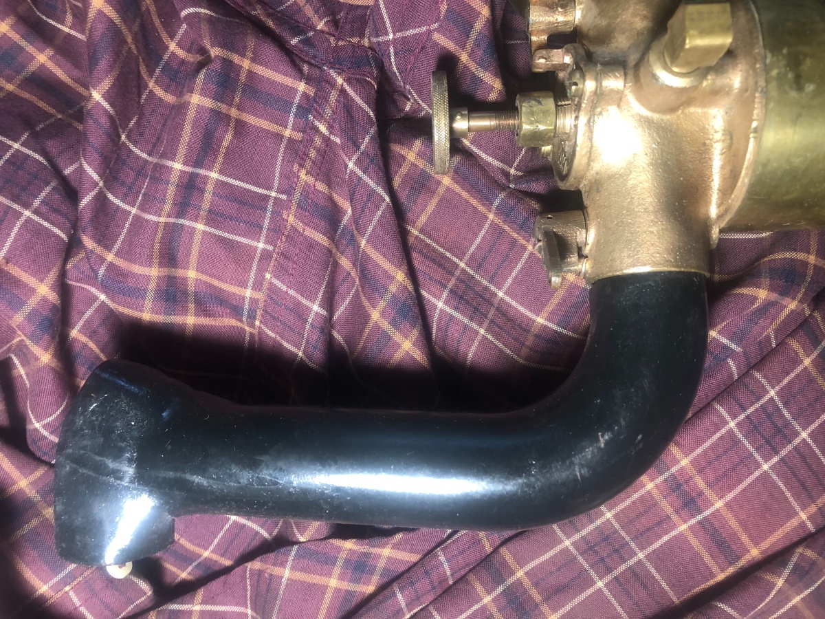

I bought this one to go on my 14 but haven’t installed it. It fits snug in an S but is a bit loose in an NH.

Re: Hot Air Pipes
Cory: Please post a picture of your hot air pipe without the carburetor! I don't want to reduce the o.d. of the end of my hot air pipe only to find out I may have to bring it back someday. Of course, I could put an N.H. on the car, and be done with it!

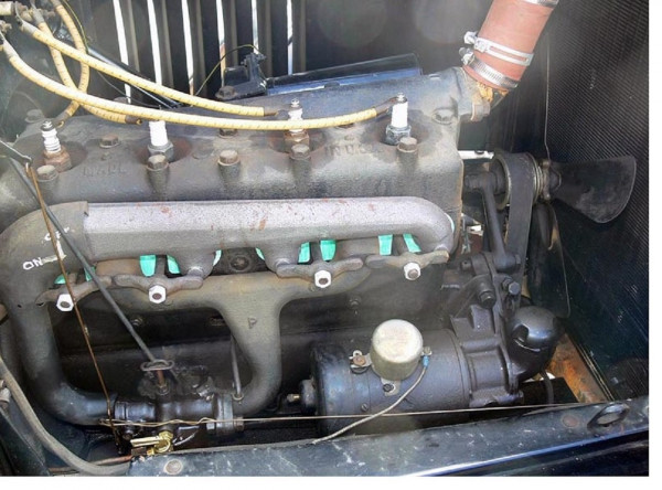

Here is the hot air pipe that is on my 1915.
I would like to find a cast one for my 1911.

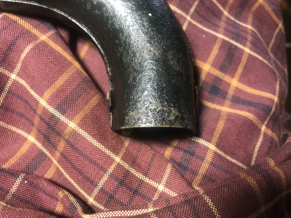

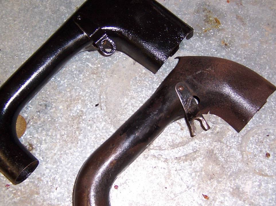

Re: Hot Air Pipes

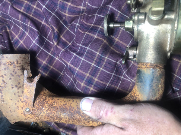

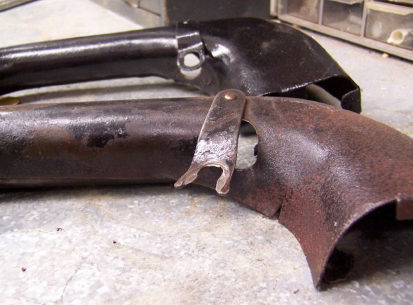

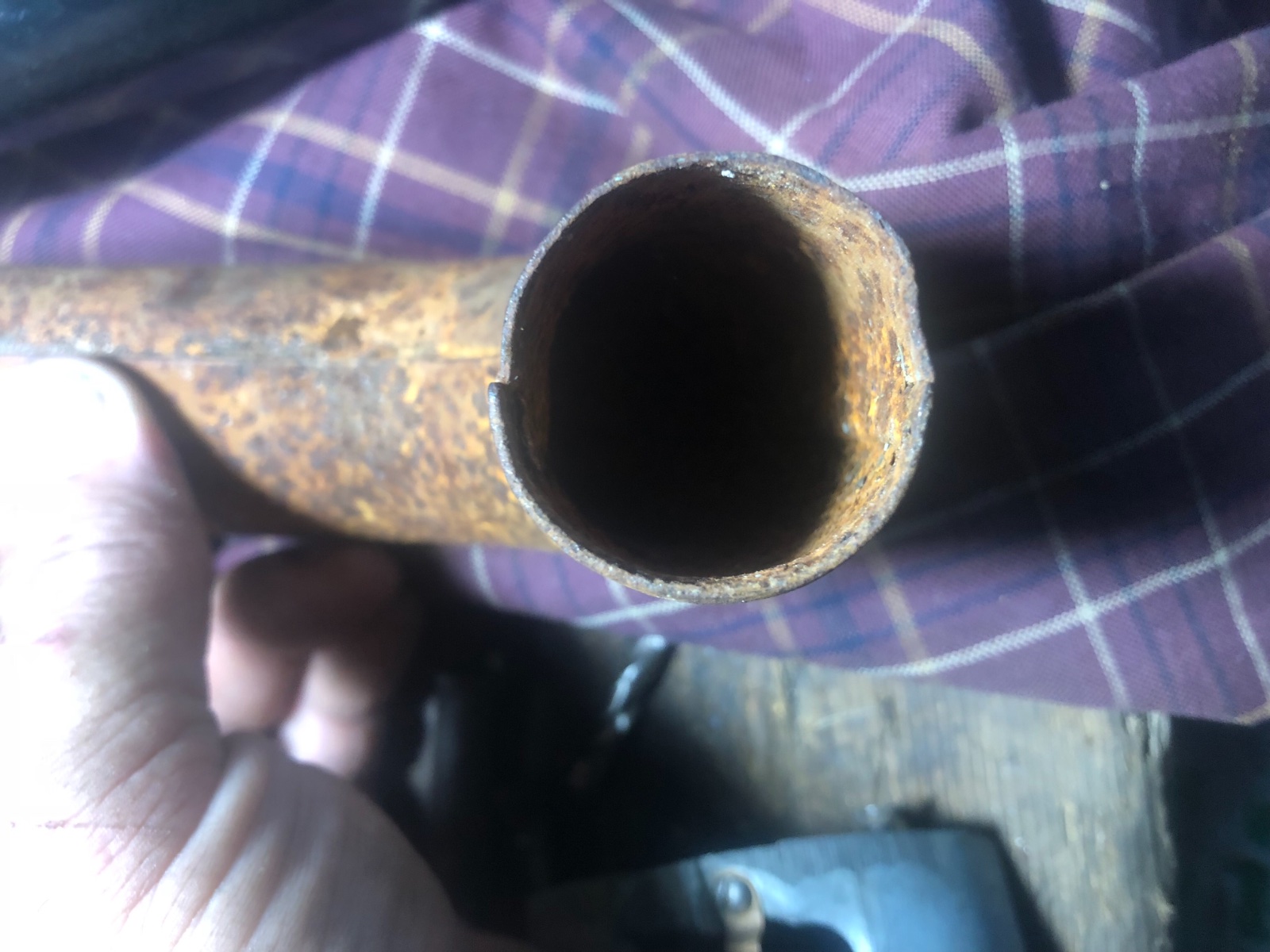

Larry, here are a few more. The later one won’t slide in, but it might if I sanded the rust off some.
- Posts: 5505
Re: Hot Air Pipes
Corey - I believe the last pipe you've shown is a repro - I've yet to see an original with the "open" tab.

Re: Hot Air Pipes

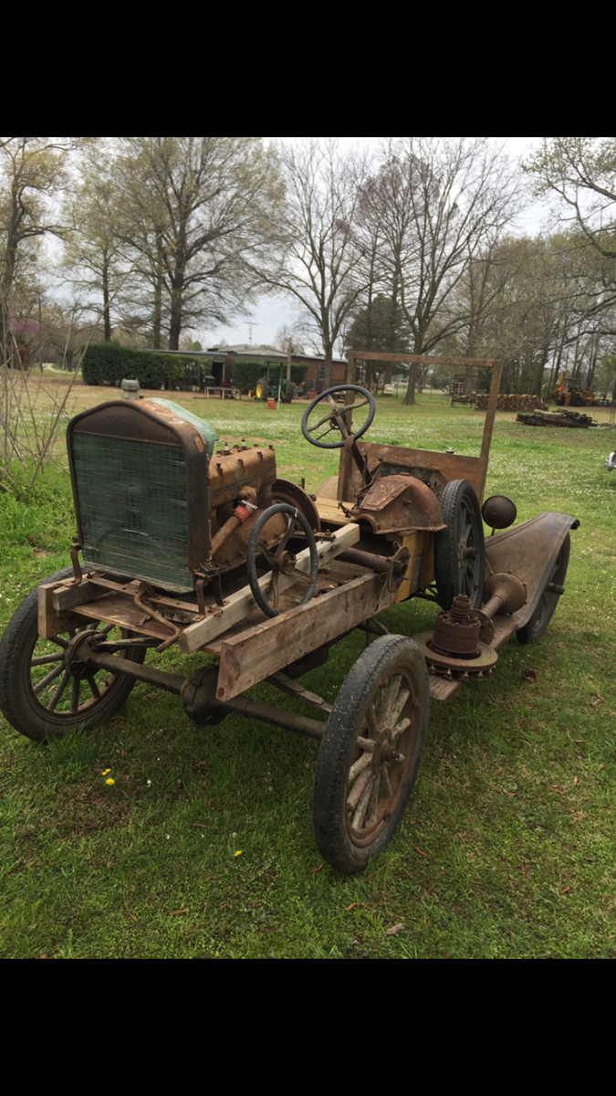

Steve, it could be. It was on a 1920 stationary engine I bought at Chickasha, had a Pat’s Pending Holley G and a riveted hub fan with only 2 blades.

Re: Hot Air Pipes
Steve and Corey
The 'open tab' style clip on the hot air pipe is the one used '19-'23 prior to Ford making the later versions with the full circle clip for the manifold stud. Ford did recommend to use a washer on these to keep the ears from spreading.

- Posts: 5505
Re: Hot Air Pipes
News to me Mr Treace ! Can you substantiate that claim ?
- Posts: 5505
Re: Hot Air Pipes
I stand educated - my 1923 Ford Price List of Parts depicts an artist's rendition of the "open" tab - I don't have a 1922 to look at but prior parts lists, 1921, 1920 & back to my 1915 price list shows the "early" style stove. My 1925 list shows the "full circle" tab but it is the later style stove when Ford introduced the late style manifold clamps & perhaps the combination mixture/choke rod.

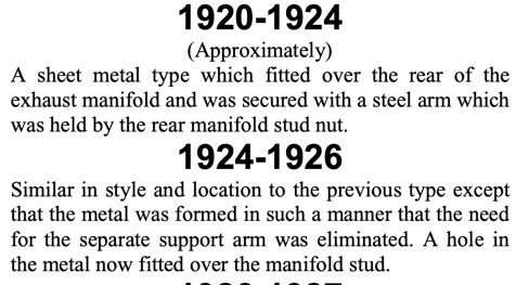

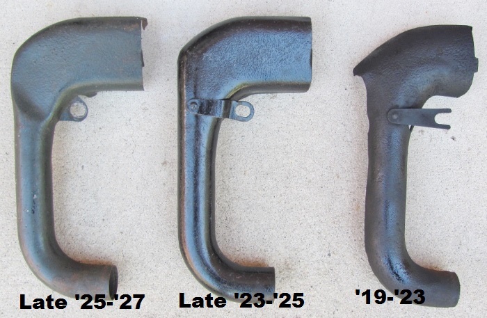

Bruces's C-D had this to state on the Hot air stoves, formed from stamped sheetmetal.
His dates are approx. The later one was changed in '25 for the new combination choke and carb adj. swivel rod and is recessed for that rod into 1926 until the Vaporizer came along and then the hot air pipe wasn't used on that setup.

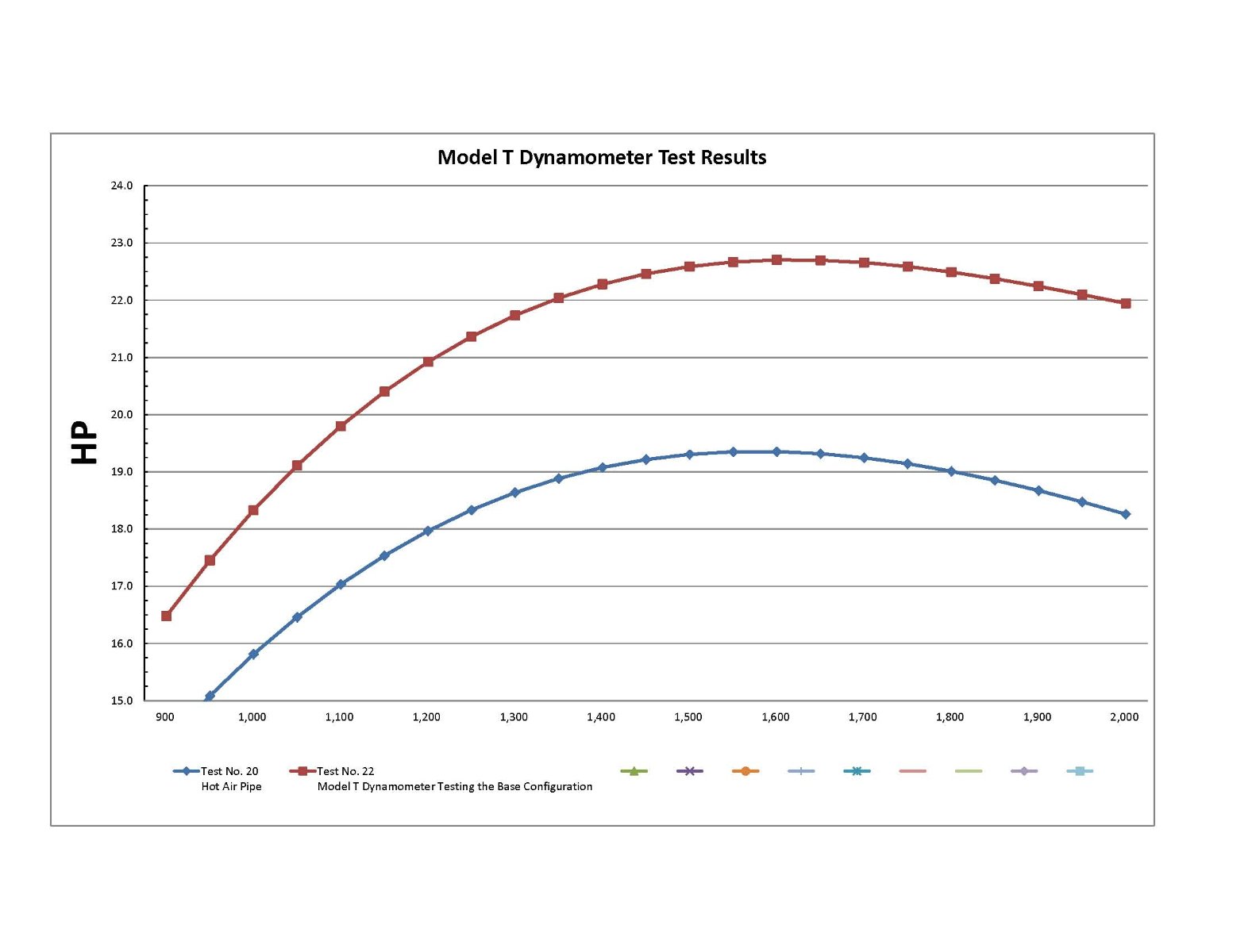

Re: Hot Air Pipes

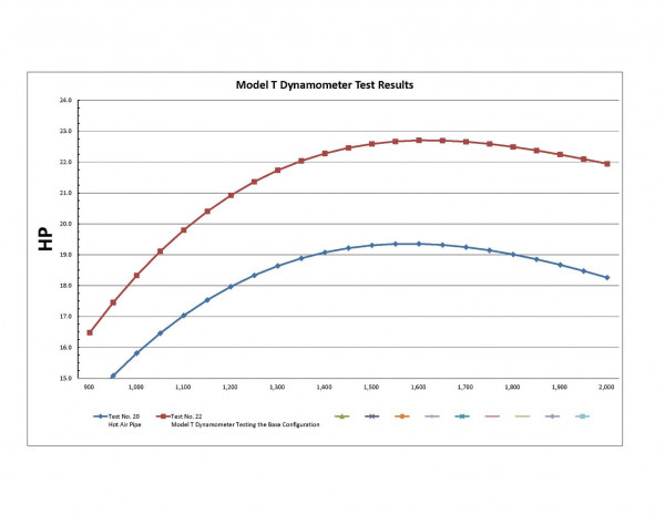

Let me throw this Monkey Wrench into the mix.
I got this off of the forum some time back.
The only difference between the two curves is that one has the stovepipe and one does not.
I took mine off.
I took mine off.

Re: Hot Air Pipes
Bob,
I also found that my performance is better without the pipe. But, on cold mornings in the summer here in the south, with high humidity, after a highway run of about 45 minutes, my carburetor will freeze up, stopping the car. So I put the pipe back on. I found that I can move the pipe enough to clear the carburetor if I want to run without the pipe, but that the pipe remains on the engine so that I can hook it back up if needed by just moving it back into position.

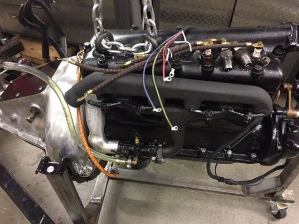

Hi,
I realy like this air Pipe on my 1913-14 engine work realy well and look nice too.

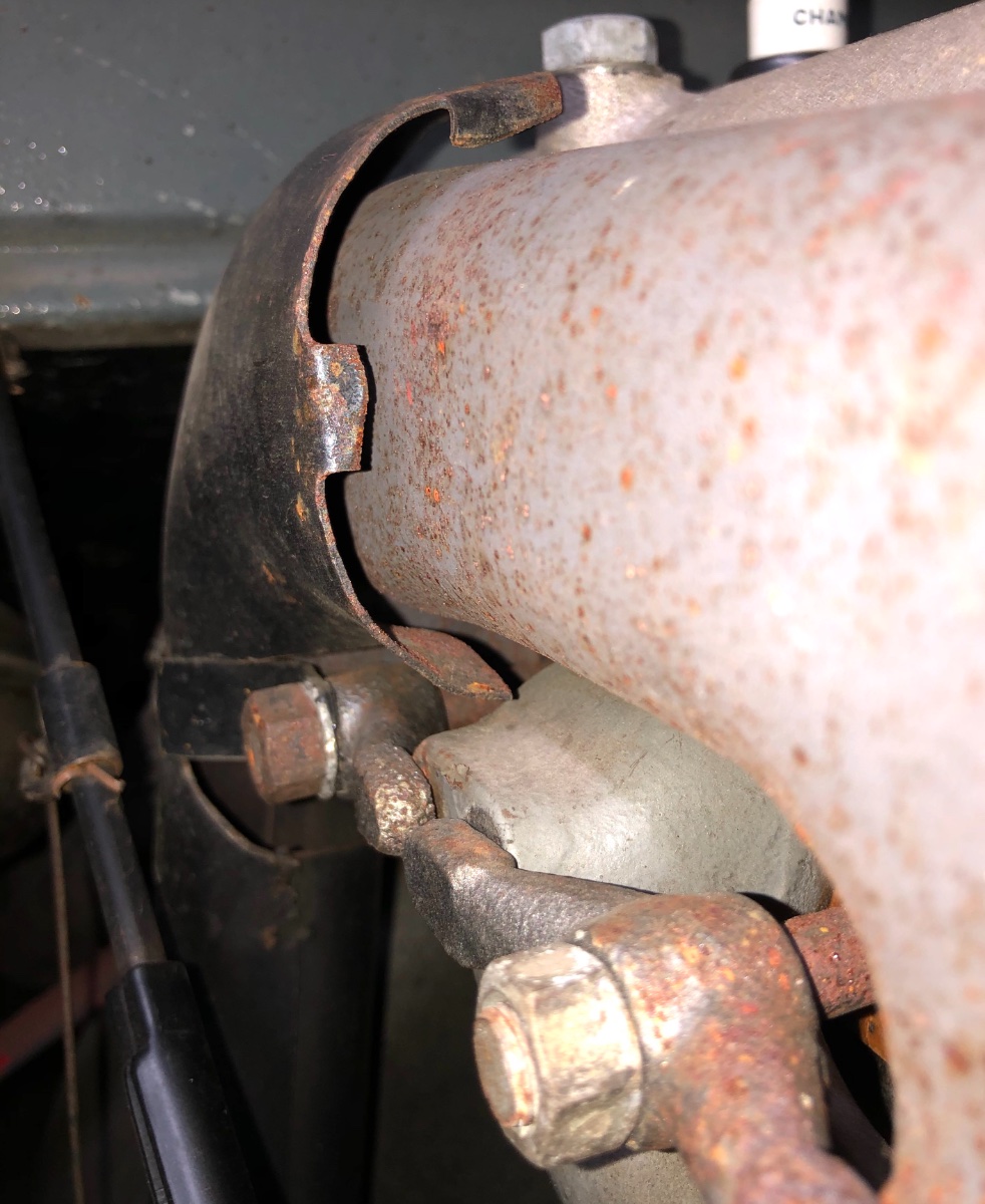

Re: Hot Air Pipes
I have bought a new repro hot air pipe of the 19 - 23 type but I have issues fitting it on the engine.
Can any kind soul with such version mounted on the car? Particular how it fit with the bolt that holds the clamp to hold the manifold.
Thanks in advance!

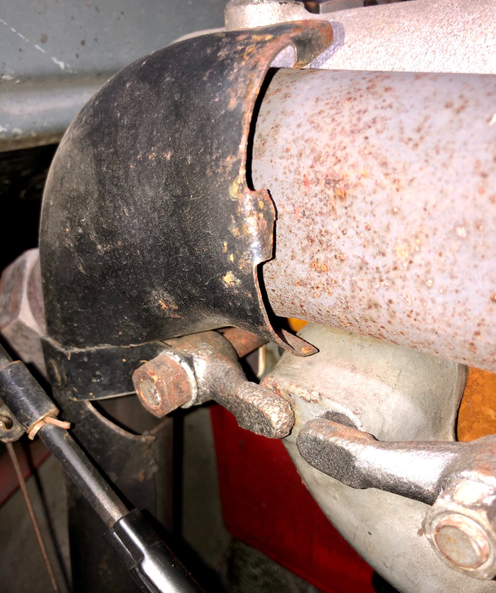

- Posts: 4057
Re: Hot Air Pipes
dykker5502 wrote: ↑Wed Sep 09, 2020 2:47 pmI have bought a new repro hot air pipe of the 19 - 23 type but I have issues fitting it on the engine.
Thanks in advance!

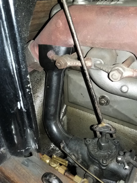

This is the repro Lang's hot air stove on my '27 touring. The photos may help you. The round hole in the upper back side is for the manifold clamp to fit into, and that far end of the clamp over the exhaust manifold, then the other end on the intake manifold. Place the clip open end over the stud, and you lock it with a washer and then the nut on the stud. The washer prevents the open clip from spreading and letting the stove get loose.
Notice mine is MMP'ed.
The tangs on the stove over the exhaust manifold are trimmed away too, to get the stove close to the manifold for clearance of the later style carb adj. rod. The tangs don't hit the metal manifold to prevent squeaks , which are rampant every where else on my touring!

Re: Hot Air Pipes
Thanks! It hot pipe is also modified for adaption I can see and that was what confused me with the one I have.

That hot air pipe that Mario posted is a NOS one I found at a swap meet in the late '90's. It is aluminum and I polished it, came out very nice. Dave
