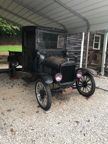

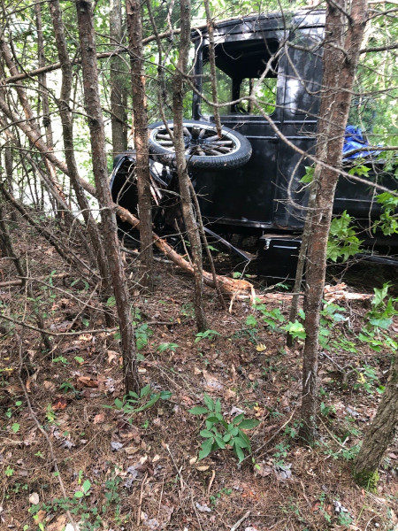

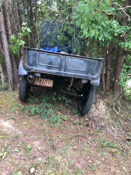

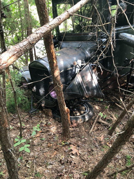

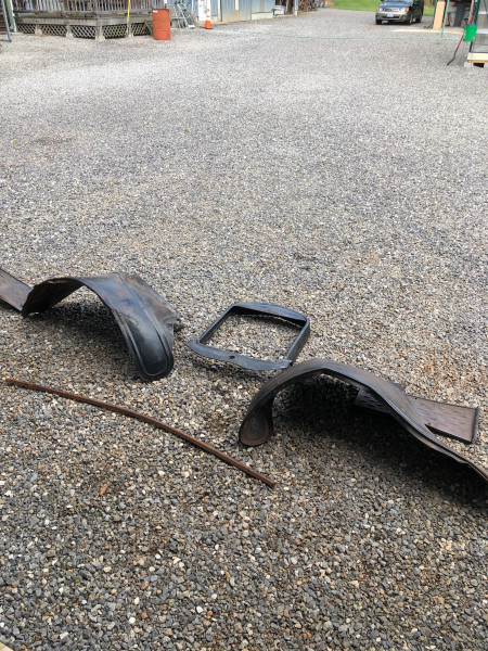

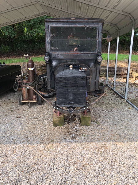

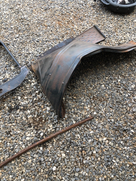

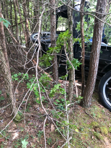

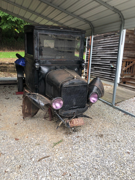

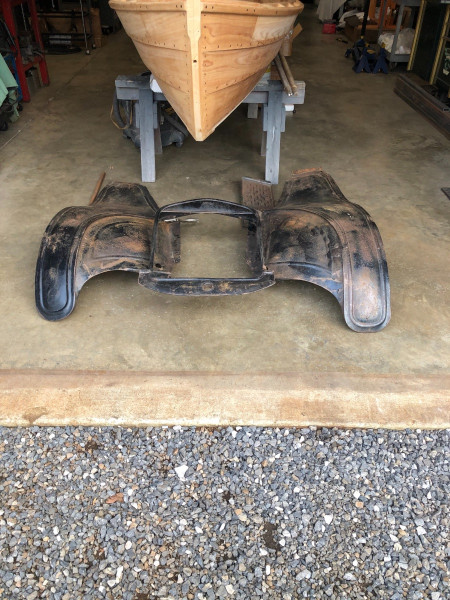

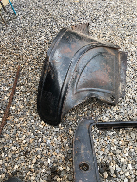

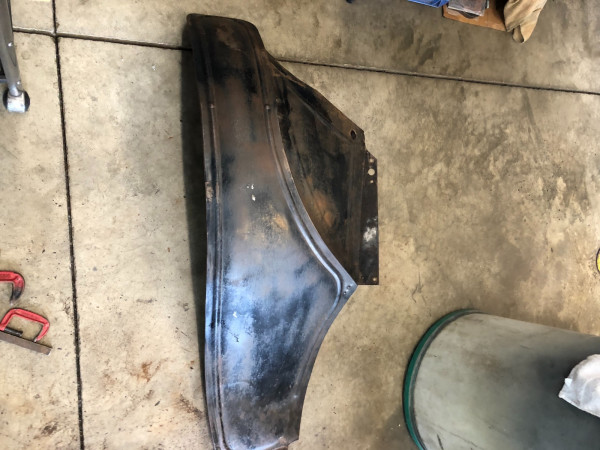

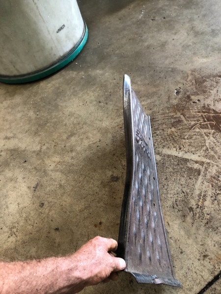

Was showing Rick how well his new TT runs and operates and coming down a hill the accessory Rocky Mountain 6 Speed Transmission jumped out of gear and would not go back in. New emergency brakes with linings would not hold back as they were not seated in fully. A Real Run Away! Rick in the driver seat, me in the passenger, Rick yelling.., "What Should I Do"!.., me.., "Hang on and let me steer"! Aimed dead on to a pine tree thicket. Looks bad but really is not. Was able to steer it right into the trees and knock out the energy with a couple of three inch trees. Already have all the parts in the works so it will be back up and going in no time.
PLEASE FOLKS, NEVER UNDER ESTIMATE ANY T WITH AN ACCESSORY TRANSMISSION AND A NEUTRAL! ACCESSORY BRAKES ARE A MUST!!!!!!
I AM POSTING THIS AS A REMINDER AND MY MISJUDGMENT! No one was hurt.., Thank God!
Only the fenders, running boards and mounts, a little hole in the radiator, drag link and wish bone damaged. Not bad for a 35 mph impact.
Humble Hank with soiled under pants in Tin-A-See

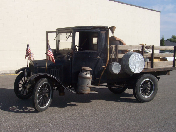

Main reason I won't run my TT down this hill until he has brakes, just in case the Warford comes out of gear.
No brakes what so ever on the axle, sooo....
The others have and are tested every time down.
Sure isn't the end of the world tho.

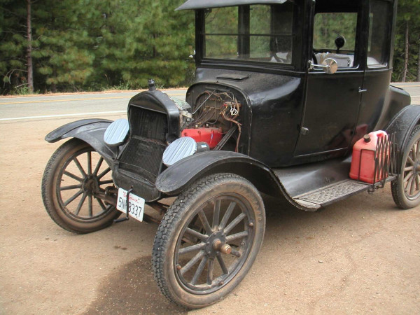

My close encounter with roadside vegetation was due to going too fast on a muddy road and being misdirected by sand washed across the road, but it was a similar result, although less serious. My only damage was a busted top socket and I was able to drive away. Running off the road unexpectedly is always disappointing, whatever the reason.

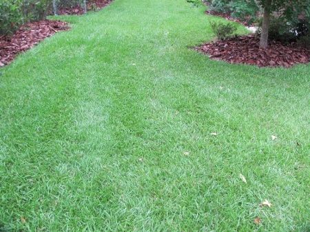

Had my run-away experience back in May 2012, just rebuilt the 1919 and went for a spin to adj. free neutral some more.
Made 2 loops around the 'hood and just coming into the driveway, a muffled bang/pop sound, from the tranny?..but motor was running, low pedal not slowing the T driving into my driveway with the house dead ahead...whoa....no brake either.
Shut off the motor by switching off the key and sought out steering to a soft landing spot
Spied the grass to the left of the house to roll to a stop, missing the house and having enough of soft grass and dirt to slow the T to a rolling stop.
Of all things, the emergency rods were disconnected! As I was adjusting for free neutral, and the clevis were off for setting after free neutral. Normally that is done on jack stands, but that day decided to run without emergency brakes.....bad idea
Oh me. Lucky. At least was returning home into my downhill driveway when it happened. Any other place on the road at higher speed would have been more scary! (Investigated cause was spun loose pinion gear on the driveshaft, putting the transmission brake and low pedal out of commission.
Moral for me, don't leave home without emergency brakes hooked up and working.
Tracks in the grass at the side of the house where the T finally rolled to a stop on its own.

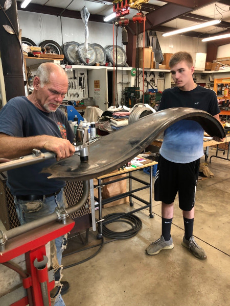

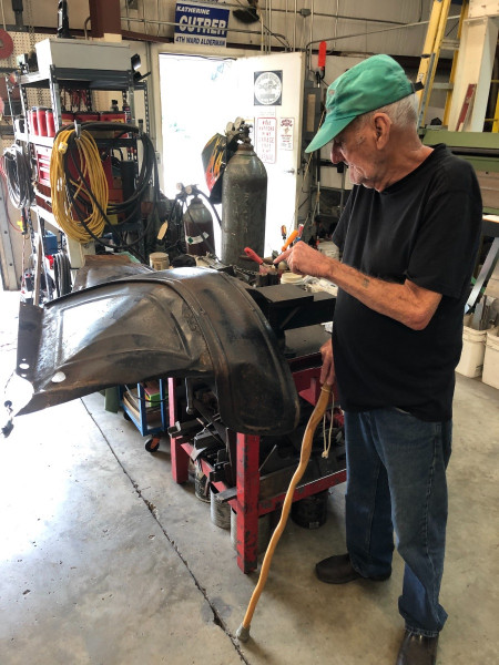

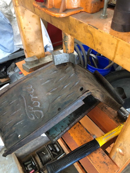

Hank, glad everyone is OK. Straightening that sheet metal will be a good learning experience for your apprentices.

wow....hate to see a T banged up like that, but glad yall are ok.
One way to look at it is....if these cars were all sitting in musuems and never getting used, they'd never be in wrecks. And that would be more tragic than one occassionally having a crack-up
If the passengers come out unharmed and the T is repairable, then all is well.
And...it looks like that radiator apron is dinged up. You don't want that banged up thing on that nice T. Better send it to me!

This could have been much worse. Any one that has been to Hank’s place knows that this could have gone down hill fast.
Sorry Hank had to throw that in. But it really could have, he lives on one nice bluff overlooking the TN river. His road has some high drop offs on one side of the road.

Most can't believe metal being twisted so bad can be brought back like new and even stronger by an air hammer. Here is a days work with two bad teeth (crowns going bad), OUCH!

All the general rules are in this book. A wealth of information, been using and teaching from them for over 45 years.

WOW,that poor truck!
Glad you are all ok.
BUT help me understand,how did it yank the wishbone out of the oil pan and not damage the ball socket?Or is the oil pan 1 of the parts that will be replaced?

free download of the book,After seeing what was done to those fender,I wanted to see that book!

I always use an APCO radius ball cap! Beautiful breakaway system and keeps perfect tension as needed. Also use them on the center link.
No damage at all to the oil pan, the front broken leaf spring did the skidding. No damage either to the front cross member.
The key to straightening bent/twisted metal is to reverse the damage as it happened. That book will explain it.

And six days later..., Ready to go home.., again!
Locked the AUX transmission in low. I think Earl Shribes, Maaco, and Peach Auto Painting would be proud of that 95 year old paint match!

LOOKS GREAT! Like the old Timex commercial "Takes a Licken and keeps on Ticking" or Trucking. Paint looks good. Haven't heard the name Earl Scheib in years. They were in Houston back in the sixties. Paint jobs were $29.95. Google. Earl Scheib interesting story. started painting cars after hours in a garage He owned in the late 1920s and company went world wide. their base paint job is now $399.00

Terrific recovery, Hank. Not only your save on the original incident, but also on getting the car back on the road. I especially like your action of locking the aux transimission in low.

I'm glad everyone is OK and aren't you glad you had those two boys to teach you how to fix the truck!

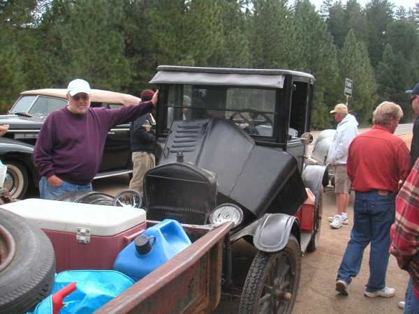

Ten Years ago I put together a Stag Tour and so I was the leader. Lee had his Coupe which he used to drive to high school (a few years ago). It has a Ruckstell.
On the way home I was doing about 40 mph down hill when Wham! In my mirror it looked like Lee was trying to get me to go faster. I started pumping my brakes which consisted of the service brake, Rocky Mountains and lined large drum parking brakes. In to the mix I used low then reverse when I got slow enough. Finally I got both cars slowed down enough that I was able to go across the road onto a gravelly patch on the opposite side.
Immediately after that patch the road got really steep down and twisty turney as it ran down a ridge in the forest.
Lee had broken off his shifter casting on the Ruckstell and was the second car in line on the tour. He had stock transmission brake and I think, unlined parking brake, no auxilliary brakes. He planted his T dead center on my pickup bed... so perfectly that he lost the radiator and headlights but NOT A SCRATCH on either fender and the hood popped off. Here we are ten years later and Lee Still thinks I saved his life (I didn't, it was all Rusty!).
Lee still hasn't repaired the Coupe, in fact he hasn't driven a T again! I agree with the sentiment that auxilliary brakes are essential. Without mine Lee and I would not have been able to stop before hitting the treacherous downhill stretch.

Daaaang, Hank! Fantastic work...and in only a few days! No wonder you weren’t as upset as I would have been. You are a magician. LOL! Jim Patrick
Topic author - Posts: 5474
- First Name: Henry
- Last Name: Lee
Re: Even the Experienced Make Bad Decisions
Thanks Jim.., I really hate to admit but it is a specialty in panel restoration and too boot, the two young men just finished an assignment I did for them on reversing damage on panels. They were comprehending every step perfectly. Talk about an opportunity..., accidents happen sometimes for a reasons beyond our understanding.

Is that the same radiator?
Amazing job!

Yes Mack it is.., believe it or not.

Looks great Hank. Your talents are many.
