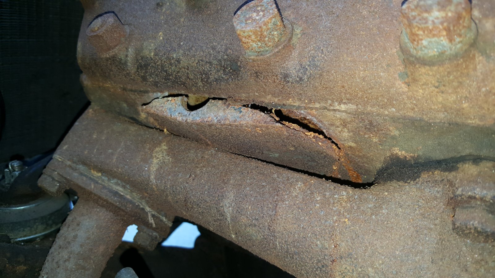

All it takes is forgetting the first night there's a hard freeze. Not a T, but still a Ford, and ice does not discriminate! That's the second instance of this I have seen in recent years. Don't count on draining it saving your bacon either because many castings have pockets that won't won't empty.
