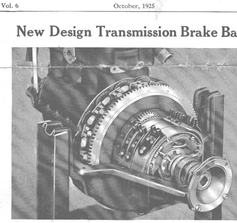

And it looks like a wide brake band lining on a pre '26 band? Good luck with your repairs, Patrick. jb

Good catch James, I didn't notice the narrow metal band on the brake.
Patrick, the wider rear brake drum uses a wider metal and fabric band, You have the wide fabric, but not the wider metal band. Here is what the wider metal band looks like, note that it is the same width as the wide fabric. There is one on eBay if you can't find one locally:
https://www.ebay.com/itm/1926-27-Ford-M ... SwHlhfUpFk
