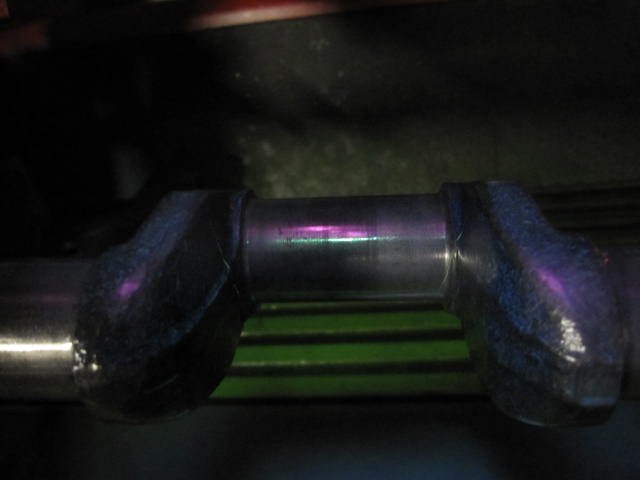

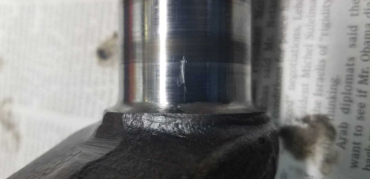

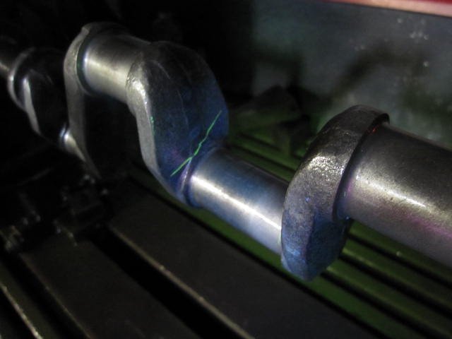

Dare we analyze my cracked crankshaft?? I say we do.. but INTELLIGENTLY
Topic author - Posts: 197
- Joined: Tue Jan 15, 2019 11:30 am
- Last Name: Lyons
- * REQUIRED* Type and Year of Model Ts owned: 1913 Touring, 1915 Touring, 1925 Coupe
- Location: West Virginia
I pulled the engine out of my 1925 Coupe. It had a few things wrong with it so I decided to take it out. First thing I did is have the crankshaft magnafluxed as always. In the attached photo, you will see a photograph of a 1/4 inch long crack in the #4 rod journal. I am considering putting it back in the car. Here are my reasons why. Please keep your rebuttals polite and thought-provoking. Making a blanket statement of "ITS CRACKED, REPLACE IT..." does nothing for good dialogue.
Here's why:
1, From the looks of the crack, and the fact that I can feel it with my fingernail tells me it's been there for years. The edge of the crack is rounded, speaking to years of use, polishing the sharp edge away to a rounded bevel.
2, The crack runs axially... along the length of the journal. If it ran diametrically, I would replace it without another thought. But this crack is not cutting the journal in two.
3, It's in the downward stroke side.... meaning it's in the crux of the crank, so when the piston fires, and pushes down hard on the journal, the crack is being forced closed... not open. I doubt this scenario promotes rapid crack growth.
In the end, I may choose to replace it. But a crack this small, running in this direction doesn't make my alarm bells go off. Forget that we live in a world of Scat cranks. If you only had this one to use, lets figure out what everyone thinks the probability of failure is?
And GO....
Here's why:
And GO....

Could just be a deep gouge. I would have it magnafluxed to check. On my own car if it passes that test I would use it, customers car no.

You didn't say "Wet magnaflux" as if it was done dry it only gives a one dimensional image whereas the Wet mag will give all three.

I think you are taking a big chance. If the car is rarely driven, then maybe you can get by for a while, however, it could break at any unexpected time and cause great damage to the engine or other parts. When it breaks, the car will suddenly stop and other parts could also break.
If you are planning to sell the car, it would also be unfair to the potential buyer if you were not to disclose this information. Also remember that this location has the most pressure of any place on the crankshaft because of the pressure of the first three cylinders firing, this location will not only take the pressure of number 4 but will be twisted by the other 3.
It is really a very lucky thing that you found this crack before anything broke because you might even be able to save the babbit. If your bearings are undersize, but the babbit is sound, you could bore them out to standard and fit a brand new crank in the engine. The new SKAT crank will cost a bit, but you can get one in standard stroke and the only difference is counterbalance. It really runs smooth and is stronger than the original crank.
So, the expenditure for a new crank now, could actually save you from having to replace the entire engine or even more in the future.
The decision is yours to make, but if it were mine, I would replace the crank.

Even if it's not a radial crack, it's evidence of crystalized metal structure in the crank. Even if it doesn't go now, nothing is saying that you won't develop a radial crack in that crystallized metal structure. How much is your time, patience, and engine worth? If not much, then run it, and when it breaks, know you have a pretty big hassle and expense ahead of you.
This is (to me) a craps table gamble... you can keep rolling the point over and over, but eventually you'll roll a 7. How's your luck? And speaking of, you need to factor in 2020. Normally, no, but after this year... while it's apart I'd drop a new Scat into it and not worry, rather than wonder "will THIS be the trip that breaks my baby?" every time you venture forth.
That's just my opinion. Just the crack being there means there's damage in the metal of the crank.... and that means while the linear crack may not fail, nothing will stop that crystalline structure from biting you elsewhere.

James, in your original post you said, "First thing I did is have the crankshaft magnafluxed as always."
Have you actually magnafluxed this particular crank in the past ? Was this same flaw seen previously ? If yes, then the only question you need to consider is whether it has grown since the last time you looked at it. If you have looked at the crank before and this is the first time you have seen the flaw, then I'd be worried.
The other possibility is that this is the first time you have ever inspected the crank and you have no idea if the flaw is a long time feature. Then we're not much smarter other than your observation of the wear evidence along the edges of the flaw.
Making the decision to replace or not is another subject. Is this the original block with correct serial number ? If so, it may have some intrinsic value and you would be more interested in protecting the block. If it's not the original block, then your only decision is whether to definitely spend a good wad of cash now or (maybe) to spend a somewhat larger wad sometime in the future.
Your decision is a lot like buying insurance. What is the chance the event will occur ? What is the cost of the potential occurrence ? How much money are you willing to spend to offset the cost of some potential greater cost in the future ?
Dick

I have seen forging lines run across two throws of a crank, they look like cracks on a wet mag machine but they are rolled pieces of steel in the forging, this could be one of those? not saying it is but possible?

I say it's a forging flaw and not a crack. "Crack" suggests something that was not always there, but has developed over time, use, stress, etc. I would propose that what you're seeing has been there since day one.

We had a crack similar to that on an equipment crankshaft. We ground the crack some just to get rid of the sharp edge running against the bearing , and ran it. It never did brake, but the bearing did go out again. This was done in frame.
