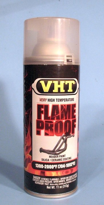

It will be fine. Just don't leave it in for weeks or months. I use the stuff for metal prep on steel and cast iron. It delays new rust until you can get the paint on. Do NOT let any get on your clothes. You can get clear high temp finish for exhaust manifolds.

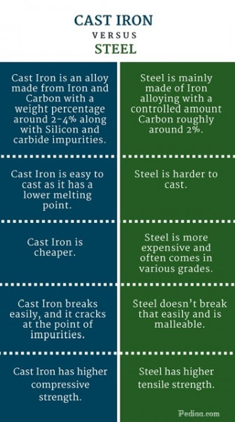

If, when you use acid on cast iron to remove rust and the area where you applied the acid turns white, with tiny bubbles, the acid is attacking the cast iron and will dissolve it completely, in a short time, so it is essential that you remove and neutralize the acid immediately with baking soda mixed in water.
Cast iron is not like steel and does not respond to acid like steel does. Cast iron is porous and has a lot more impurities than steel. Acid can get into the pores of cast iron and destroy the it from the inside out as the acid eats its’ way deeper and deeper into the cast iron as the pores below the surface are opened up.
Use acid only on steel. Not cast iron or aluminum. Jim Patrick

Cast Iron is rather porous, and will hold the acid in the pores, leading to its degradation.
