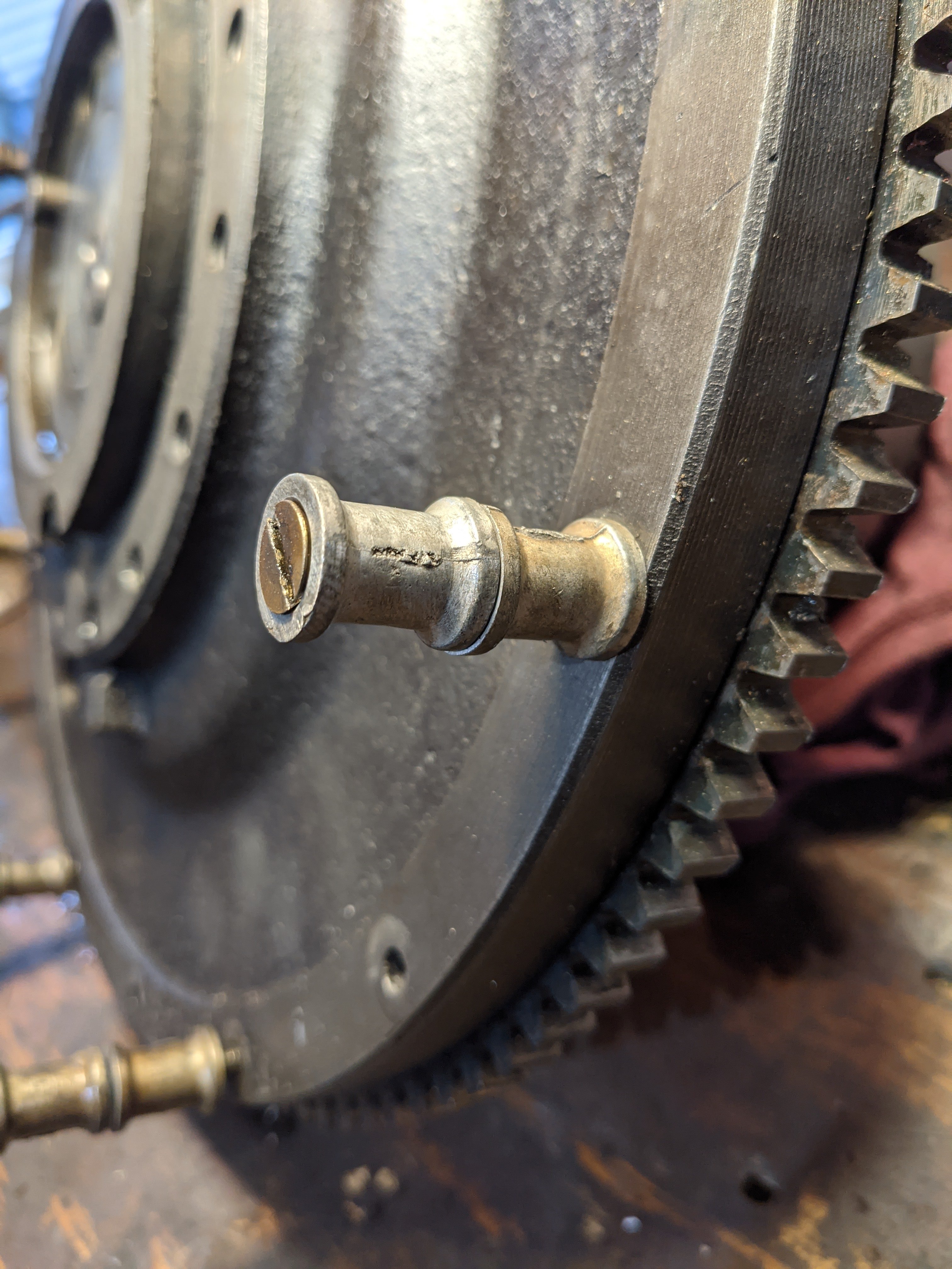

Like this? I feel like the splash from a single stack would miss the mag post oiler and maybe even the funnel. There's enough parts to do 8 stacks.
R/ Roger.

Post by walber » Sat Oct 17, 2020 12:20 pm
I used a single stack all the way around but while the internal funnel is installed I also run pressurize oil to the mains which gets plenty of oil up front. The spools are there mainly to ensure enough oil gets splashed around for the transmission. Doubled spools might well be better if using a splash system augmented by a mag post oil fitting.
