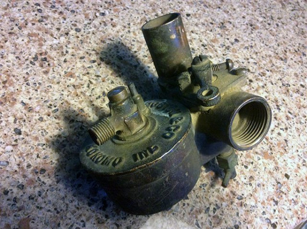

Re: Model A Carb.
Are you talking about this Model A carb?
