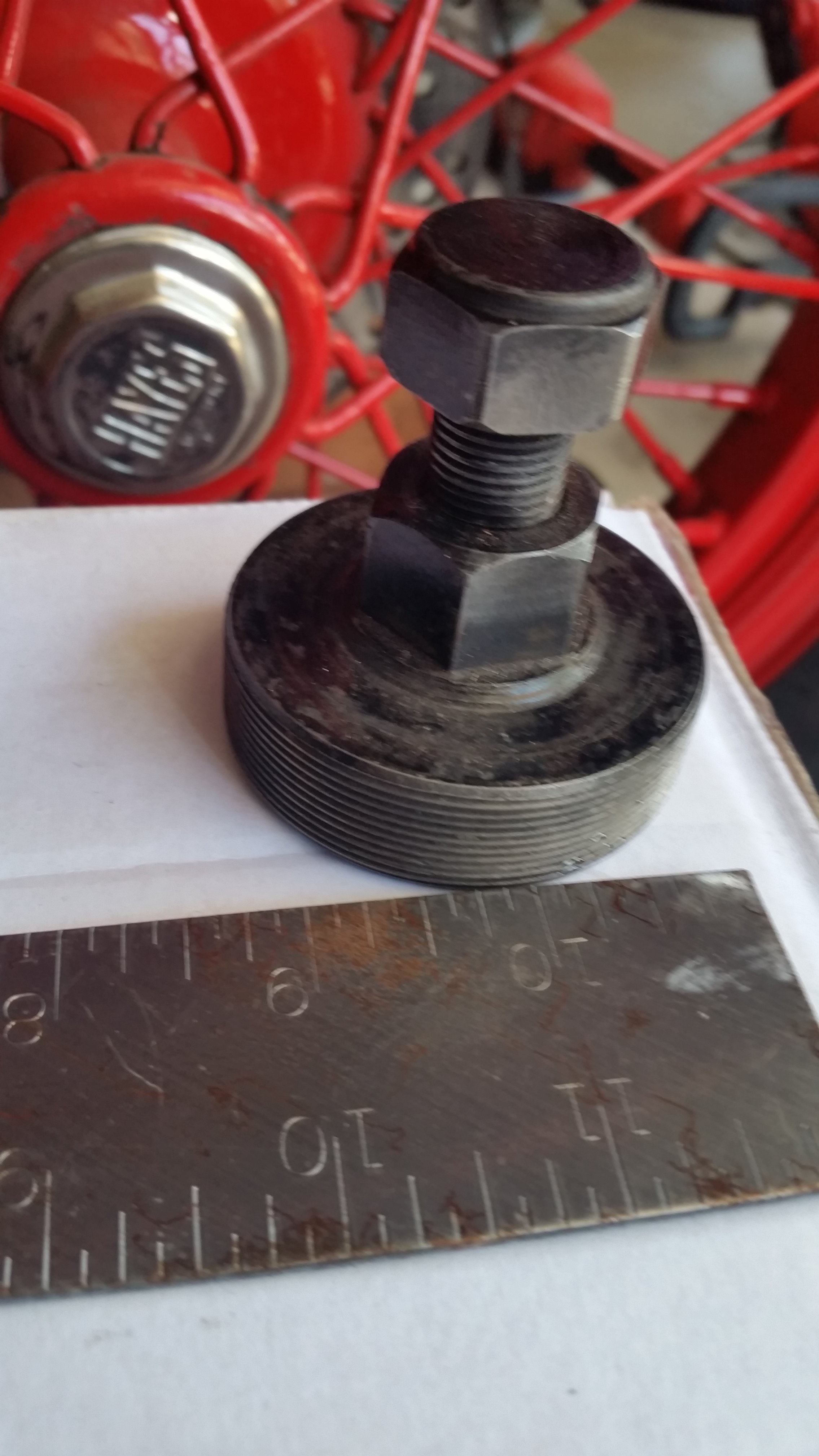

Does anyone have a picture of a Hayes wire wheel puller for the rear? I am wondering what they look like. Thanks Dan
- Posts: 7143
Re: Rear hub puller for Hayes Wire wheels?
Dan, my son made mine. It consists of an inch thick steel disc with the hubcap thread machined on the outer diameter. To the centre of the disc a large
nut is welded and that nut takes a bolt which pushes on the axle. The nut also serves as the means to screw the puller into the hub.
The coarse thread of the Hayes hub is quite adequate to take the effort applied.
Hope this helps.

[image][/image]Hi Dan
I believe this is a Hayes rear hub puller as it came with other Hayes spares for our 21 inch wires on our 1923 Roadster . Its a rather simple device that a handy person with a lathe could turn up in my opinion. Hope you are keeping well Iam still collecting Ford signs when the opportunity presents. Regards Ian

Dan, add a heavy weld around the hex on Ian's puller, and it would look just like the one we made.

Thanks for the pic. Ian are you who brought the Follow the Ford car sign from me at Hershey years ago? Thanks Dan
