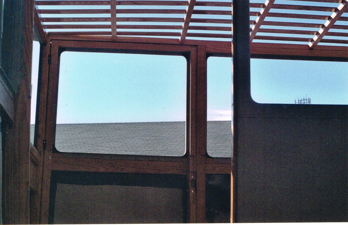

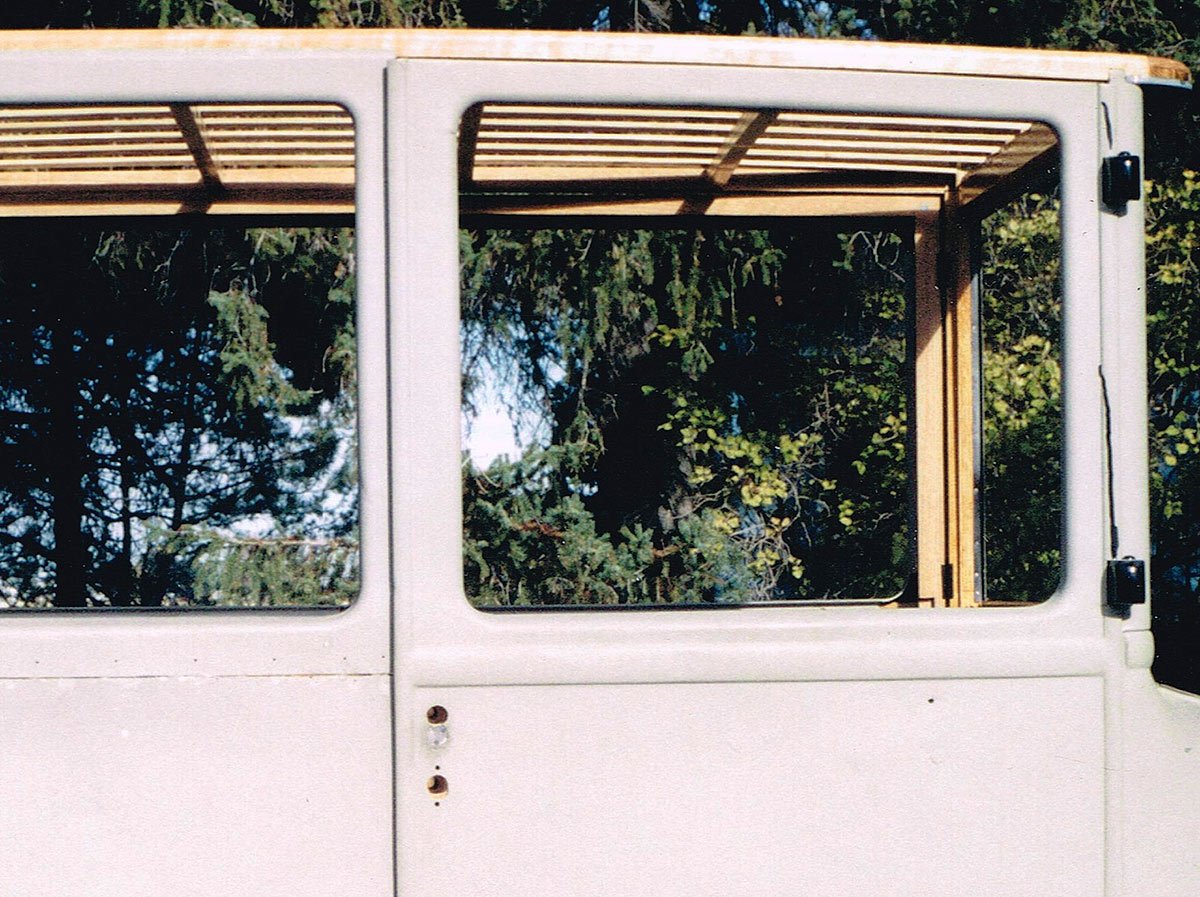

I am currently trying to fix up a 24 Tudor that needs everything pertaining to windows, both in the door and in the rear. It needs felts, bottom channels, rubber window seals, etc. There is a 1/2" gap just above the doors between the top of the door and the bottom of the roof wood that should not be there. Tomorrow I'll get a photo and upload it. Is there a rain gutter there? Anyone got a detailed photo they can share?

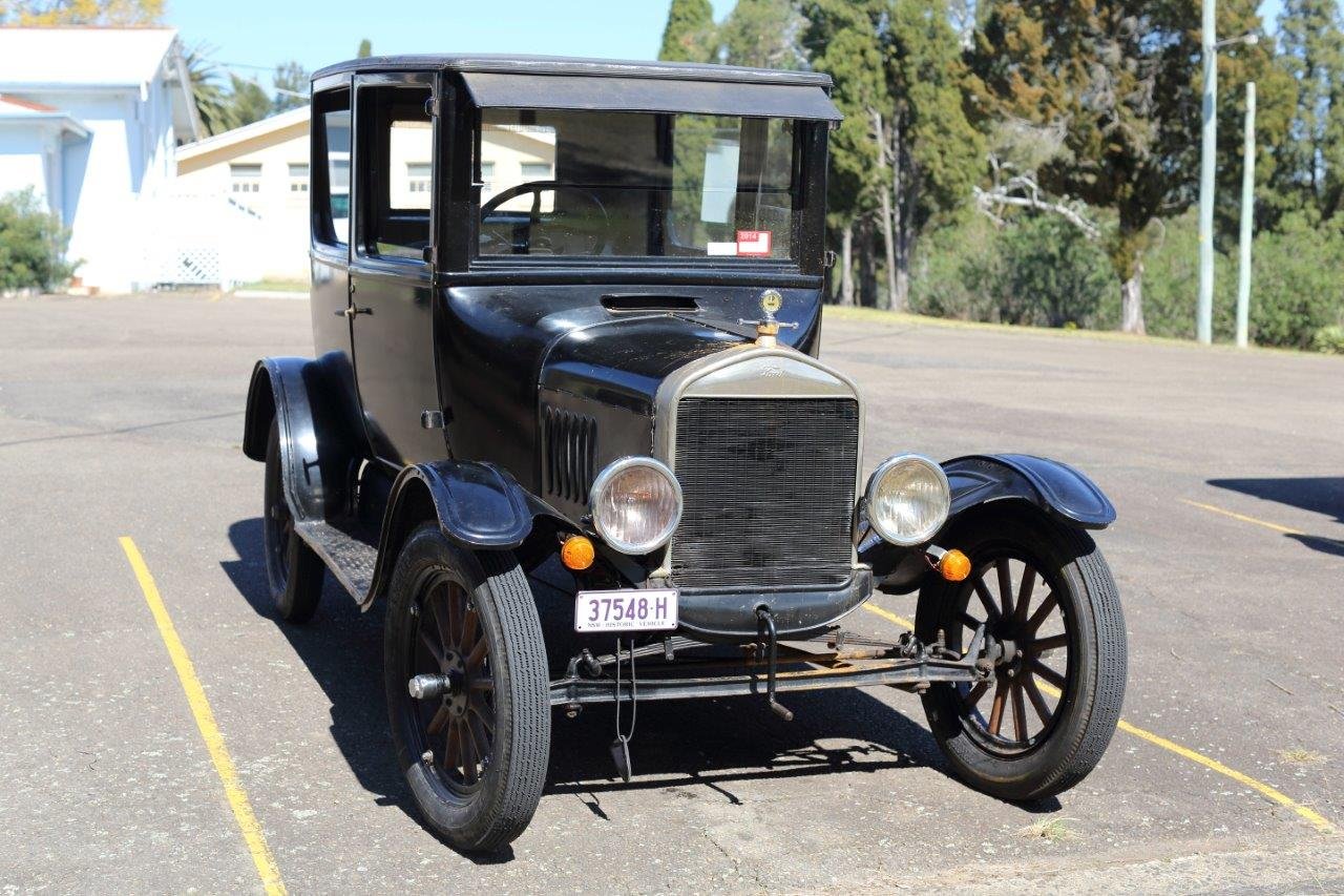

Here's mine. It looks like I've got the gap.
Sorry I don't have a detail shot handy.

John, thanks for the photo. So, do you have a rain gutter above the door? Does the hidem go right to the bottom of the wood that forms the top? A photo of the area just above the door would really help. Thanks.

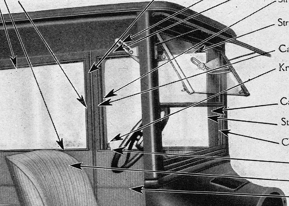

Rich, thanks, that is what I needed. What is the source of the photos with the arrows? Do they point to item descriptions?
Your doors have what I would call a minimum necessary gap. Mine has over 1/2" of space. Would the 26-27 rain gutter work for that space? It's the only one I see available in Lang's book.

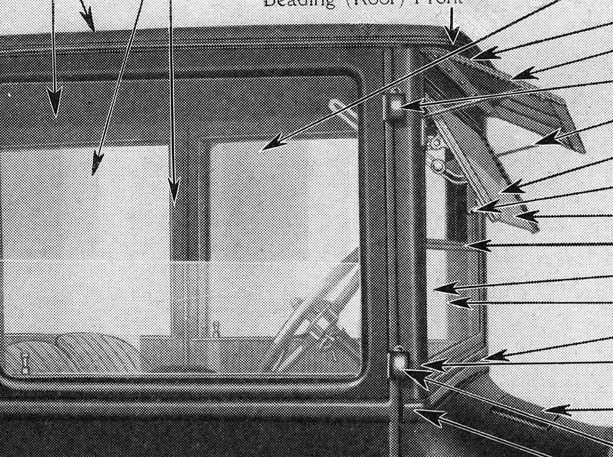

Most vendors sell the Price List of Body Parts. You need the later one that goes to 1927.
https://www.snydersantiqueauto.com/imag ... e/BT_9.jpg
This post shows one of the three illustrations for the Tudor.
