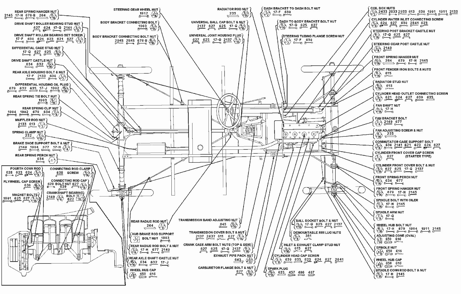

If posted lately my apologies. Not my chart but very handy. If revisions are needed please speak up....😁

The sizes shown on the diagram are for which wrench fits the bolt head, not the actual bolt size.
Here it is without the odd link:
This forum format doesn't allow a PDF, so here's a link to an old post with a PDF that shows actual sizes for most chassis fasteners:
http://www.mtfca.com/discus/messages/11 ... 1290642906
