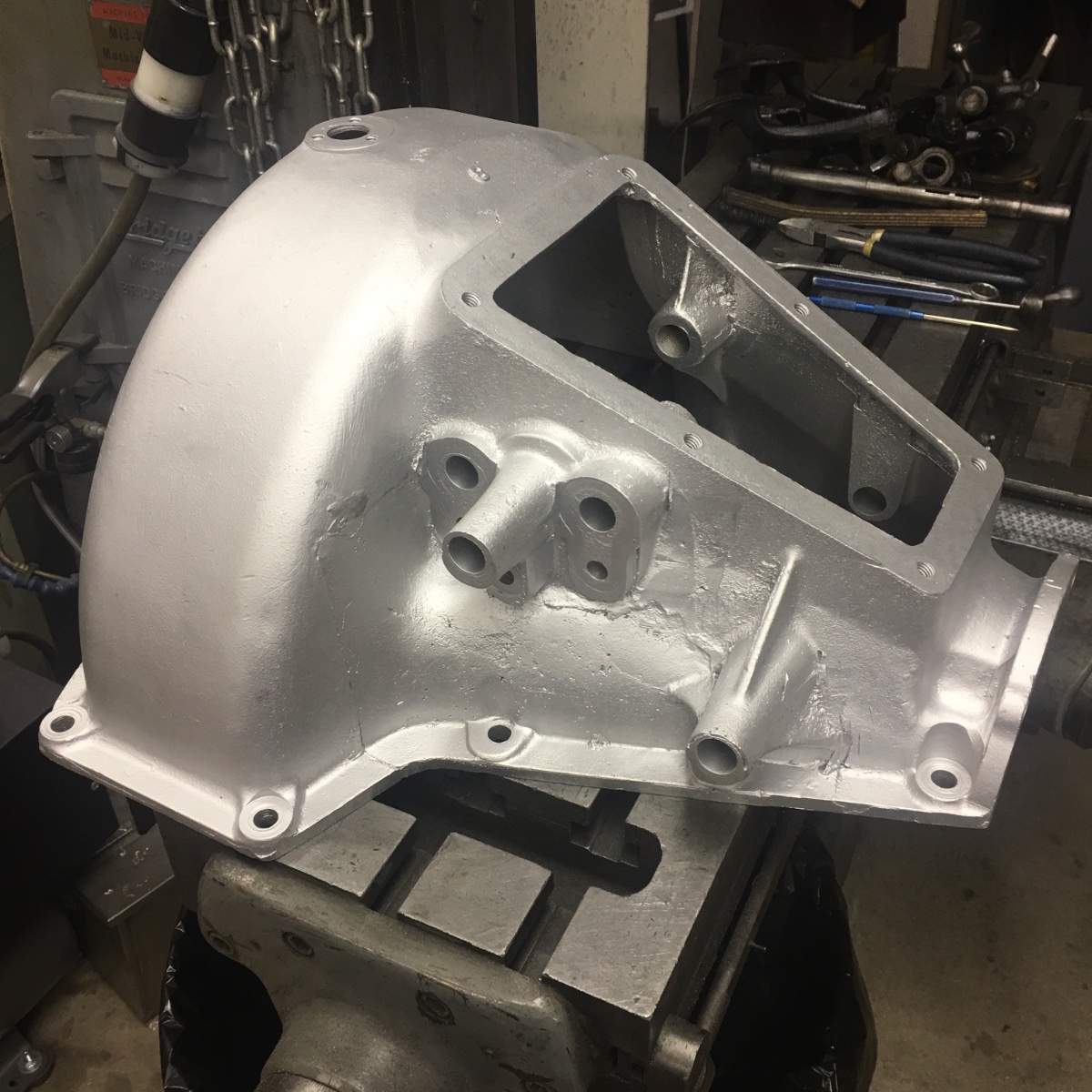

Solvent de-greased, blasted with fresh #6 glass bead, and followed up with fresh #13 glass bead.
