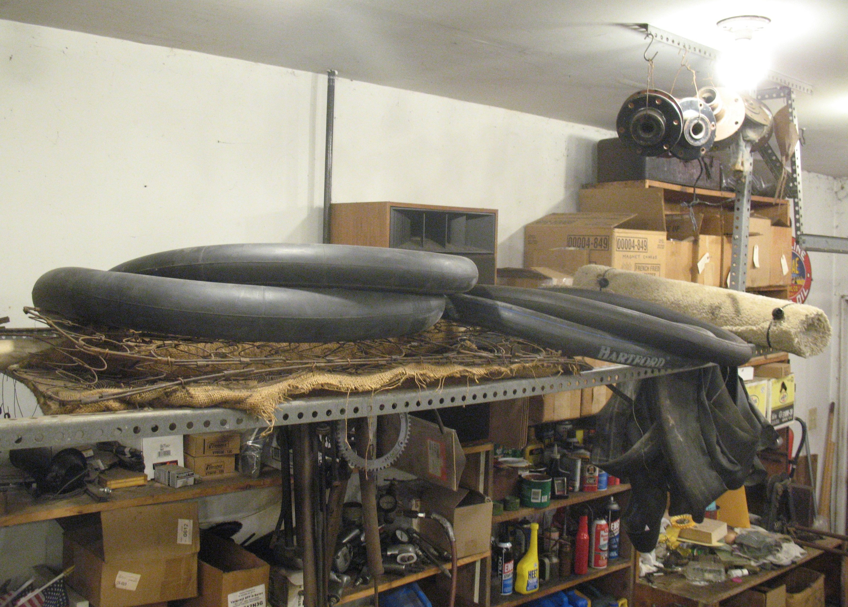

Another item you might recommend carrying is at least one spare tube, for those times when a tube can't be repaired or you don't have the time to find a leak. And as a friend who came touring this way this summer would tell you, it's a good idea to actually have a spare tube under your seat rather than just think you have one there.

Ralph, that is an excellent recommendation, but it is likely to give a false sense of security. The tubes available today are junk quality. A folded tube under a back seat, exposed to summer heat and that from the muffler, will quite quickly crack at the folds, rendering it not suitable for use. It should be checked regularly and replaced if it has deteriorated. If you can lay your hands on a butyl rubber tube from the 70's, grab it. Then remember to remove it and store in a cool place once you get home again.

Another item you might recommend carrying is at least one spare tube...
Between trips I store them.

Steve, that is the next best way to storing them, and clearly easier than fitting them into and mounting a tyre. I could not believe how well two red rubber Goodyear tubes came out of some old, mounted tyres. Keeping them out of the light also helps. My spares are stored in the cellar, which never varies from 72 degrees.
