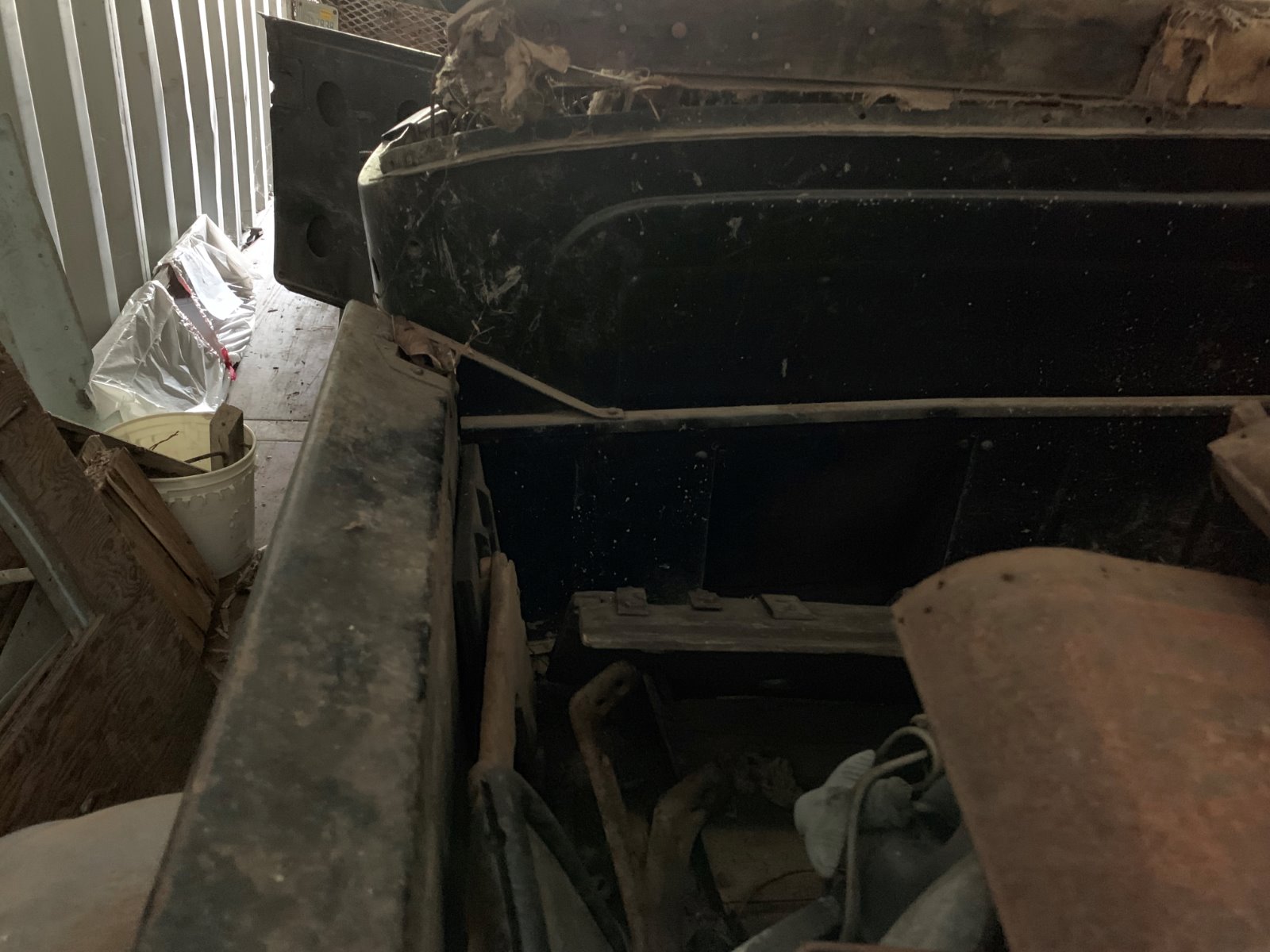

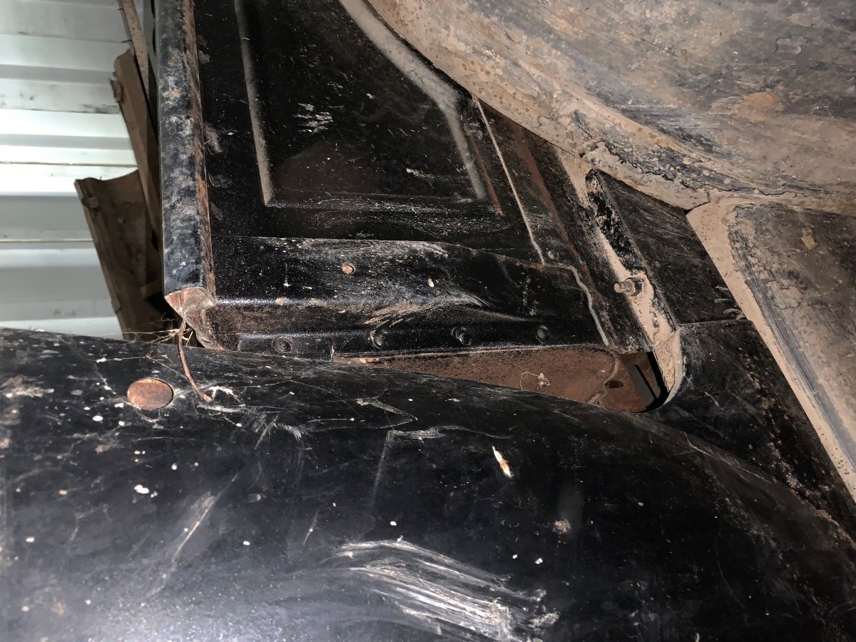

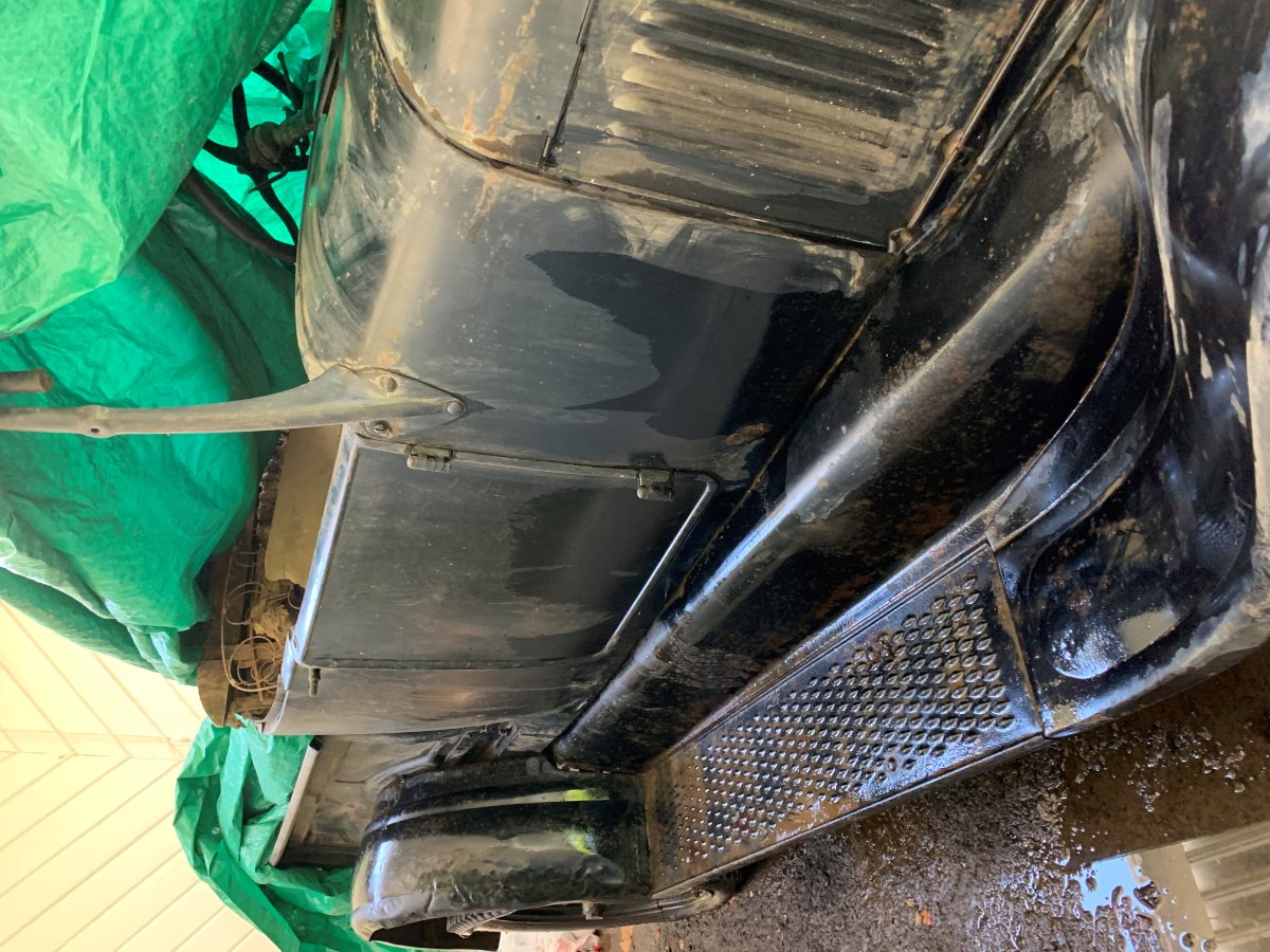

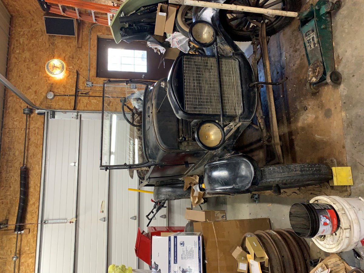

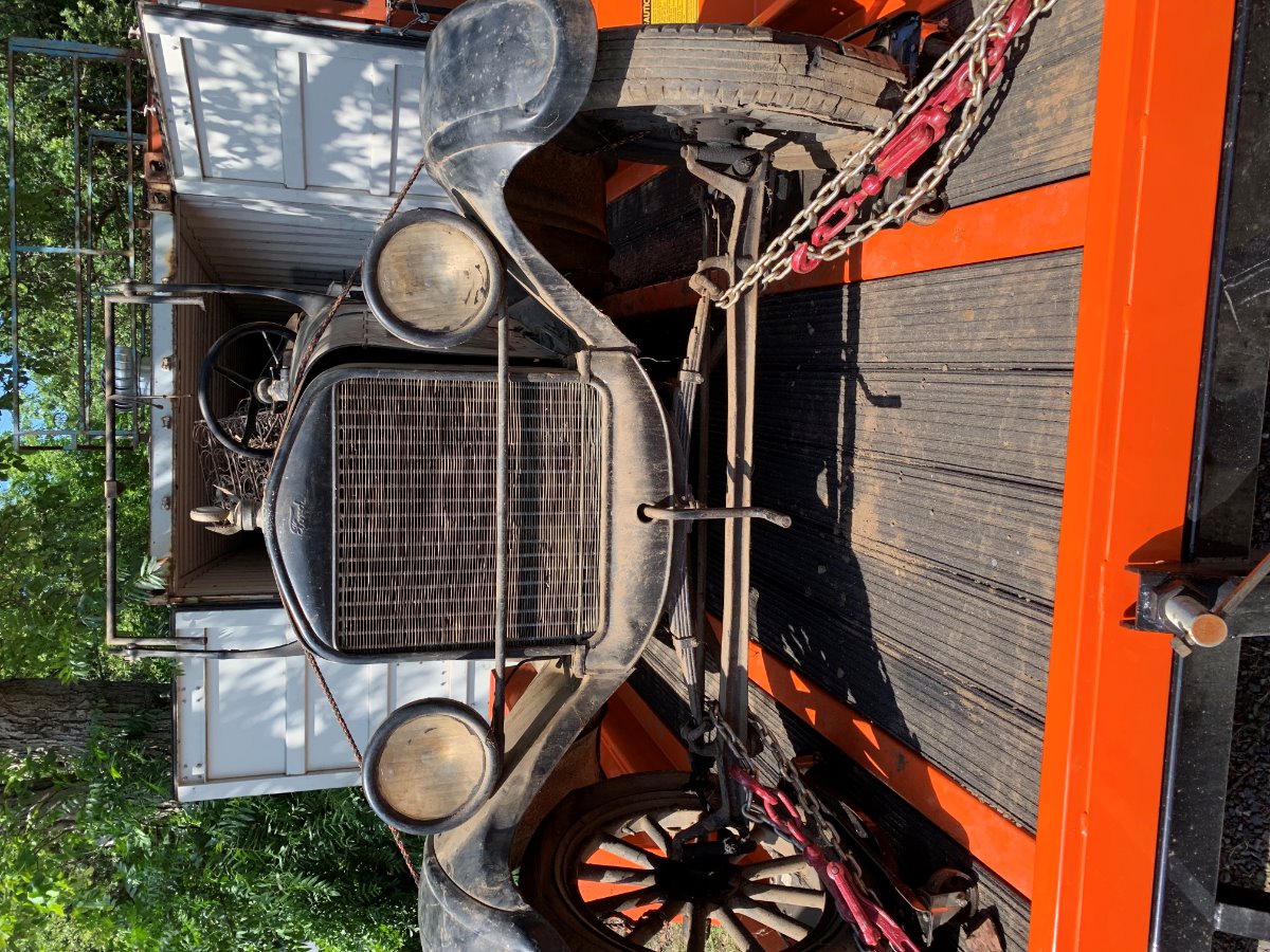

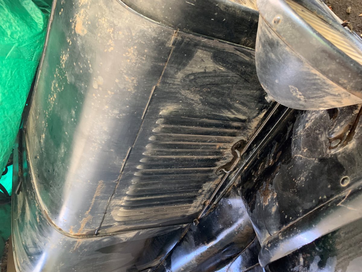

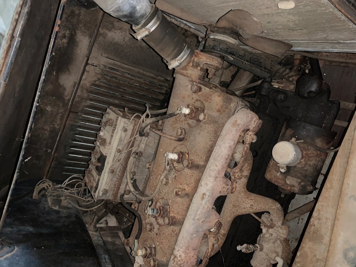

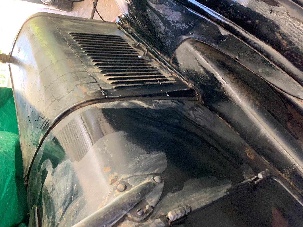

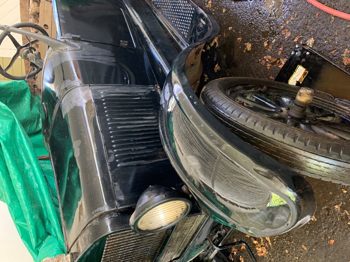

I am trying to figure out if this roadster pickup is a 26 or 27? The engine number is 27. The bed has is earlier with the stake pockets at the front. I don't have very many pictures to go by. But, I might be able to get some taken and sent to me.

It was setting in shed for a long time then moved to this storage container when the owner passed away. The family kept it and now are selling it because of age and health issues. It does not have a title, but they are working on it.
- Posts: 4081
Re: 26-27 Roadster Body Questions
Scott
Thanks, good enough photos, expanded some, and saw mostly '27 features. The cowl engine side didn't have rivets for webbing so may have the cardboard gas tank insulator against the dash. The headlamps mounted on bar is '27. The door jam at cowl is '27.
Engine has '27 features, the head bolts have been changed out, but the dome head bolts to hold the manifolds, instead of studs, is '27, those dome head would be nickel plated. The body has mounting holes for turtle deck, so may have been a runabout originally.
This one is certainly after Dec 1925, so you will find a frame number stamped on the top frame rail near the front running board bracket on the passenger side. That will tell if engine matches frame.
Appears top irons may be in the bed.
It's a nice unmolested T! Good find!.
IMO, the early bed was added, as that mounting bolt with nut on top on the subframe isn't how factory did it, that bolt head would be on top of the bed frame rail, nut below.

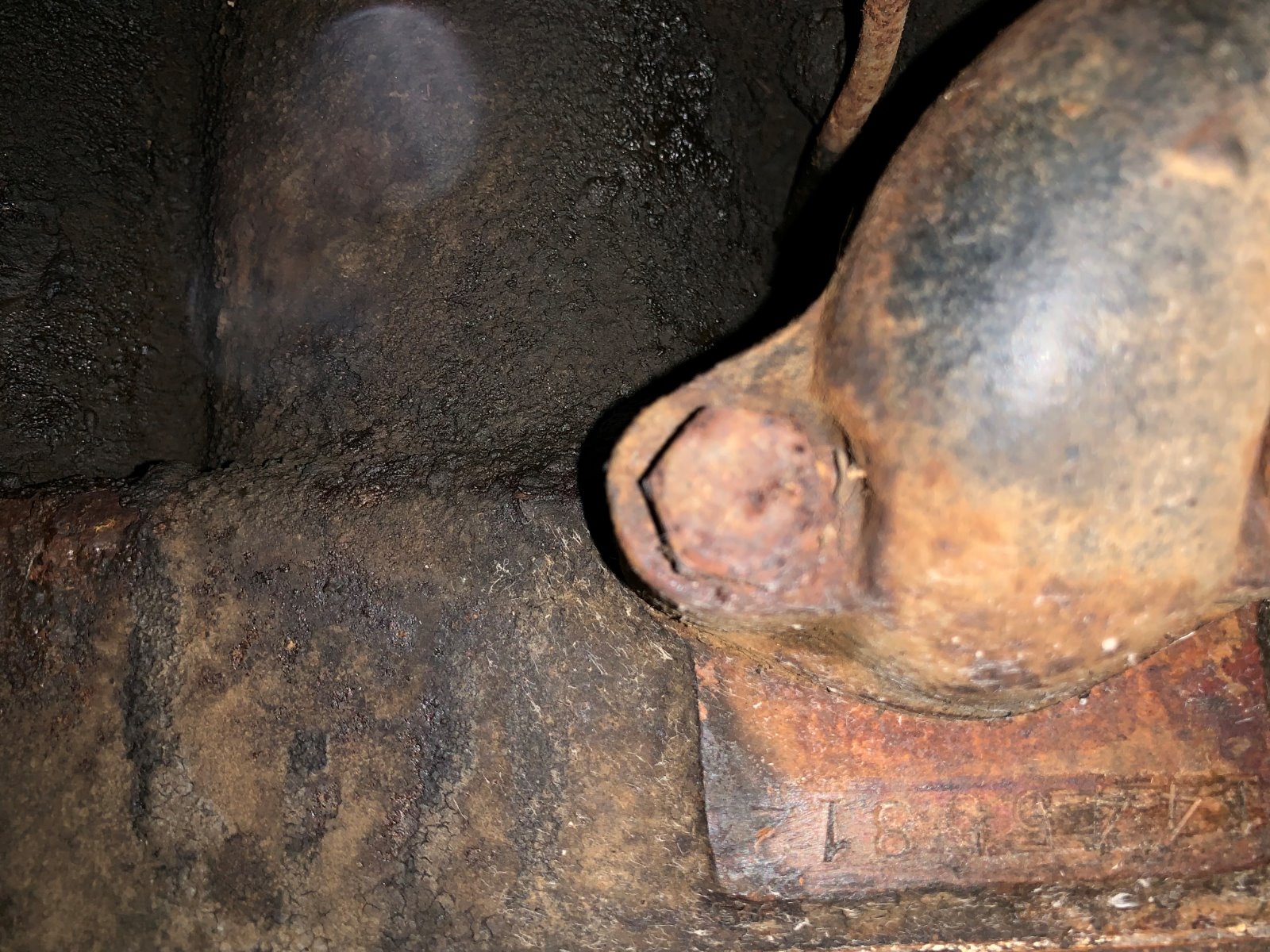

Here is the engine number. When was it built?

It looks like the number is 14, 455, 812, but the second #5 is hard to read and is just a guess. Based on that number, the engine was made on Oct. 27, 1926 which was a Wednesday, and there were 5,950 engines made that day.
Since the 1927 model year began on August 1, 1926, this car is definitely a '27.

Yes, it is 14455812.

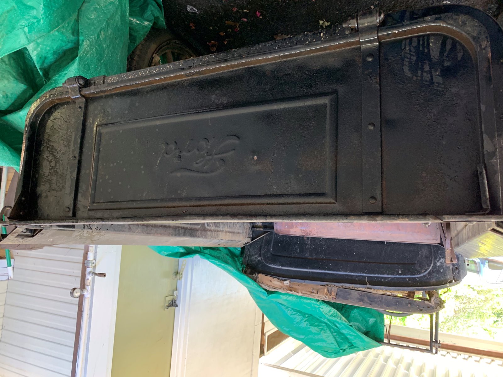

TMiller6
- Posts: 331
- First Name: Thomas
- Last Name: Miller
- Location: SE MI
- Board Member Since: 2006
This '26 is a project I've had for several years. I rescued it from a previous owner who was attempting to graft it to a shortened Model A chassis. Paint is temporarily on hold until my wife takes a separate vacation.
One of these days I will research the change notices and try to figure out when the car was built. I believe it to be early production.
Here is the upset on the hinge pillar. The cowl has the four stamped holes on the cowl for the windshield stanchion. One thing I hope to research is if the stanchion change occurred around the same time they added the drain hole to the cowl.
Here is the 1926 steel rocker. A separate zinc panel with the Ford script is fastened over this. In '27 it became one piece. The previous owner had sand blasted this car and when I replaced this panel, I found damp sand packed in here reaching partially into the cowl.
Tom Miller
Scott C.
Topic author - Posts: 863
- Last Name: Clements
- Location: Waynetown Indiana
I am still waiting for the seller to get a title. They did move it out of the storage container and sent me a couple more pictures.
- Posts: 4081
Real nice project in great shape!
You’ll have fun with that pickup.
The first photo when clicked on to enlarge shows image horizontal and nice original detail on the stanchion mounting fasteners.
Note original factory side curtain clip under that round headed single-slot machine screw.
That screw is correct, many use just carriage bolts at the stanchion.
Missing the lower windshield frame, but it may be in the bed.

Scott C.
Here is a picture of the right frame rail. I do not see any serial number.

- Posts: 4081
Scott
Nice pics, when clicked on to expand, the photos got vertical and could zoom with the Mac to see details.
The bed got changed to plywood, and the rear backrest wood is from an earlier T. The runabout would have vertical wood slats and backrest spring hung from the narrow wood tack strip that should be around the top of the body tub. The rear fenders are well worn1. Those knobby tires a bit flat!
But a great project.
Zoomed in on the frame rail, and believe I can see numerals of the serial number under the green spray paint section. Just not clear to see, you could with a visual inspection.
Scott C.
I that think I can see some numbers there. Not sure if that is green paint, or just some glare? Maybe I can get them to get a better picture?
- Posts: 4081
If you can’t visit to see your self, the owners will need to lightly sandpaper the area to allow the faint stamping to show in a good close up picture. These frame stamps are 93 years old now and the frame rail can have surface rust that hides the numerals. Original stamping are hand done and vary on clarity.
If the new owners are getting title papers you want to be sure they get correct numerals off the block and/ or frame.
Once had the seller’s son write down the block numbers, they went to DMV, got papers for me. When I got home with the T, and was going about getting title in my name.....dang!, the numbers were wrong. Had to go thru a bunch of hoops to correct that miss by the son. Always check yourself is my motto now

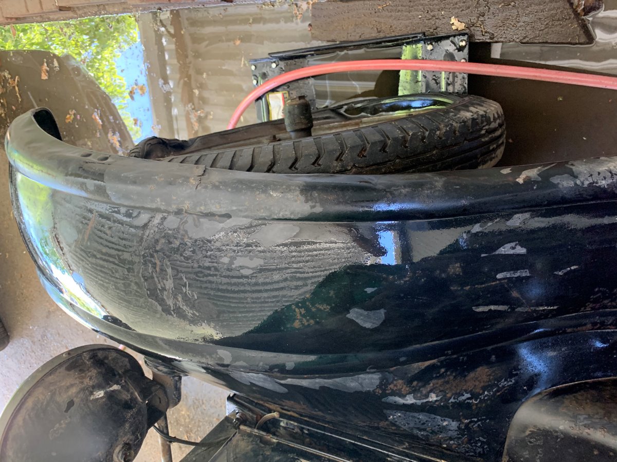

Scott C.
Here are a few pictures of it setting in my shop.
