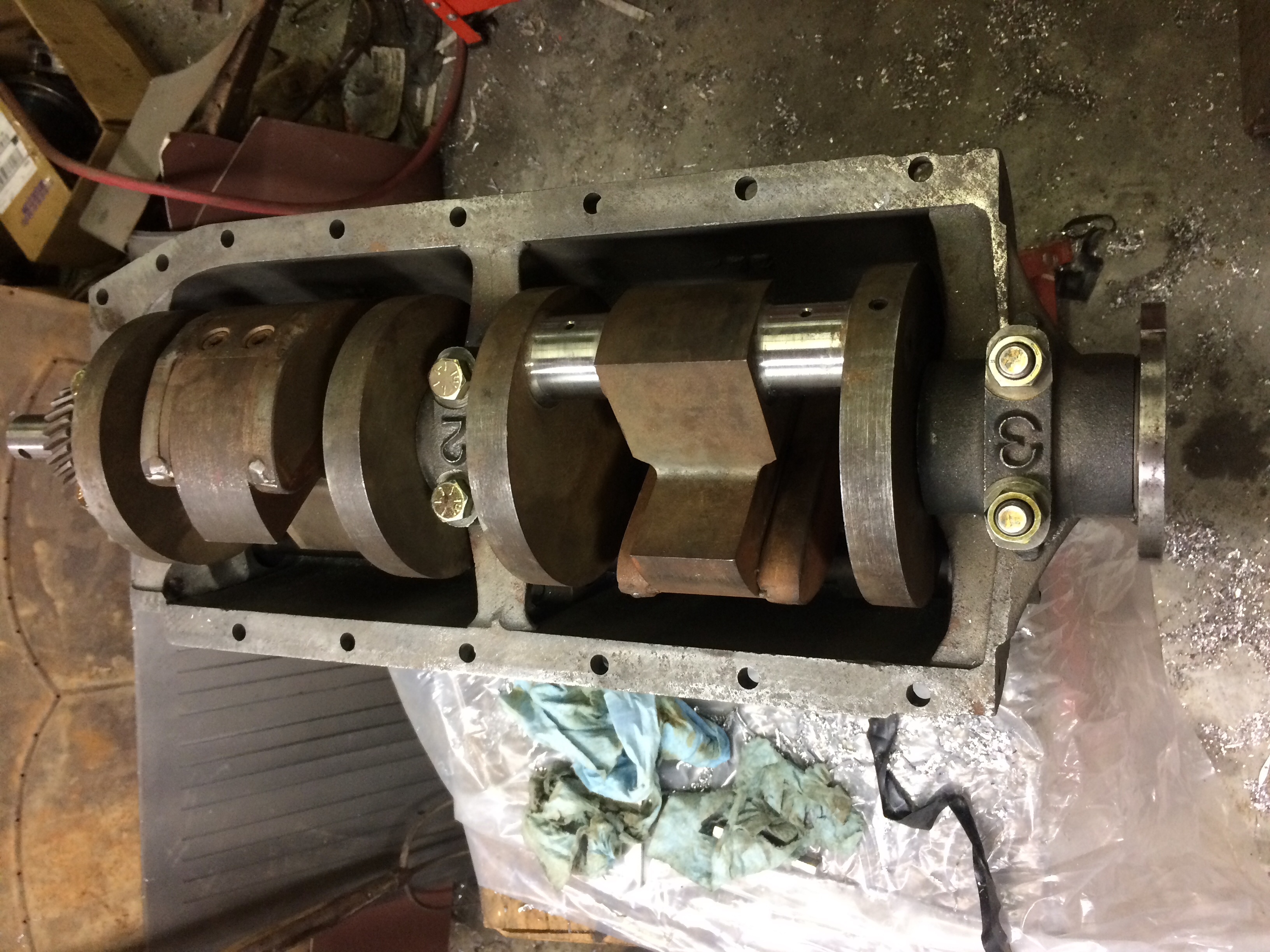

This is very unusual crank (got it from Stan Howe). Decided I should make some progress. The cam of course is unique (320 lift and 215 degrees duration). I just realized that the rods I planned to use won’t fit so I am ordering some specials from Crower. Cylinders for bored and valves are done.
Next “tricky part” is the oil lines (pressure oiled of course)
Once I have the rods, then off to the balance guy!!

What is that Crankshaft from???!!!!
My guess is was made by the Nev-R- Break company
Tim
Tim
Les Schubert
Topic author - Posts: 1364
- First Name: Les
- Last Name: Schubert
- Location: Calgary
Re: 2 up 2 down line boring done!!
Tim
My guess is it is made from a BIG chunk of round bar on a big engine lathe!! I used to have compressor crankshafts made that way (and a couple of antique car cranks too). No CNC required!

What does it weigh? (the crank)
Les Schubert
- First Name: Les
- Location: Calgary
Jeffery
Well it weighs a LOT!!
I’ll try to weigh it sometime (probably part of the balancing). Fortunately the balance guy I’m going to use is pretty smart!!
I wonder about the comments about the sound. Personally I don’t expect anything unusual!

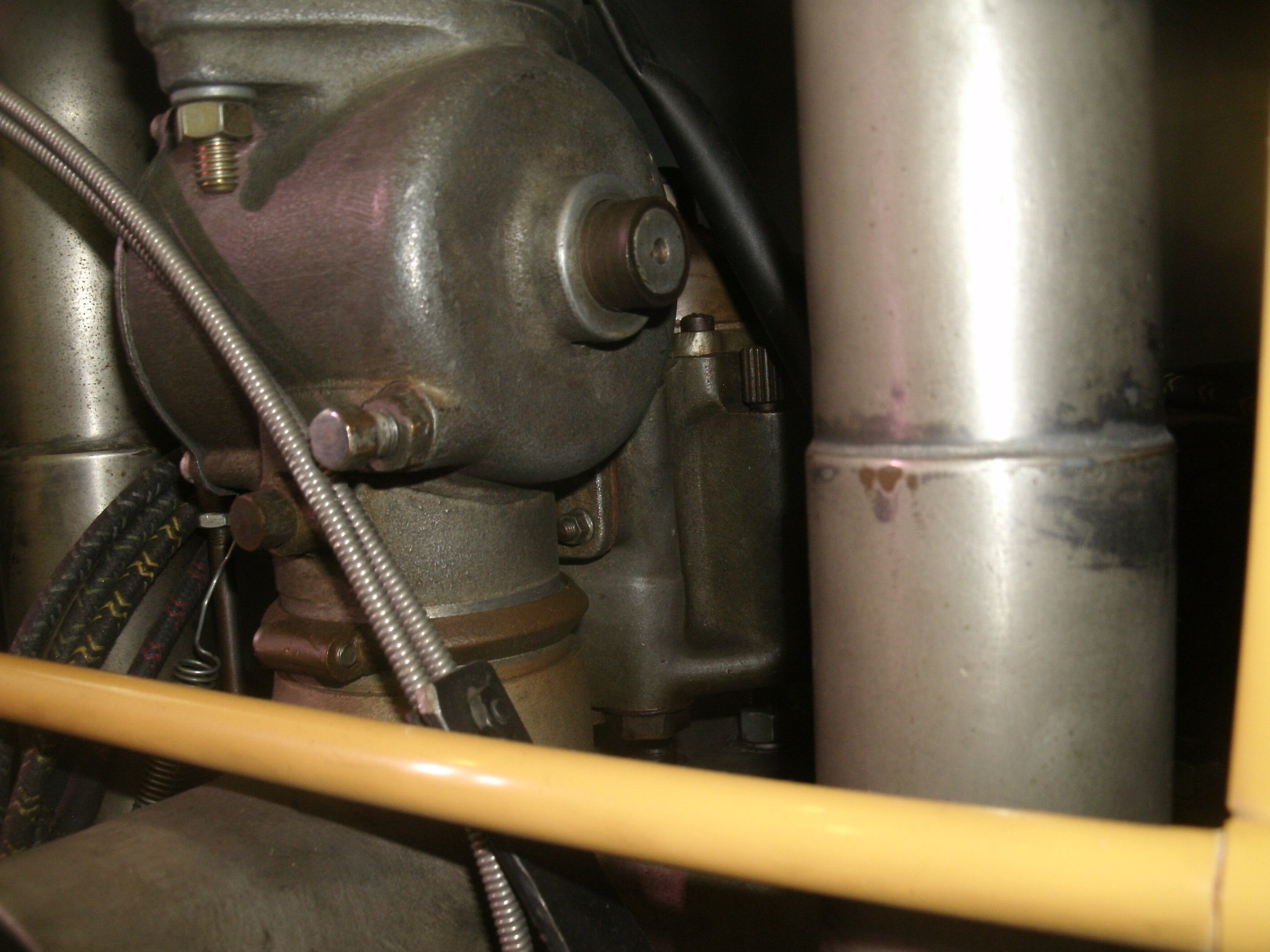

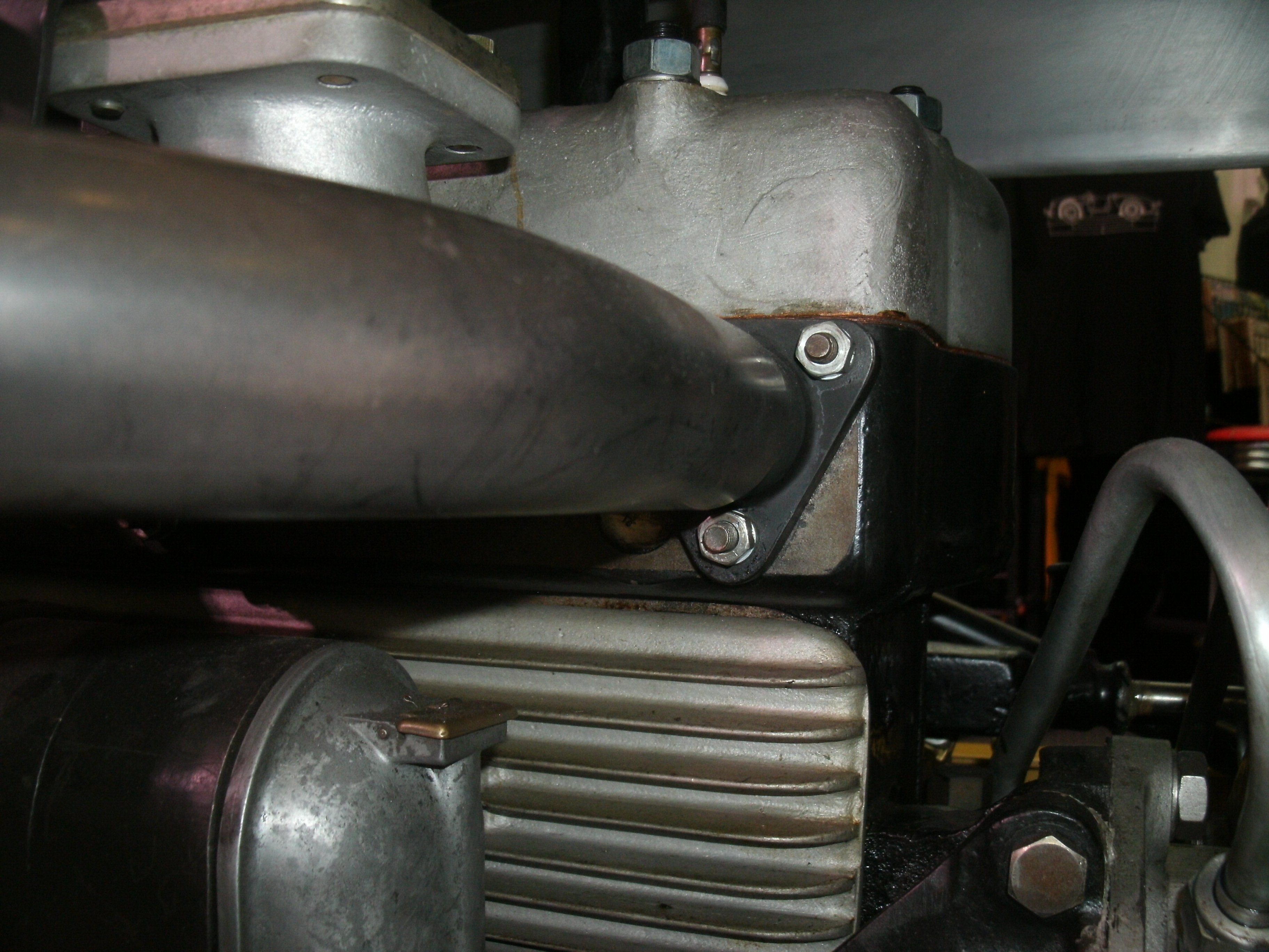

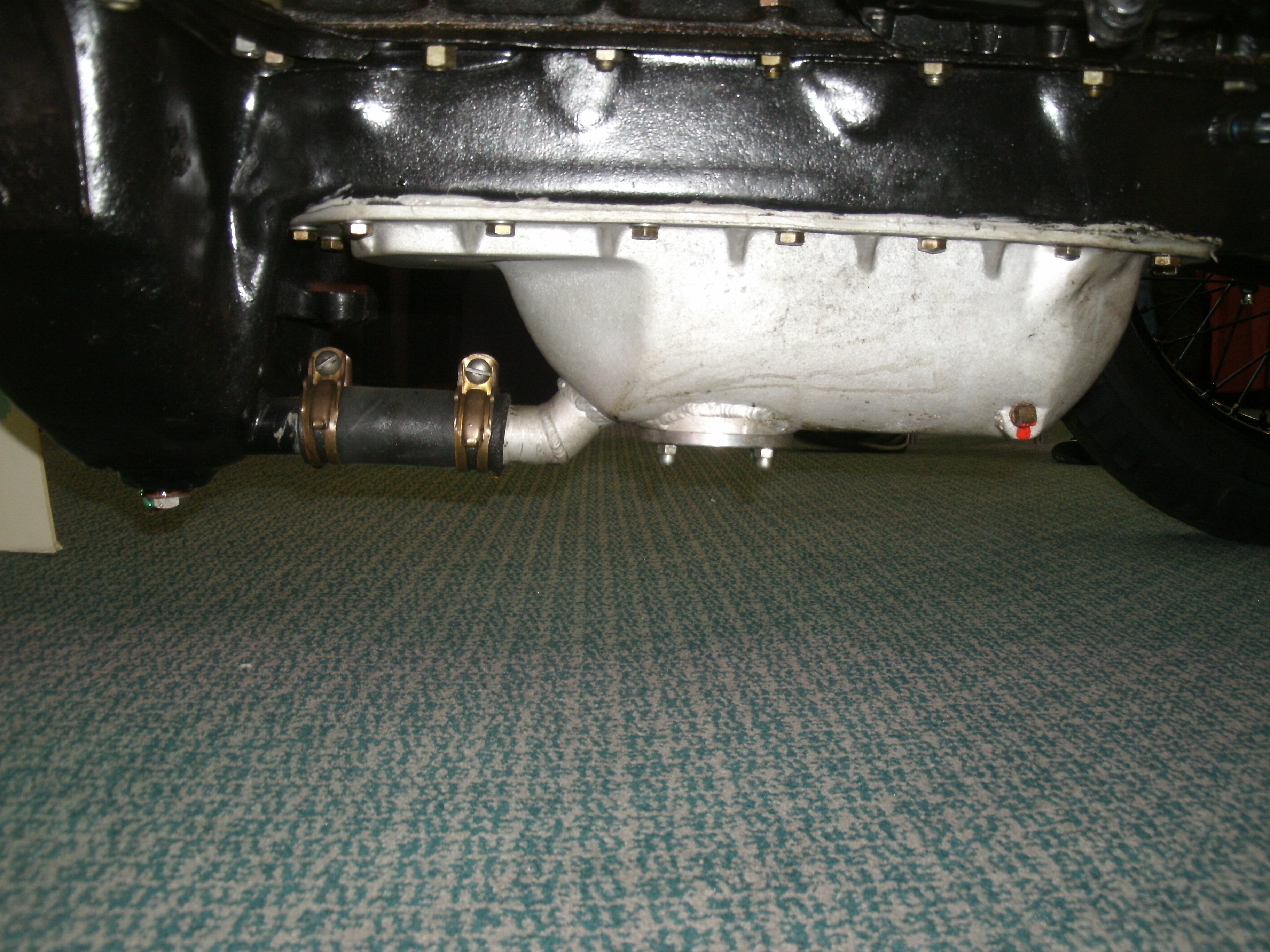

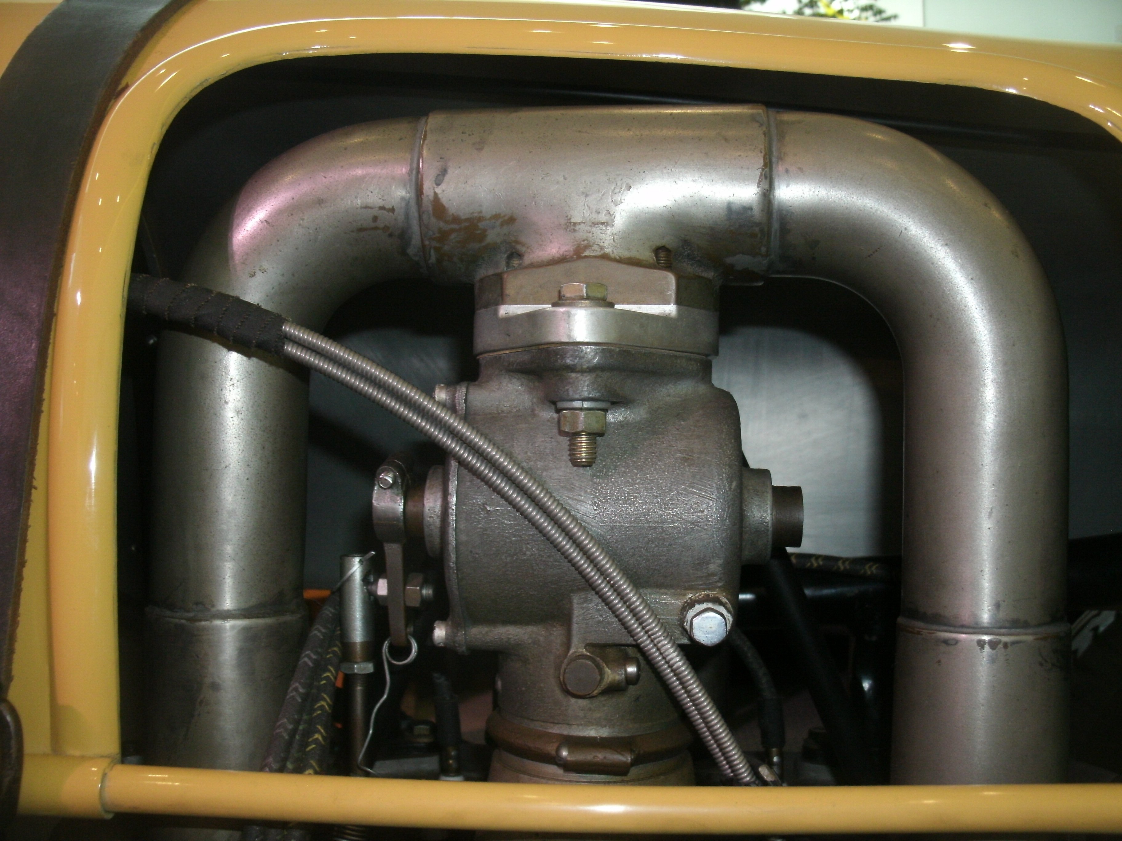

Les, I have a few more. Took me hours to dig these up.

Thank you, Big2Bird, I had not seen these pictures. Where is this car now? From what I've read, it must be pretty impressive, even today. I, for one, am waiting to see the results of Mr.Shubert's work. Thank you, Dave in Bellingham
