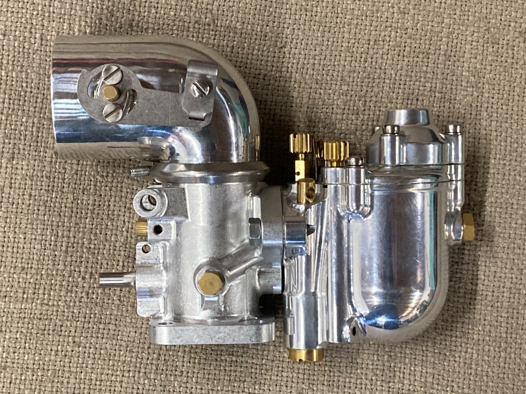

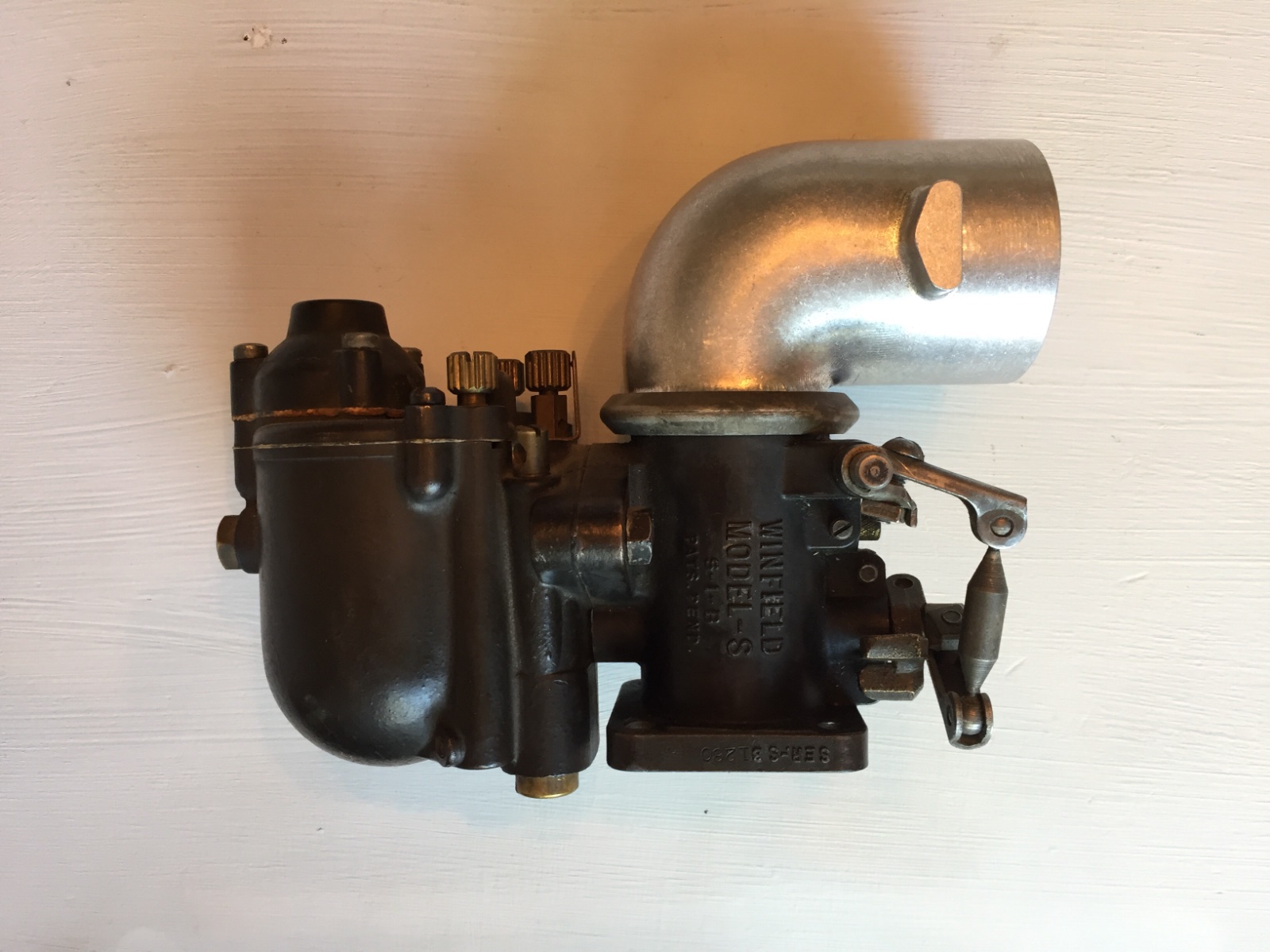

Amongst all the other projects... not sure why I felt the urge to make this...
I had a couple bad numbers along the way, so this one isn’t perfect or finished... but will correct on the next one. This one is for a size AA-B, and is just about identical to the original.
One piece at a time I’m getting closer to a complete pair of S-B downdrafts for my Akron conversion

Awesome workmanship!

Nice Kevin, well needed item!

Ed Winfield would be proud...
As for me.. I'm super impressed. Ed made some of the best performance gear to be had, and I keep thinkng if someone would have kept his dream alive in the 30's and 40's, he would be a name to fear on tracks even in this fuel-injected era...
IF you decide to make these to sell, PLEASE let us know!!!

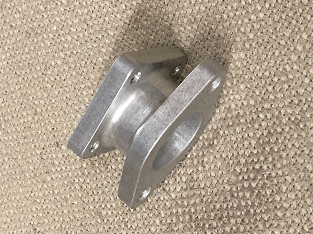

Since the bosses for the choke shaft were cut wrong anyway... I though I would just cut em off and give er a good shinin up...

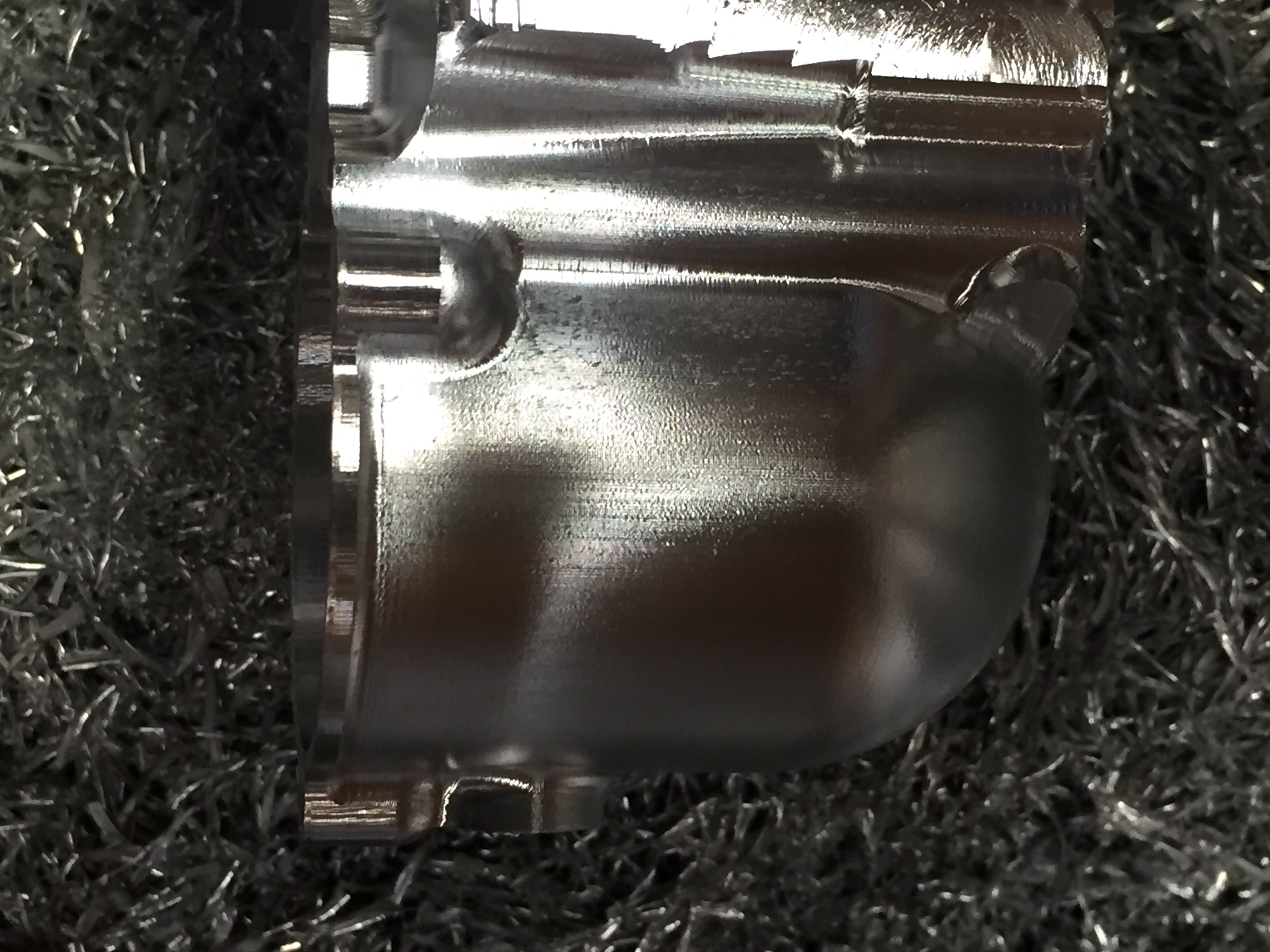

Received the tools to finish the choke elbow today. Hoping to finish the polished one... and also make a couple choke elbows complete with the butterflies this weekend
Looking forward to finishing up this project so I can move on to the V band clamp to attach the choke elbow. Thinking stainless...

Here’s one fresh off the mill... a bit of blending and it’ll be ready to run!

Well..., as the ole sayin states, try try again! Looks Great Kevin!
As I found out years ago, sometimes the wallet goes empty but the scrap metal pile grows.
Hmmmmm.
Hmmmmm.

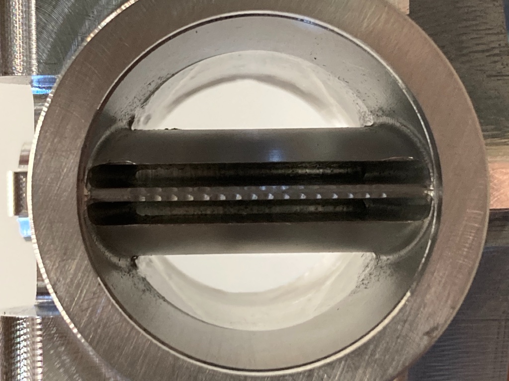

Was goin to make a few more of these this morning... but as soon as I turned on my machine there was a power glitch and I got spooked. Maybe it had somethin to do with the 100 degree heat at 10 am...?
. Only supposed to get up to 108 later...
So I decided to do something that didn’t require any electrically sensitive equipment today
Now I have a matching pair of choke horns for the pair of Winfield S-B downdrafts that will eventually fuel my Akron-Hed motor. Even tho the one horn is technically “wrong”, it’s going to work out perfectly. When a pair of Winfield’s were purchased originally, only one choke elbow was complete with butterfly
When the weather changes back to liveable... I will continue with the V band clamp to hold the choke horn onto the body, and the choke lever.

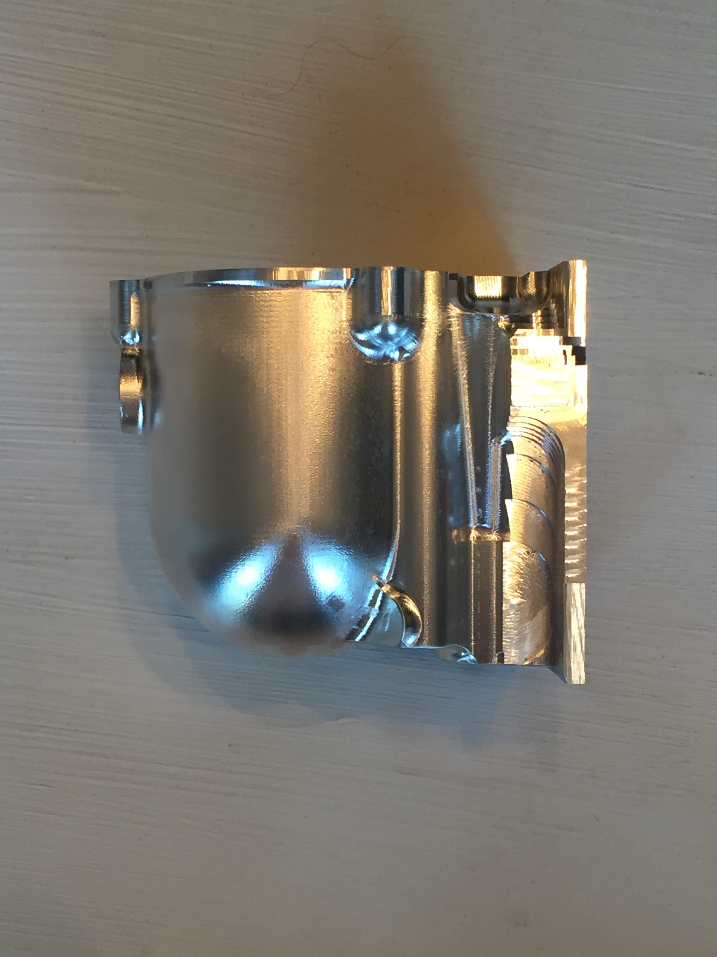

Did some more playin last nite... I haven’t got the right size material yet, so used a piece of stainless that was a bit undersized to prove the program would work, and hopefully do a fit check.
Other than the part being incomplete due to the undersized material... the program ran good, and the part fits good! Looks good too
Now just have to patiently wait for the right material to show up...!

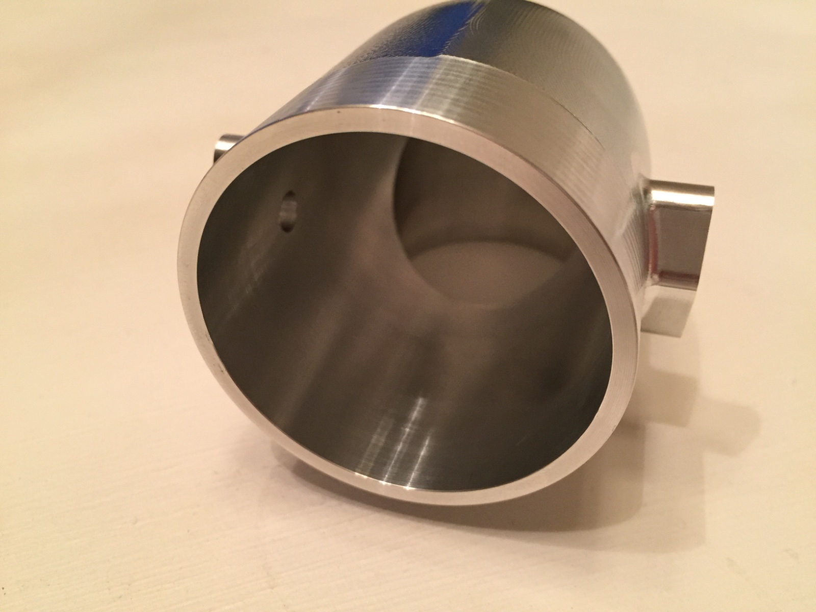

So while impatiently waiting for material... I made an aluminum V clamp to verify fit and completion. All good! Now back to “patiently” waiting...!

Norman- Kevin is making a float bowl for a model S Winfield carb. The S and SR Winfields were made after the Model M barrel valve carburetors.

Norman, the Winfield carburetors were an aftermarket accessory, and were not factory equipment on anything as far as I know. They did offer a number of carburetor sizes and manifold/adapter options to cover most production cars, and of course... performance applications.
My hope is to build a pair of carburetors from scratch, to run on the soon to be Akron-Hed equipped motor in my speedster

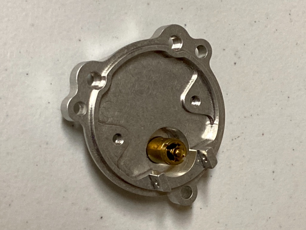

A closer look at the first operation. All the bowl cover screws and jet holes will be drilled and threaded before this operation is done. Next, the bowl ID will be held via an expanding mandrel so that I can cut the mounting flange and drill the last few holes
This darn “workin” thing is gettin in the way of progress!!

I know how y’all like progress pics...
Finally scrounged up the time to finish the first operation of the Winfield model “S” float bowl. The bowl is designed to directly interchange with the originals with the exception of the float ball. I intend to incorporate a readily available replacement float... but still have to figure that part out

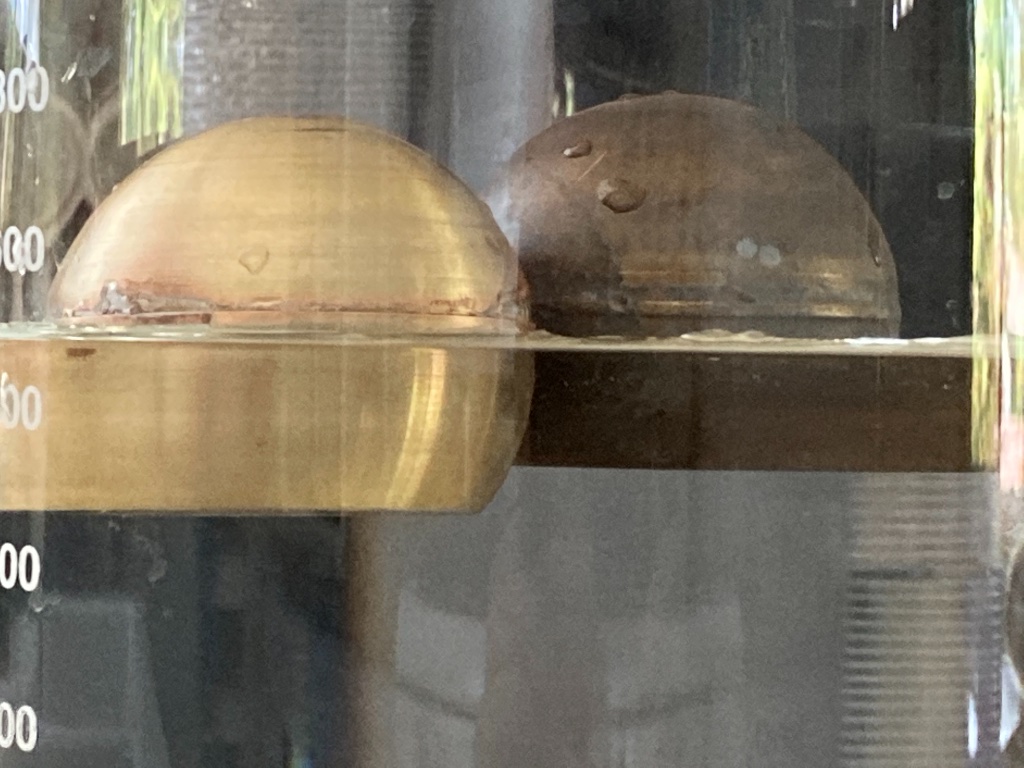

That was the original idea... but Nitrophyl is only available in 1” thick blocks, and I need a 2-1/8” sphere. I haven’t made up my mind yet, but am currently considering a readily available 2” stainless steel welded sphere. Having a special run of Nitrophyl floats is very unlikely to be cost effective. And spinning and soldering floats doesn’t sound like fun either. If the S/S float doesn’t work out, I’m thinking of laminating Nitrophyl sheets and cutting into the sphere, then riveting together with a special made rivet...

Kevin Pharis wrote: ↑Sun Nov 01, 2020 10:38 pmThat was the original idea... but Nitrophyl is only available in 1” thick blocks, and I need a 2-1/8” sphere. I haven’t made up my mind yet, but am currently considering a readily available 2” stainless steel welded sphere. Having a special run of Nitrophyl floats is very unlikely to be cost effective. And spinning and soldering floats doesn’t sound like fun either. If the S/S float doesn’t work out, I’m thinking of laminating Nitrophyl sheets and cutting into the sphere, then riveting together with a special made rivet...

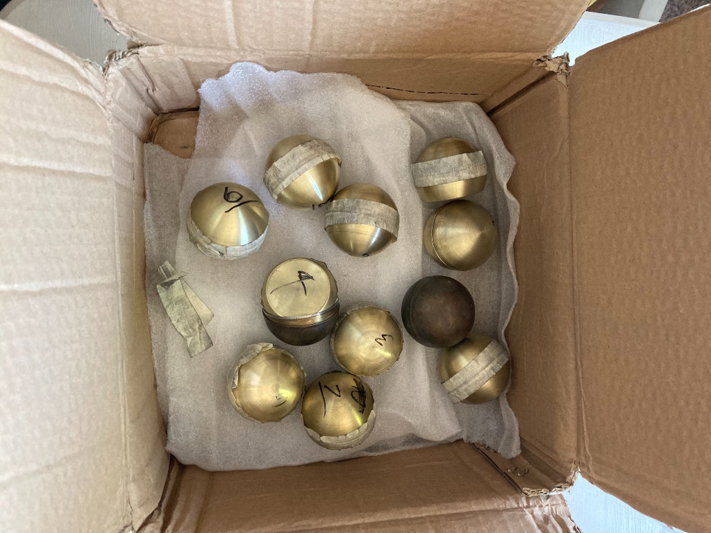

Since Jeff lives just down the steeet from me, I figured I should revisit the metal spinning discussion... met with him today, and it’s lookin promising!
Will make some tooling and see how it turns out...

You can make the $$ back if the float is correct for originals as well.Kevin Pharis wrote: ↑Tue Nov 03, 2020 9:00 pmSince Jeff lives just down the steeet from me, I figured I should revisit the metal spinning discussion... met with him today, and it’s lookin promising!
Win win.

Found some time over the weekend to finish the float bowl!

The first float sample pieces are here! They all look and fit good. The material thicknesses all seem to be right, and so I’m confident they’ll float right too. Maybe I’ll try some soldering this weekend...?

Kevin, I have a SR that the float sank on, I found round stainless floats about the right size but I'm wondering why the flat area on the Winfield floats?
Kevin Pharis
Topic author - Posts: 1654
- First Name: Kevin
- Last Name: Pharis
- Location: Sacramento CA
Re: Playin in the shop today...
Incorporating the readily available 2” stainless steel ball float was my original plan. Turns out the buoyancy is wrong compared to the original brass floats, and was going to require a great deal of modification to the float lever. Also, being 1/8” undersize I was concerned with sloshing of the fuel as the ball float acts as a baffle.
The correct float for an SR is spherical, but has a large flat on the bottom, as the addition of the accelerator pump takes up space in the bottom of the float bowl. The S float is a true sphere. Both model floats are pictured above

On My 6V, it uses a cylinder shape float with a center guide. I used a stromberg float while I repaired mine. It was close but no cigar. Love what you are doing Kevin. jw
Kevin Pharis
- First Name: Kevin
- Last Name: Pharis
At first look it would seem like “floating is floating”. But turns out the buoyancy of a carb float is a delicate balance. Until this project I never fully grasped the required precision of setting the fuel level. We are always told to measure the gap between the float and lid to set... but rarely consider that the float must be of a specific weight and displacement for it all to work as designed.
Nice job saving your V/H float John!

While I wait for floats...
Have been working on the float bowl cover. It’s designed to take a modern Viton tipped needle and seat, and will otherwise interchange with an original float bowl cover. All that’s left to do now, is to crimp the bore to retain the detent balls.

Finally feel like I’m making some real progress today...
Still have to finish the external surfaces on 2 sides... but that seems like the easy part!

It’s been slow goin since my last post... but goin better now that I have got the first operation of the throttle barrel refined down to 7 hours! And I won’t mention the few bad parts that have happened along the way
But while the mill runs the throttle barrels I have started the lathe work making some of the small hardware pieces. So far I’ve got stainless steel bowl to barrel studs, brass float bowl level plugs, and brass idle port plugs. I also ordered custom ground piloted reamers for the throttle shaft bushings, and have been getting staged to make the throttle plates and shafts before finishing the OD of the throttle barrels.
I did get distracted making a couple S-A to Model A intake manifold adapters in the meantime too...

Today was throttle plate day. It started out kinda iffy this morning... but smoothed out nicely enough to yield a couple of nice fitting throttle plates
Here we are in the lathe gettin spherical

Thanks for the kind words fellas. This project definitely started out as playin... but now it’s turned into more of an obsession! My wife even started calling it “the other woman”. Still fun tho!
The throttle plates were a challenge figuring out how to make. They are basically a modified ball bearing... so where do you start, and what do you hold on to. I finally figured how I could cut all the important surfaces in one operation, then finish the spherical OD in the lathe.
There is no shortage of challenges with this project! But I am looking forward to the throttle plates and barrels being finished, cuz all that will be left is the internal brass. Seems easy by comparison...

After almost 7 months of waiting, I was finally able to guilt the metal spinner into producing my float halves... looks like I will be doing my own metal spinning in the future
. Out of the 20 or so pieces, I was able to find 2 pieces that could be assembled into a dimensionally correct part.
I’m going to have to make another batch tho, as the weights of the components isn’t quite right... and so my new float doesn’t quite float like it should
It’s all good tho, as now I have lots of parts to practice soldering with

Contrary to popular belief... there has been Winfield progress lately...
My first batch of float bowl covers had a minor design oversight... so did the second... but that’s all behind me now with the third edition! So I made up a batch and have been working toward complete subassemblies of cover, detent balls, Viton tipped needle and seat, and float lever.
The float bowl covers were a minor dimensional adjustment from the previous design, a new detent ball crimping fixture was made, and all went smoothly and assembled well. Just had to decide what to do for the float levers...
I went back and forth for a bit... and eventually decided to machine them from solid brass bar. So while I was at it, I made a few I also came across an adjustment screw cover, and decided to make a few

So far, all the components will interchange with the original Winfield carbs, and I have been making extras for this reason. I’m not really the “long term plan” kinda guy... but nobody else is producing parts for these carbs, and it’s not getting any easier to find good originals.ThreePedalTapDancer wrote: ↑Fri Jul 16, 2021 7:57 amBeautiful. Are you going to be offering assembled units for sale?
If nothing else, I’m proud to be able to offer some technical knowledge and repair parts to people interested in these iconic carbs.

Well... had a bout with the C19 over the last several weeks, causing a complete and total stop to all progress on all fronts. I’m back on my feet now, and trying to catch up to all my irons in the fire.
Turns out there is a rush on Buffalo wheel parts this year, and so I will be distracted for at least the next few months. Not all carb progress will halt tho... I will still be pushing the metal spinner to complete the float balls, and also workin to have the Akron-Hed intake manifold cast using 3D printed sand. We’ll see what other carb projects slip into the mix along the way...

Made some exiting progress this evening! After what feels like forever, I was able to get a throttle barrel back in the mill to take the final finishing cuts. Still have a few holes to drill, but cosmetically this part is essentially finished
I hope to have at least 1 of these throttle barrels cleaned up and ready to run by the end of the weekend...
Looks good Kevin. You were actually able to get this detail on Millzilla? That’s a lot of table to move around.

Sure did Andy. Turns out Millzilla can do nice work if I talk to it real nice

Success!!!
Well... success on this test part with bad internal features. Will have to get out in the shop early tomorrow to make up one that is good all over!

When I play in my shop, I only seem to make a mess and leave oil spots on the floor. Impressive skills you have to be able to build a carburetor.

I hate to say it, but it’s almost time to bolt it to a motor and see if it works. I’m thinking the odds are pretty good it will.

The punch list is pretty short now... need to drill one last idle passage in the throttle barrel and it’s DUN! Need to build and install 2 brass plugs to plug off main jet passages in float bowl and it’s DUN! Only parts left are the float ball and the throttle shaft stop lever, and I will begin to test with originals rather than wait for these to finish.
The head needs some minor machine work still... need to machine down the valve guide bosses to clear the inside of the T valve springs, and make thick shims to get the springs to the proper compressed height when installed. Also facing off the head bolt bosses to the same heights so that the rocker sub plate doesn’t twist when the head bolts are installed.
In all reality, only minor work left to do!

Been a busy few months since my last update... Buffalo wheels, Buffalo rear hubs, Buffalo hex caps, Winfield choke horns, Winfield V band clamps, Winfield fuel inlets, and I’m sure I’m forgetting something...
But at least the shelf will be stocked for a bit

Testing on my dads touring today. Swapped out his original S-B for my new one, and running pretty darn sweet!! He’s goin to hook up the linkage and we’ll do some road testing later

The running carb was shipped to a specialist a couple weeks ago... and it turns out today was it’s turn on the flow bench. There will be an official report next week, but the preliminary report this afternoon was really good! The guru likes the design, and compares it to a “Fish” performance carburetor produced in the 40’s - 50’s.
I was surprised when he told me that this seemingly little carb flows an amazing 153 cfm!!! That makes this carb similar in size to a Stromberg 97!
