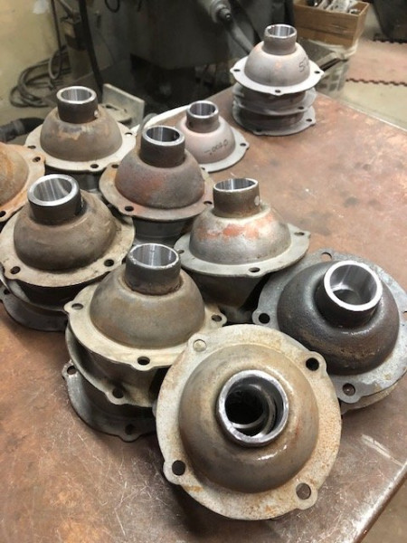

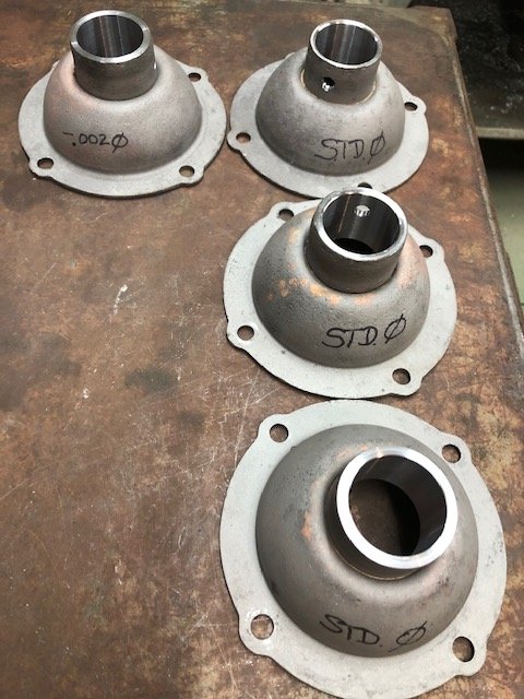

I will start the topic out ... in addition to voting ,I re-babbitted 39 model T ball caps ( 4th.mains) ... i will be working on building up inventory in hopes of a prosperous year in 2021 ... with hopes that our lives will return to a pre-plandemic routine and we can again enjoy our lives and cars ...always an optimist ...Gene French
- Posts: 4694
Re: What have you done to your T this November
Great! These will help save crankshafts and also keep oil where it should be.

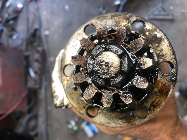

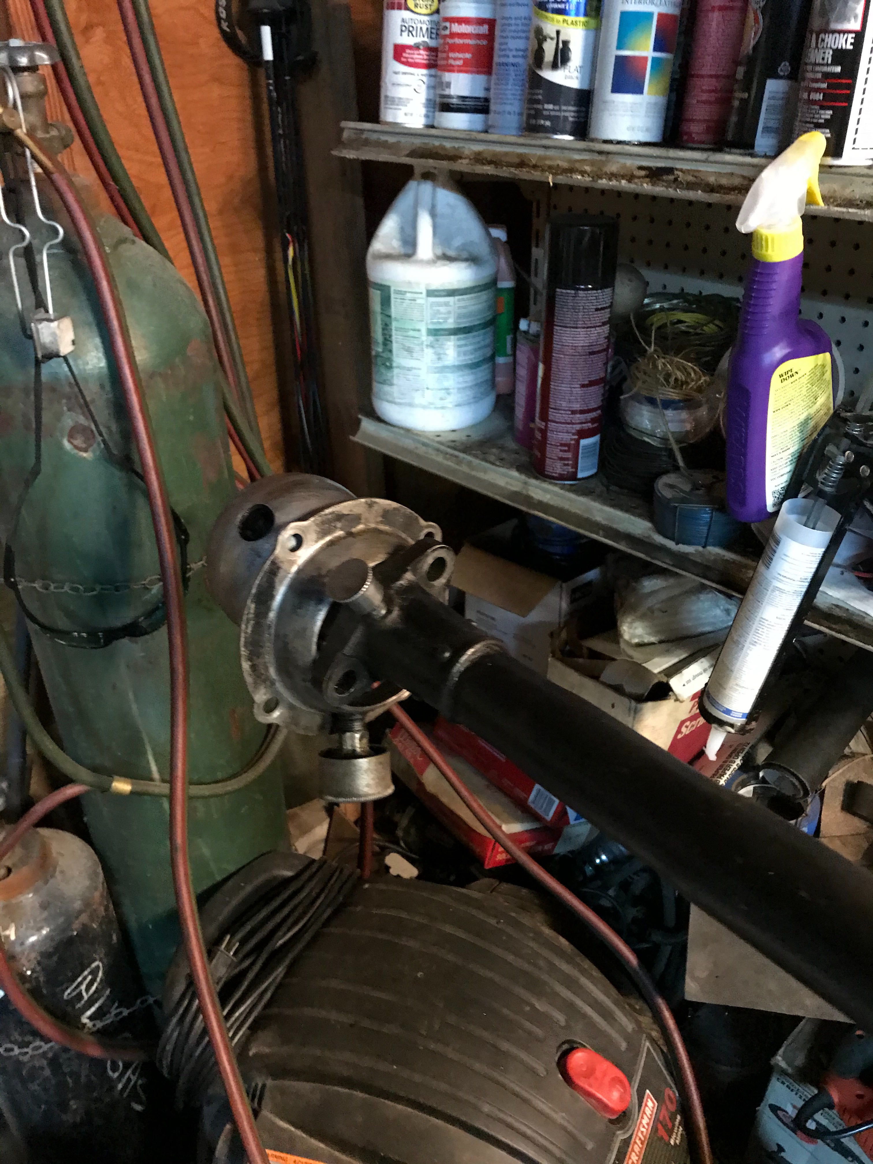

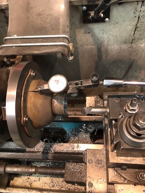

My friend Doug and I, unpinned the U-joint, drove out the old driveshaft bushing on my ‘24 Touring, and replaced it with a new brass one.
Luckily no reaming needed, but did need a little facing.
After reinstalling the U-joint, everything looks great as far as clearances and backlash.
Now ready for final assembly.

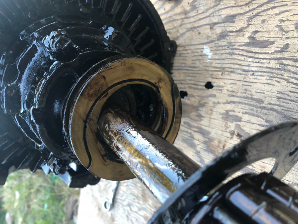

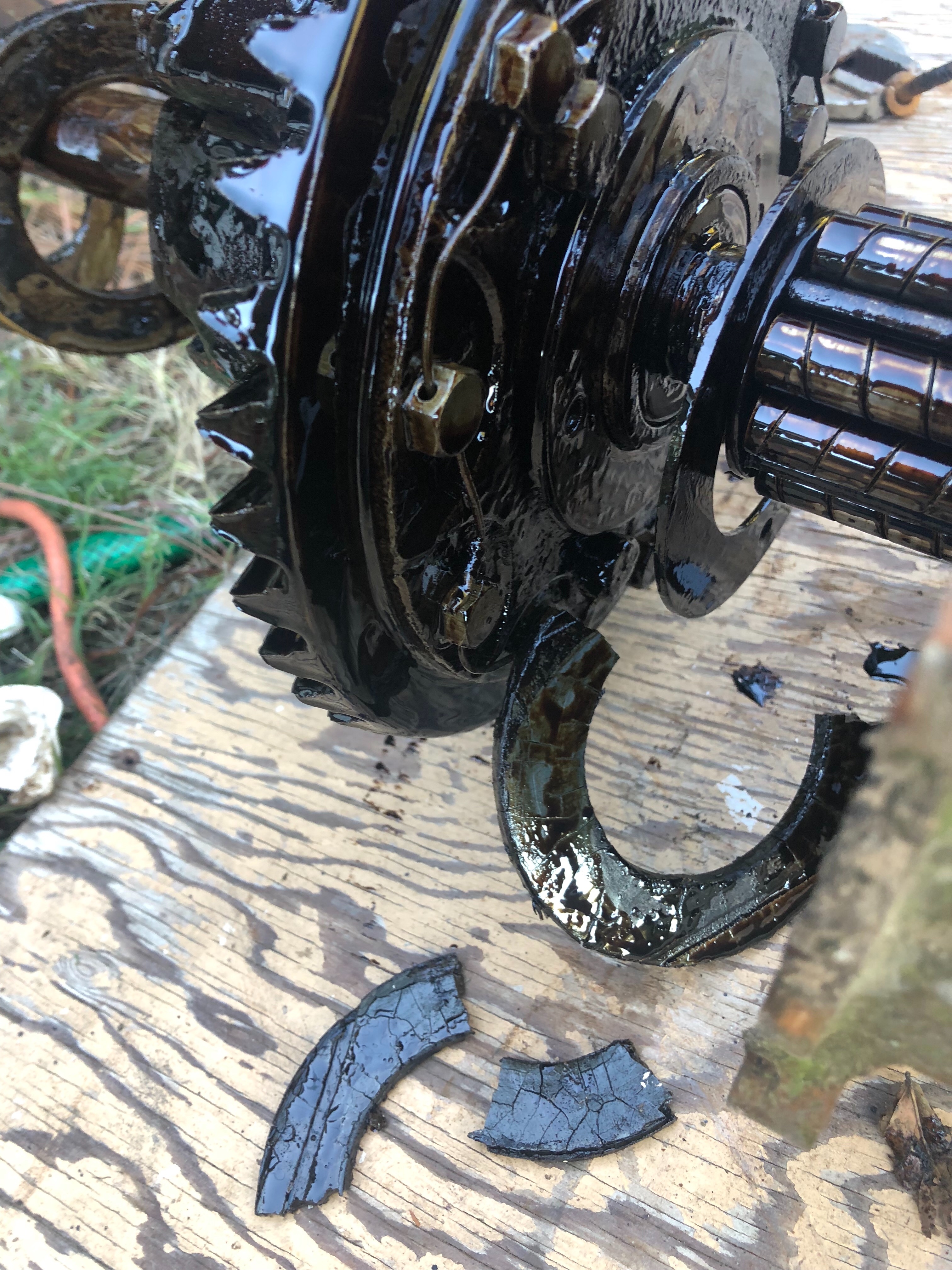

I took this rear end apart today and found one brass washer and one babbitt.

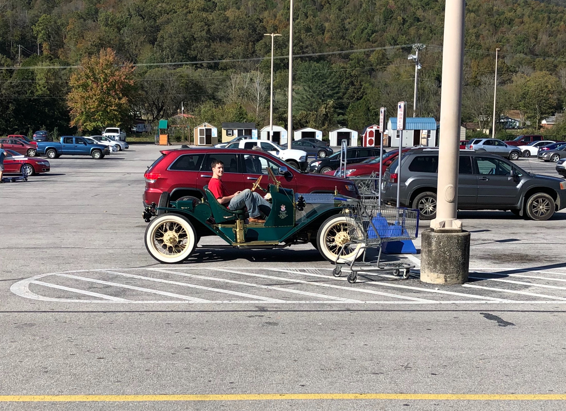

Pizza Delivering! And training our pit-bull to stay in the car..., "Stay Boy"!

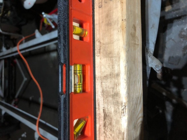

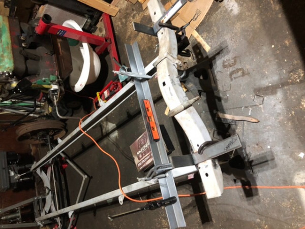

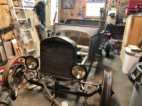

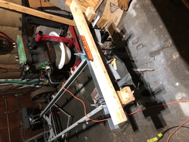

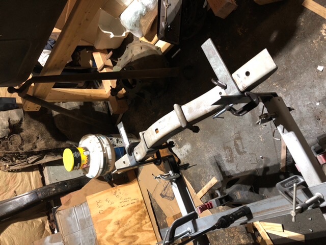

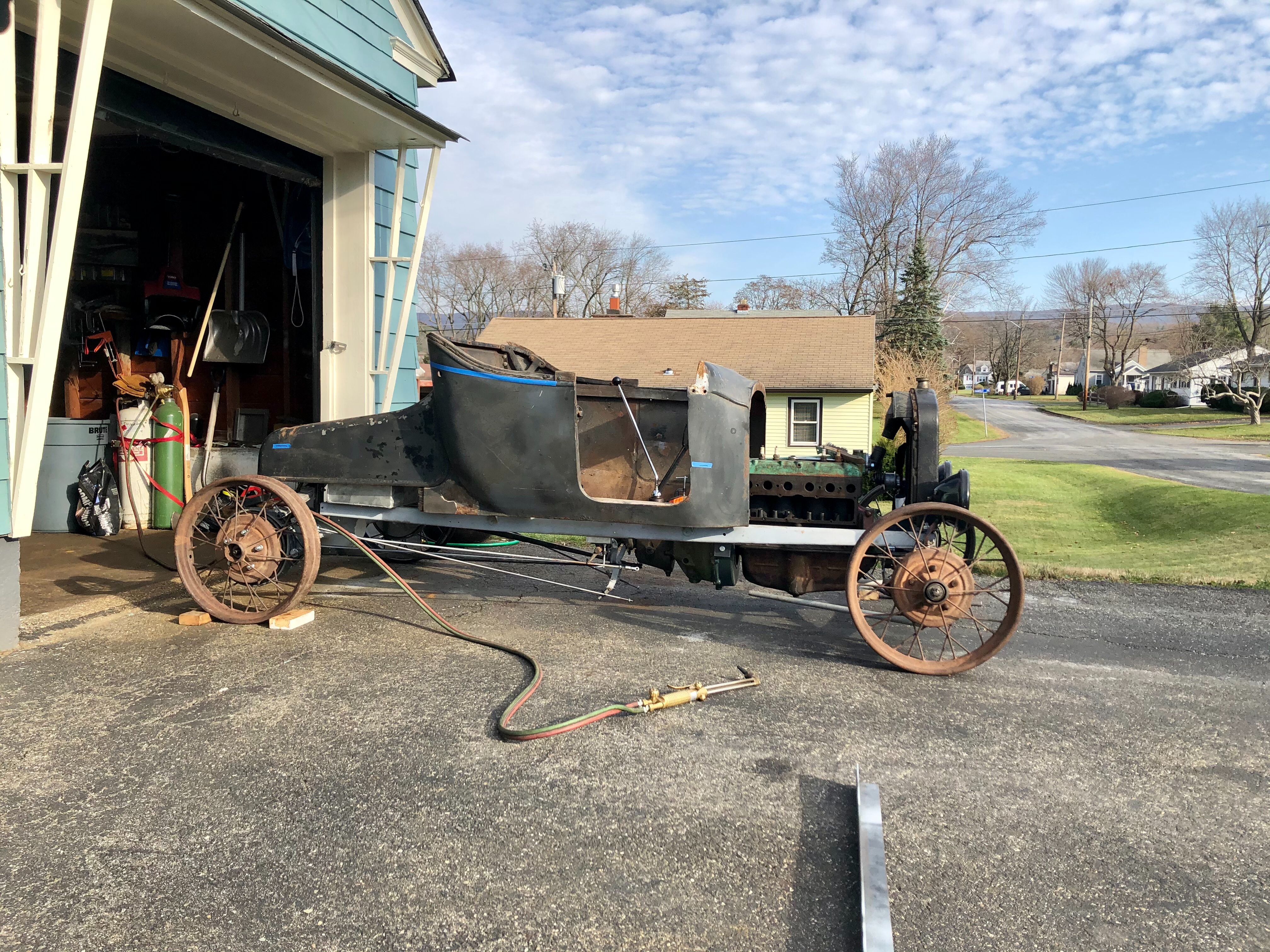

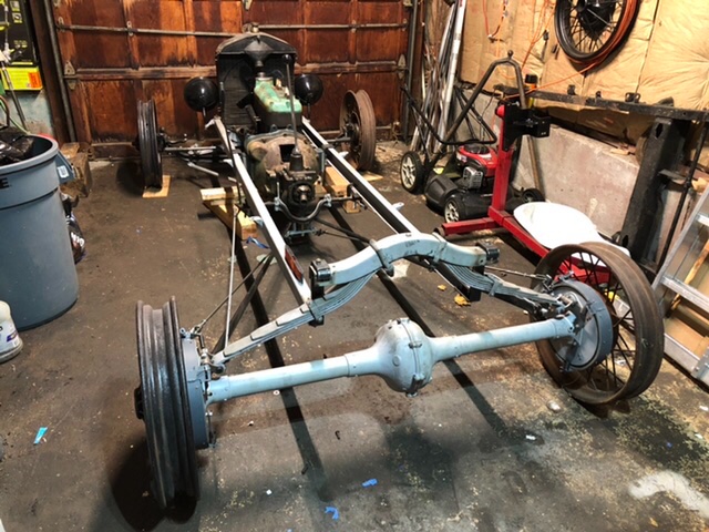

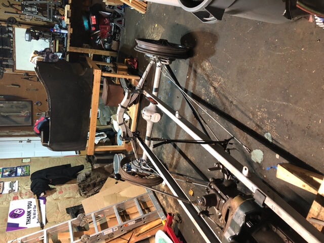

Made some frame modifications. Trying to keep this 1930 period correct.
- Posts: 5616
- First Name: Henry
- Last Name: Lee
Looking good David! Thats the way my Dad made them on our Speedsters!

Thanks hank, even though my t roadster has that unorthodox engine choice, still every part will be pre 31. There’s are growing group of us building cars like this in the western ma, New York, Vermont, and New Hampshire area. It’s fun!

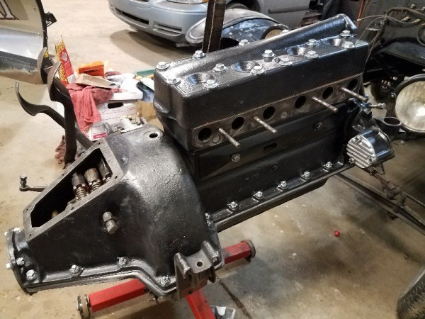

I didn't do it all in November but am able to see the light at the end of the tunnel in the last few days. Thanks to Gene French and his equipment I have been able to re-babbit three sets of rods and one block and set of caps. I had to re-pour one bearing three times to get it right and redid some of the rods several times. Line boring went better than expected and the '26 engine is going back together now. I told Gene on the phone that there were a hundred ways to go wrong and I had discovered about two thirds of them. It is exciting and rewarding to see the engine taking shape after all these years. Looks so nice I ordered glyptal and will paint the inside of the block prior to final assembly. Two more Model T engines to go! Many thanks Gene, you are a credit to the hobby.

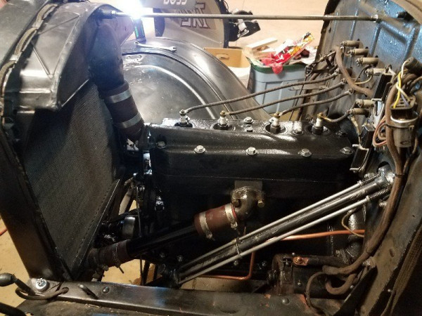

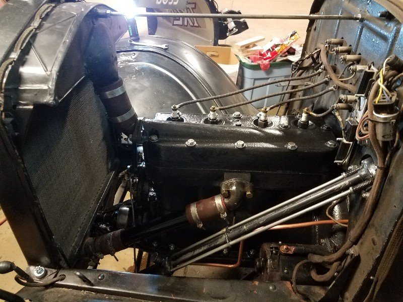

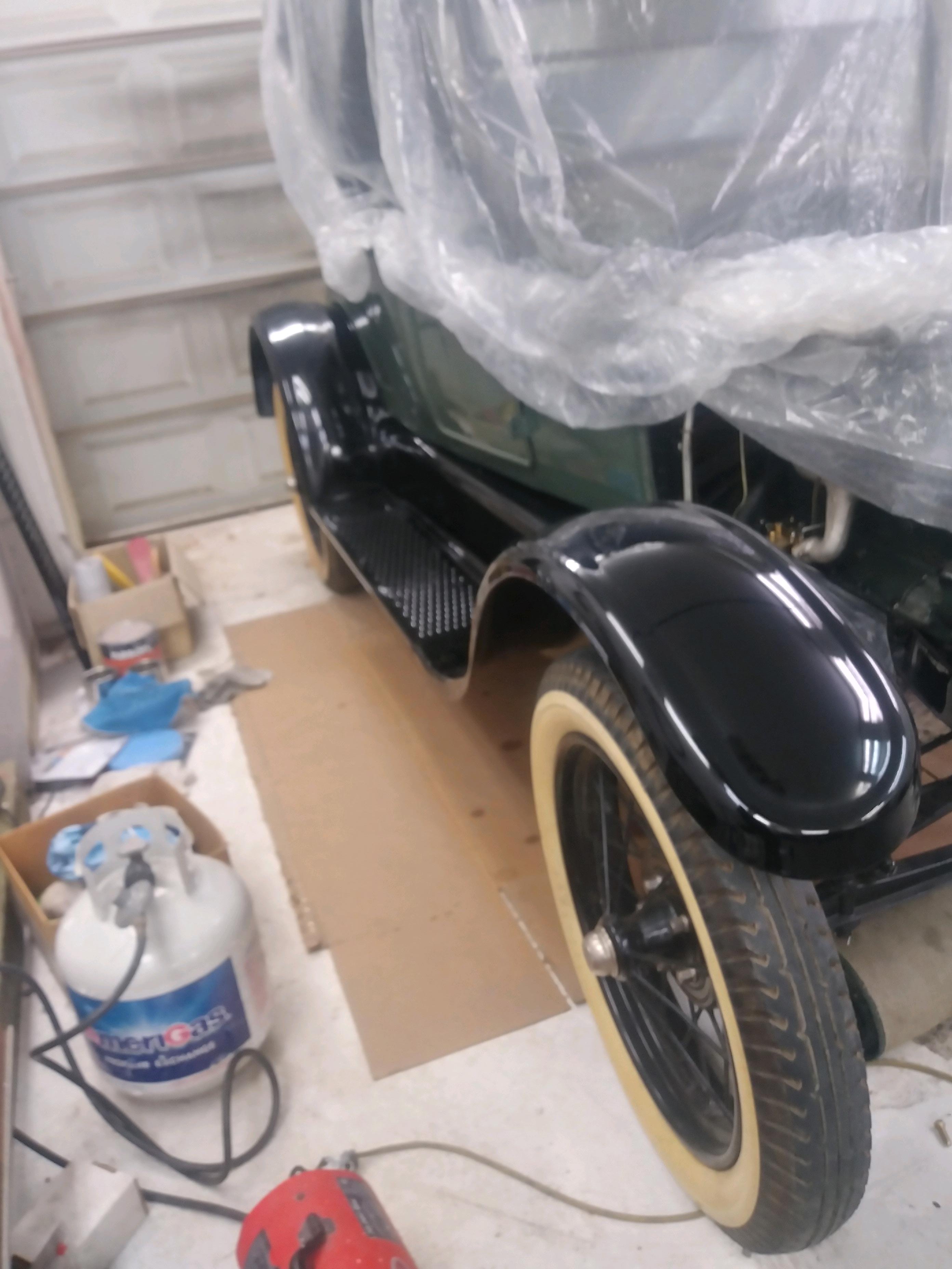

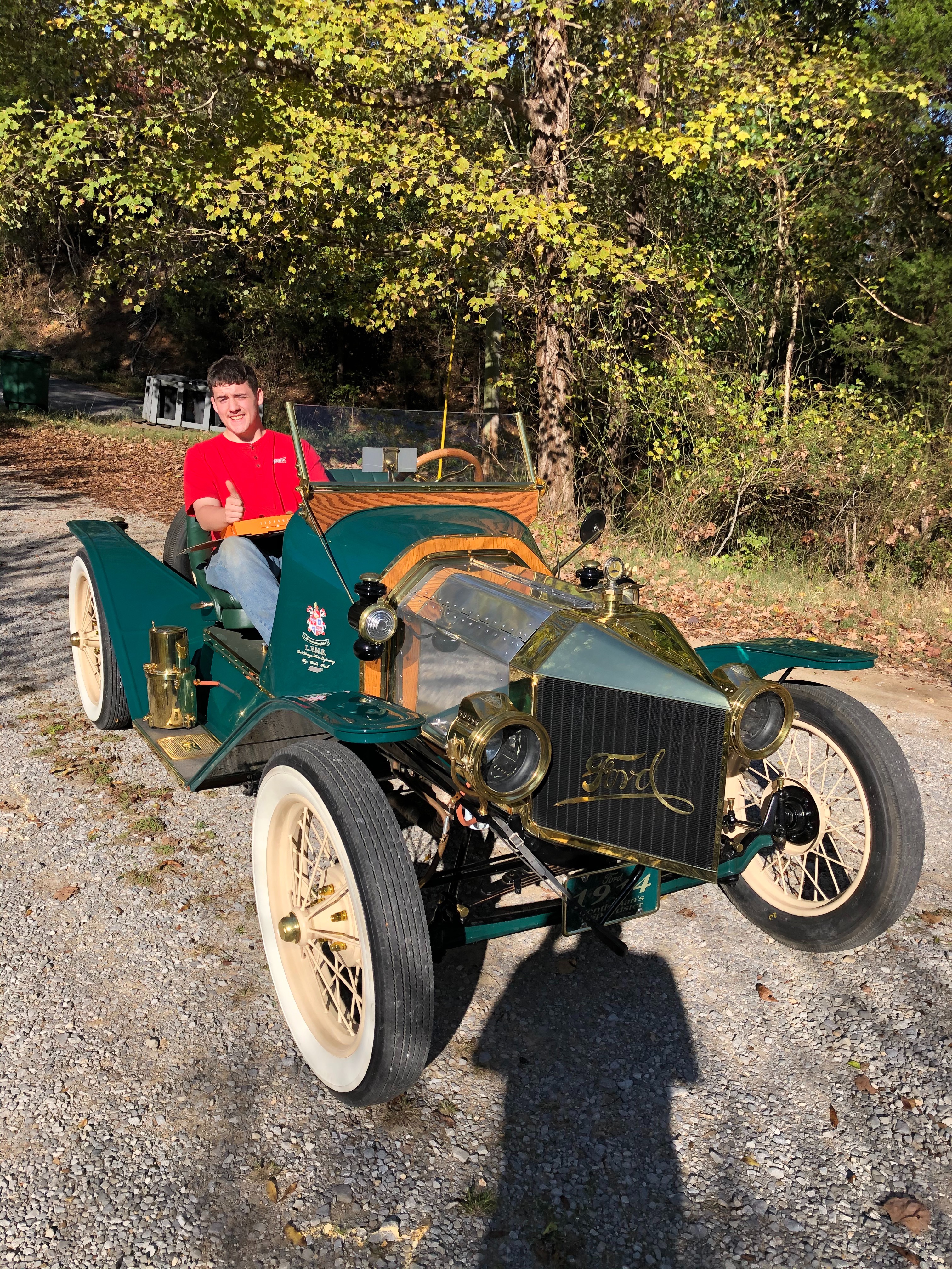

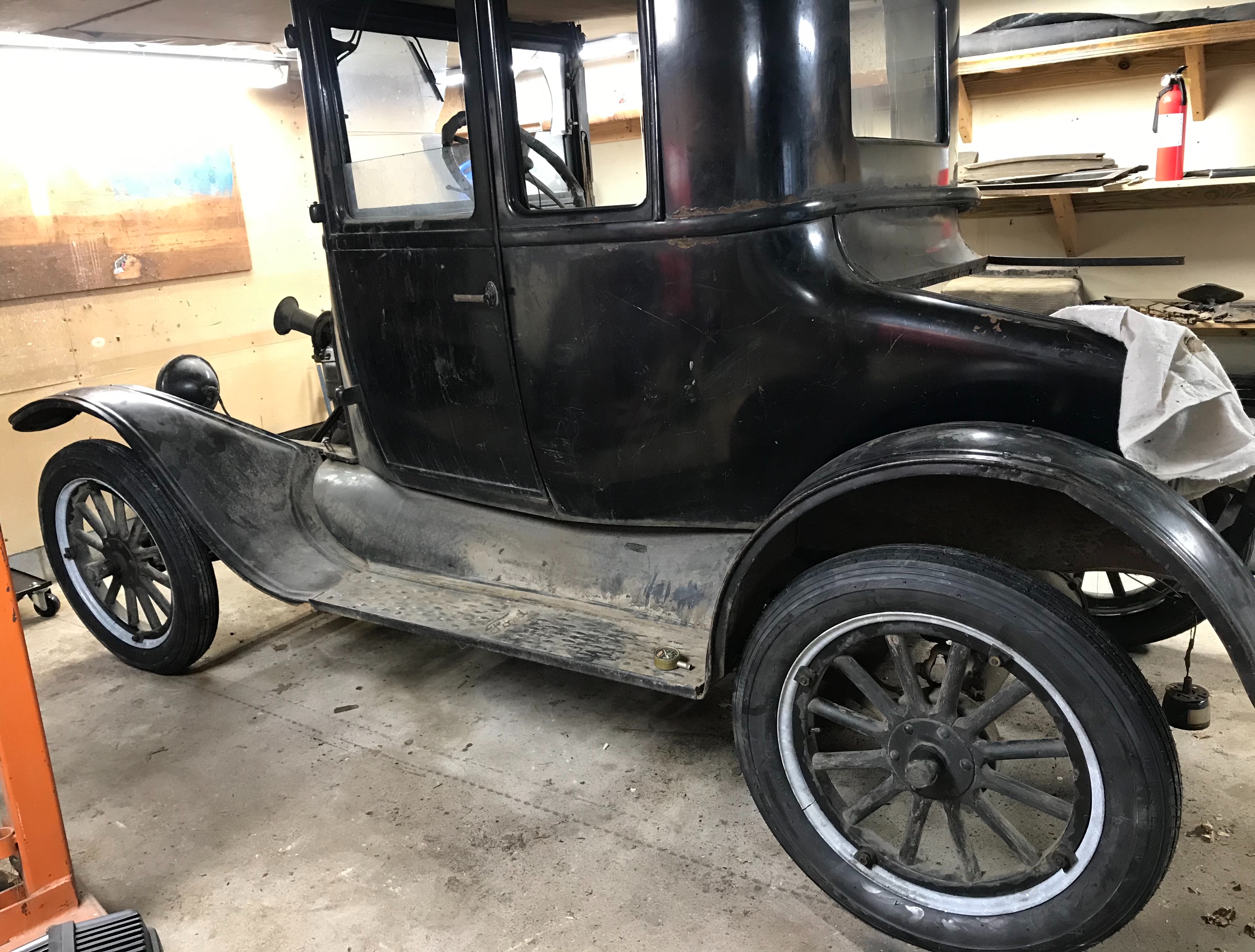

After three years i finally got my 24 Fordor back together and it started on the first push on the starter button, on mag i had to adjust my new U&J carb from Stan Howe, it killed every bug in a square mile from the smoke. I took it to storage and put the popcorn truck in the garage for finishing, my friend Tom built the did all the woodwork, i have pictures on my phone but haven't transferred them yet.

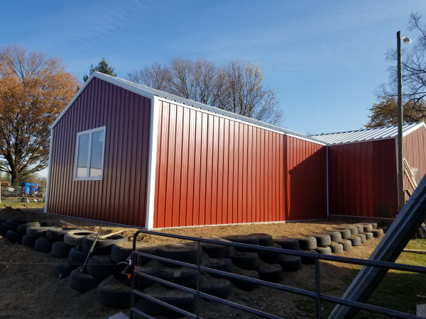

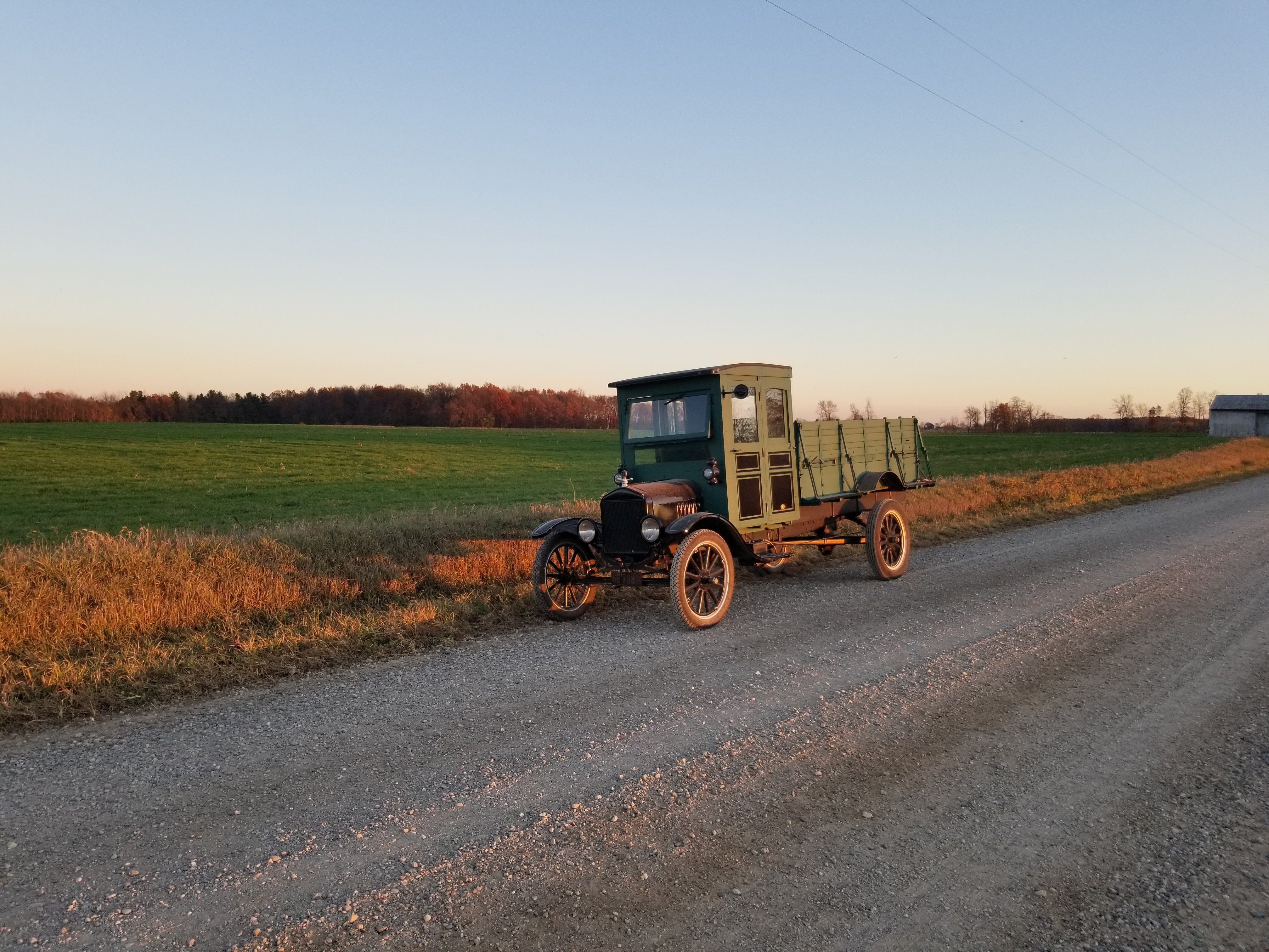

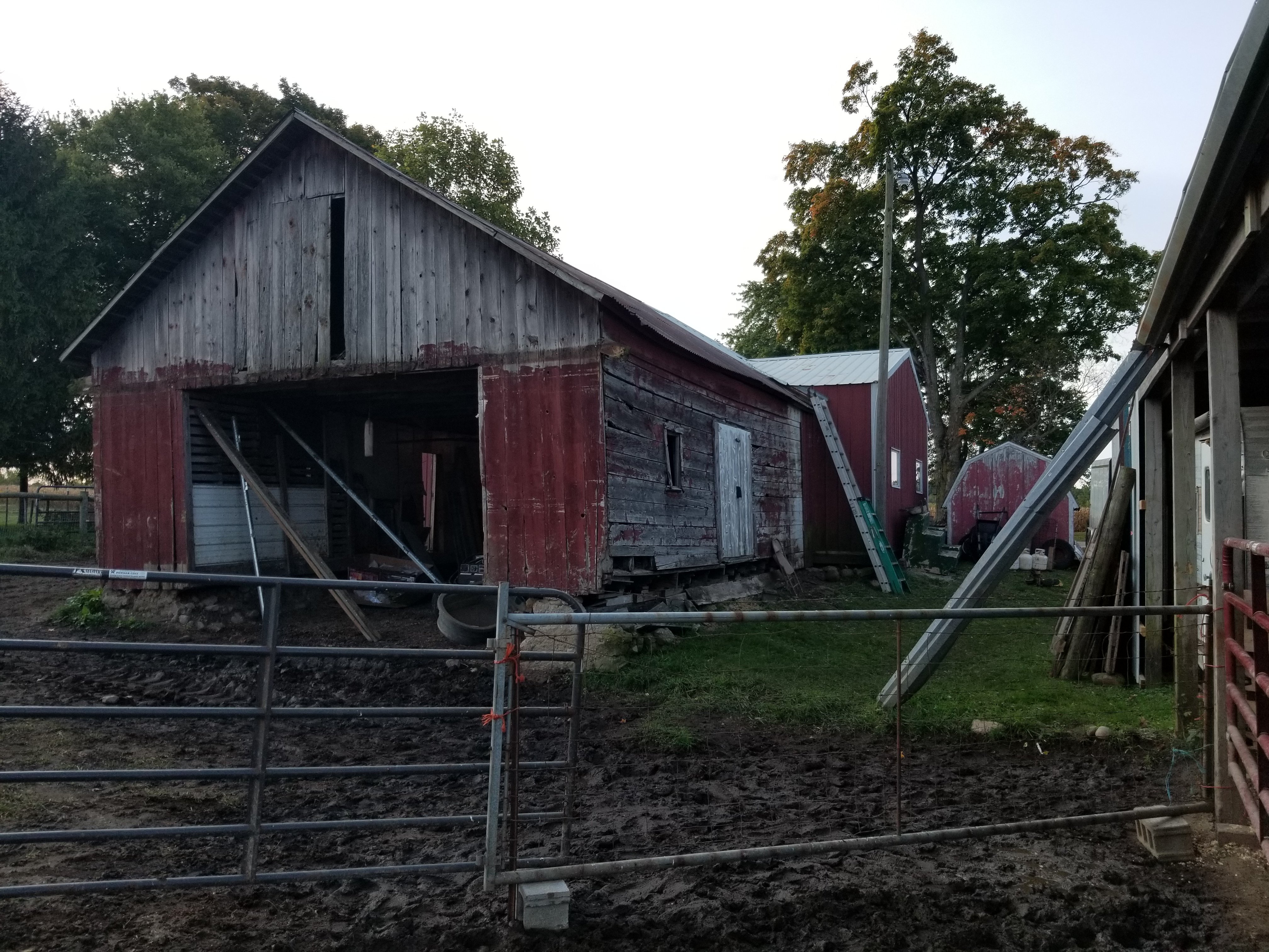

After spending the last month turning this
Into this

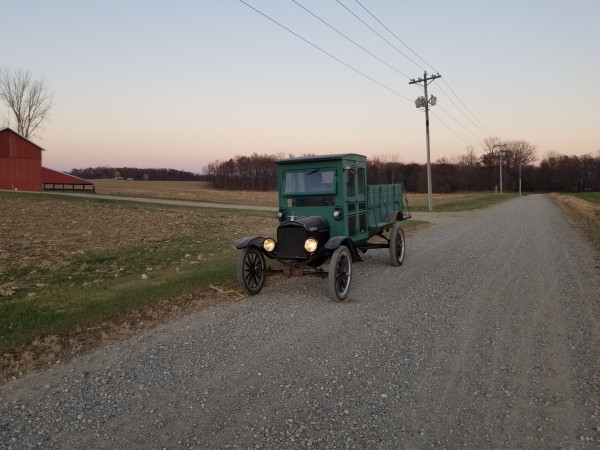

For my new insulated and heated shop, I took the TT for a drive this evening. It has been over a month since I drove one of them. The 75 degree weather and the fact I finished sealing the new shop for the weather led to a relaxing drive through the countryside.

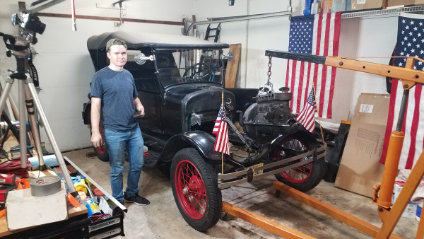

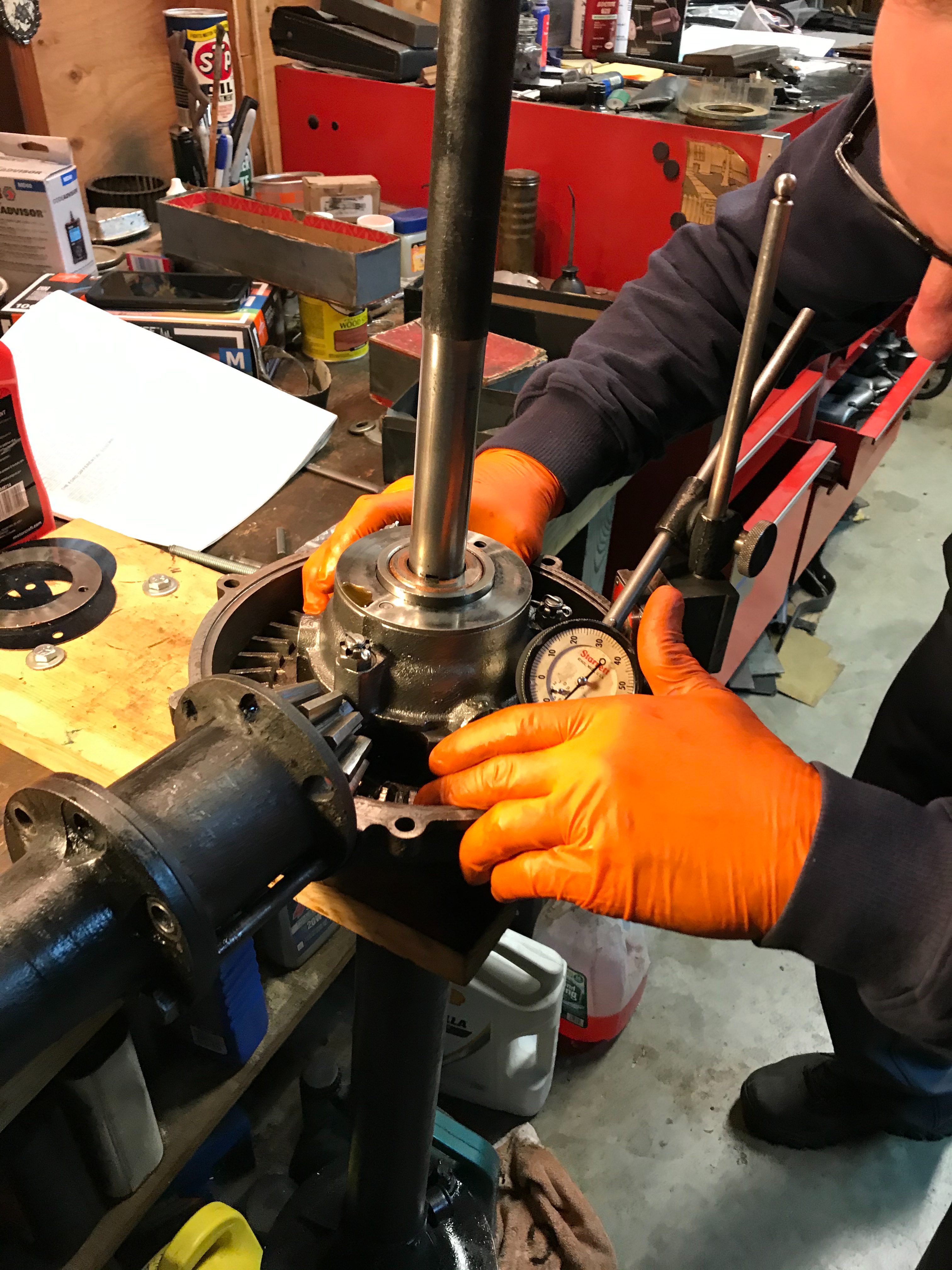

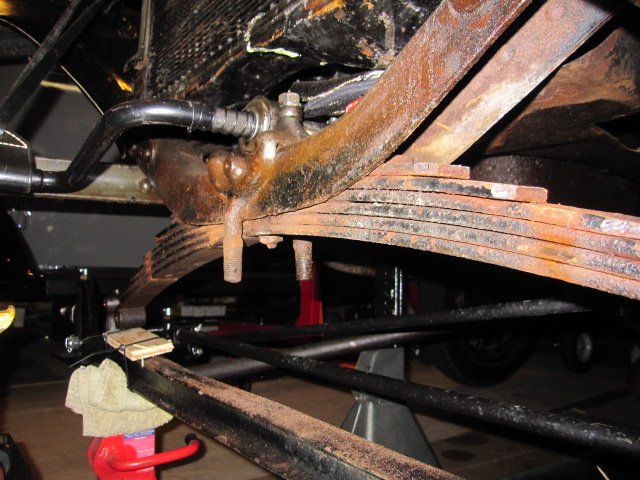

I just spent much of my weekend with Mark Eyre. He coached me through the significant mechanical upgrades needed on my '13 Touring. I got the body bolted back down and the windshield and rear fenders back on it while Mark reattached the lamps and helped me align the doors. While we were at it I changed the rotten interior pieces for a better (used) interior. While I don't have a top on it the car has come a long way.

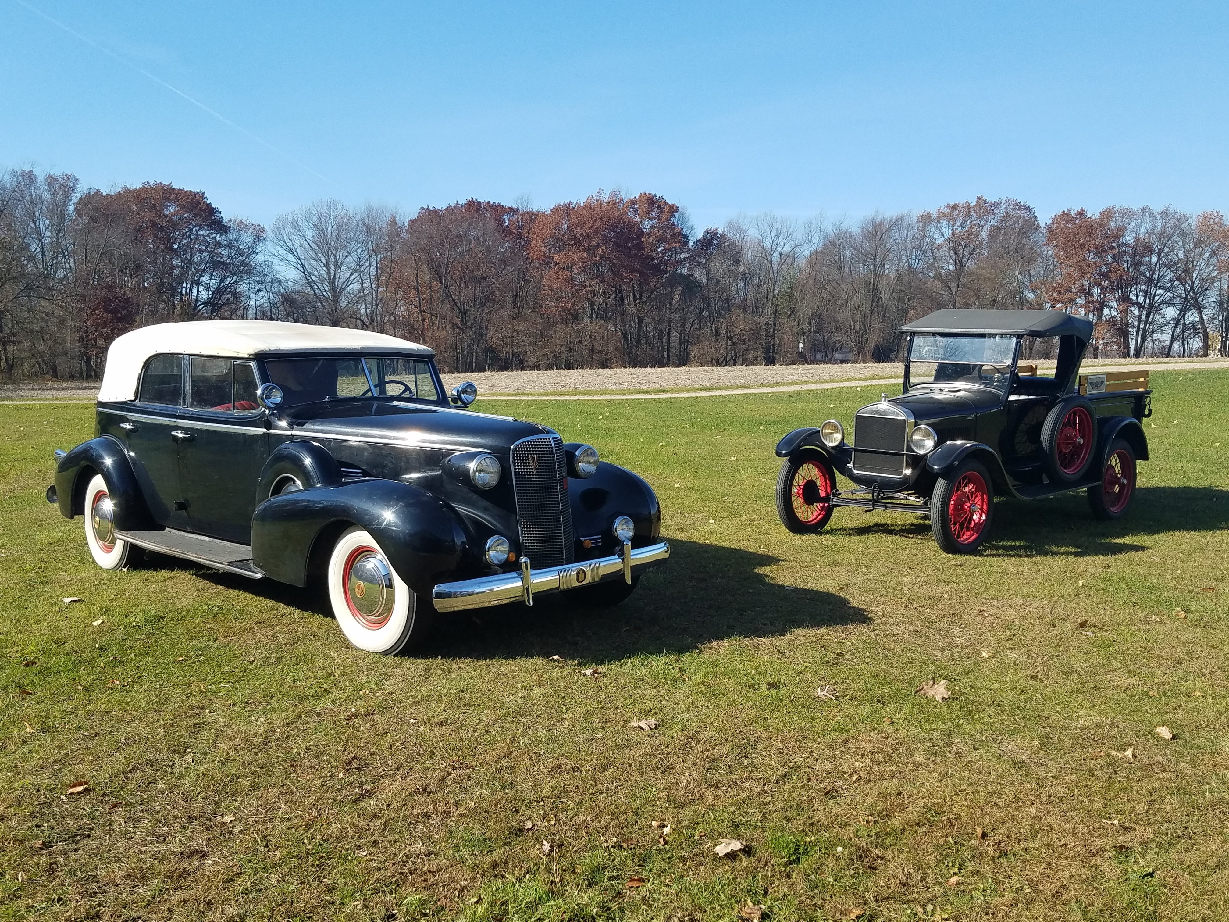

We also had a mini two car auto show in Mark's front yard over the weekend.

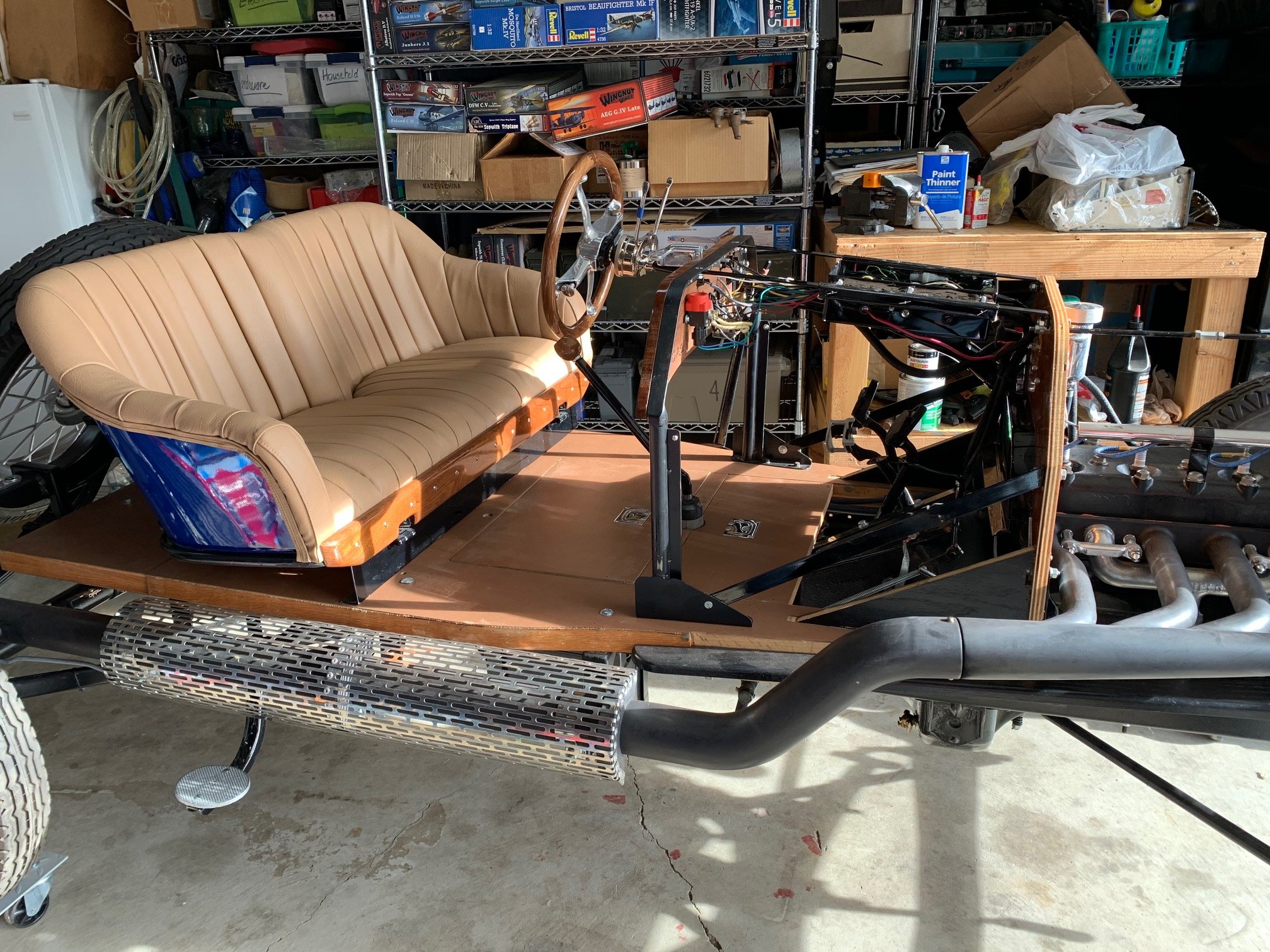

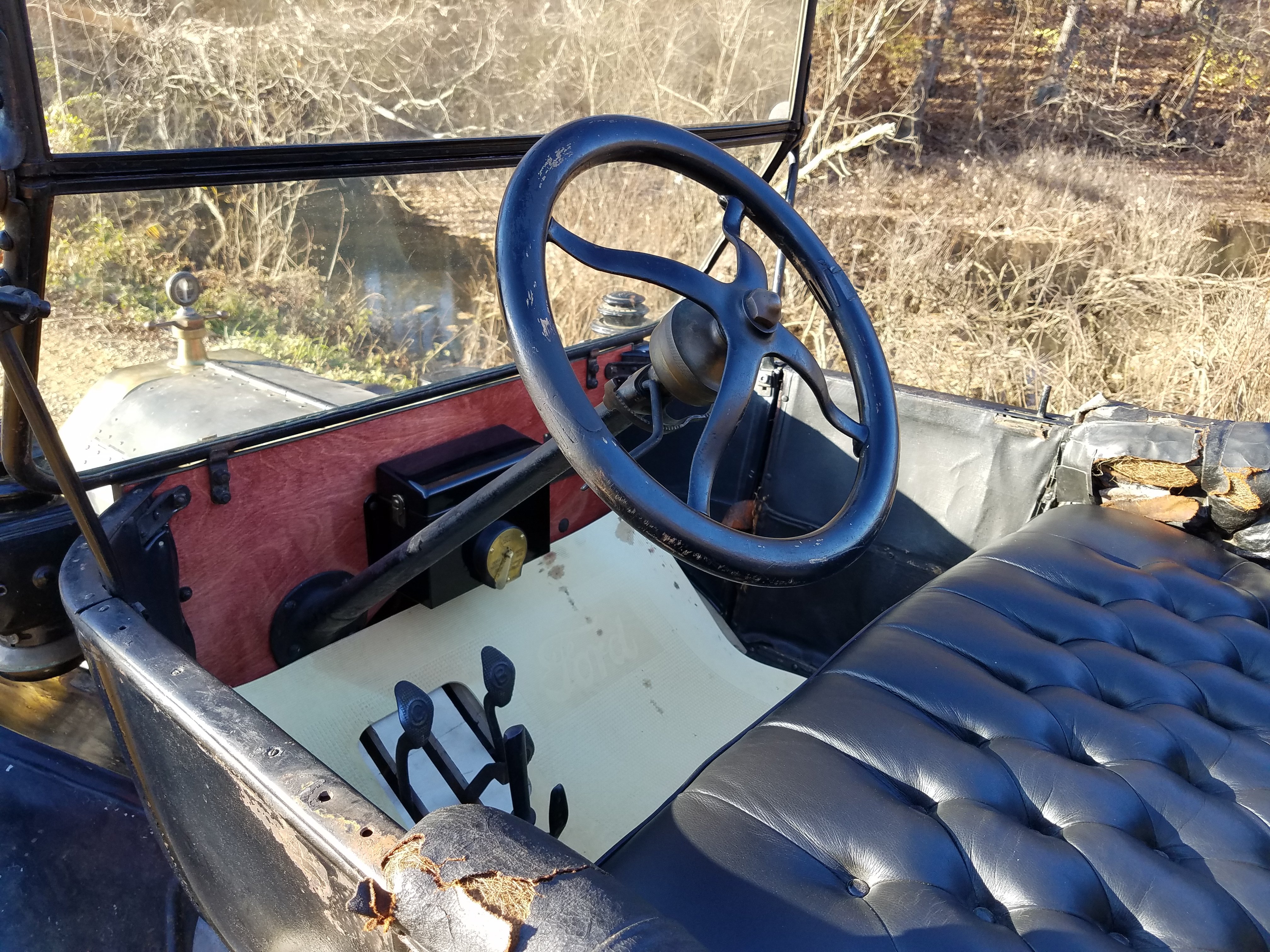

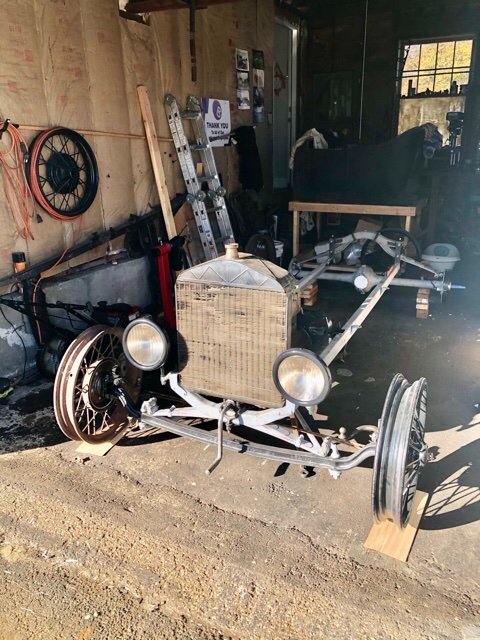

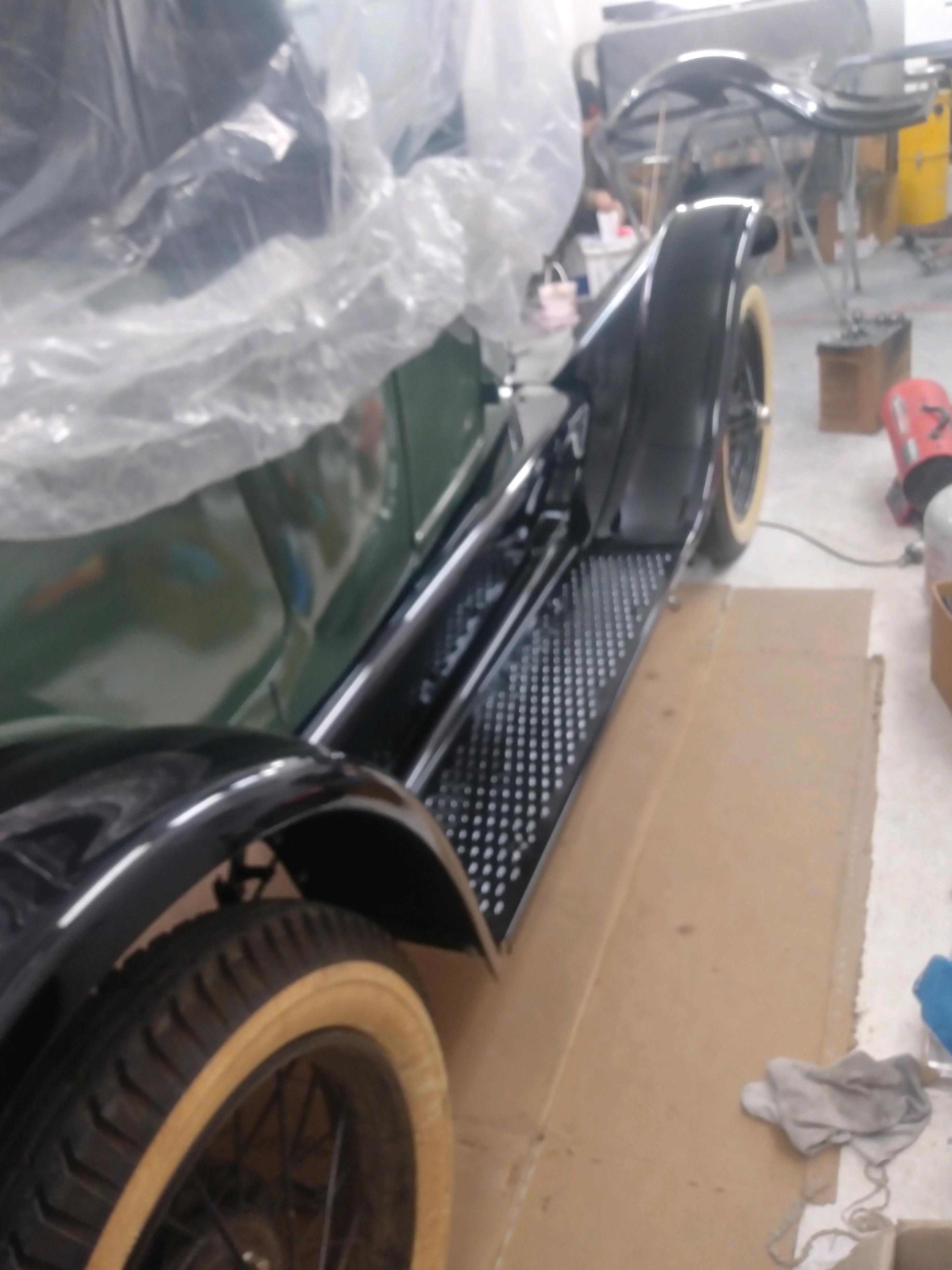

Getting close to finishing this build. Had it out for a few test drives.
Just give me time to Rust and I'll be good as new.

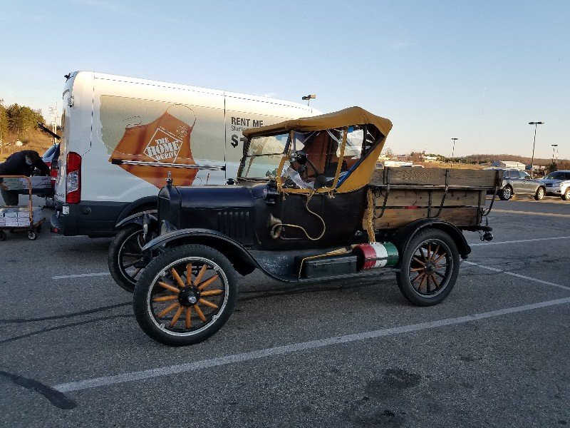

I drove to the Home Depot for a good test run, after some short jonts to adjust bands, check for leaks, etc, after a transmission rebuild, valve job, steering rebuild, etc. We have some good hills in the area, so got a chance to see how the new-old head worked. It worked great! It's an unmarked old/early style cast higher than stock compression head. Purchase thinking it was a WR head, but Joe Bell says it also looks very similar to a Giant head. It didn't make a wiz-bang change, but certainly does pull better up the hills. Didn't have to drop to low on any of the hills tried.
Did notice, however, water gurgling out from the back end of the head, at the water gasket, just starting, on the return trip. I had to re-use my old copper head gasket when I re-assymbled. Luckily, a new copper gasket came in just last week!!

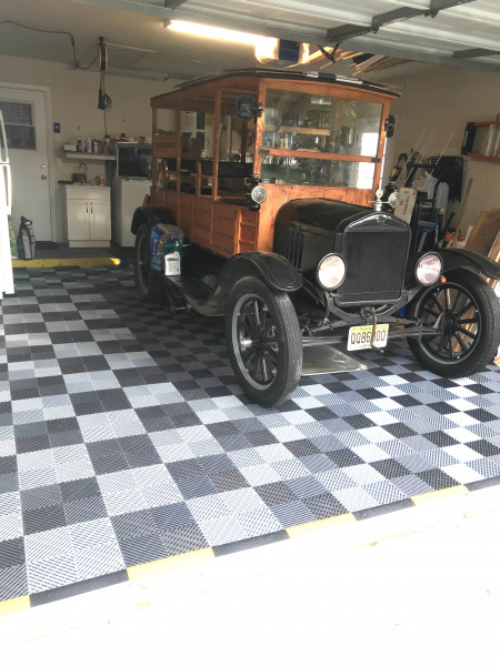

(tongue in cheek...)
I started to feel sorry for the 'digs' that my Hack lived in. I'm usually an Obsessive Compulsive guy (some say Neurotic
) The house in Florida was built with a concrete slab poured on what was scraped sand that has a high water table and done without any vapor barrier!
To make matter worse, over the years someone else had done a Forest Green epoxy coat, that blistered and failed...then did a battleship gray epoxy coat above that that also failed in spots, and then they just overplayed the whole thing with a thick coat of left over latex from somewhere...the surface was like walking on the moon!
All my 'fix-it' chores are done (for now) so what to do? I tried everything known to man to strip what was there...even bought an angle grinder and was doing 4 square foot at a time...but the upper layer of concrete, the 'cream' tended to just shatter out too... So, saw this stuff on line...went for the fully vented...took two days to put down...and its a bit over the top...but...I left the T in place, jacked it up 1/4 at a time while the snap tiles were placed under the wheels! Stuff attracts everything down through the ribs, but vacuums up really nice with a shop vac.
Is it my imagination, or is the Hack actually smiling?

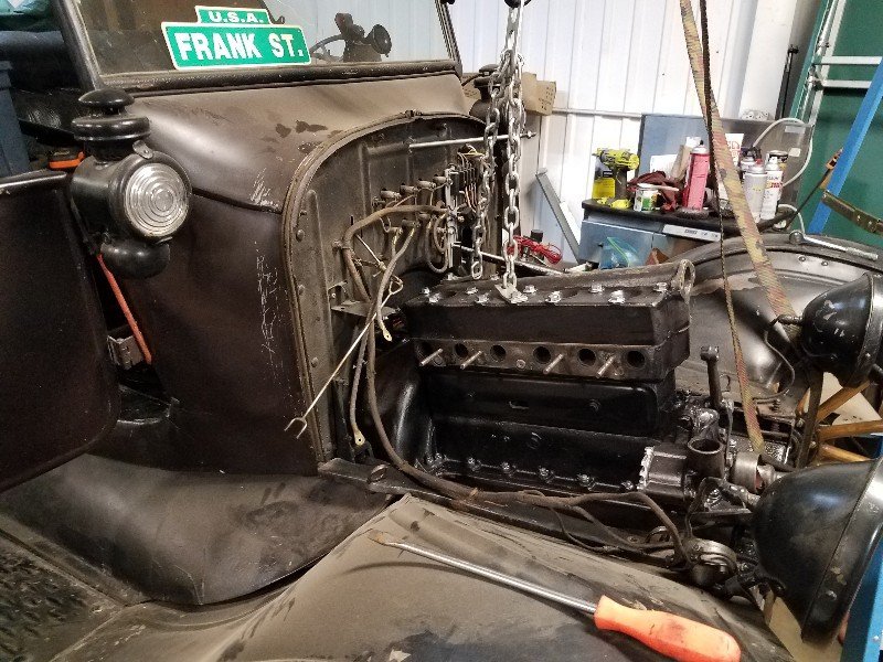

Not on my T's but on a 24 roadster that a fellow is trying to get going for a friend. He had no idea how the ignition worked, so I went over and checked it out. The coils worked well when grounded individually, so showed him how to remove the timer, and explained what it did. It has a new day timer that had a bad spring on the brush. Showed him how to take it apart to replace the spring, and gave him general information on the operation of the T! Nice Roadster, has a sticker from the covered bridge tour, and a ruckstel rear axle. Good top and paint.

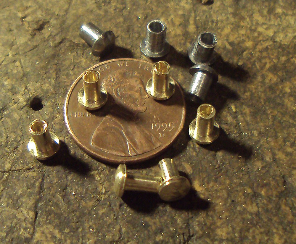

I did a little rivet making today. These are kind of small.
Got the roadster on wheels with the lowered rear suspension.

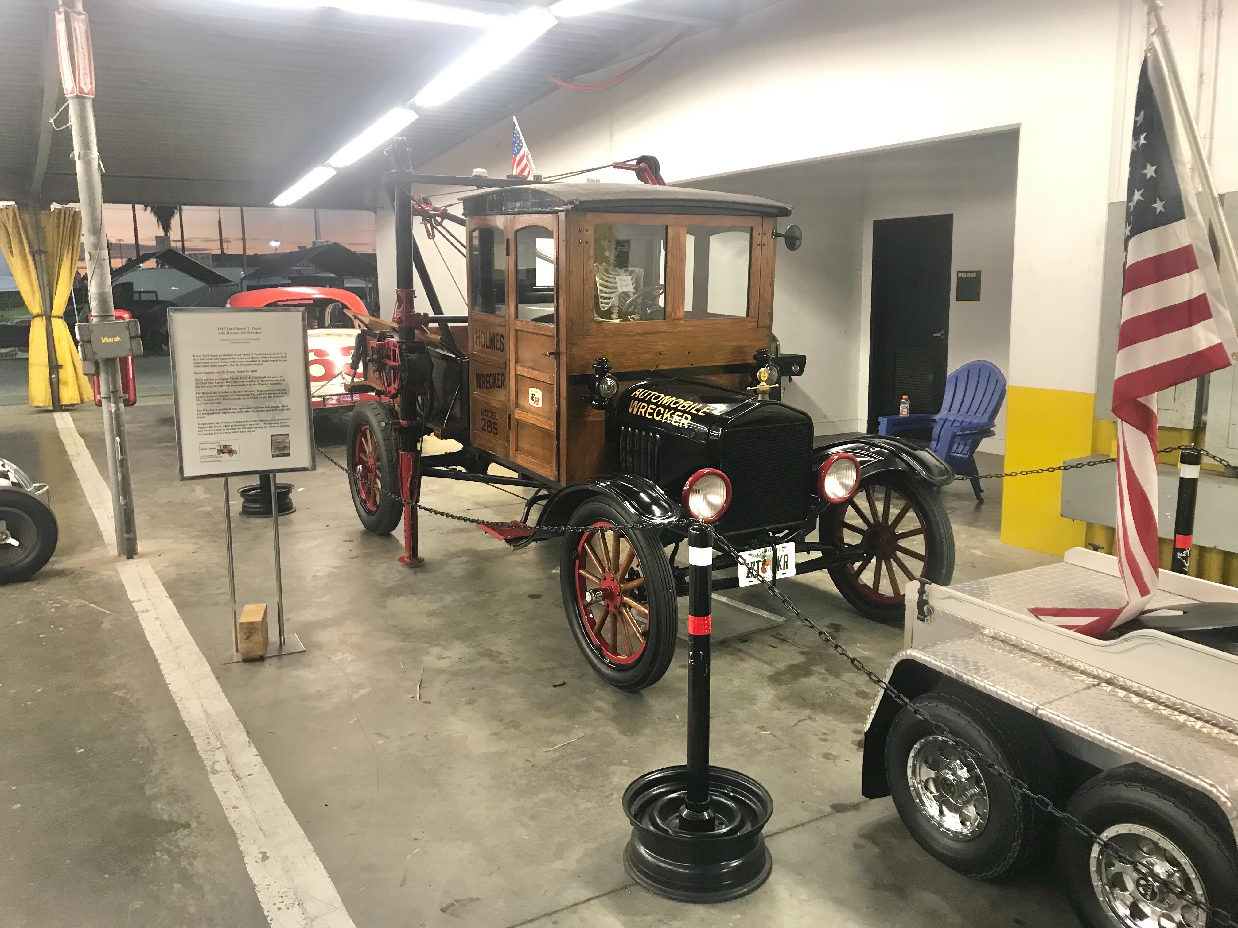

Adjusted the bands, got the original owner back in the drivers seat, and went to the Daytona Turkey Run !
Great holiday weekend for a car show. Thousands of vehicles, but only a couple of T’s this this year.
If my short term memory gets any shorter, I won’t even have thought about what I’m going to forget.

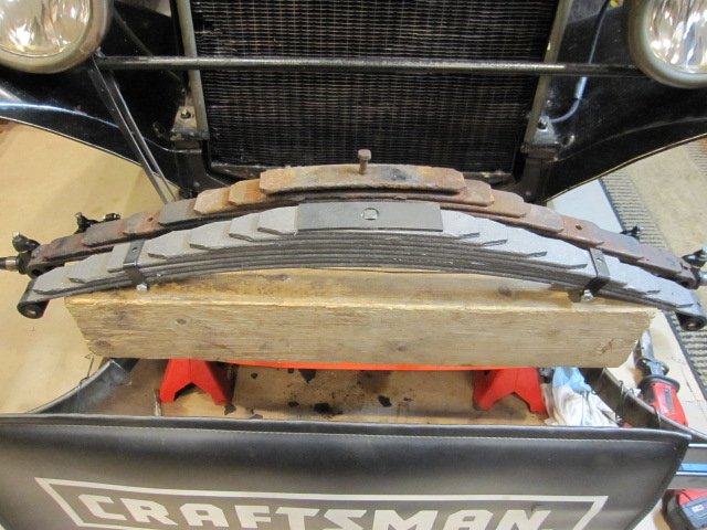

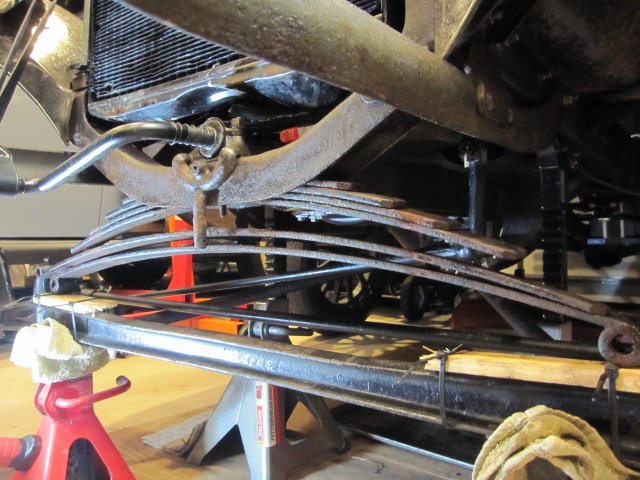

Got the old rusted in place front leaf spring out after cutting the tie bolt and wedging the leaves apart and out. New leaf spring ready after I install the new perch bushings. Thanks to "T" springs in W Hartford for the nice quality front and rear springs.
Finishing painting body damage from an accident in June. Decided to paint all the black

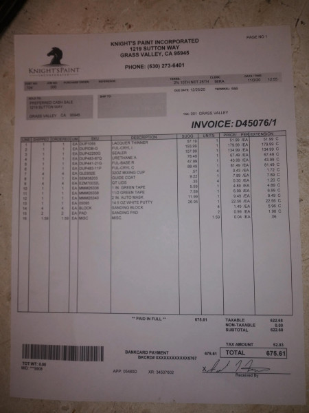

Rich, what paint did you use ? Haven’t found a good period correct paint finish since DuPont imploded.
Pulled the tired engine out of out 27 Touring for rebuilding with help from my Son Chris.

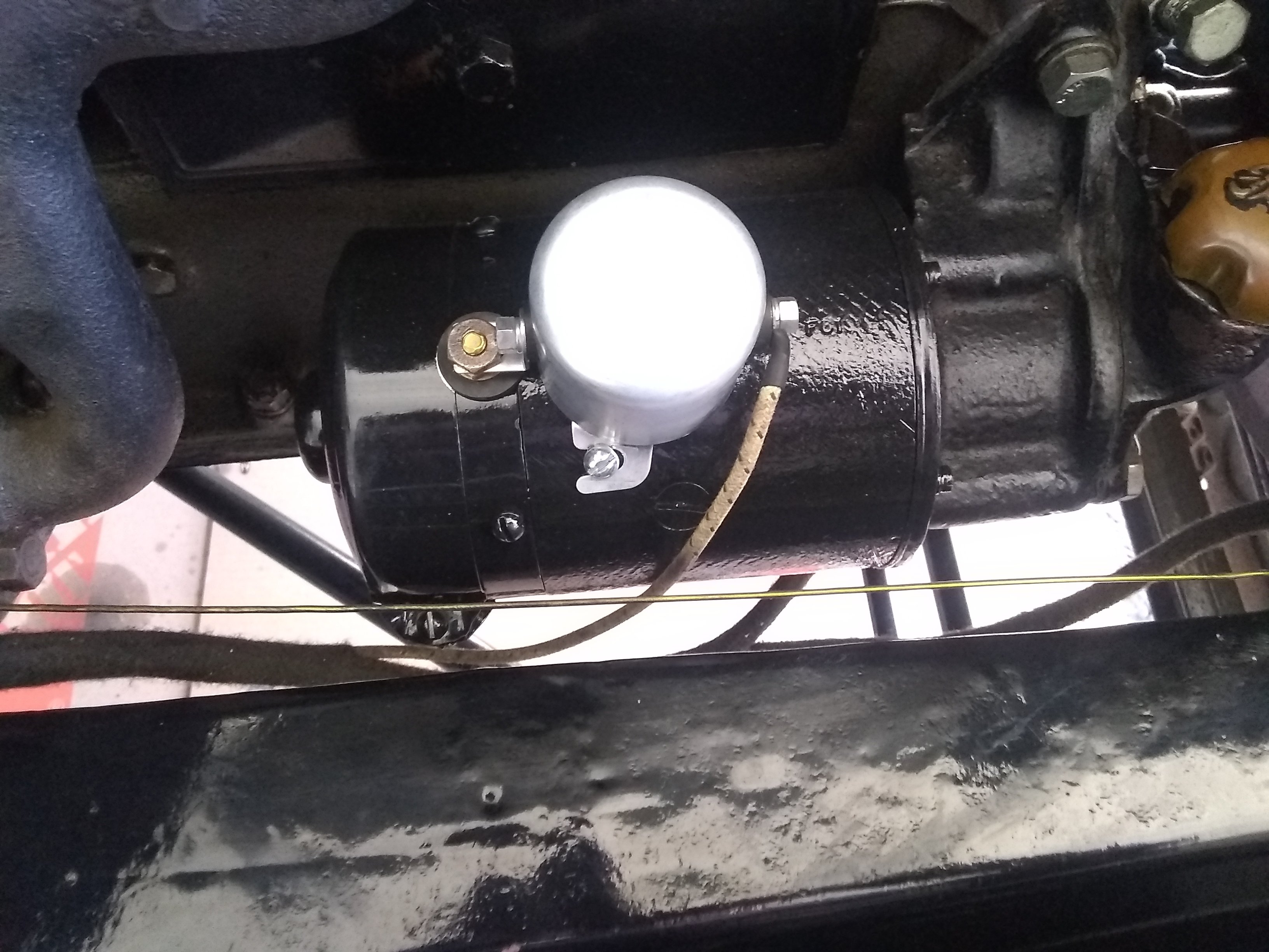

Rebuilt generator for my 1920 T.
Worth every penny.
Worth every penny.

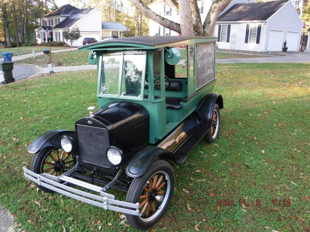

End of an era for me. Sold the 1921 huckster today along with a bunch of parts. It's going to stay in Oregon but it's moving to the Hood River area to live on a ranch. That leaves the 1925 cutdown T and 1920 Dodge. Partly it was the need for money to survive the next 5 months and I needed something different. It was a fun car and I put lots of miles behind the wheel. Being in the best shape of the 3 needed to go. This one I have kept the longest of any car I have owned. I think the new owner will have lots of fun with it, I did. I will be changing my avatar picture soon.

Paul heres the invoice
