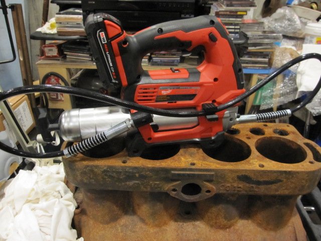

Re: grease zerk for U-joint grease cup
This will help to easily fill those zerks and ease the pain of Arthur Itis
If you have not yet, try Relief Factor.
Nu2theT .... man ... THAT beast would GIVE me Aurthor itis!
