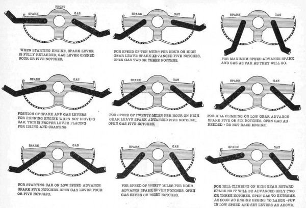

You ask what the model T capabilities are on a hill. That answer is based on what a properly working, properly operated model t can do. you are not getting good hill performance so you are considering improvements beyond the stock t configuration, a 10 tooth gear or a ruxtel should be considered IF the properly working and properly operated model T is not meeting your needs. You say you are new to model T's, and new to this particular model T, so let me suggest you go thru some basic tune-up and adjustments to make it work properly and reliably. Secondly, with the help of more experienced model t owners you learn the ins and outs of operating it properly.
Proper use of the mixture knob and the spark lever are tough for new owners to master, without these set right you will not have adequate performance and pulling a hill may be a challenge.
A tired timer, plugs, and coils will kill performance.
Add-ons like a fuel filter seldom help and often rob performance.
I would give it a year learning how to drive and tuning it up before I would spend any money on a 10 tooth pinion or ruxtel axle. If there is a local model t expert become his new best friend. Best of luck with your new endeavor, you will either end up hating it or loving it.

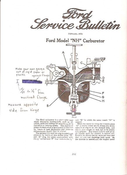

I was going to give you two things, but I thought of another. Too low float level in the carburetor or a blocked fuel intake to the carburetor could give symptoms of running out of gas when pulling with throttle fully open.

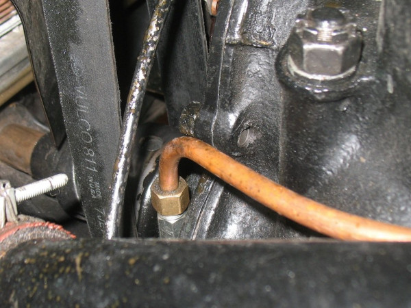

The problem with backing up a hill, at least for me, is that Model T steering gets rather squirrely in reverse. I never go anywhere without my running board cans. Their primary purpose is to save me an unscheduled long walk, and they have done that more than once. But a secondary purpose arises if I encounter a particularly steep hill with a low tank. I can put enough gas in the tank to take it head-on.
As for oil draining away from the front of the engine on a steep hill and letting the front bearings go dry, at the very least it's good to have an accessory outside oil line to take oil from the hogshead to the front of the engine.

It occurs to me that while this is a starter-equipped car, you may want to hand start it sometimes. I suppose some folks never do, but I think most of us use the crank at least occasionally. Of course on a lot of Model T's there's no electric starter and the armstrong start is the only choice. If you do hand start, there's a safe way and there's a dangerous way.

Ernie says he will check the sediment bulb and carb float again. He had the sediment bulb out once, but not since we did the first main flush of the gas tank. He's also had the carb apart, but didn't pay much attention to the float level. So he says he will double check that too. There is no in-line filter at this time. We've been keeping the gas tank clear full, and an afternoon drive for us is only 6-8 miles. So I would not expect the fuel shifting in the gas tank to be a problem.
We do already have an accessory outside oil line.

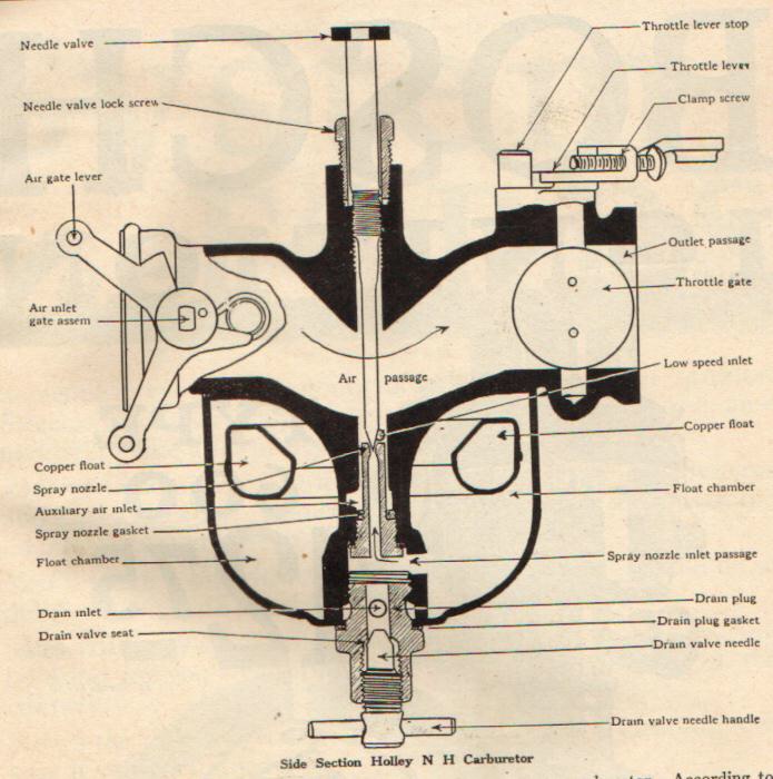

These will be useful if you have a Holley NH carb. The float adjustment is very important. Be sure to measure fro he machined flange surface. If you get a carburetor rebuild kit, the bowl flange gasket is usually too tight to fit when dry and if you try to force it, it will tear, but if you soak it in water for a few moments it will fit just right. Secure the bowl in place while it is still wet and allow the water to dry so that it will retain the correct size. Jim Patrick
