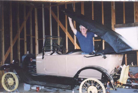

Your description doesn't seem right. The top should be a "one man" top. There should be no pins in the top bows but you can stand in the back seat area and pull up first the front bow, then the second bow and everything will just fit right into place. The only place there are anything resembling "pins" would be the top of the windshield posts. There are brackets on each side of the front bow which fit right over the posts. You might have an easier time with those posts if you loosen one side of the top windshield so you can wiggle the post. Then tighten the wing nuts on both brackets and also the windshield post. There should also be three snaps on each side of the Gypsy curtains at the back bow. See picture below

Note, that video posted by John is for an earlier year T the 27 does not have those pins but everything folds down or up without moving anything. However even with the "one man" top, it is easier with two people. If you do it in as rough a manor as in that video, you will very soon break the top irons and have a real mess of your top. The 26-27 can easily be folded or raised by one person in good health from the back seat like I posted in my picture.

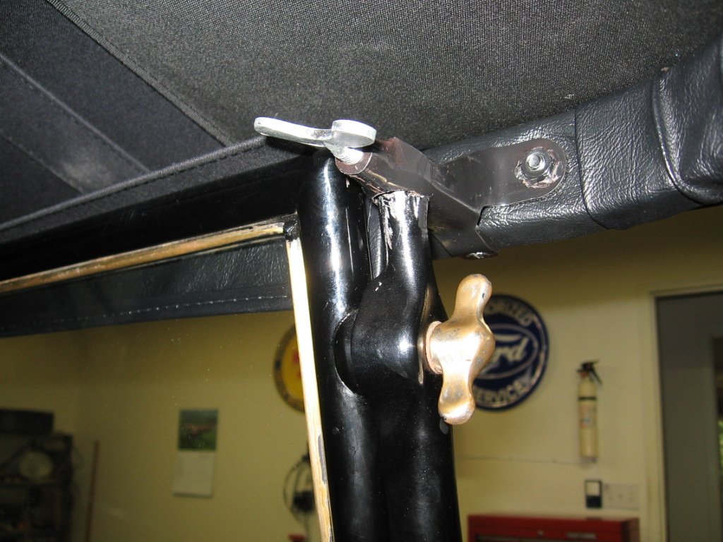

Here is what the front bow attachment looks like on my 1924 cut-off touring (now a pickup). Since this picture was taken I have nickel plated the windshield pivot wingnuts and painted the top clamp wingnuts black.

Re: 1927 Model T Touring Putting the Top up
Same clamp was used 1923 to 1927.

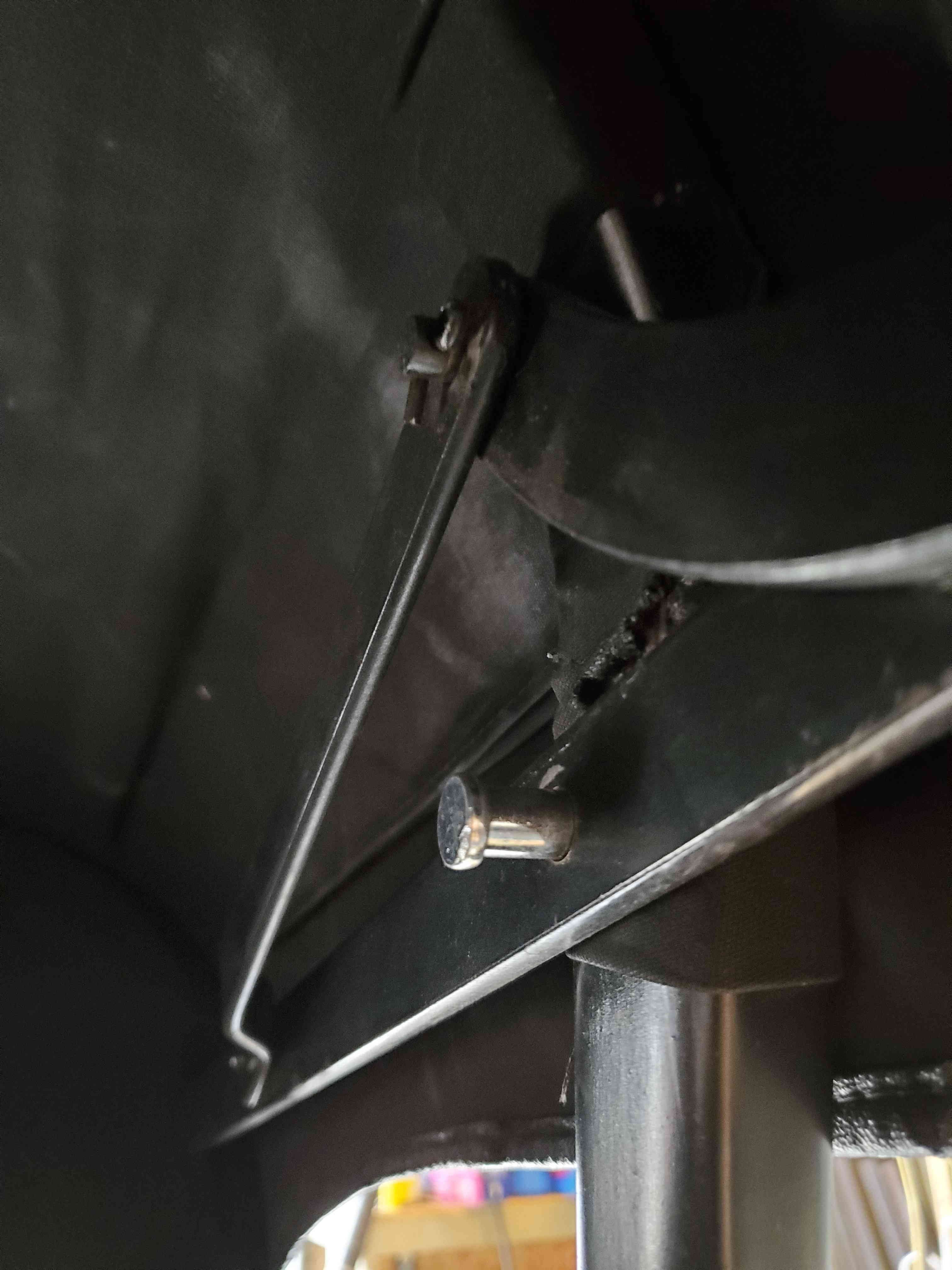

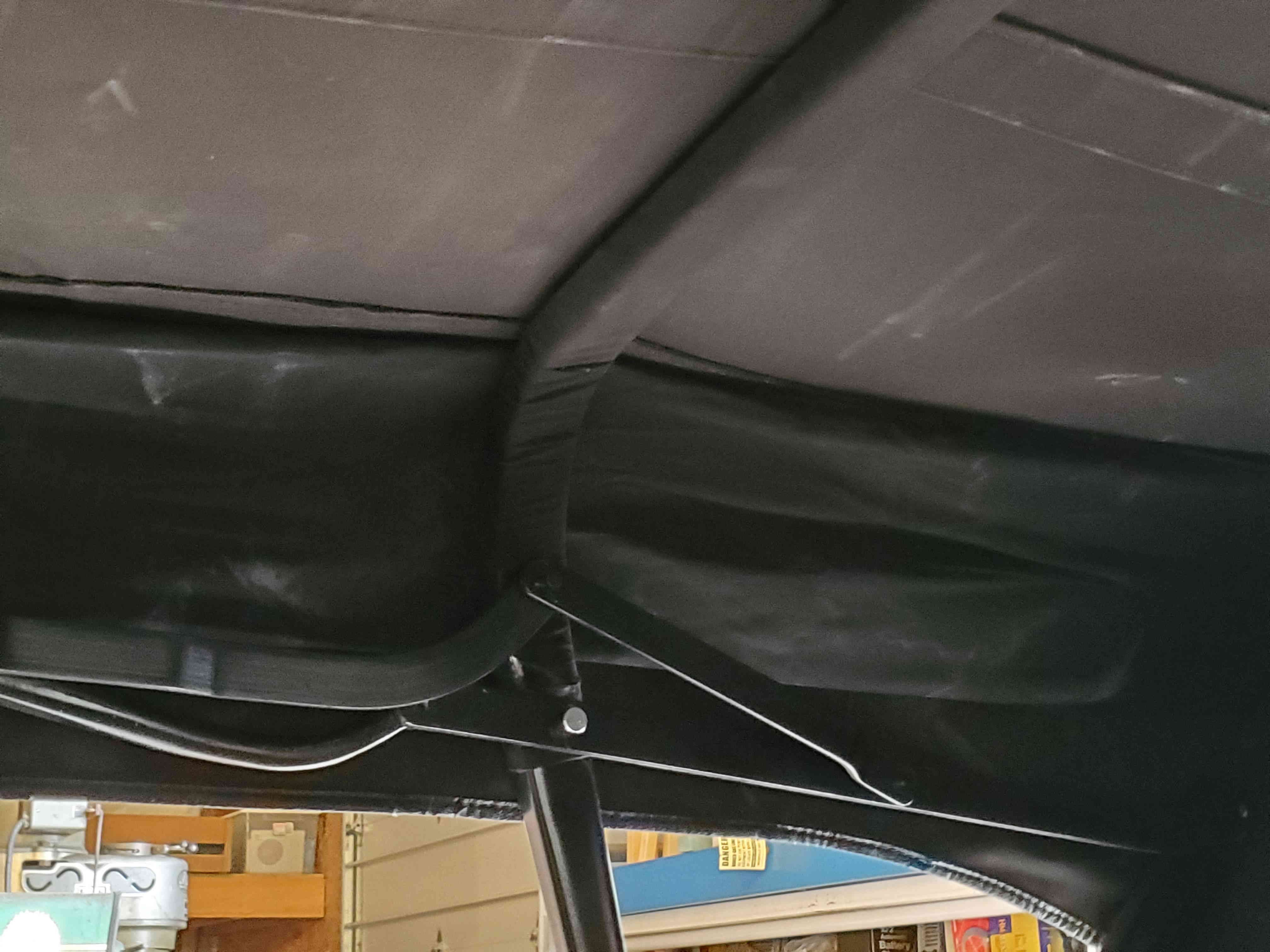

A picture is worth a 1000 words. Here are pics of the pins.

My car is a 26. If yours is really a 27 then it has a different top than mine has.
