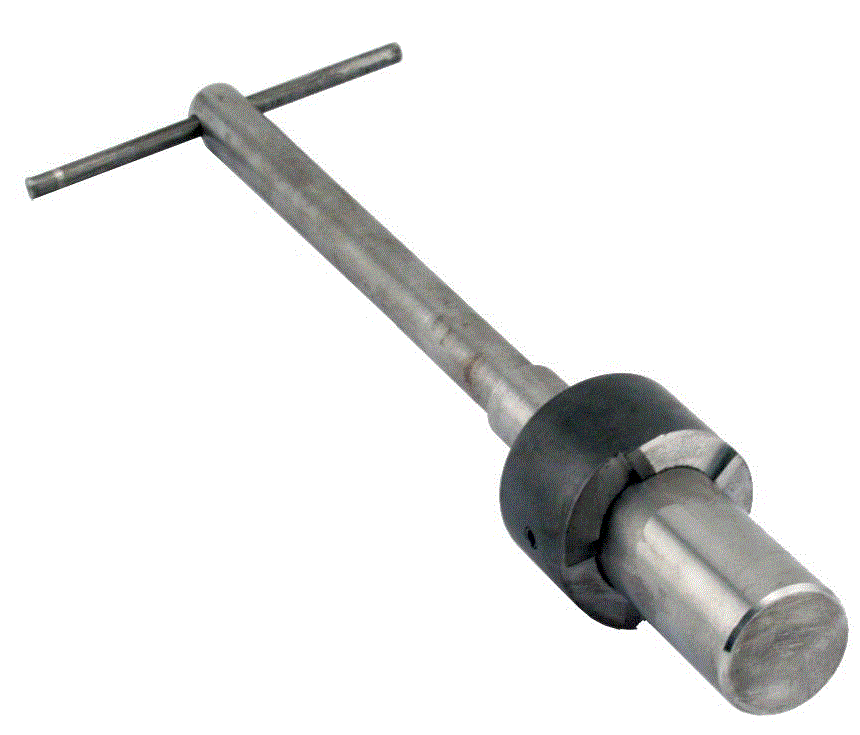

Hi, any one have somme experience to share with the BUSHING FACING TOOL? Is it working well with a brass Drive shaft housing front bushing? I would like doing by myself without going in machine shop.

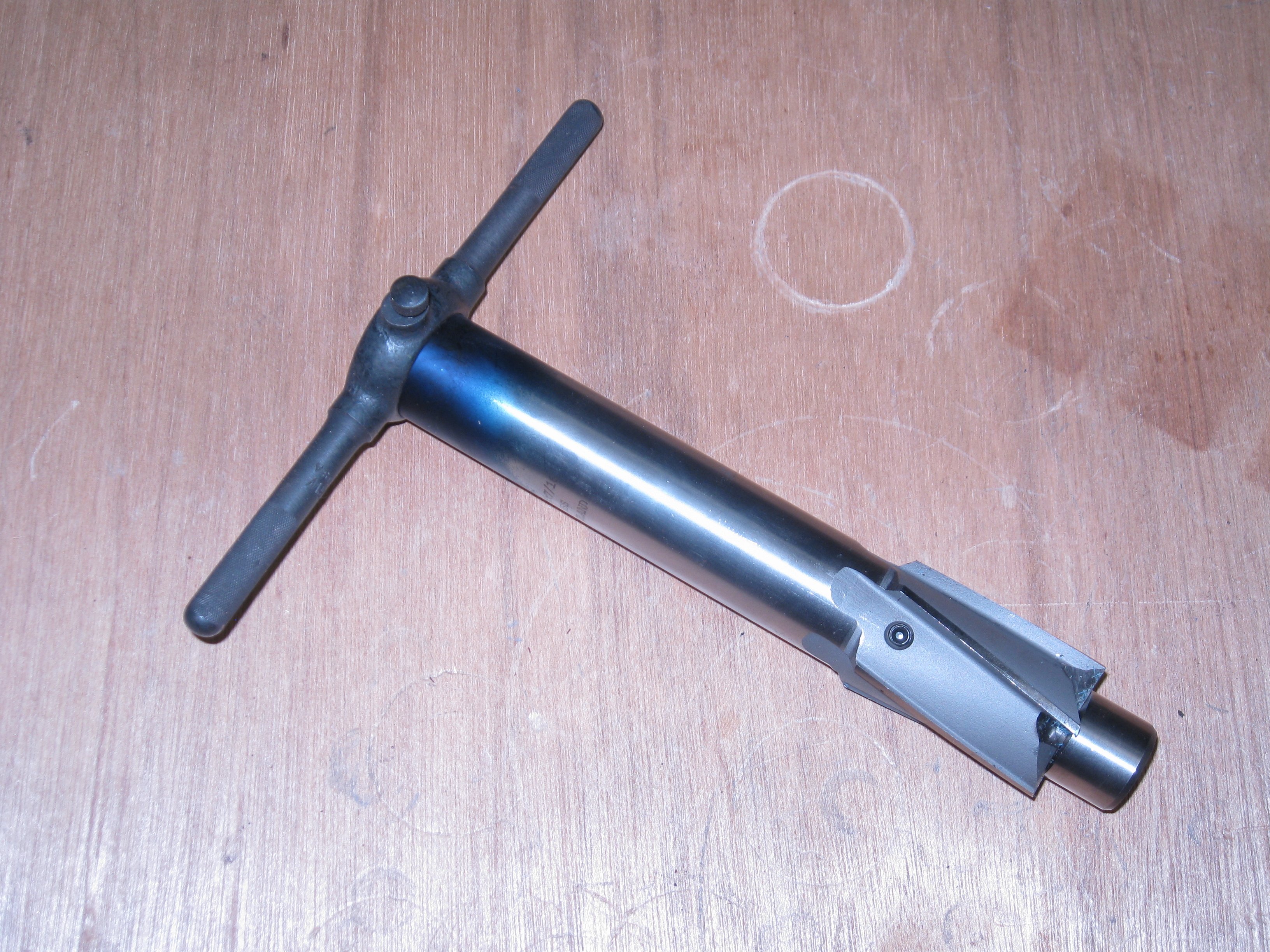

I can not comment on the one that you have shown (sold by the vendors), but I can say that the one that I have works very well.
I bought a surplus piloted spot-facer and the correct size pilot and was into it for less than half of what the one you have shown cost. I had the similar style (to the one that you show) for facing the spindle bushings on the front axle and I was not happy with the quality of that one. That is the reason that I got the one shown in the photos above.

Re: BUSHING FACING TOOL QUESTIONS?
The catalog ones are junk, don't waste your money.
As Andy and Joseph states, "Junk" is an understatement.
Agreed! Having one of those will inspire you to come up with something far better on your own.Henry K. Lee wrote: ↑Mon Nov 30, 2020 4:45 pmAs Andy and Joseph states, "Junk" is an understatement.
It all depends on the material one is attempting to face or ream. I've used the currently available facer on NOS Babbitt d.s. bushings and it cuts satisfactorily but not so on the current brass bushings. I have a Stevens facer also.
I assume you guys using the same process for the spindle bushings? I had the thrust cutter the vendors sell and again it is junk. I guess I will look for a piloted counterbore in the right size. Unless I get a better idea from you all.
I think i stuck the tool in a drill once and it worked far better. The handel presses out pretty easily. I use my lathe now to face bushings.
That tool may work ok on babbit bushings but it requires a lot of pressure to cut the brass bushings by hand. I face most of the material off in the lathe and then install the bushing and sneak up on the fit with the tool shown in a drill.
