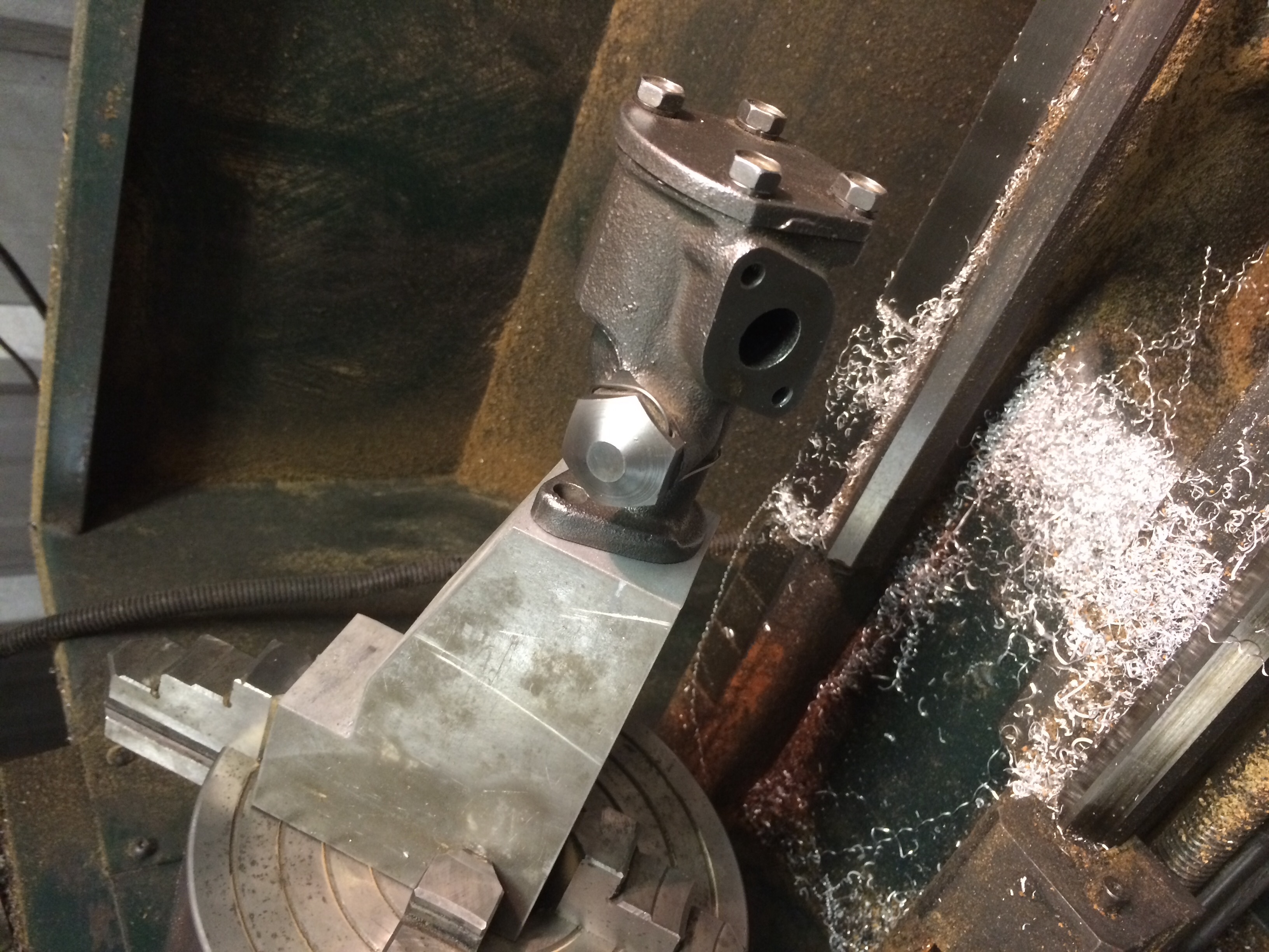

Using a flathead V8 oil pump. To alleviate any confusion about oiling the transmission, the transmission shaft has a hole down the center and a side hole and is fed from the rear main bearing. I first used this concept over 40 years ago and it worked great!

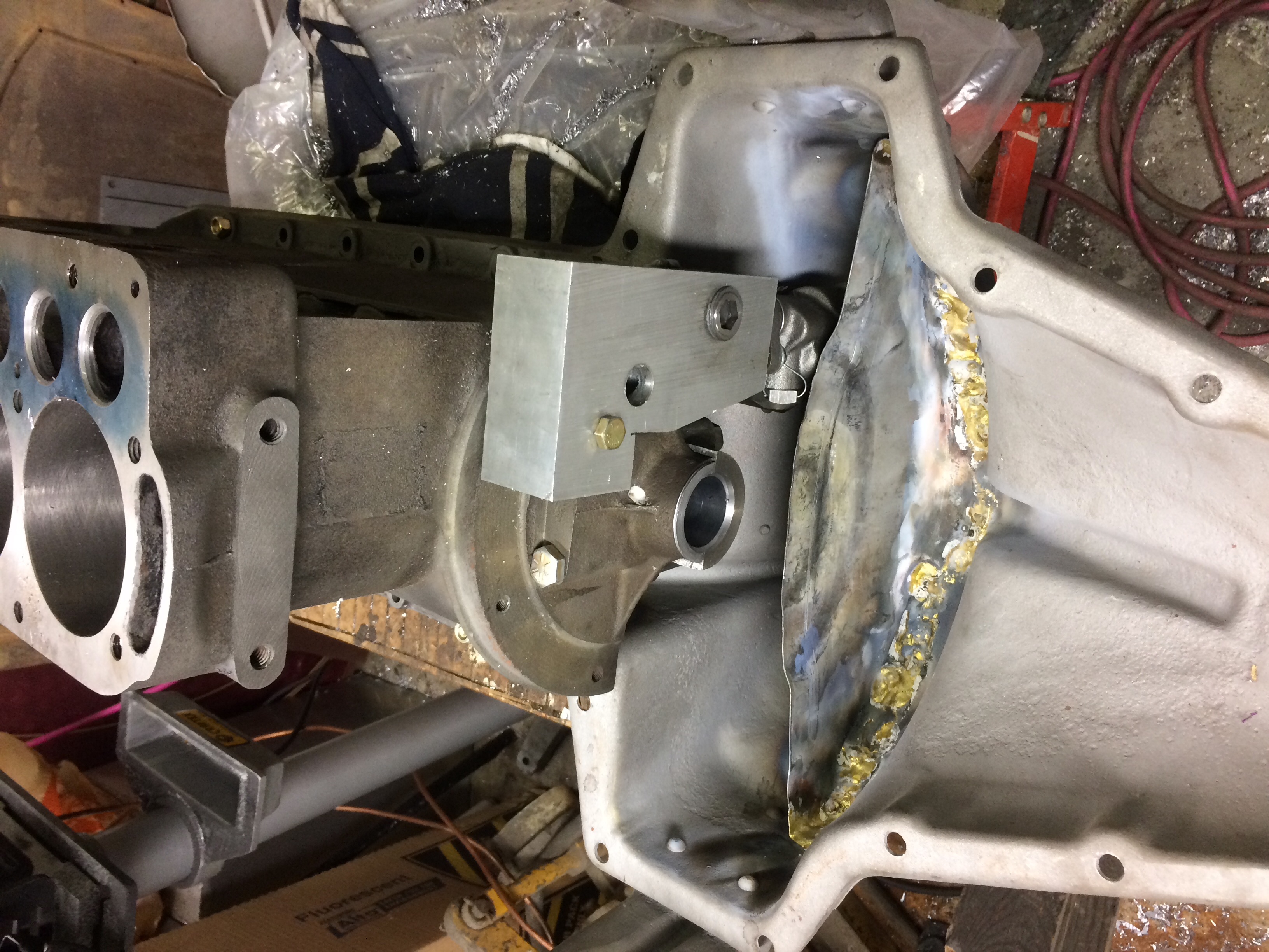

Re: A different oil pump option
I guess that the aluminum cylinder with the hole is the pickup and I believe I can see a filter inside.a couple of questions which I suspect many would like to know more details.
Is the pump as low as the pan will allow?
How did you connect the gear to the rear of the camshaft?
How does the oil that accumulates behind the shield get back to the pump side of the shield?

Yes the aluminum cylinder with the screen is the oil “pickup”
The elevation of the pump is a function of the location of the camshaft and the length of the oil pump, so I really have no decision there.
The oil pickup I located to a “practical” location low in the pan.
The camshaft extension is by drilling a 1/2” hole about a inch into the end and making a piece of 3/4” bar that is about.0015” interference and with some heat and pressure it is now locked in place. Then when cool, machine to 5/8” to fit the gear, a woodruff key and a snap ring.
The gear is installed when the camshaft is in place.
Hopefully this helps.

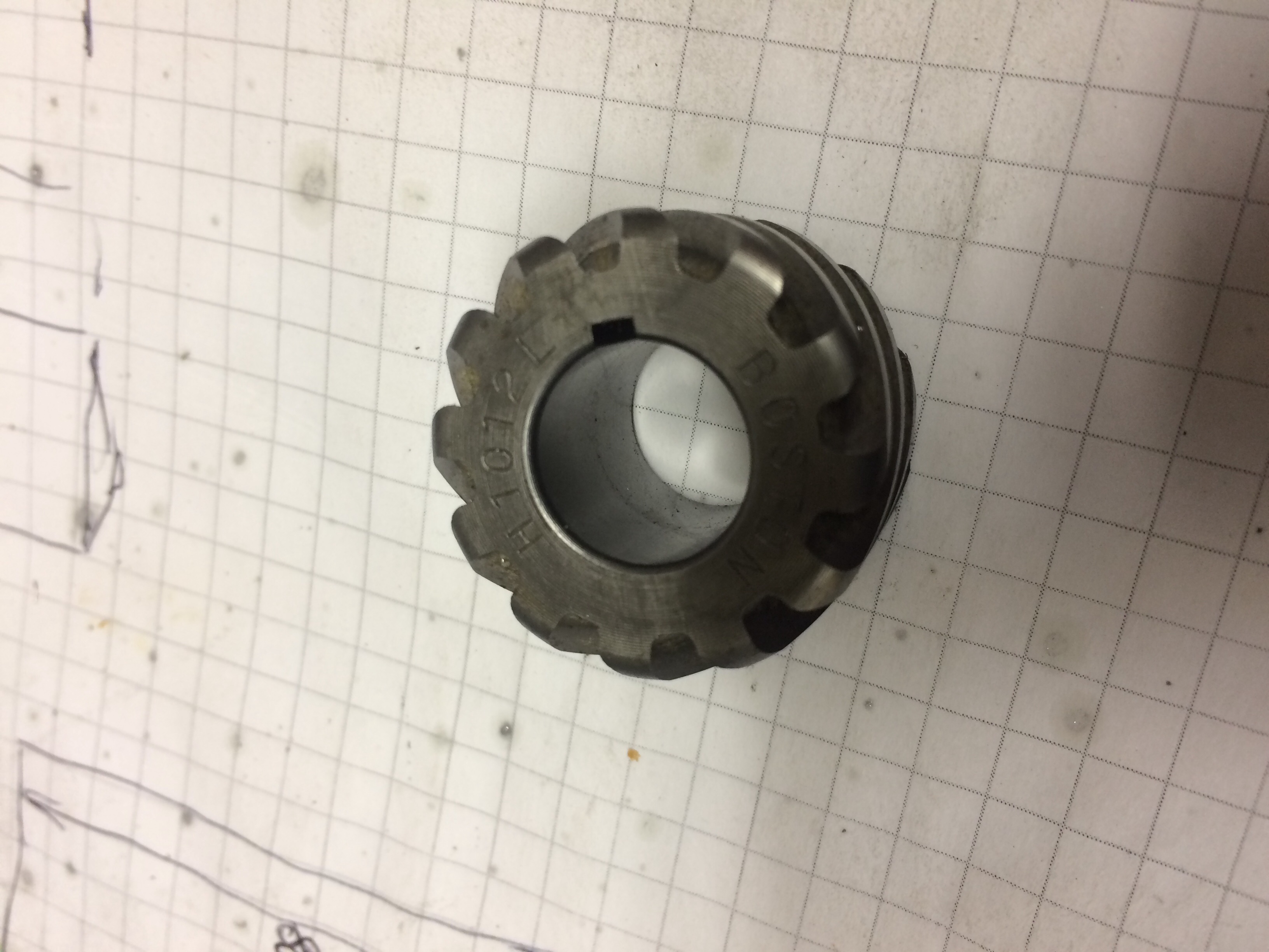

This is the gear I use for the camshaft.
A Boston H1012L. 10 pitch 12 tooth Left hand

Made good progress on a second one. I realized I had the pump, the gear and a “home” for it!!

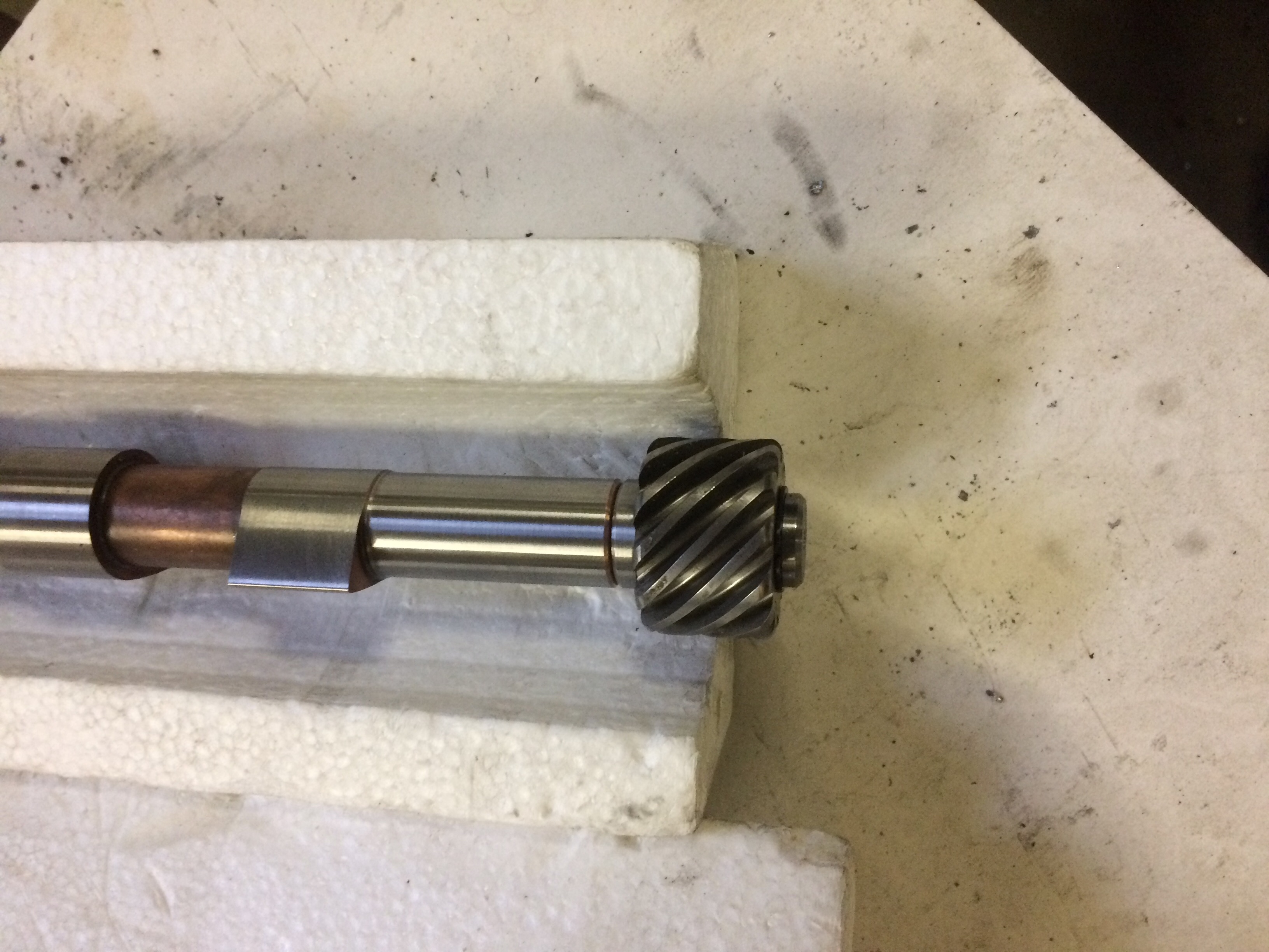

And here is the camshaft extended and the gear on it. The extension is threaded in with a LH thread
