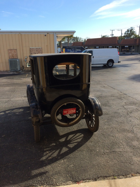

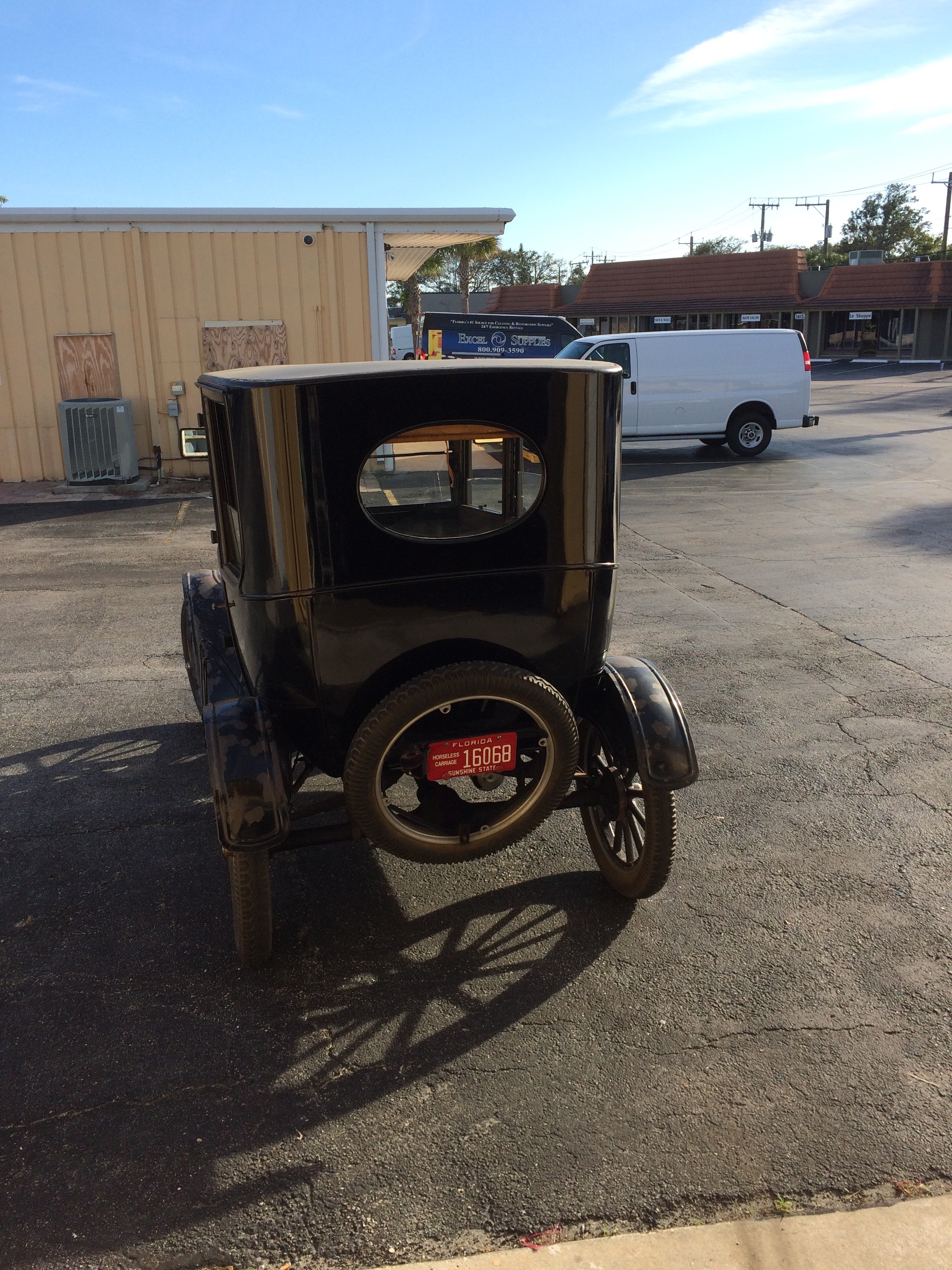

The top on my original unrestored Centerdoor was alligatored, dry and cracking. It was also sagging in spots between the bows so water could pool there. I used Flex Seal on it and it came out great. I applied numerous coats and eventually it filled the cracks and reduced the alligatoring. My only objection was that it has a gloss finish but after leaving it out in the Florida sun for a time it has dulled down. Don't know how it will hold up over the long haul but 3 years later it still loos great.

Golly Russ, you need a steo ladder to even SEE the topRuss T Fender wrote: ↑Fri Dec 04, 2020 8:35 pm. . . My only objection was that it has a gloss finish . . .

Rich, I debated doing anything to the top as you have to be 7 feet plus just to see it unless you use a ladder. I was just going to use it on fair weather days but in Florida a fair weather day can turn into a downpour in a flash and why have a closed car if you can't use it in foul weather!
