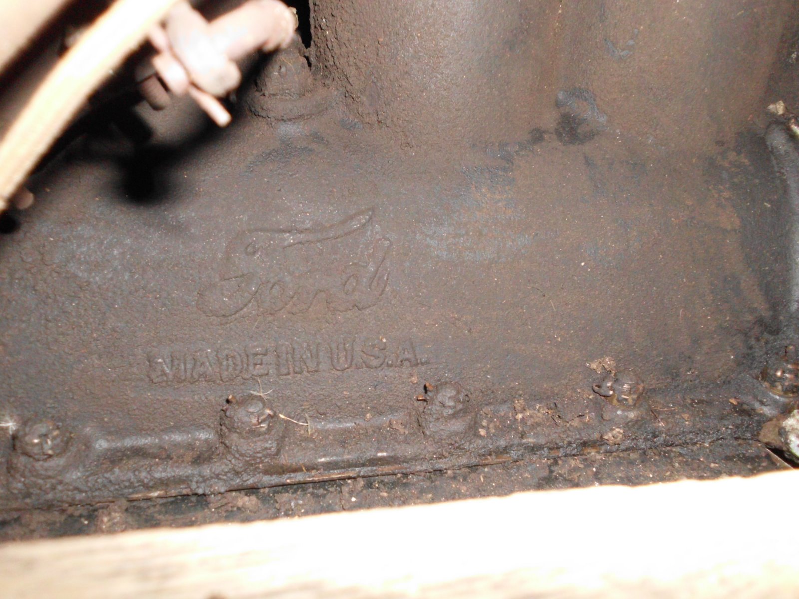

Dave: Look around it for anything that might say "Made IN USA". Stuff that went to Canada that had that on it was ground off, or removed some way. I have a 13 running gear that was a Canada car and the USA on the block was ground off. Mine was an early 13 so no Made in USA on the head, but the side of block was ground off. Dan.

I don't think the Made in USA was ground off, I don't believe it was ever cast in the first place. I have a Canadian 15 and 16 engine and only Ford is cast on the block and nothing is ground off. I don't think the country of manufacture was cast in the blocks until some time in 17 or later.

David, the fossil evidence is contrary to your timeline for the casting of country of manufacture on engine blocks. Many, if not all early blocks in Canadian supplied cars sent to Australia show where the 'Made In USA' was ground/chiselled off. I cannot put a time to the end of this practice.

Never wanting to spread misinformation I went to my library last night and took a look at Bruce McCalley's book. In the 1913 section of "the book" on page 163 Bruce shows several angles on a USA built 1913 engine; clearly the left engine skirt and the cylinder head have "Ford made in the USA" cast into them. the '09-12 engines in Bruce's book show no such casting. I'm strongly convinced the Made in USA casting will be ground off on a Canadian built Model T, from that time period, notwithstanding where the engine was cast, again, to avoid the tariff complications with export vehicles into the British Empire.

I would check the serial number it may be a poorly stamped B If it is a C ,it may be a Us car with a Canadian Block. My Sept 1912 an original car that was complete running driving car with original engine only has Ford on the block nothing removed the casting date is above the serial number ,the body was never apart original wood and there are no Robertson screws on the car. this is the car , driven home 1960
