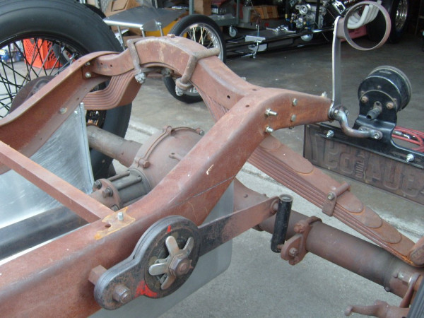

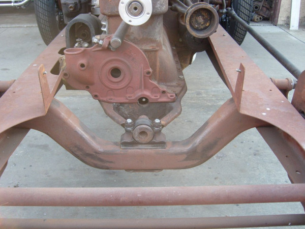

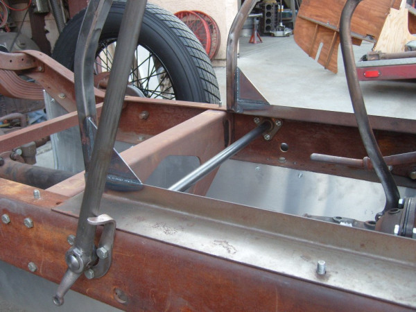

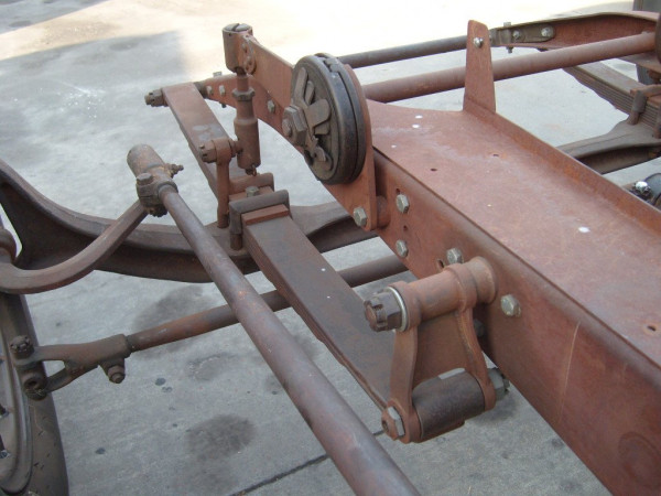

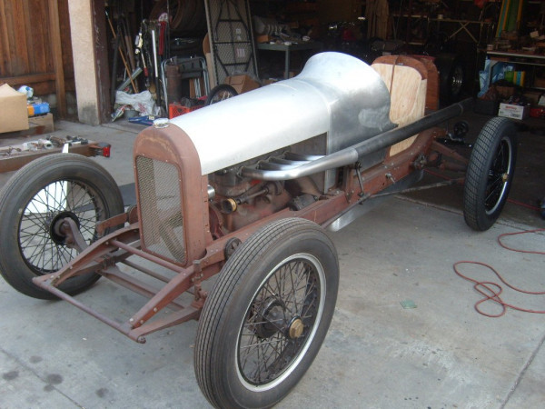

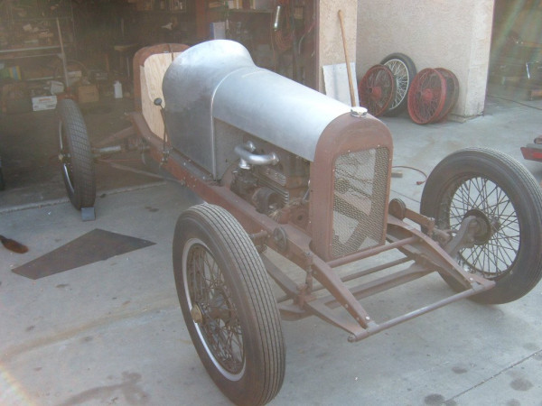

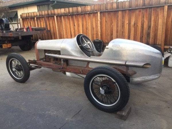

I posted pictures of my race car on the " Speedster " thread,
I was asked to post more pictures so here they are , hope you enjoy them

I guess I’ll start with a few questions...;
What is the wheelbase?
What frame rails?
What front axle?

Post by pete eastwood » Tue Dec 08, 2020 11:41 pm
Hi Kevin ,
Wheel base is 96"
Frame is an Essex
Front axle is Essex

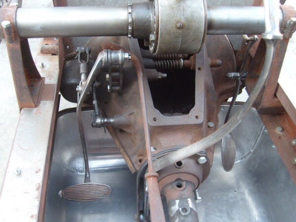

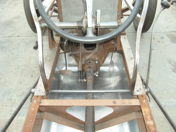

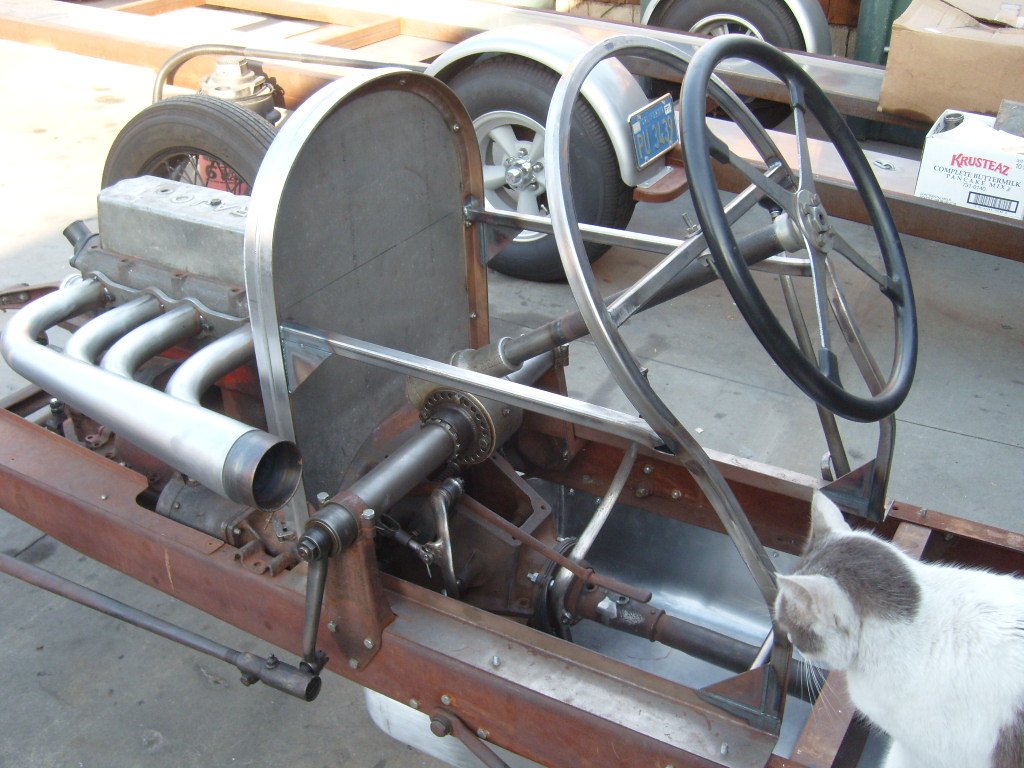

Really nice work. Good to see everything, including the driver, really low
Will you explain the controls.
I'm guessing that -
the right pedal is the throttle
the outboard lever on the right is the rear brakes
there is no transmission brake
the horizontal lever just left of centre is for reverse
the left pedal might be low/high
the lever just right of centre could be Ruckstell
Marks out of 6?

Post by pete eastwood » Wed Dec 09, 2020 12:56 pm
Chris Barker
You get an A+ for getting them all correct !

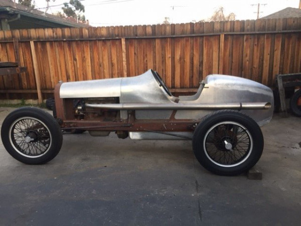

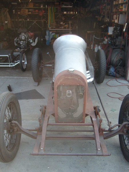

Do I see some Dennis Webb sheet metal?

Pete, could you explain your transmission/pedal setup?

Post by Craig Leach » Thu Dec 10, 2020 12:02 pm
Looks like he reversed the low/clutch pedel using the brake shaft as a pivot and converted the reverse to hand operated. Very inovative.
Super nice car! My hats off to you.

Post by pete eastwood » Thu Dec 10, 2020 2:01 pm
SeanB,
Craig Leach pretty much explained the controls.
The right pedal is the throttle
the left pedal ; down for low , up for high , in between for neutral . I'm still working on a simple mechanism to hold & maintain neutral .
horizontal lever , lift for reverse
vertical lever is for the Ruckstell.
Brakes are handled with the out side / right side hand lever to the rear axle brakes .
All those pieces are constructed from highly modified various model T & model A parts .
big2bird
The body panels ;
Bill Gathings formed the tail panels to the buck that I built .
I fitted the tail panels and am in the process of welding them up .
The rest of the body ; cowl , belly pan etc. I did myself .
