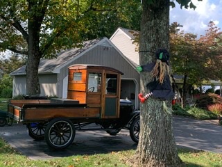

i have considered installing the rocky mountain brakes on my 23 wood body truck.
i could purchase them from a vendor, but i also have heard that the old style may be better or different.
is it worth the effort to find an older set or just purchase a new set?
im not familiar with the differences enough to make a decision

My t is basically a 23/24 car that has a wood cab pickup much like a tt would look like
The bands stop it pretty good
I did put brake shoes on and my club helped me figure out the brake rods so the parking brake works good also
I live in an area that has hills and I use reverse and the brake and for the most part I’m good but was thinking an alternative brake system may be beneficial
I actually find myself wanting to drive the t more than my other cars so I thought I would look into brakes

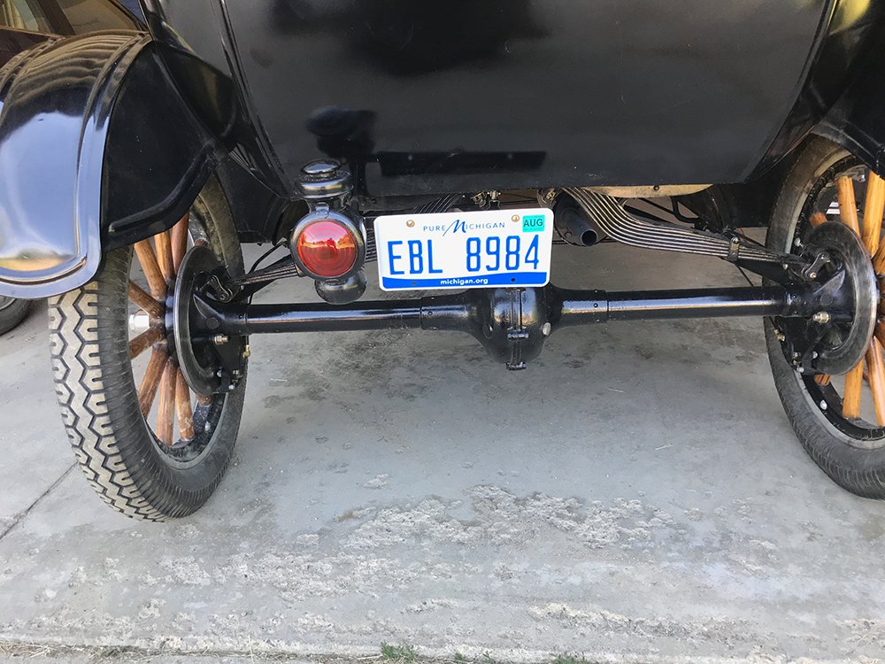

I have a '17 Touring that I drive, a lot! I had two experiences on the 2019 Indiana Covered bridge tour which drove home the importance of good brakes. In the first case I was going down a narrow, steep, winding hill when I came upon several Model T's stopped at a river ford. I pushed the brake to the floor and managed to miss the car ahead of me only by pulling half into a ditch. In the second case I was climbing a steep, narrow road when the engine started to sputter. It never quit but if it had, I don't think I could have stopped the car from rolling backwards into the cars following me or going off the road into the rough. I had three passengers with me so the car was heavier than most.... people could have been hurt.
After evaluating the available braking systems, I went with hydraulic disc brakes. They work great! Forward, reverse, wet or dry it's all the same. I have a driver, not a show car and don't care if they don't look "period." Not everyone will agree with my logic but there it is.

Tim,
thanks for the picture of the hydraulic brake system.
i forgot they existed.
did you use the sure- stop system or maybe another vendor.

Joe,
I used the "Sure Stop" system. The components are of the highest quality and go together well. Unlike mechanical brakes you don't have to periodically adjust them. They also include a reliable brake light switch activated by hydraulic pressure. Under routine driving only a slight pedal pressure is needed to stop. If you stomp the pedal you can easily lock up the rear wheels.
I assume you have small drum parking brakes so the price of discs compared to RM's is about $150 more --- well worth it in my estimation.
