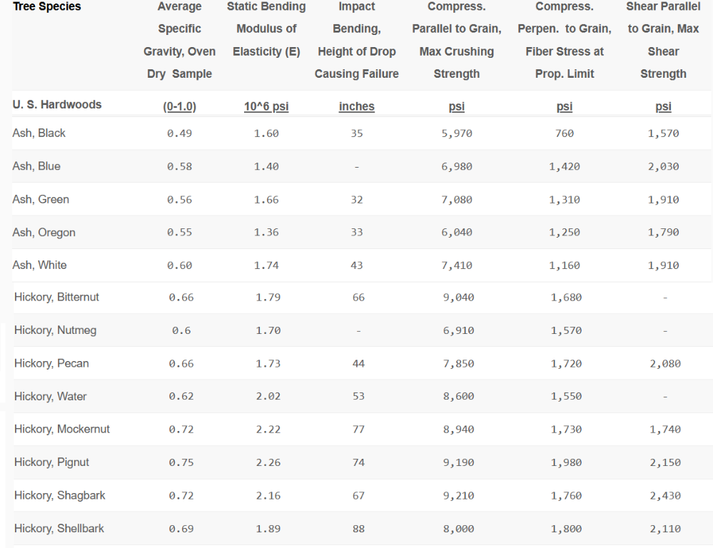

Where are "Mythbusters" when you need them? I'm not nearly as confident in the sheer strength of a hickory spoke as you are, Scott! I'll buy a spare or two when I redo my rear wheels this summer and see if I can rig up a test.

Bedtime reading material: http://www.mtfca.com/discus/messages/29 ... 1204559669

From an the bedtime reading post above
Strength Properties of Commercially Important Woods
https://woodbin.com/ref/wood-strength-table/
Just did a cut n past to see Ash & Hickory
