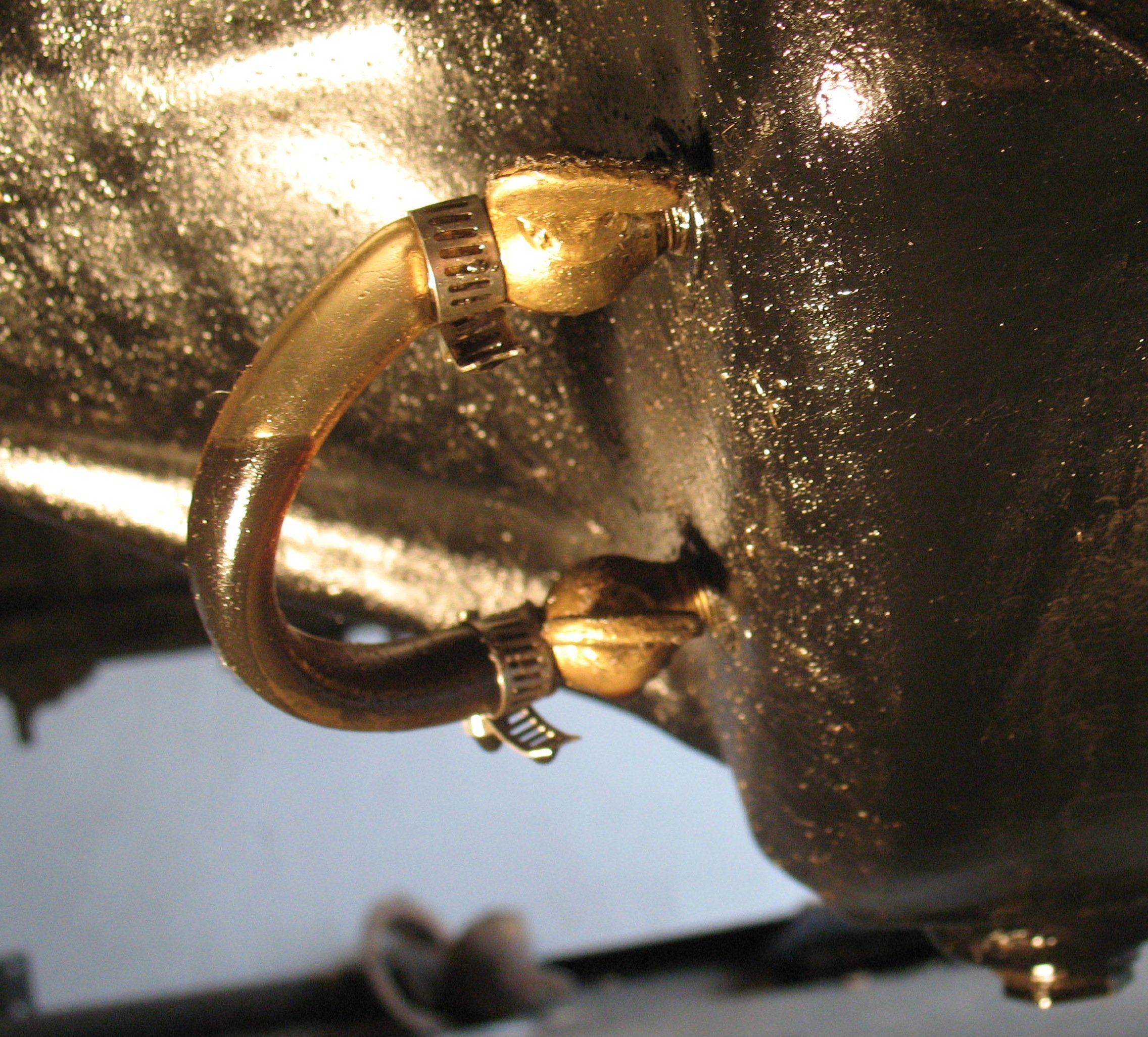

I guess I need to rebuild my T tranny because my acsessory oil float was stuck in full and I ran it out of oil :roll: :?
I found a chipped gear tooth and all the band lining was tore up.

The oil for the trans is also the oil for the engine, so if you did run it dry and damaged the trans you may have similar damage to the engine, both will need to be rebuilt. I have torn model T engines apart and freshend them up by taking out bearing shims, honing cylinders, replacing rings and valves, etc, but in my 50 years of owning and working on a model T, I have never done a transmission rebuild. You ask the question what is the procedure to pull the engine and rebuild the transmission, that question tells me you are already over your head. Rebuilding a transmission requires special tools and reamers that for a one time job are going to be a prohibitively high overhead cost. Rebuilding an engine may require pouring new babbit bearings, again requiring special tooling and know how. You could buy all the special tooling and teach yourself model T engine and trans rebuilding, but that will run you several times the cost of having your engine and trans rebuilt by a professional shop. I would suggest you take the whole thing to a engine repair shop that knows model T's and have them do the entire engine and trans rebuild.
You may want to go through your car and remove and throw away any other gee wiz accessories that have been added over the years, as many of these things have a tendency to reduce vehicle reliability or safety.

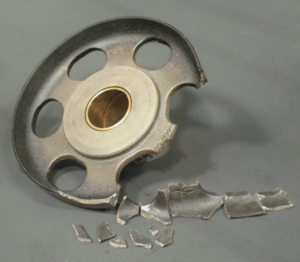

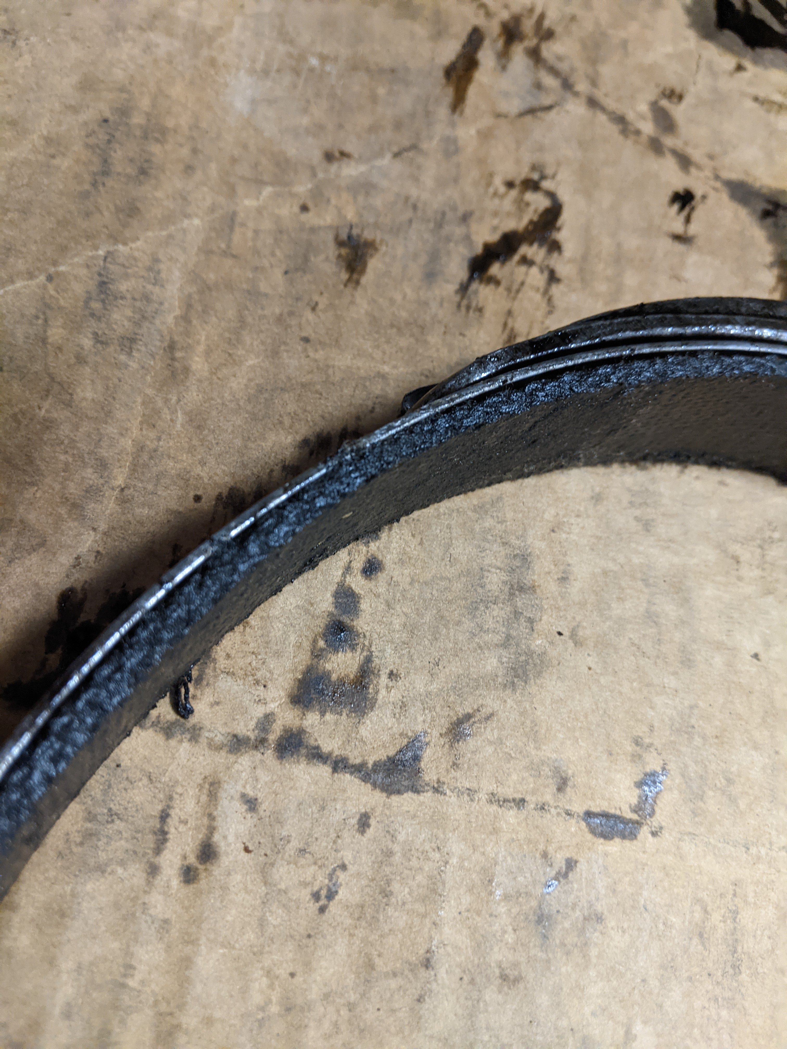

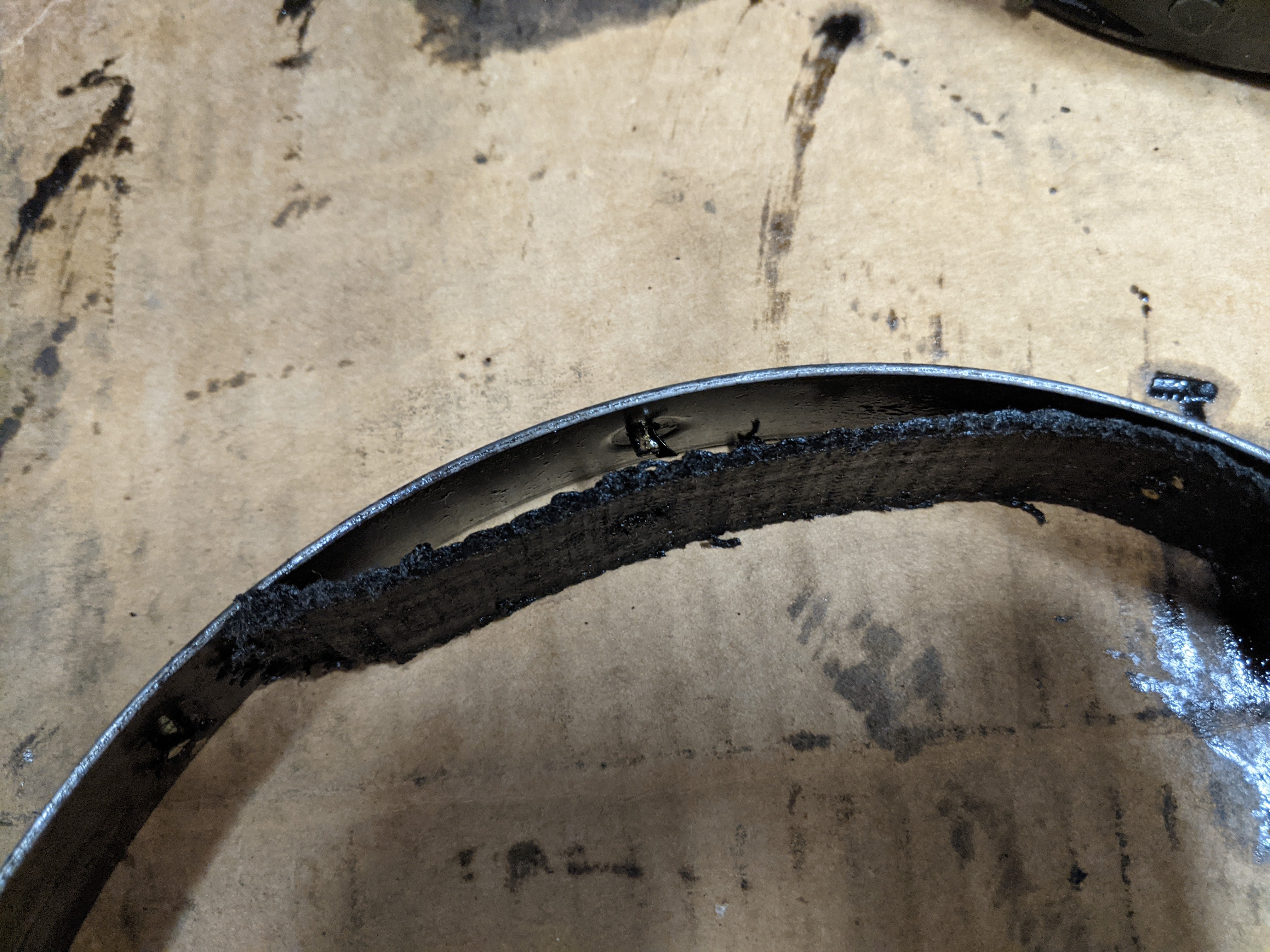

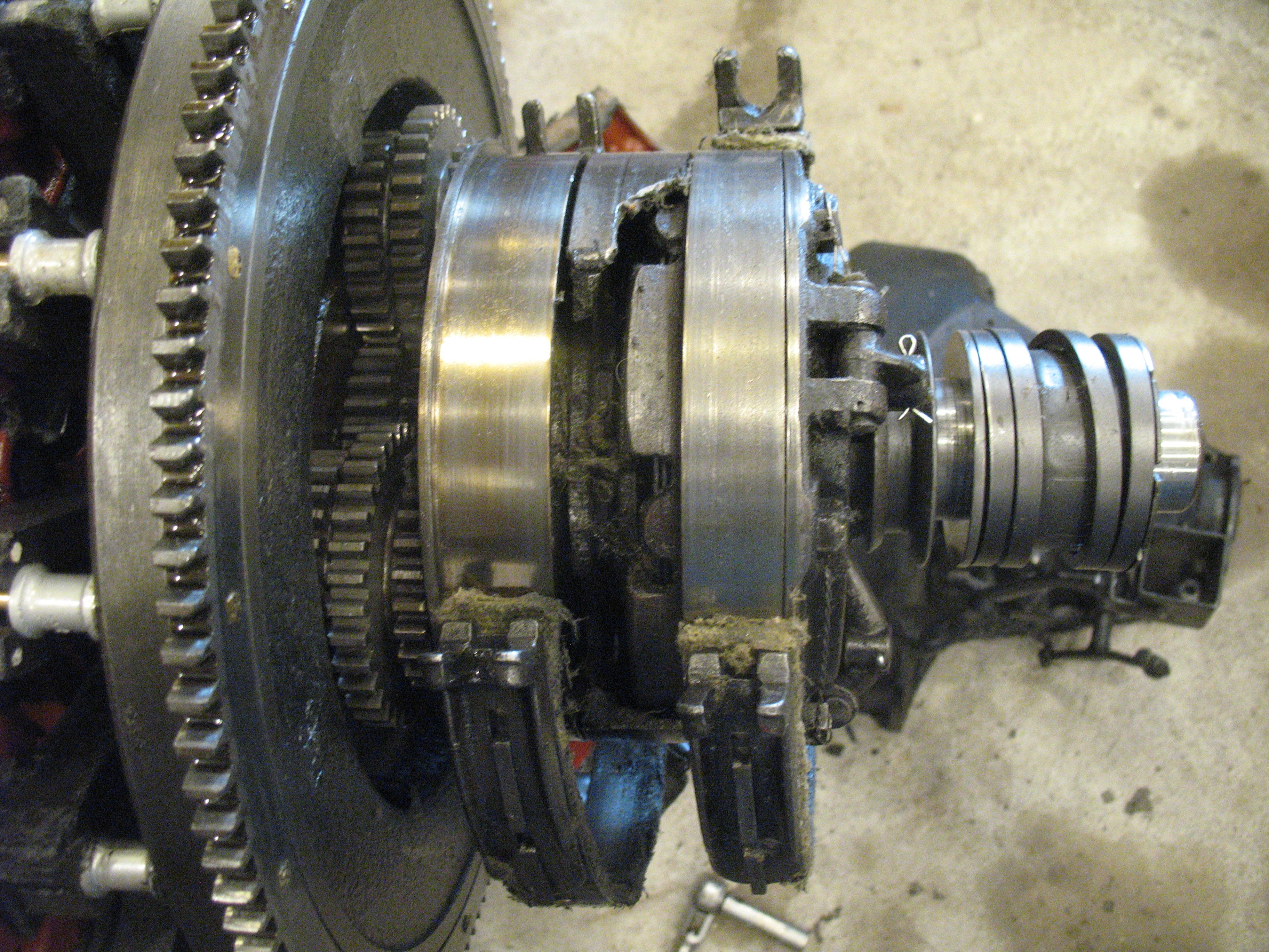

Band lining torn up indicates a cracked or broken drum, so you will probably need to replace at least one of those. An original drum may be OK for a car that isn't driven much, but if you intend to use the car a lot it's probably a good investment to get one of Dave Nolting's new drums. Many original hundred-year-old drums have cracks, sometimes unseen, that can only get worse until the drum goes to pieces. VOE
One of Dave's drums will cost a lot more than an original, but it won't do this to you.

1 "...if you did run it dry and damaged the trans you may have similar damage to the engine..."
2 "Gee whiz" accessories are often counterproductive. If you want something to help you check your oil level, ditch the float thing that betrayed you and DON'T get a brass & glass sight gauge. The only accessory I deem safe for that job is this:
Obviously, you keep the petcocks closed and only open them to check the oil level.

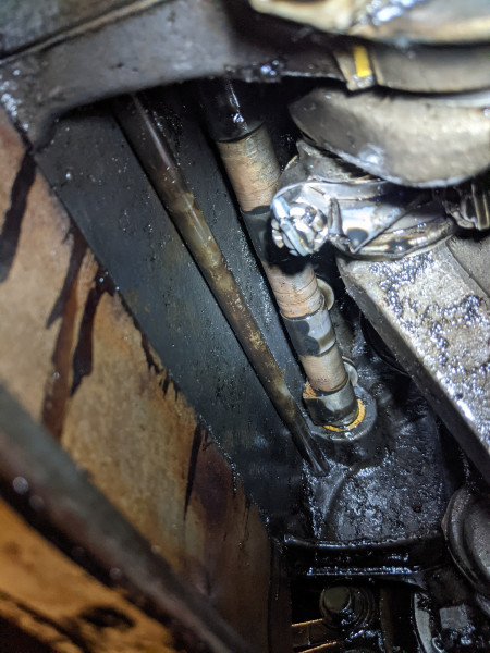

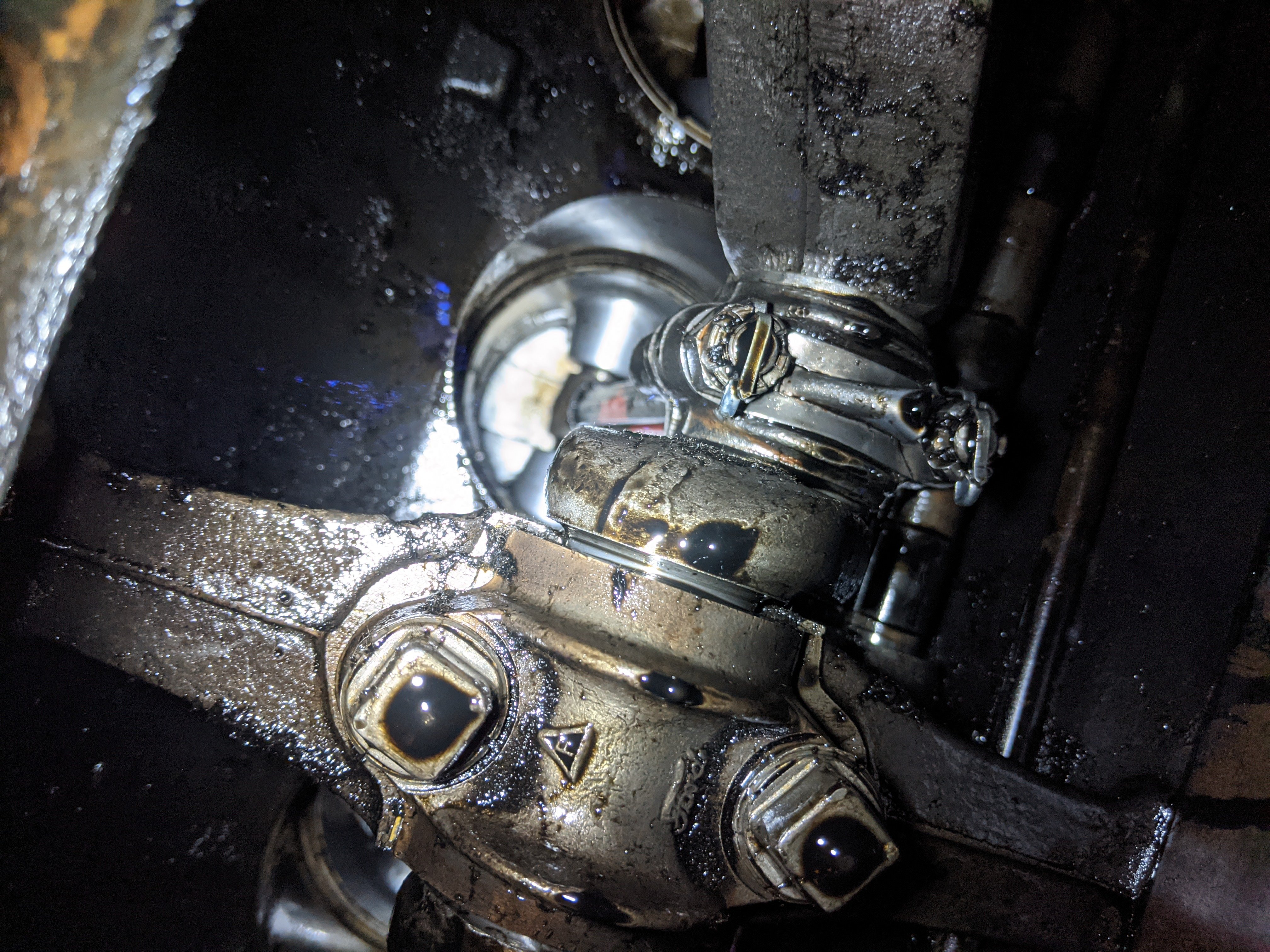

so, last night I started tearing the T apart to pull the engine. I figured id better open the inspection plate on the oil pan and take a little look inside to see what damage I'm facing. well, to my surprise, everything to my knowledge looks good. the tie rods on the crankshaft look pretty great and have only slight side-to side play. no up and down, witch I assume is good. there is no sighs of overheating and the timing gears at the front of the motor look to be in great shape. no meatal shreds to be found and cylinder walls are very smooth. there is still oil residue on everything and the dips in the oil pan inspection plate were full of oil. the camshaft looks good too. nothing is obviously warped or damaged at all. as I remember, driving home there was not much noise coming from the transmission or engine that I noticed. no knocking, grinding, pinging or anything out of the ordinary. the motor wasn't trying to seize up or bog down. there was no "hot" smell, however, the hogs head was too hot to touch, almost as hot as the exhaust pipe. I never actually drained the oil to see how much was left, I'm having some trouble getting the drain plug off. I just know it was below the bottom petcock. I think tonight ill start to remove the hogs head and see the damage in the transmission and how bad it is. do you guys think I still need a full engine rebuild or just the transmission?
Posts: 7401
Re: T transmission rebuild?
Post by Steve Jelf » Thu Dec 10, 2020 11:42 am
From your description the engine may be OK and the transmission probably is not. At this point I would leave the engine alone and pull the hogshead to see what it's hiding. That should tell you whether you need to remove the pan and replace any transmission parts. I would also have an experienced Model T person evaluate the engine and transmission to see what's needed.

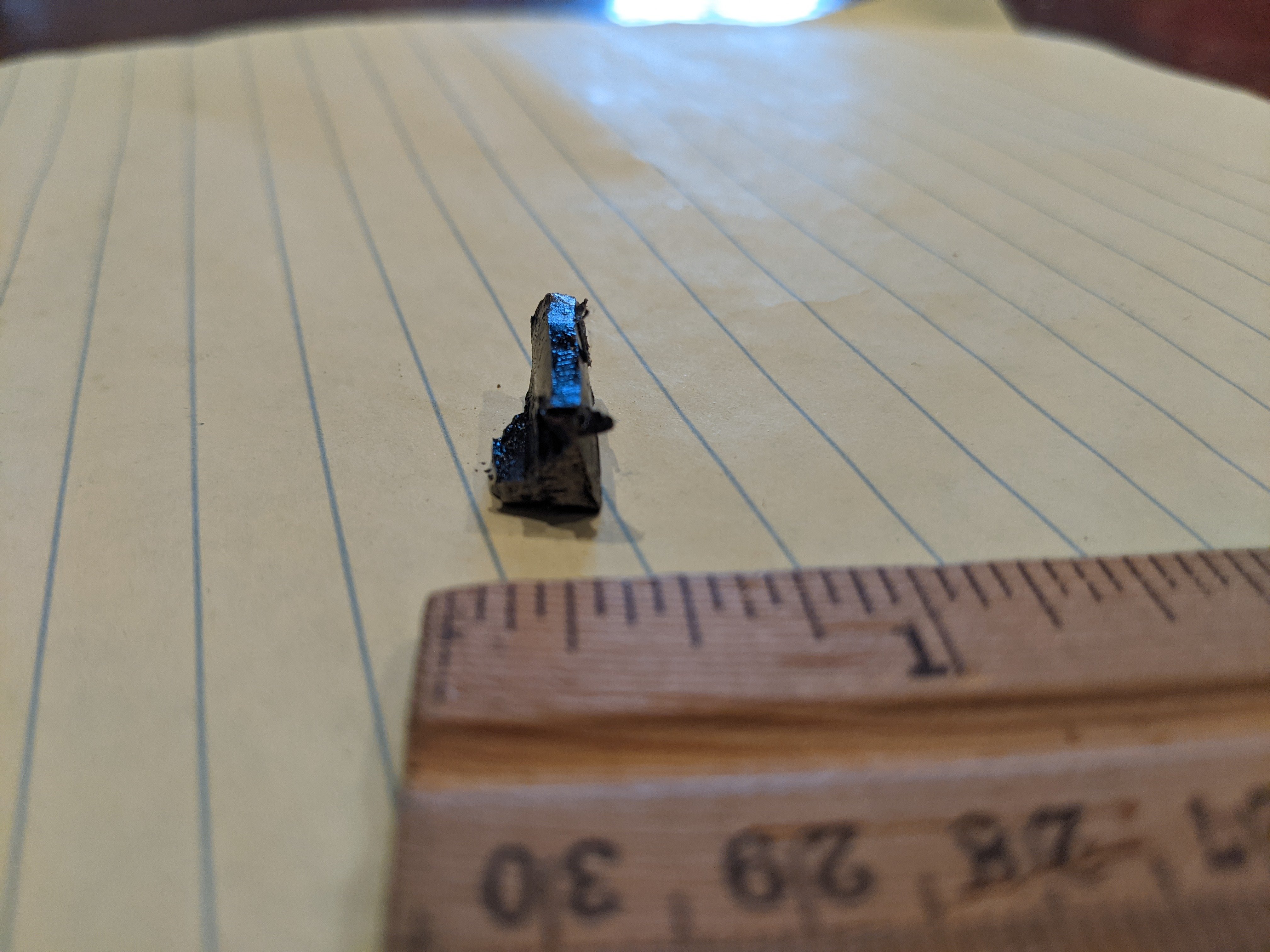

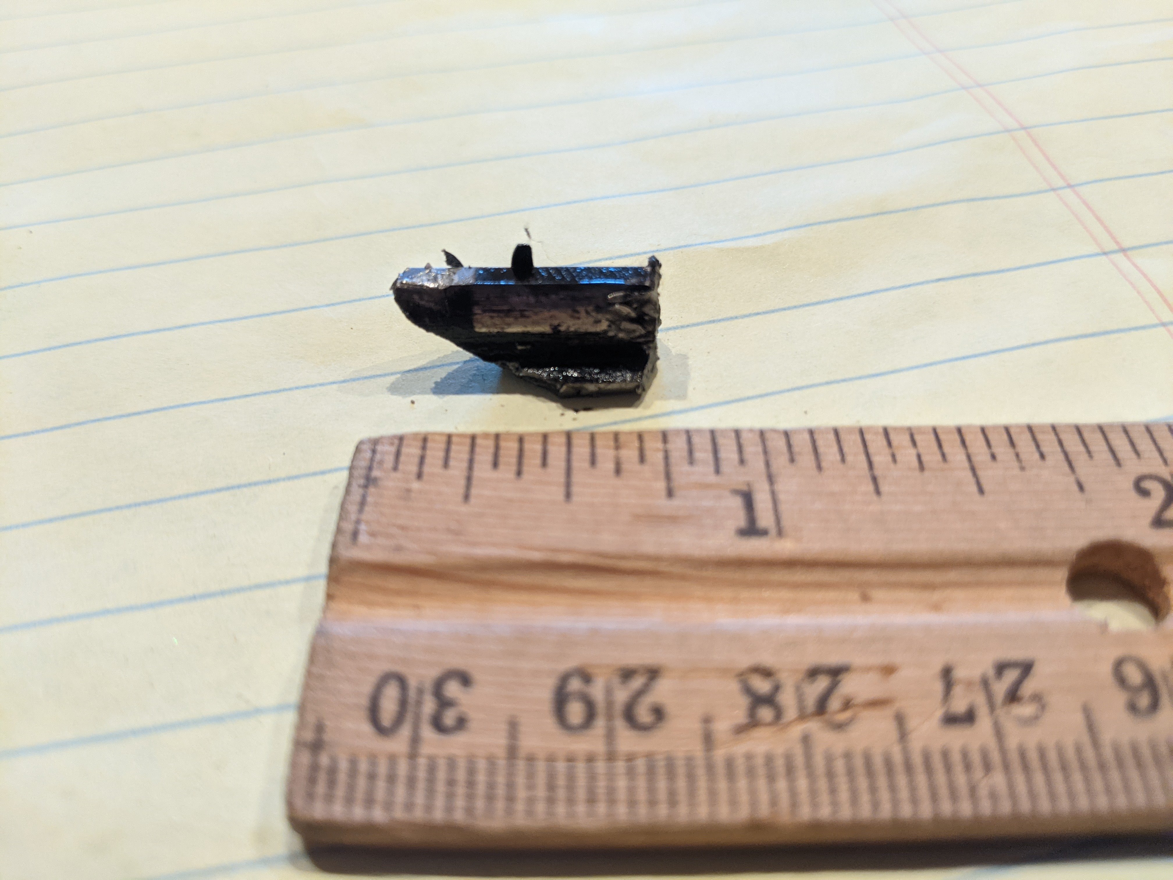

How big a chip are we talking about? Can you post a photo of the chipped gear tooth?

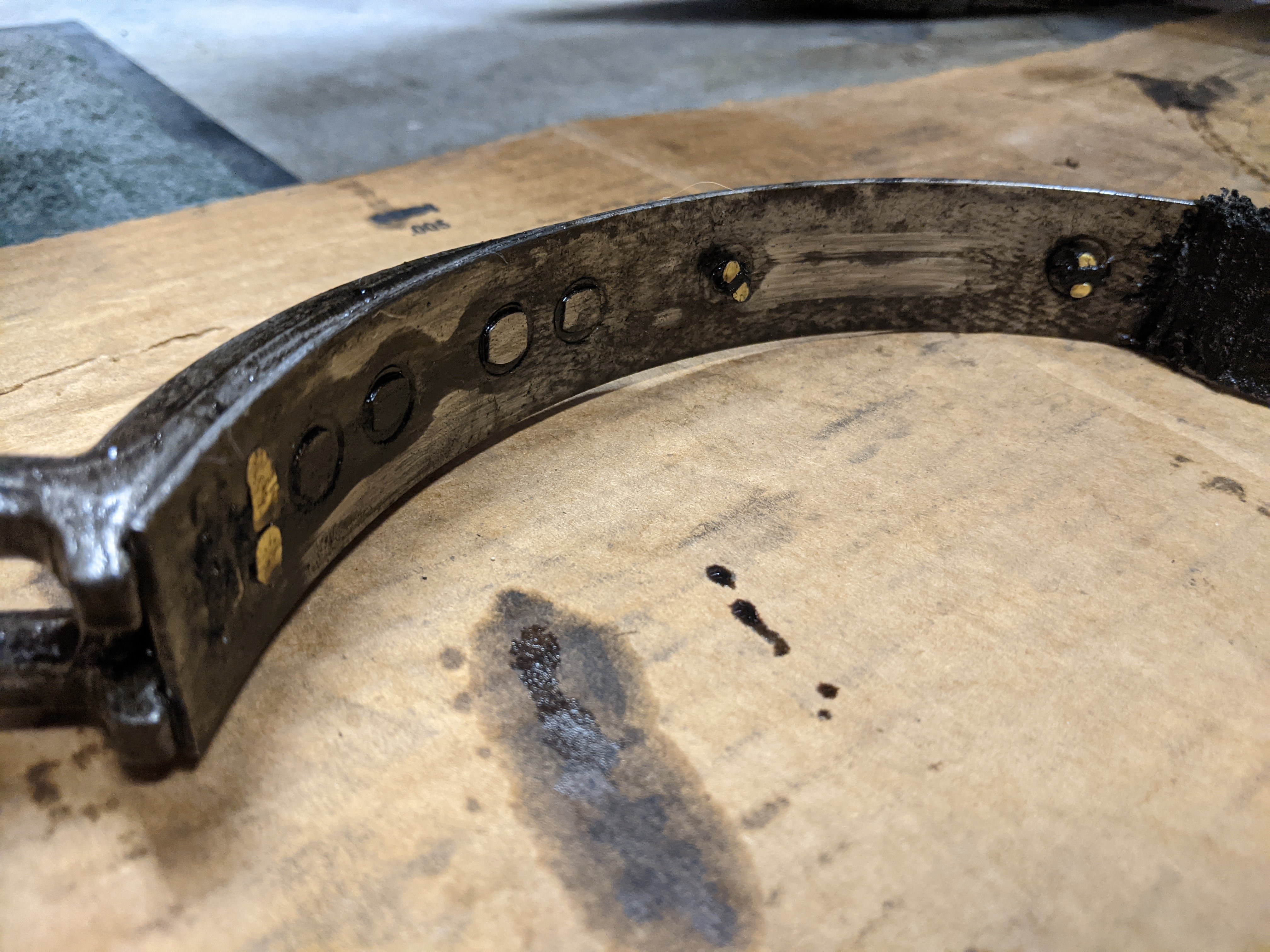

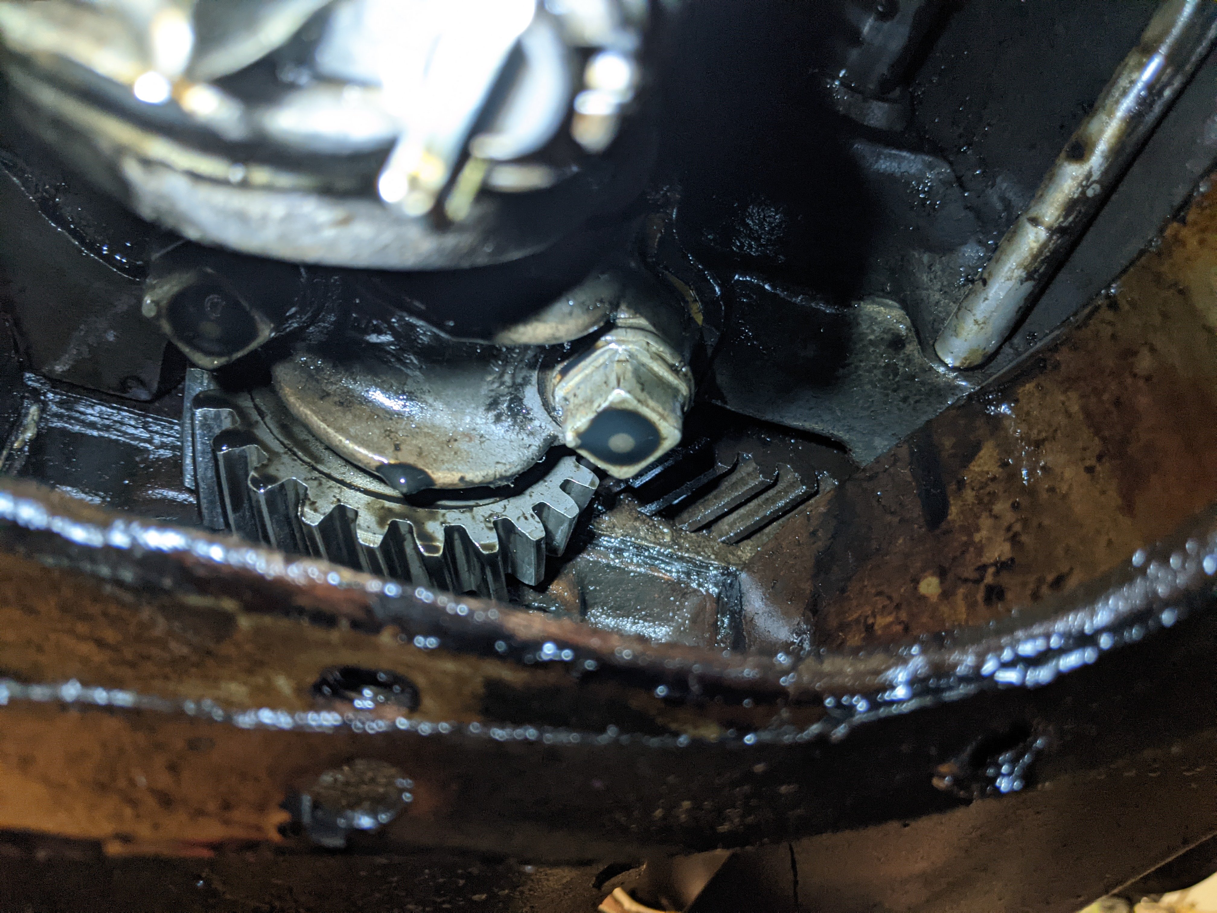

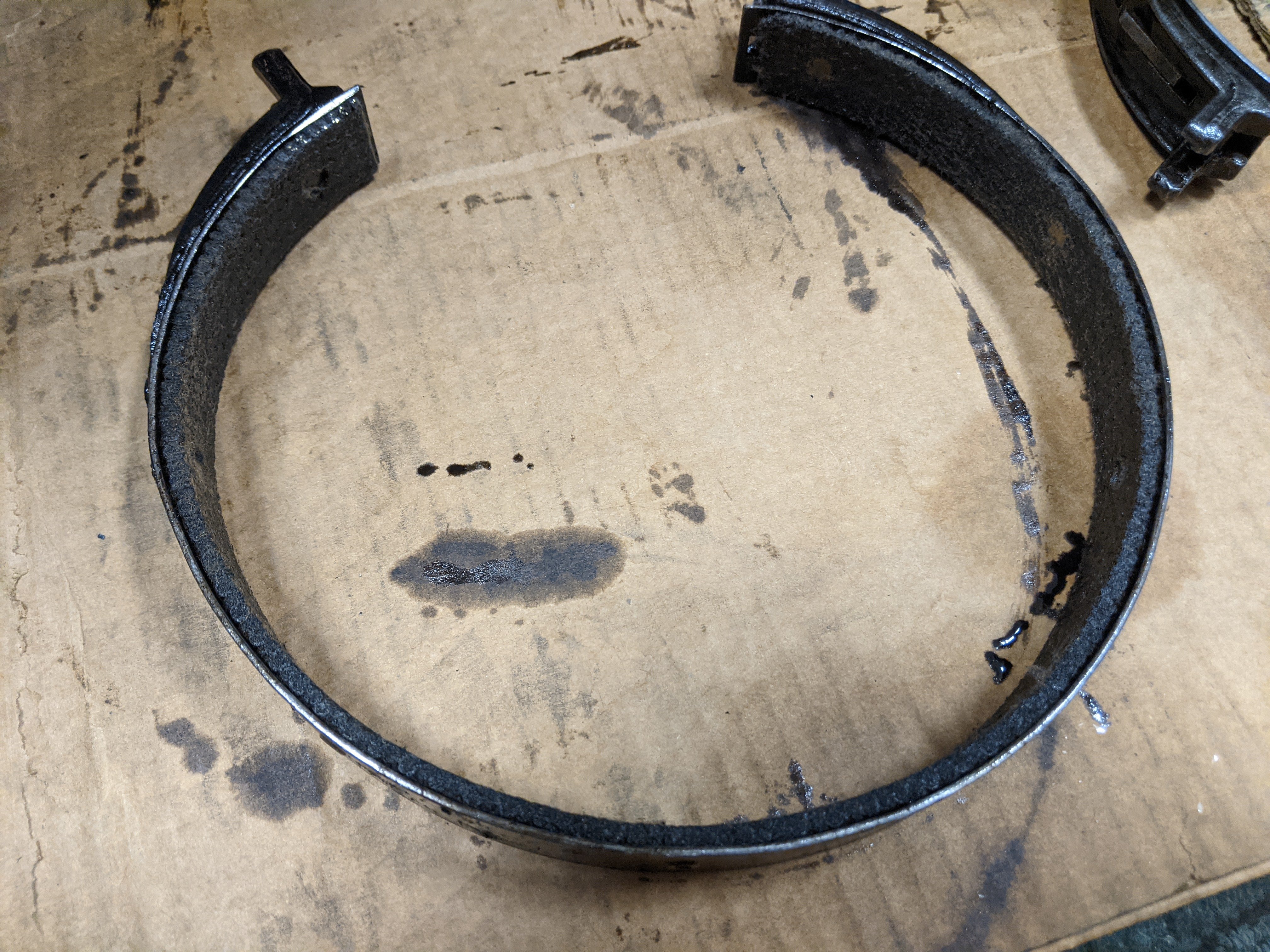

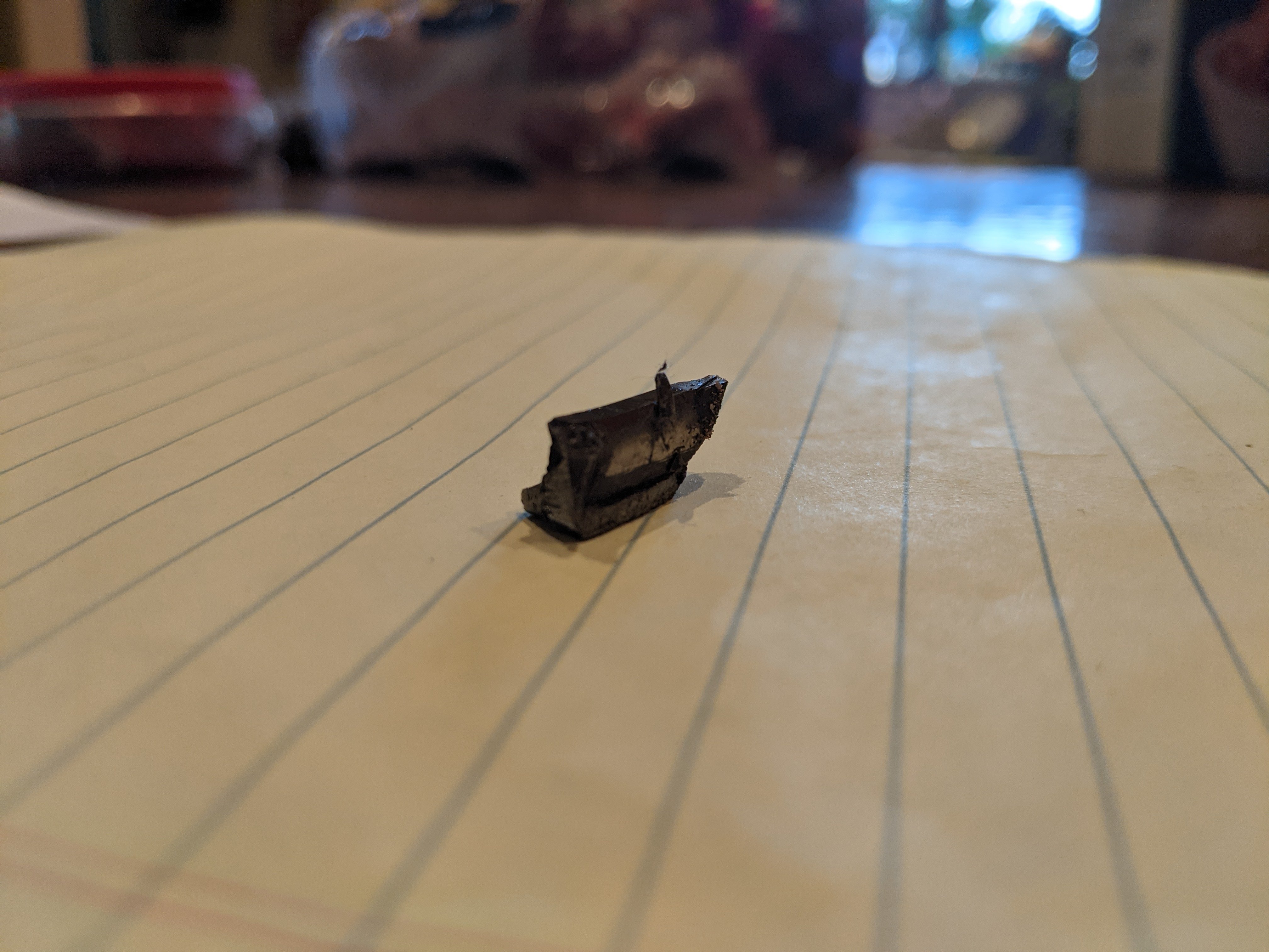

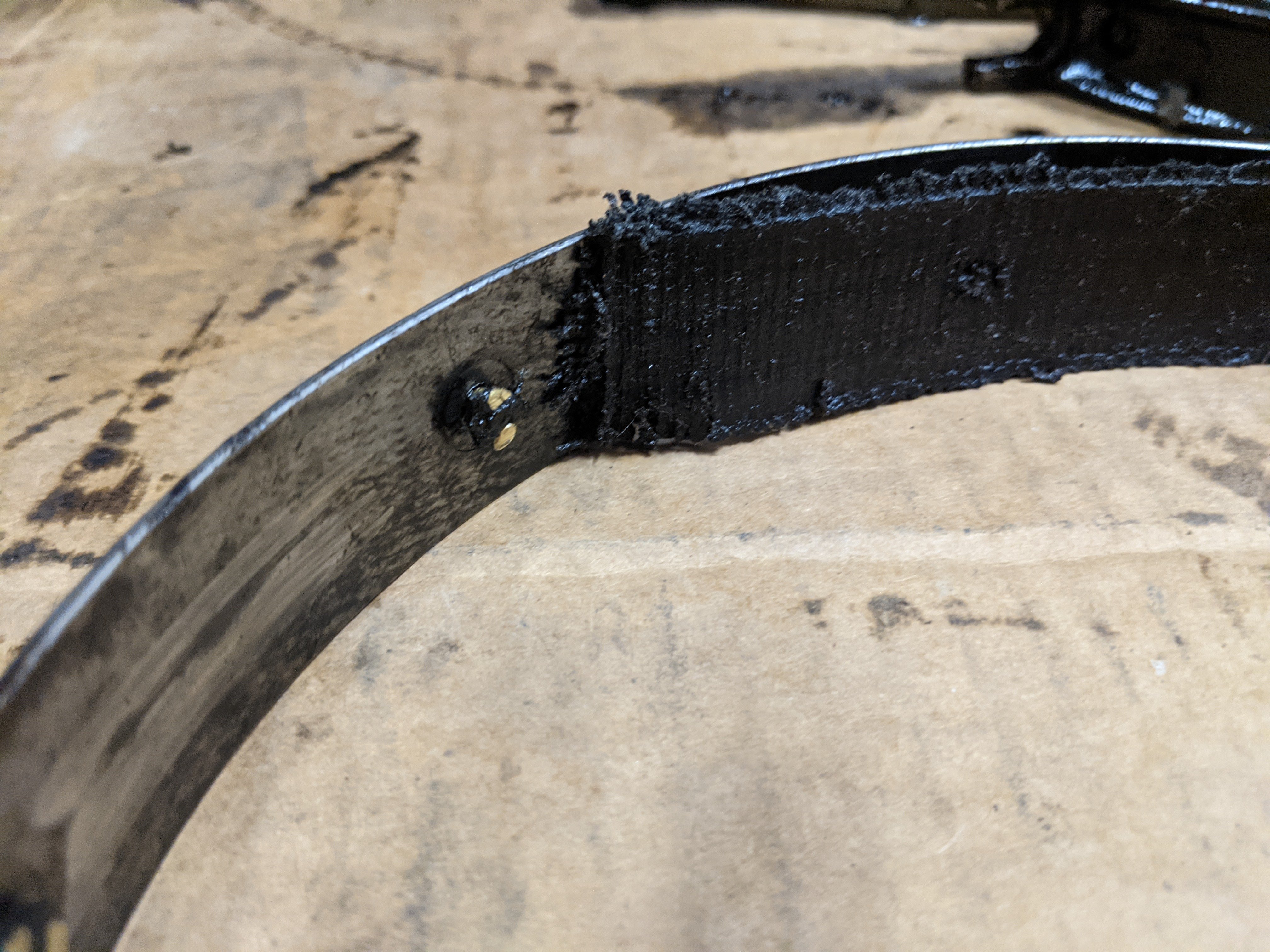

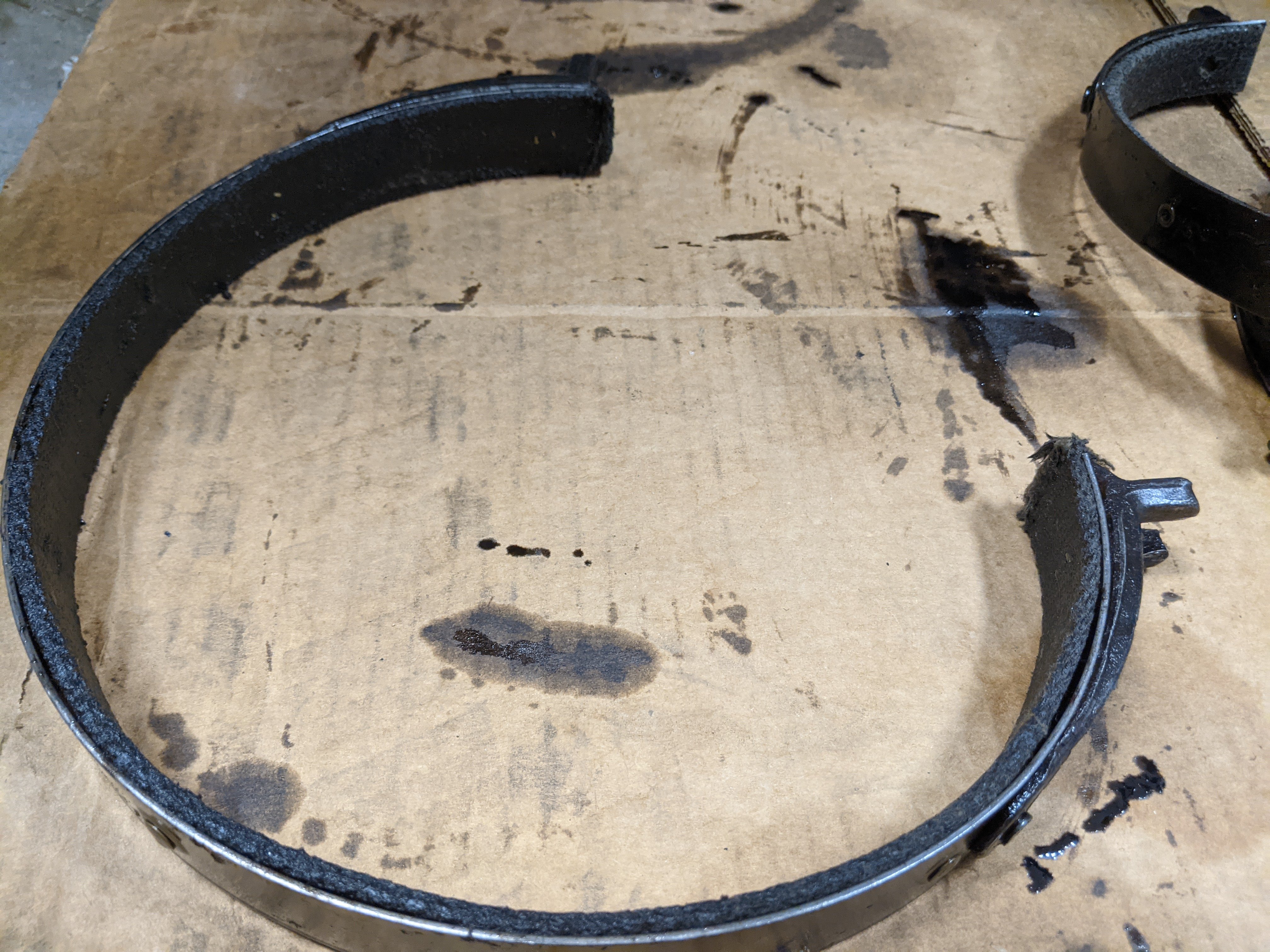

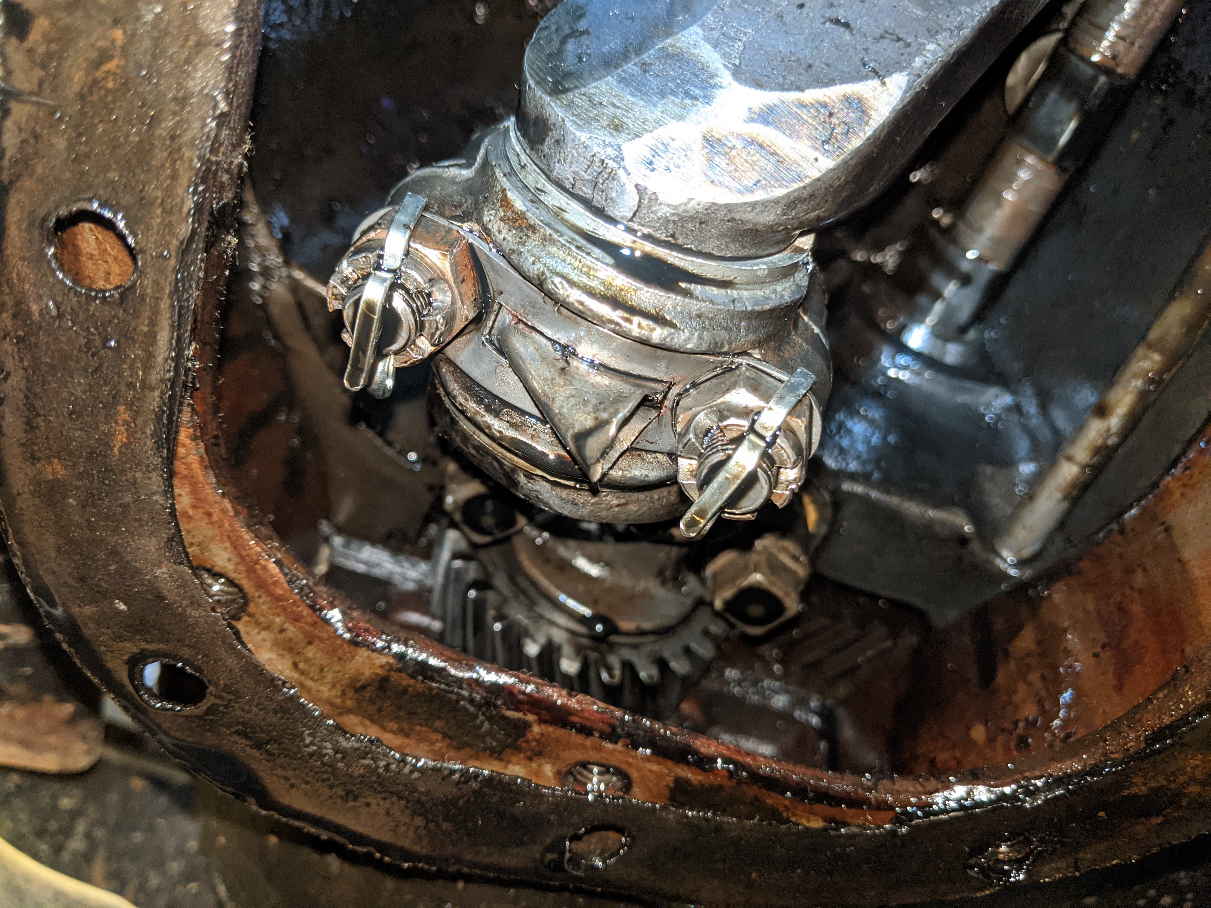

ok, I got the hogs head off last night, finally. it took me an hour and a half but i did it!
the drums are loose and have a good amount of play in them, about enough to stick a butter knife in-between. the triple gears look fine with only slight play in all but one, which rocks side to side with about a fourth inch movement. i believe the tooth came from a drum, its a little less than an inch long. could this be possible? the flywheel is torn up in some places as well. it looks like the cotton brake band got obliterated and is in clumps inside the engine and transmission. drums are not discolored and are still smooth, except the brake drum, which has grooves in it. i didn't see any cracks. there is still a slight amount of oil in the pan.

Post by Jerry VanOoteghem » Fri Dec 11, 2020 12:20 pm
That gear tooth is a problem. Time to pull the engine out.

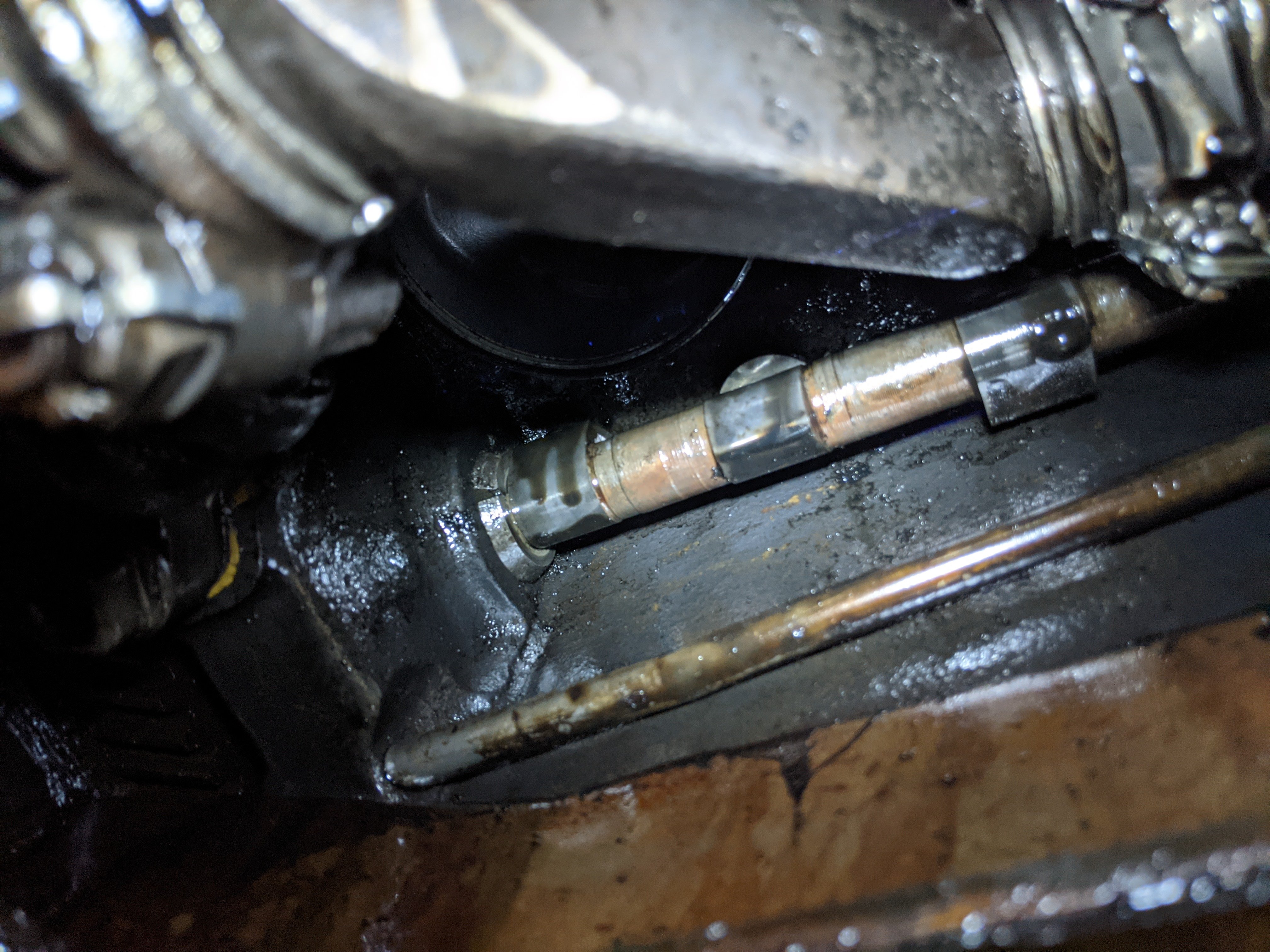

Clearly someone has been in there - aluminum pistons, oil dippers, etc. Take notice of the fiber cam gear - unless you can verify it's "an era" macerated one, you might consider replacing that with an original steel or aluminum gear to prevent a catastrophic failure resulting in "found on road dead" it won't take long for the generator to remove some teeth !
The bands appear to be late production Scandinavia "tar babies" - not the best on the market IMO. Can't distinguish what the metal chunk is - did you verify it was a triple gear tooth or ???

Post by RajoRacer » Fri Dec 11, 2020 1:05 pm
The first photo of "the chunk" appears to have a gear tooth mark - interesting !

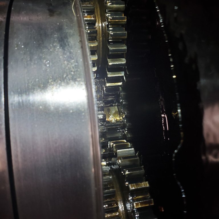

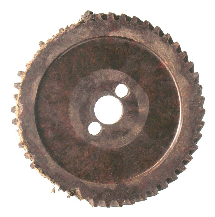

That by itself demands pulling the engine, taking off the pan, and removing the transmission. I expect the wobbly triple gear is seized and has wrecked the flywheel. I don't recognize the "tooth", but I suspect it may be a piece of drum and was part of chewing up that band lining. The engine may be perfectly OK except for needing all the band debris cleaned out of it, but you will at least need to pull the oil tube for a thorough cleaning. Diagnosing an engine's condition from photos is beyond me. I would want an experienced Model T specialist to inspect it.

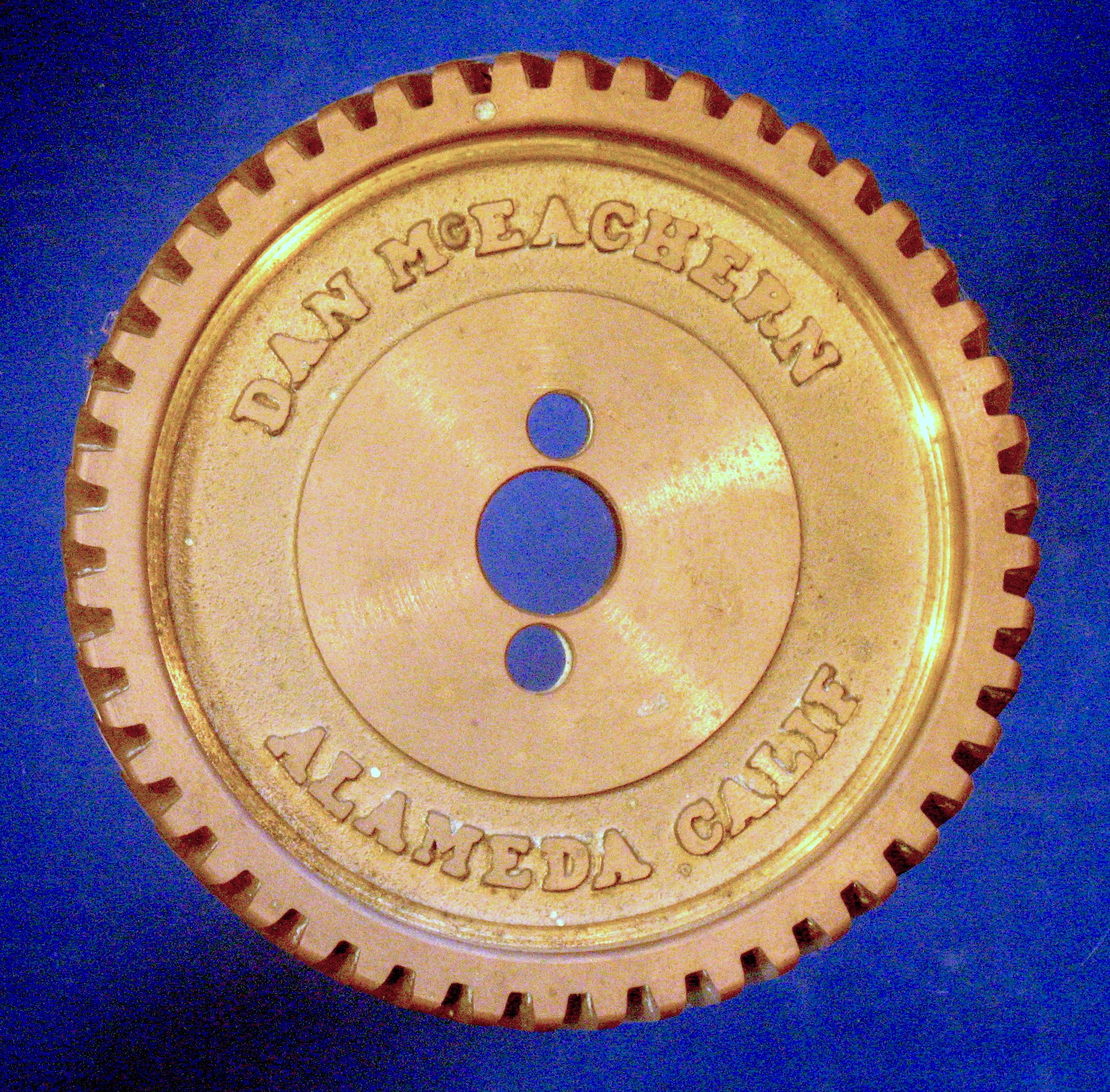

If that is indeed a fiber timing gear, in my book there's no might consider about it. Don't gamble that it may be OK. Get rid of it. Replace it with original steel, new aluminum, or new bronze. I believe bronze is best.

Post by Allan » Fri Dec 11, 2020 5:16 pm
If the metal piece is a gear tooth, it's not from the triple gears. The rule shows it to be almost 3/4" wide, wider than the teeth on even the earlier tree piece gears and the driven gear. The transmission needs to be stripped to investigate.
Posts: 4410
Post by Jerry VanOoteghem » Fri Dec 11, 2020 6:38 pm
Pretty sure it's a tooth from one of the drum gears, (sun gears).

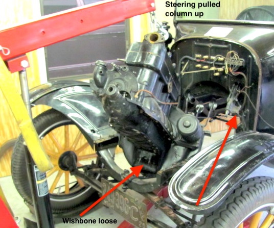

Just remove the four bolts that attach the drive shaft housing to the transmission and the u joint will slip out of the transmission as you pull the engine out.
Stephen
Mr man
Posts: 67
Joined: Fri Jan 17, 2020 6:51 pm
First Name: Carson
Last Name: Combs
* REQUIRED* Type and Year of Model Ts owned: 1924 touring, 1923 roadster pickup project
Location: Las Vegas, Nevada
Post by Mr man » Sun Jan 31, 2021 10:26 am
great! thanks Stephen
Posts: 7401
Post by Steve Jelf » Sun Jan 31, 2021 1:45 pm
Don't forget to drop the wishbone. :)

Post by John Warren » Sun Jan 31, 2021 5:05 pm

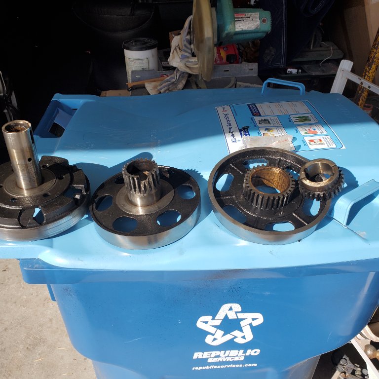

I stoppedby Carsons, this is where the transmission failed. Low drum gear.

by the way, does anyone know if I need to remove the steering column to remove the engine? or can the motor be maneuvered around it?
Posts: 7401
Post by Steve Jelf » Mon Feb 01, 2021 11:59 am
I don't remove it all the way, but I undo it at the bottom and at the firewall and set the steering wheel back on the seat. I've never tried it with the column in place because it looks to me like it would be more hassle than it's worth. See Pages 50-52 in the Service Manual.
As you remove the various nuts and bolts it's a good idea to put them in little bags or envelopes and label where they go. Eventually maybe you won't need to do that, but the first few times before you learn to recognize everything it will simplify reassembly.
Posts: 4057
Post by DanTreace » Mon Feb 01, 2021 1:57 pm
Like Jeff posted, pull the steering column up and behind the dash, you need that space at the lower frame to pull the motor. Lots of little stuff to remove, plug and gen, starter wiring, drain the rad, and remove it with the hoses attached to the radiator, by removing the upper and lower outlets. Remove the fan and timer with wires. And remove the metal hood shelves, makes it easier to first slide the motor out with the pan ears gliding on the frame rail. A bit of grease on the frame rails too helps the slide, both out and back in.
Remove the 4 bolts at the u-joint, and remove the 4 bolts holding the engine to the frame sides, plus the cap on the motor/spring mount. Lastly, don't forget that darn wishbone, that has hung up a lot of engine pulls ;)

Post by John Warren » Sun Feb 21, 2021 1:37 pm
This is Carson's transmission drums. The gear on the low drum is galded and broken and the bushing is scored and loose. I'm thinking not enough clearance when installed.
[/size][/image]
