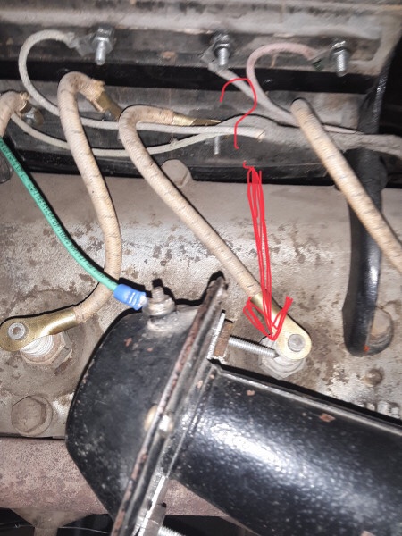

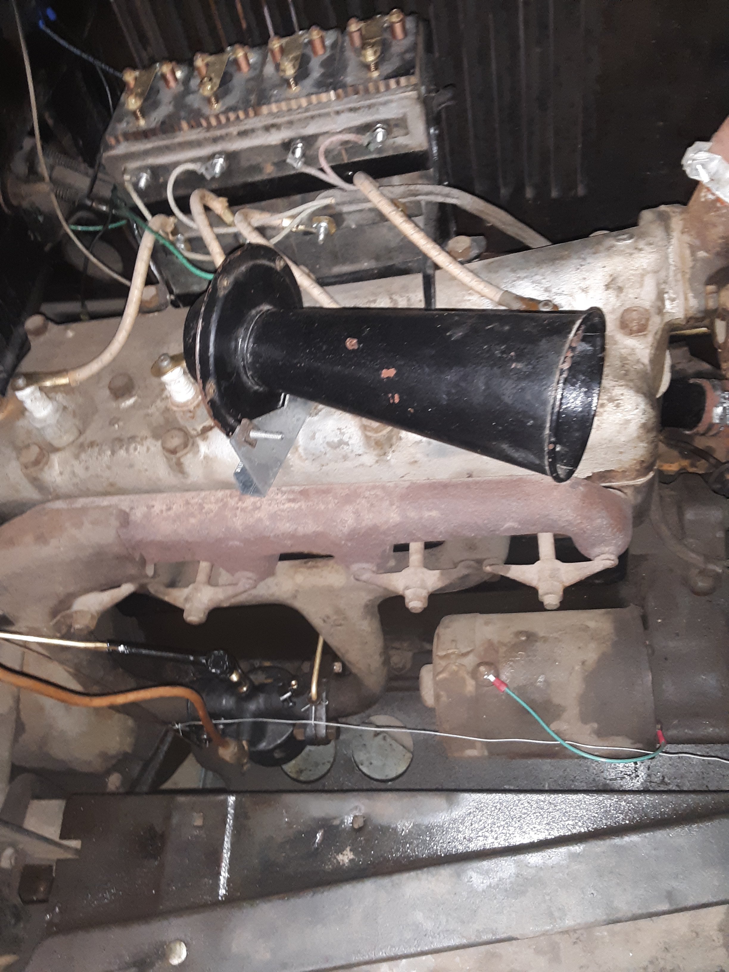

I hooked up a MAG horn 2 my 26 Model T. I connected the horn's body to ground and the terminal to a switch and then to the Magneto. When I ran the car on a MAG and turned on the horn, the engine died. What am I doing wrong? Is the horn taking too much of the Magneto power?

Post a picture of your horn.

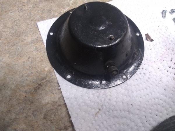

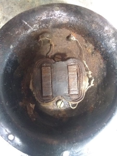

Guess is the horn's coil is bad and grounds out causing a direct short, taking all the AC current to ground.
Remove the cover and test the coil for conductivity at the terminals.

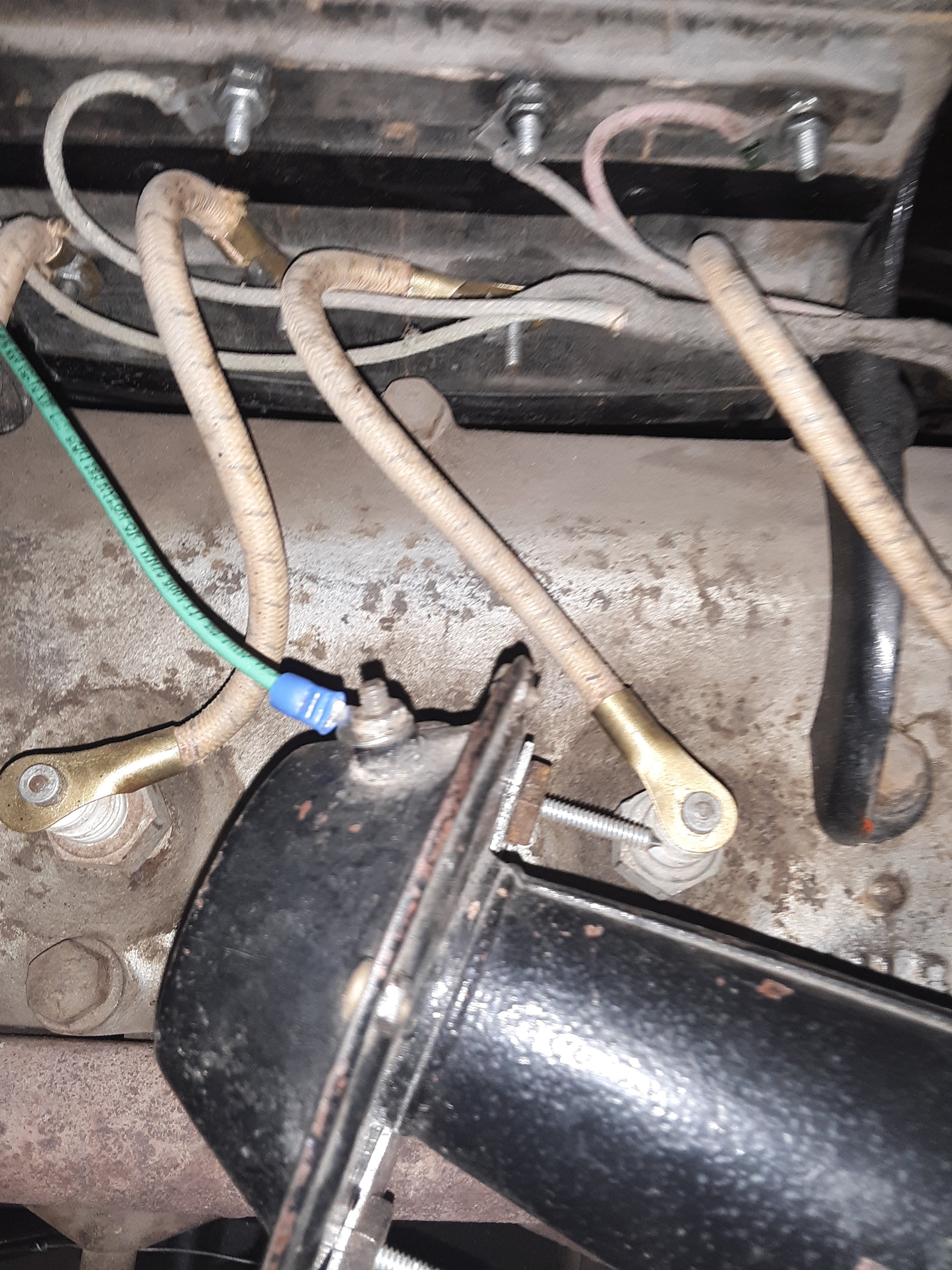

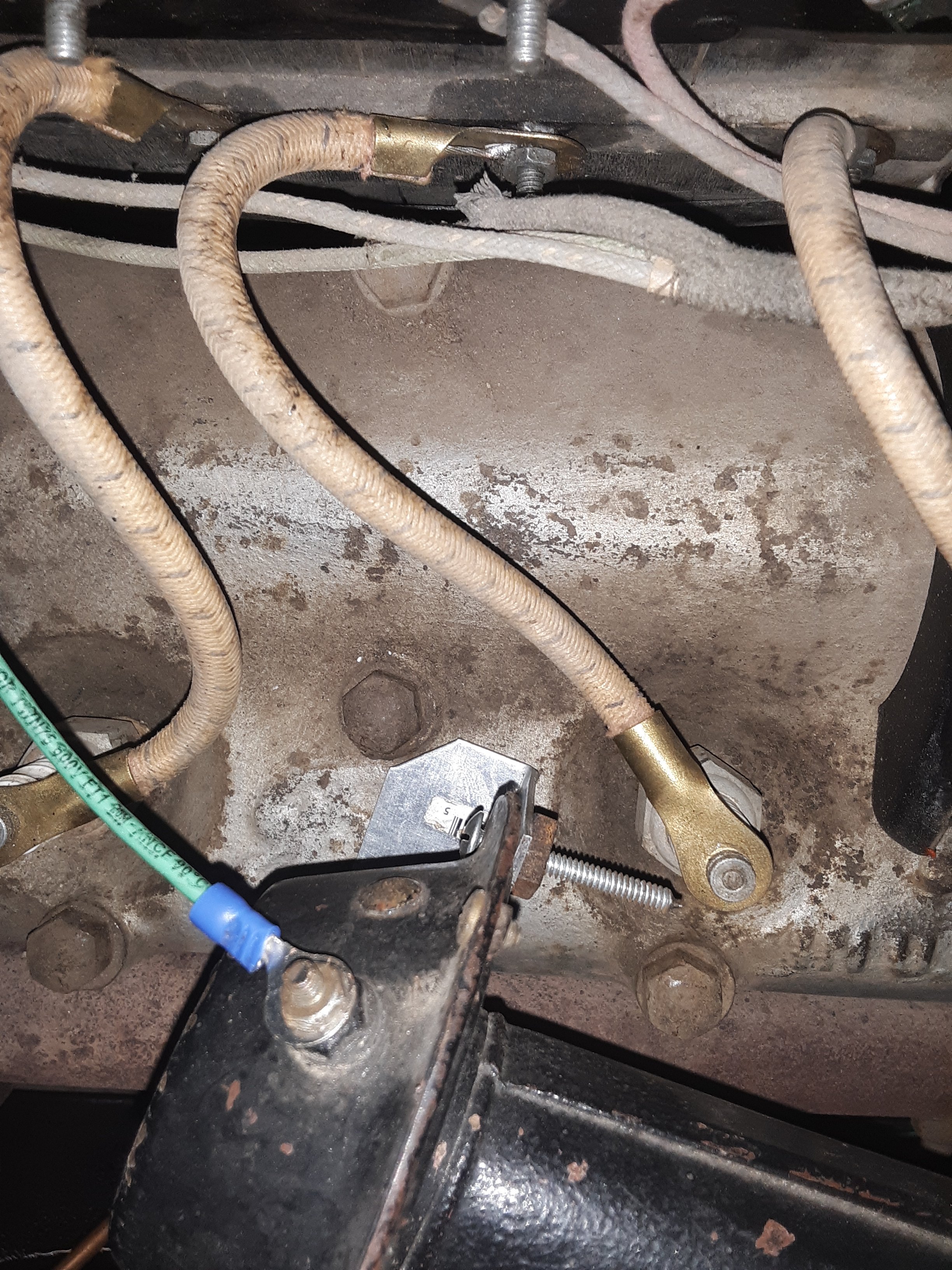

How close is that screw to the spark plug? Is the plug shorting to horn?

I think the spark plug shorting to the long screw, (which should be trimmed), would simply send the high voltage directly to ground, which shouldn't hurt anything, aside from ignition in #2 ;) .
