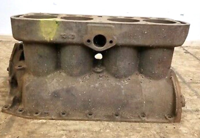

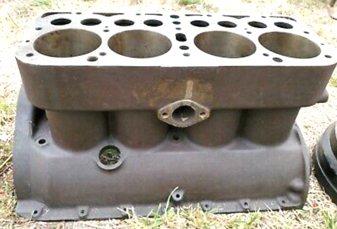

Easy to tell bare Model A block vs Model T block, the Model A has oil filler on opposite side. Model T block oil filler is on manifold side. Lots of other difference.
Model T
Model T

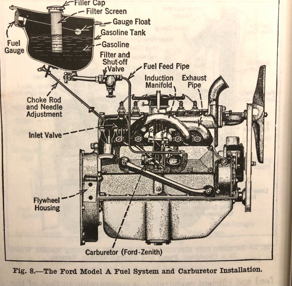

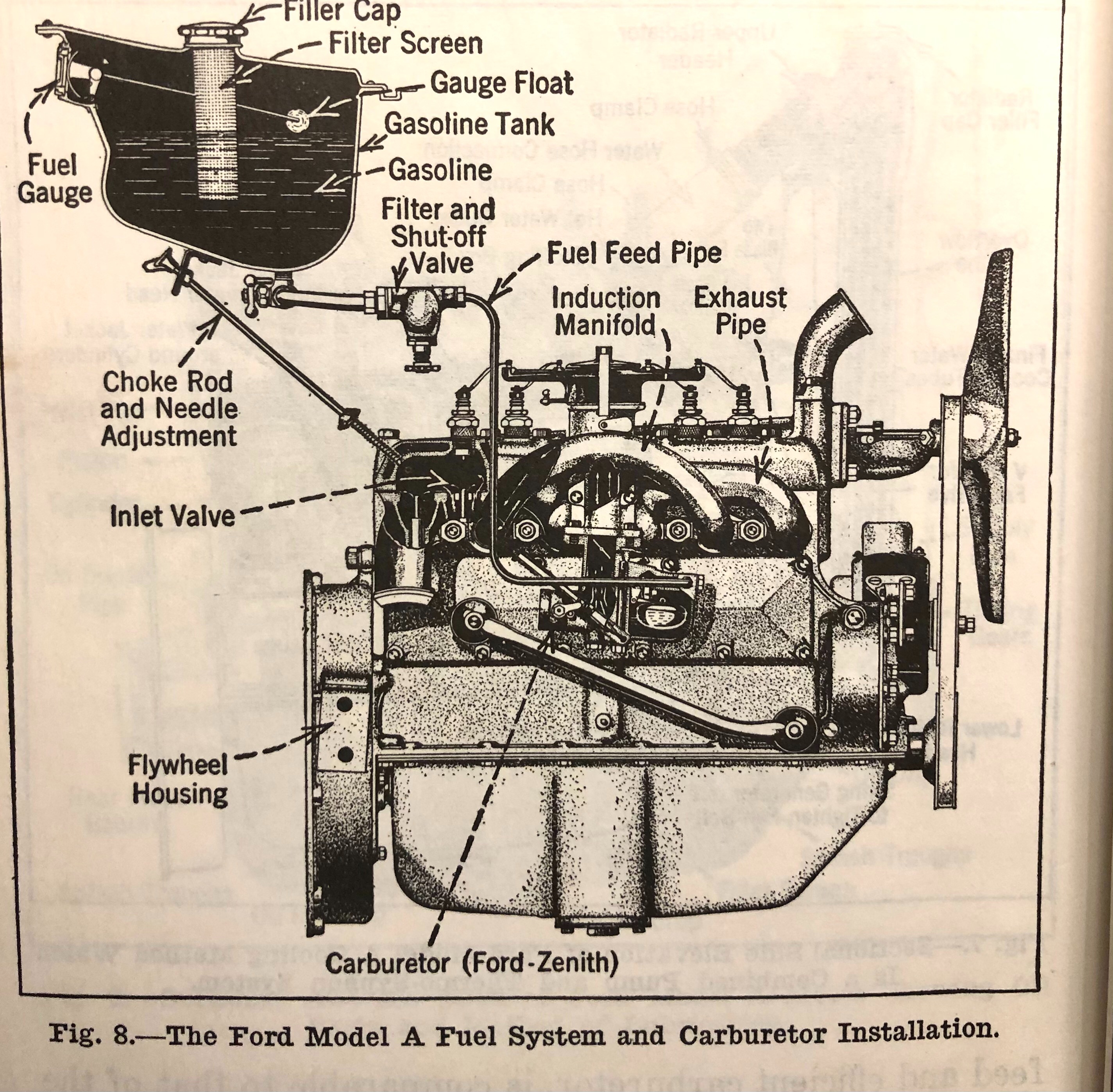

Re: Difference between an a and t block?
What kind of carburetor system did the A have?
- Posts: 3977
Similar system to T, but larger carb, and intake something like the late T Vaporizer, since it mounts to the exhaust manifold to preheat fuel vapor for best combustion. Ford-Zenith carb.
