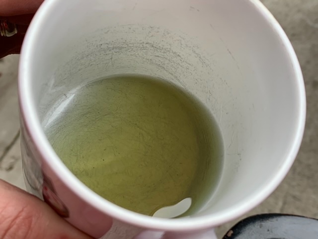

Went back out today, in the 50s, and tried again with no luck. Checked compression (all cylinders low 50s), checked spark, etc. I decided to see how the fuel flow was, so I opened the carb bowl petcock and the flow was good. Looked at the gas and immediately saw discoloration (bottom pic).
I decided to see if the discoloration (and possible contamination) was coming from the tank or was only in the carb bowl. I drained the carb bowl completely and then began filling another cup with gas I knew was fresh from the gas tank and had only passed through the carb. That gas looked good.
I decided to try and start the T up normally and she came to life. I drove the 13T around town for about seven miles and things seemed pretty good. I will take off the carb bowl in a while to see what’s going on there. But would you say contaminated gas could be my culprit?

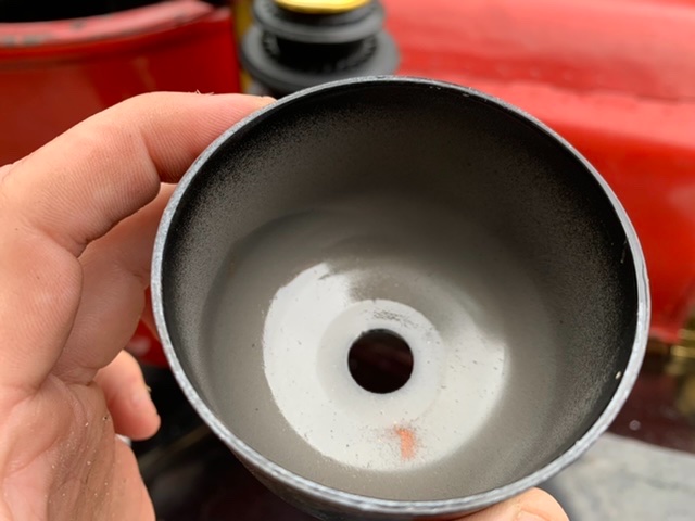

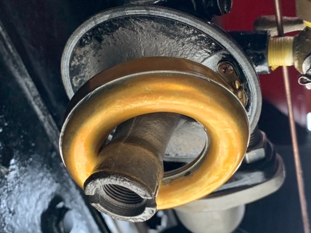

Inside of the carb bowl. Didn’t see any sludge in it. Should I drain the gas tank’s petcock to see what comes out of that?

Am I seeing the remains of paint on the inside of the cast iron and top of the inside of the bowl? Painting these parts is a no-no as dissolved paint plugs some passages. I would also suggest that you check the actual fuel level in the bowl while you have it off the car (1/4" clear tygon tube attached to the drain and extended up the outside of the bowl with gas supplied through a funnel into the inlet.)
- Posts: 4400
Re: 13T - Starting issues and mixture adjustments
Good thinking on the paint! Broken down paint could be why the gas in the bowl is discolored? Also, looks like flecks of paint have fallen away from cast iron.Bruce Compton wrote: ↑Sun Dec 20, 2020 11:36 pmAm I seeing the remains of paint on the inside of the cast iron and top of the inside of the bowl? Painting these parts is a no-no as dissolved paint plugs some passages. I would also suggest that you check the actual fuel level in the bowl while you have it off the car (1/4" clear tygon tube attached to the drain and extended up the outside of the bowl with gas supplied through a funnel into the inlet.)

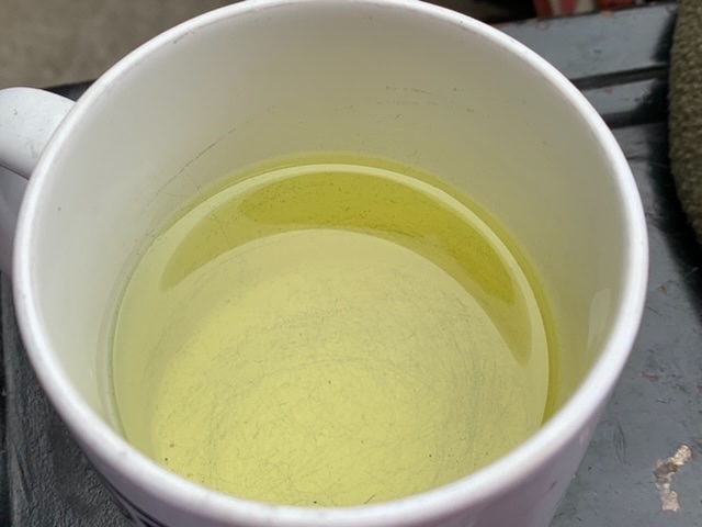

Drained the sediment bulb. A few very tiny bits of debris but overall, the gas looked good.

As to not being able to flood it, even if you try to, have you checked your carburetor float level? Maybe not enough gas in the bowl. If the float/bowl level is too low, the gas will sit way down below the jet and need more vacuum than you can create by cranking, to pull the gas up high enough to get it past the needle valve and into the venturi. Since the choke butterfly isn't exactly a perfect seal, even that may not be sufficient to pull up fuel from an underfilled bowl. Have you tried hand choking it?
