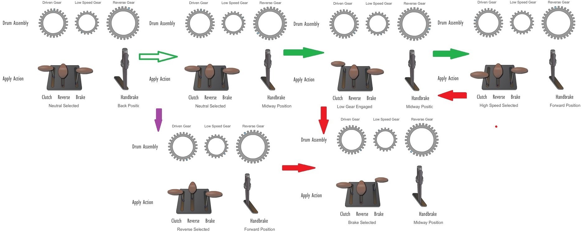

Speaking of synchronization the levers...
- Posts: 6546
Re: Driving question
This link has animation of how the gears engage as you change position of the handbrake lever and pedal usage . The animation may take a little bit of time to load t hen you can click on the handbrake and pedals
https://www.modeltcentral.com/transmiss ... #animation
Try these sequences and watch the drive gear. I welcome criticism of the sequences - thinking pictures help

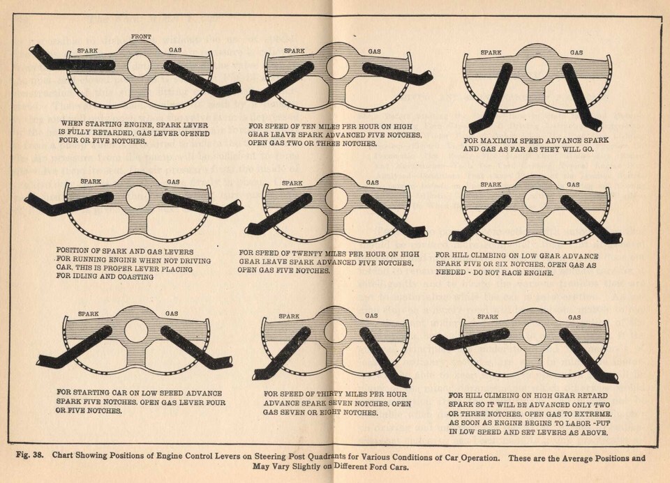

The chart Jim posted showing many different throttle and spark lever positions applies to running on battery. When running on magneto there are only three spark positions. It's customary to start on battery and switch to magneto, in which case you can forget about the chart. Just move the lever down to where the car runs best.

The short answer is that you can put the parking brake handle in the most forward position most any time, depending on where you place the other controls and what you intend to do next. But you should start with a good understanding of just what the parking brake handle does in its various positions.
1. With the PB handle pulled fully aft, the clutch pedal is depressed to the mid position (neutral) and the rear brakes are applied. In this position, the car should not roll, but the engine can be started.
2. With the PB handle in mid position, the clutch pedal is still depressed to mid position (neutral), but the rear brakes are no longer applied. If you move the handle to the mid position, you'd best be in the driver seat with the foot brake applied or be on level ground.
3. With the PB handle in most forward position, the clutch pedal is fully released (HI gear), and the rear brakes are not applied. If you move the PB to this position with the engine running, you'd best be in the driver seat with both the foot brake applied and the clutch pedal depressed half way down, ready to drive.
With the above understanding of the three PB handle positions, you will understand why all the other recommendations have been made.
