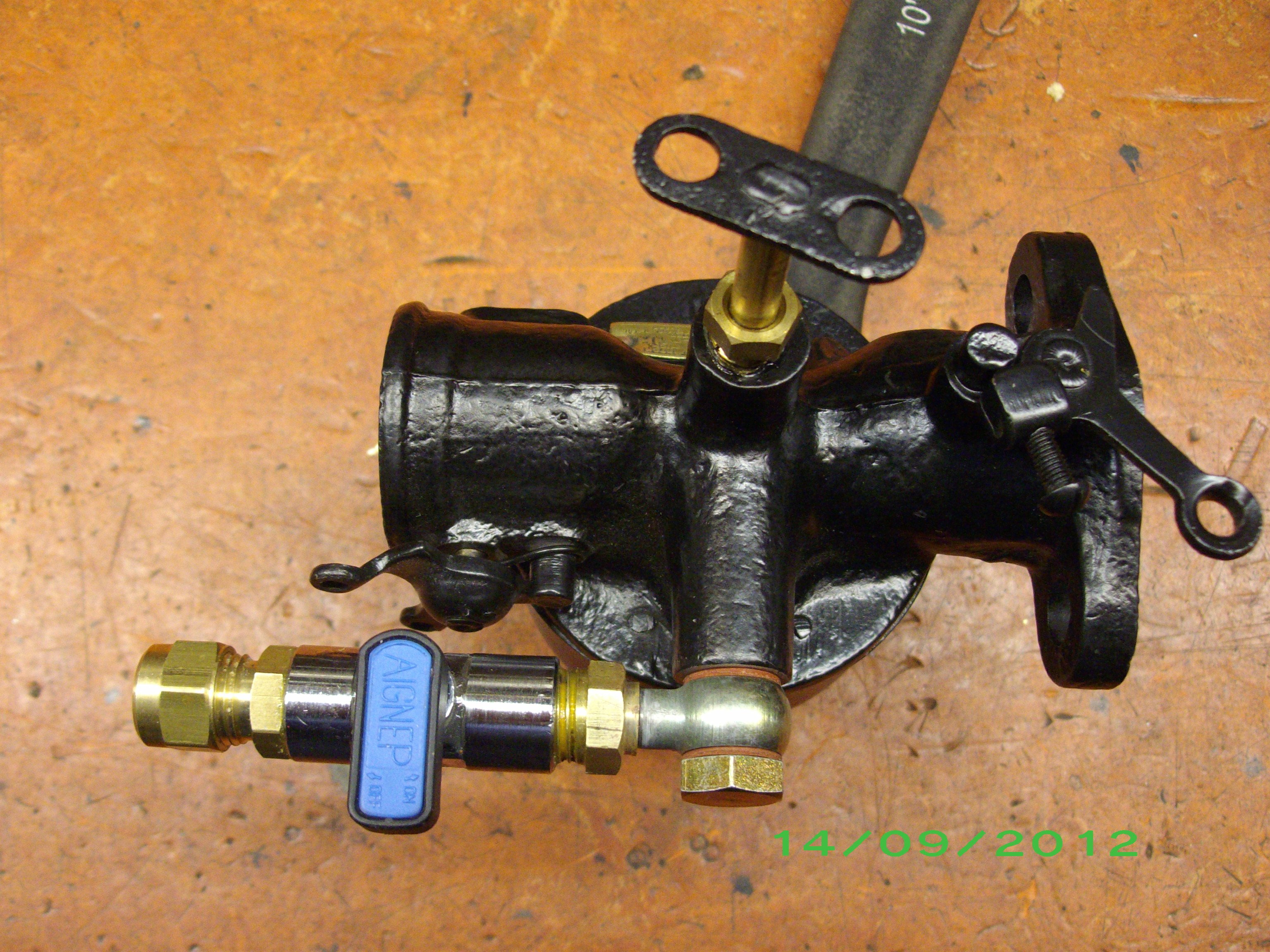

I had that problem with every one of the shut offs. I talked to Lang's and bought a tube of "airplane" lube they sold, it didn't work. Unless you are set on having an original looking shut off, I would go to the newer "ball valve" type. They seal and work!!!

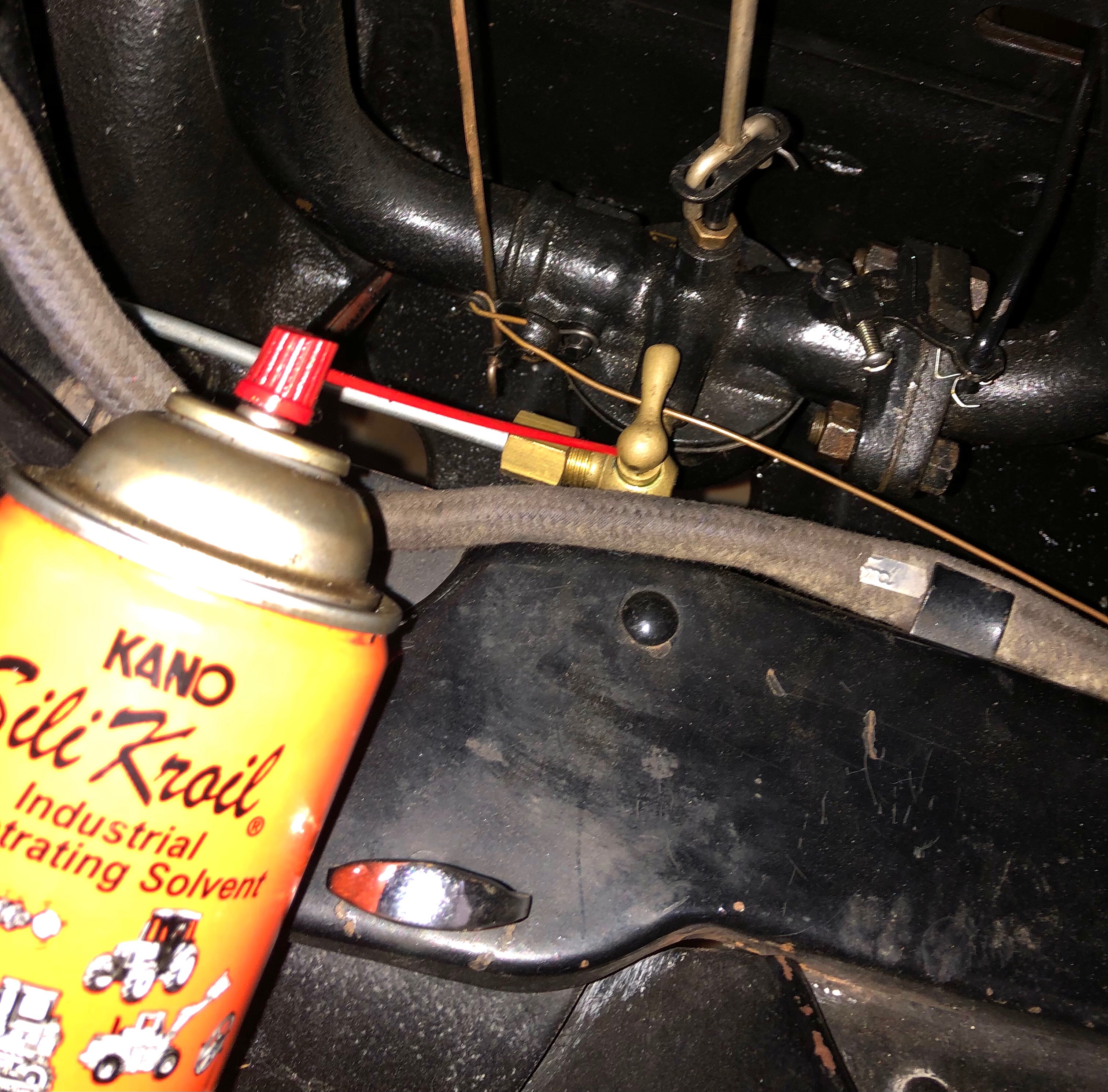

Apply your favorite penetrating solvent when you notice sticking. Of course, adding MMO to your tank provides good lube and keeps your engine valves from sticking too :P
