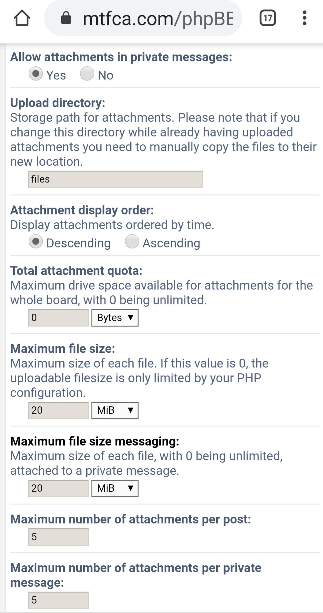

This is the attachment size setting.
20 MB
20 MB
