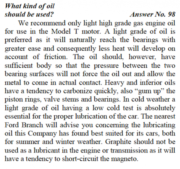

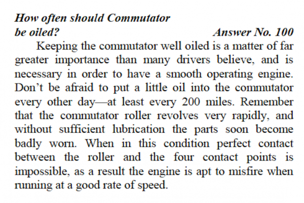

I believe the Tiger is essentially a copy of the Ford timer. Here's what the 1919 Owner's Manual says:
I know one Model T expert who packs his timer full of Mobil red grease, and apparently it works. I use New Day timers, so I have no first-hand experience.
What is "light" or "medium light" engine oil? Those are old terms for 20W. But a modern multigrade (5W-20) is not the same. Some of today's T experts who drive long distances use 15W-40 and 20W-50.
