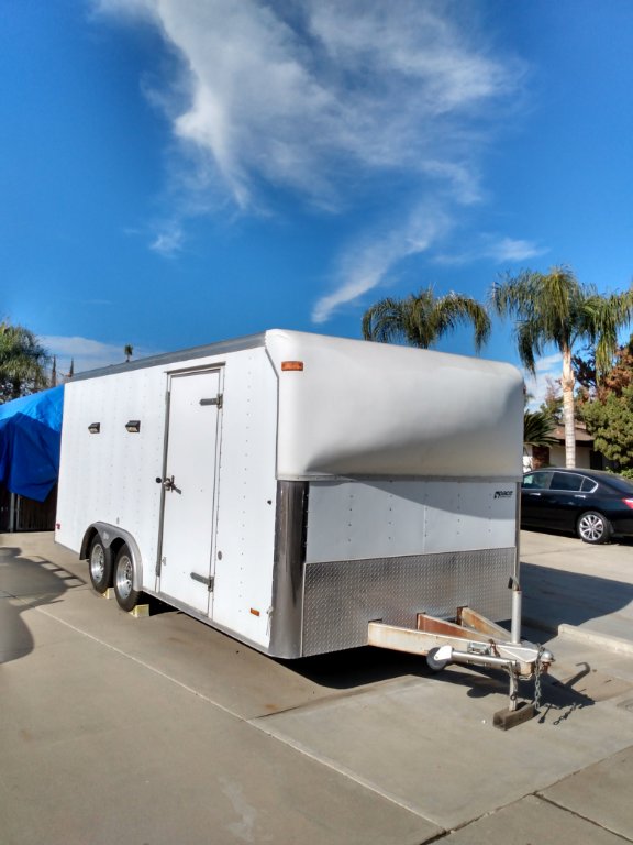

Hello fellow large trailer pullers,
Yesterday I purchased a 1999 8'x20' Pace aluminum enclosed auto-hauler. My 2019 Chevrolet tow vehicle has the factory tow package with "tow mode" and a 7 prong plug. The trailer's plug matches the Chevy's, and its running lights, break lights, turn signals, and flashers all activate as they should. This is easy to see.
However, I cannot know "for sure" if when I step on the brake that the trailer breaks are activating. Would any of you know a technique to test them?
Note: My tow vehicle does not have an "aftermarket trailer break handle" installed at the driver. Just the factory tow mode option.

One way to determine is IF your trailer has the breakaway switch...I can't tell in your picture if it has one..pull the pin on it, with
the trailer connected of course through the 7-way plug, and try to drive off with it. Trust me, IF it's working (the switch), you won't be able to budge. That in itself I would think would let you know your brakes are working. At least in emergency mode.

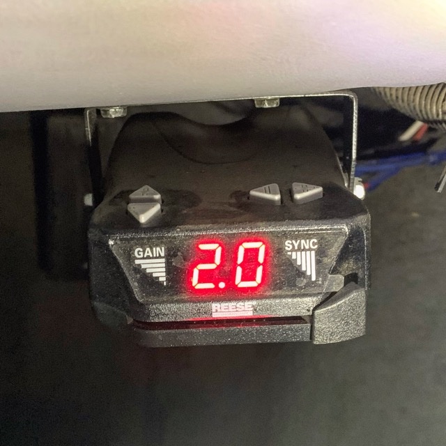

I have a 2019 Chevy pickup with the towing package, the brake controller is built in and is in the center dash under the screen at the lower left side, you adjust the gain by pushing on the + or- on the switch or you can push in on the slide part of the switch and it will go to 100% and if the brakes are ok it wont move or it will stop the trailer wheels if you are moving, if none of the mentioned items don't work get to a trailer shop as soon as possible.
Rick

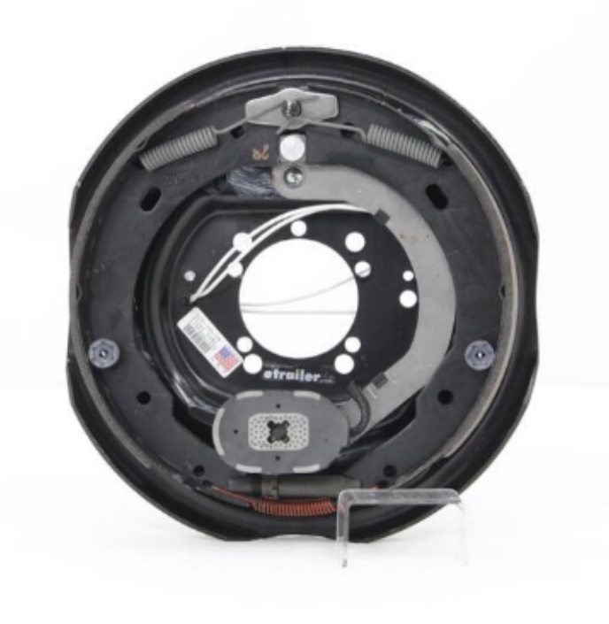

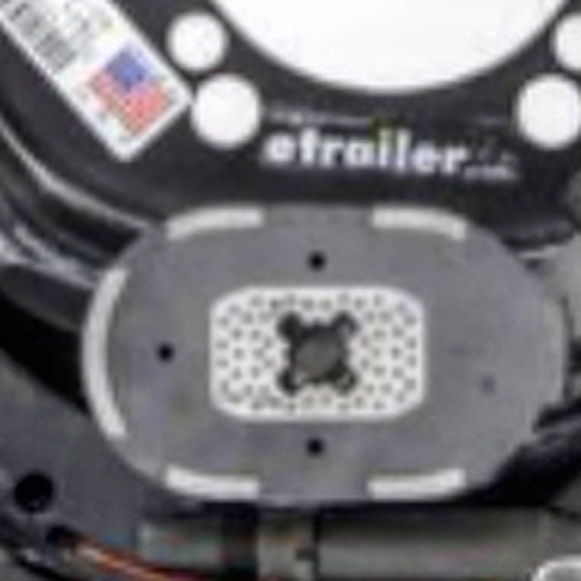

Electric trailer brake magnets fall out because
the design of all manufacturers relies on a cheap
clip in the center of the magnet to hold the magnet
in place - this cheap clip has a tendency
to become dislodged - this causes the magnet to
fall into the drum and get eaten up.
The passenger or curb side magnet clips tend to come
loose first because the curb side wheels
take more shock and road abuse.
If you jack up a trailer wheel & turn it - if there
is a distinct sound of something loose
inside the drum - chances are it is your magnet.
All brake backing plates have this clip.
It is a shitty design that has never been - and probably
never will be - improved upon - because then you
wouldn’t need to buy replacement backing plates
prematurely 👎

If your Silverado does not have a switch on the dash like this you need to have an aftermarket brake controller installed, sounds like you do not. "Tow-Haul is a function of the Transmission & not Auxiliary Brakes on a trailer. https://images.carid.com/acdelco/items/84108377.jpg
