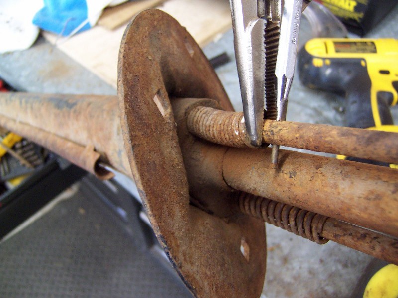

Better to clean them in place. Then paint, to make em look good under the hood.
Removing the column rods means removing the cluster from the upper quandrant , completely disassemble the steering column.
To remove the rods, follow instructions in Ford Service , Chapter XXV.

It is possible to drive the arm pins out with a small punch. If you drill them the holes may become enlarged. The spring cups cover some similar pins that also can be pulled out.

The little cups at the bottom of the springs have pins in them. Pull back the cups and remove the pins. To remolve the rods from the column you have to drill out the rivets holding in the gear case, pull it out, and pry open the claws that hold in the rods. Anneal the claws (turn them red and let them cool) before reassembly. Parts dealers have the proper rivets. All this is done with the column out of the car, of course.

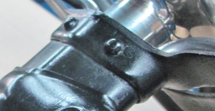

Jim, with all due respect, anything other than solid rivets or solid taper pins at the assembly of the column tube, quadrant, and steering case won't give the necessary strength and security to this important spot. Stay with Ford fastener design.
Using the vendor style rivets is easy, they work, and look like factory.
New rivet along side a removed original

New replaced rivets, finished job

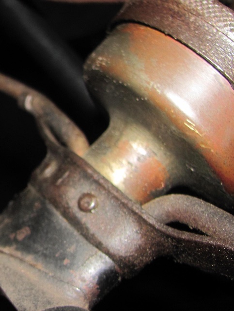

View of original rivets on unrestored column for comparison/b]
