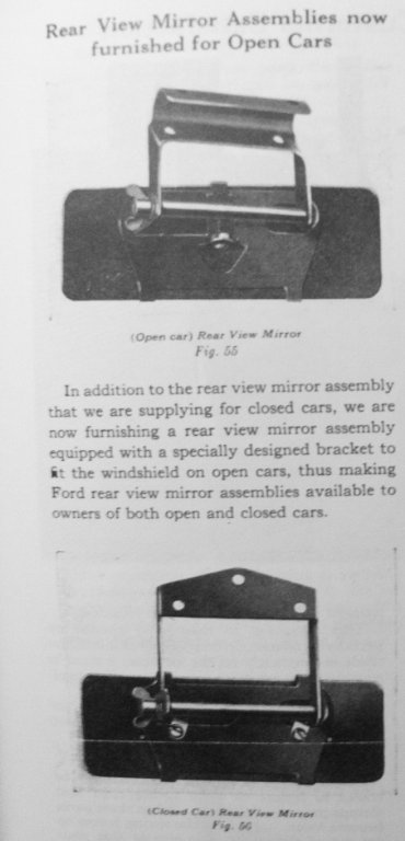

I had not seen the Australian Parts Catalog before and I looked for something specific, the rear view mirror. In the American catalogs it is part 18259X and in the Australian it is listed as 18523X. I had a friend that had a RHD Model T more than 50 years ago and for some reason, the one thing that I remember was that the mirror was different. Of all the things that I remembered or noticed or just stuck with me all those years, the rear view mirror. The "slide" for adjusting the view was on the opposite side as the LHD (as it should be or the mirror would be pretty useless):
September, 1924 Service Bulletin
I have had more than one person tell me that I was wrong and there were never 2 different mirrors, they were the same for both RHD and LHD. I have always respectfully disagreed with that. Would anyone have any photos of 18259X vs. 18523X for comparison?

Joseph, you friend may be right, or wrong! The slotted piece, which allows adjustment sideways, is part of the clamp on the mirror glass. It is possible to remove the long centre bolt and rotate the glass/clamping piece assembly through 180 degrees and refit the long bolt. The only difference is instead of two claws on the bottom and one on the top, there will now be one on the bottom and two on the top. I bought a nickel plated brass mirror of that type at Chickasha, and that is what I did to make it RHD suitable.

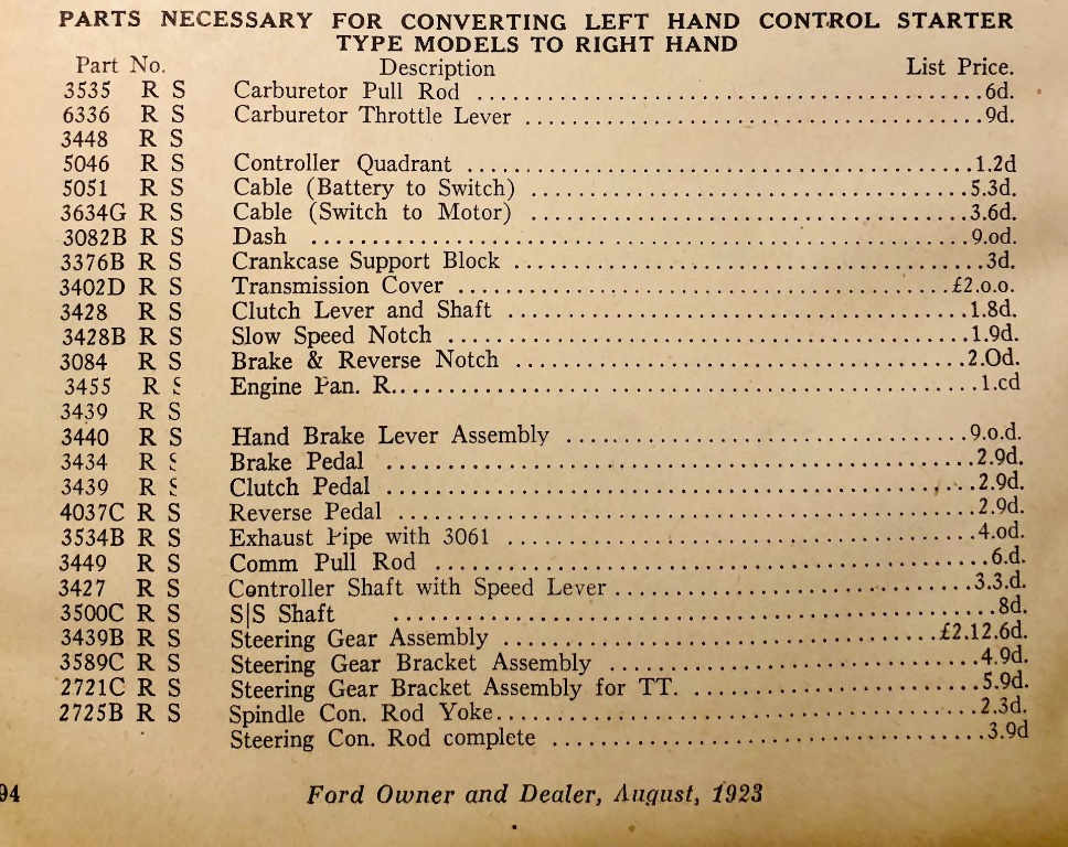

Found this chart in Ford Owner Dealer, from UK dealer on parts needed to convert left hand starter cars after 1923, to right hand drive.

I read it two times and the thing that stands out is the crankcase support block? There is no left or right on that one that I have seen. Other wise I think we got it all. Thanks for that list.

Maybe the fuel line needs a little tweaking at the wood block to clear the exhaust pipe taking a new route.
