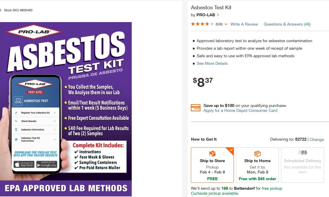

Asbestos is most hazardous when it is friable. The term "friable" means that the asbestos is easily crumbled by hand, releasing fibers into the air. Sprayed on asbestos insulation is highly friable. Asbestos floor tile is not. If the cable surface is clean encapsulating it with varnish/shellac/paint should be sufficient (similar to what is done for Asbestos Pipe Insulation Encapsulation). But before you go through all that trouble and to alleviate your concerns, you can have it tested for Asbestos
