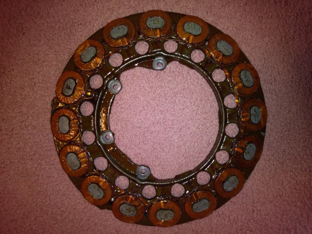

Post by tommyleea » Tue Feb 09, 2021 9:58 am
Here is a picture of the mag post area. The copper colored area is completely covered with a coating.

Post by tommyleea » Tue Feb 09, 2021 10:15 am
The new mag ring..

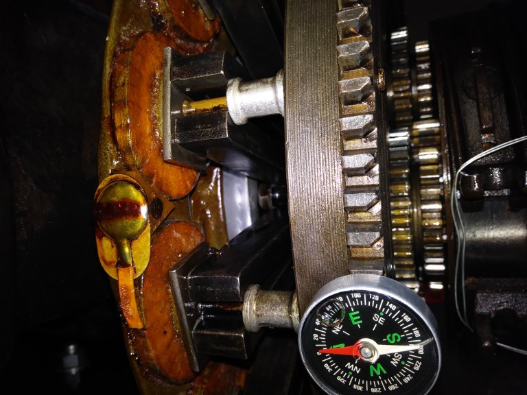

The 2ed photo up from the bottom, you are reading the magnets not the coil ring. The contact point also needs to be cleaned if you haven't. Once the flywheel/magnets/transmission are removed, power is run thru the base of the coil ring and the contact at the top, then each of the coils are checked with a compass.
Unless there is a dead short, the only spark you should/might see is when the probe you are using makes contact. If that 2ed up photo is current, I don's see any signs of the covering being disturbed like I would expect if you were doing a recharge except for that one small spot. As said above, the varnish is not allowing current to flow and is acting like an barrier. Which could have been the problem to start with.

Post by Steve Jelf » Tue Feb 09, 2021 11:24 am
Looks like the bolt holes were masked and are bare metal. Good enough. Clean the coating off the solder button and check continuity between there and the bolt holes. If there's coating on the backside of the bolt holes you can wire brush that off just to be sure of a good ground. It appears that the poles were masked, but if they weren't and there's coating on their faces I would remove that too.

Mark Gregush wrote:
Tue Feb 09, 2021 11:16 am
Thanks..Yes, in that photo I am checking the magnets. The other test I did prior to installation. You are correct the coating is still on the mag disk. I will remove a small portion and recheck.
Thanks..I will clean the coating off today and retest.
