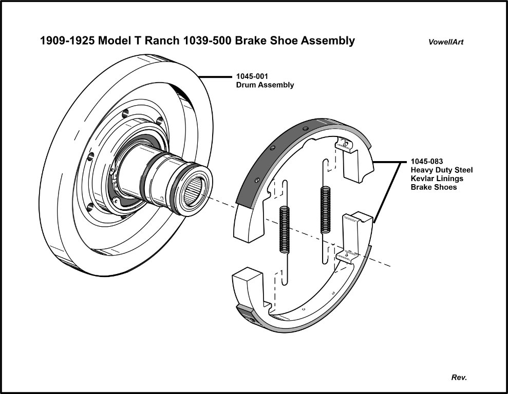

Your car, your choice. Myself I went with Rockies and regretted it ever since. Took them off and threw them in the corner of my garage and went with John W. Stoltz's (Model T Ranch) heavy duty brakes with Kevlar lined shoes...they're also attached to a Floating Hub, which puts the weight of the car onto the wheels and not on it's rear axle. And yes, they stop my car and will lock up the rear wheels if I'm not careful...something you never really want to do actually, because once you lock up those wheels, you no longer have any control over your car, you're skidding along at the mercy of inertia.
But I've been told those Disc Brakes work pretty good and some folks I know who've installed them, disconnected their transmission brakes figuring they didn't need them anymore. Myself I'd be hesitant to do that, because the more braking power you've got the better in a Model T. But they don't look all that noticeable on wood spoke wheels, so I'd imagine they'd even look less noticeable on Model T wire's also. The pads are readily available at most car parts stores, so, no worries there, as to the rotor I don't really know, but I'd imagine that they're a standard size from something...that's what you've got to check into really, what it would take to rebuild them and where you can find parts. My guess is that just about any car parts store has most of what you'd need to rebuild them, if and when you ever did.
Your choice really, I just prefer the ones I'm using as opposed to something that (to my mind) doesn't belong on a Model T Ford.

Re: Disc Brakes--Yes/No??
Jonah D'Avella
John W. Stoltz's Model T Ranch Brakes
They're hardly noticeable between the original brakes and John's...they're about as noticeable as the Rockers, yet work a lot better and a lot cleaner looking installation too!
I'm running 3:1 in a stock rear axle...wouldn't mind having a Ruckstel though...just can't afford one. I also rarely drive my car over 35 mph and the modern Rockies only work going forward, not backwards. So forget them holding you on any hill...they wont! But those Model T Ranch brakes sure will, but then so will Larry Sidemore's AC brakes and the Original Rockies (which work totally different than Bud's version of them), they actually have 2 cam levers on them to adjust the both the forward braking and the reverse braking. I was suppose to draw them for Larry "Original" Smith, but the drive I had all the pictures on was destroyed in the Creek Fire a few years back, so I've been slowly reacquiring what I've lost in an effort to fulfill my promise to Larry and draw those Rockies of his (much better set up than Bud's Rockies, I especially like the cable and pulley equalizer, always pulls even, none of that screwing around with rods and clevis pins nonsense).What size rear end did you have?
Fun never quits!
