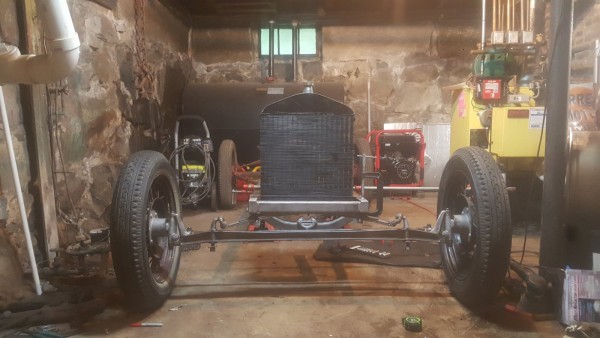

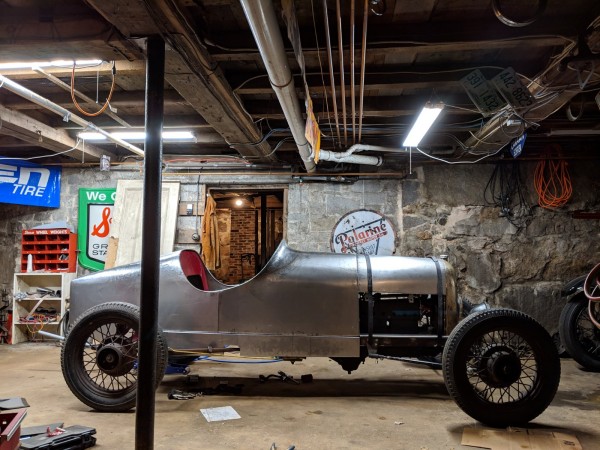

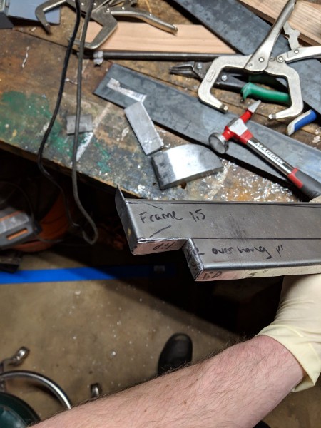

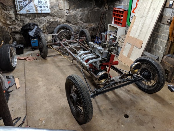

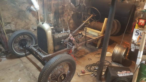

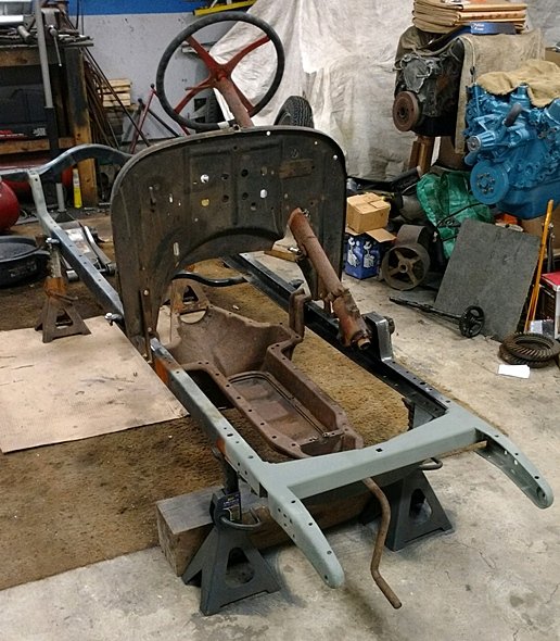

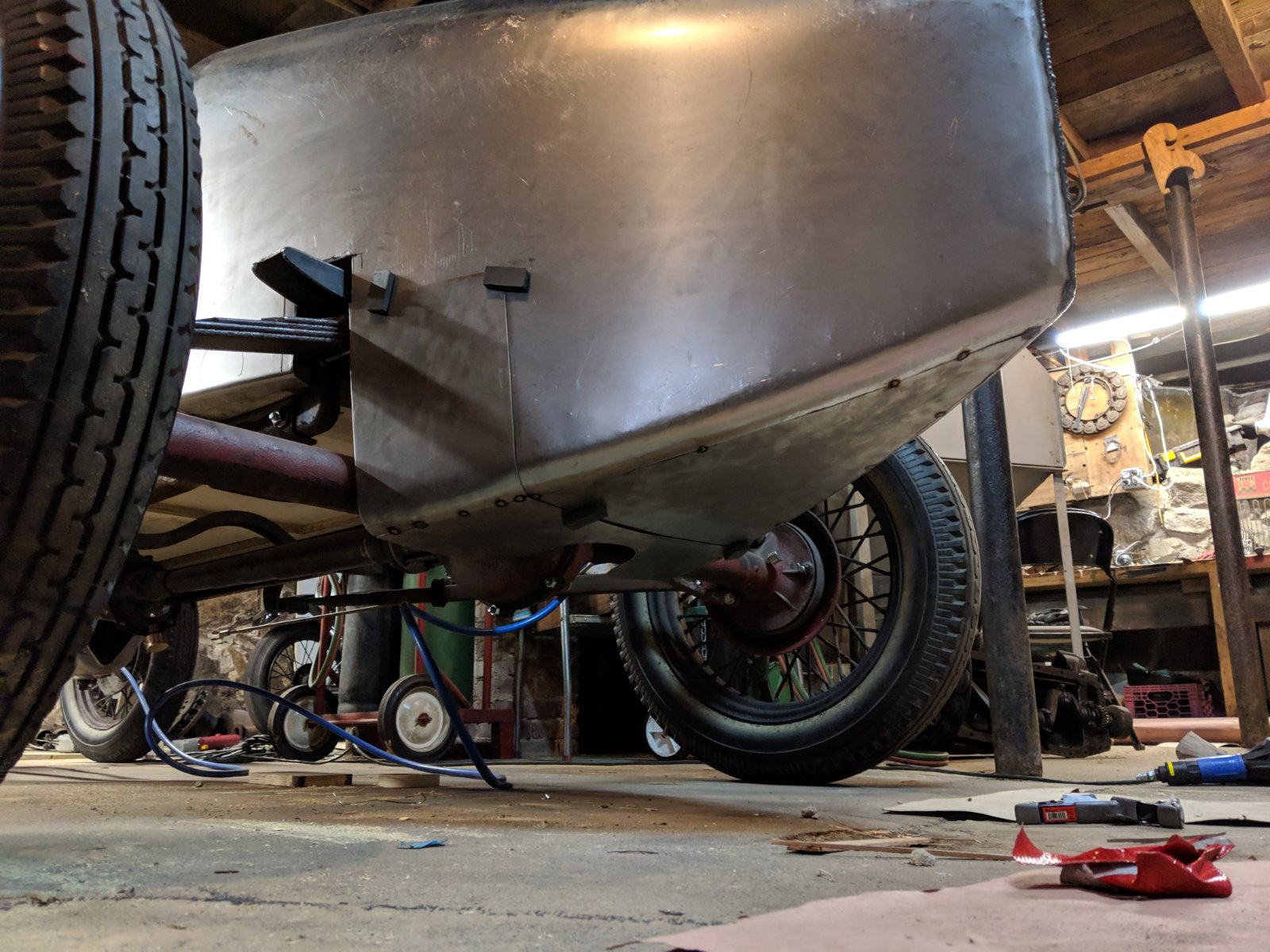

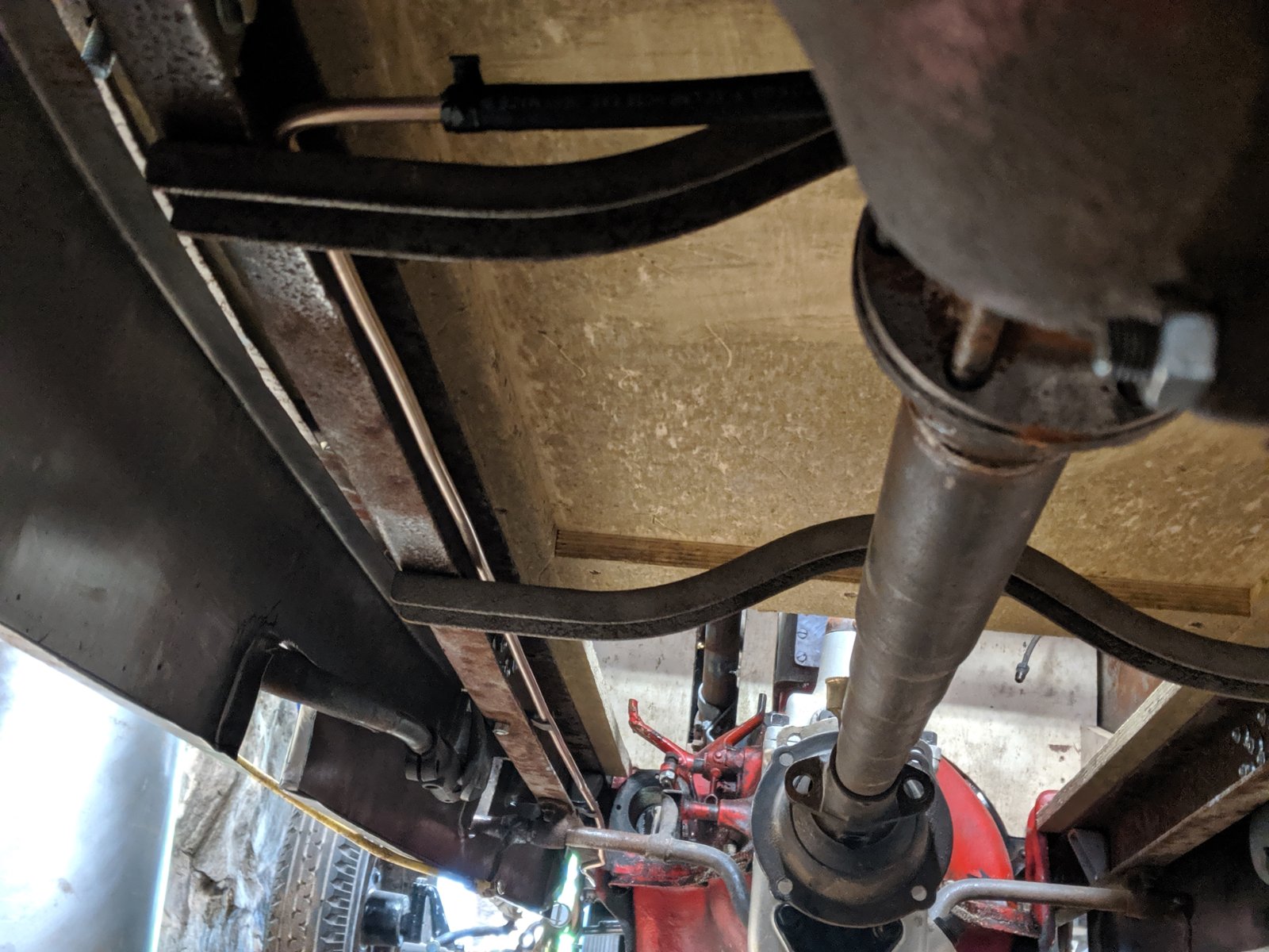

Late last year I bought a frame and running gear to begin building my own speedster. The chassis had been modified in a very hokey way and I went through and undid/ modified what had been done. This thread will be very photo heavy as it's easier to explain visually.
Originally the frame was lowered with angle it on and a modified rear cross member. I cut all that off and came up with something else.
This ended up being a bad idea because the frame and spring interfered. That was a week or two down the drain.
The rear lowering did however work out. I bought the cast lowering brackets and a lowering cross member for a combined 7" drop. This car will be about as low as I can make it and still be drivable.
I stripped, blasted, and painted the front axle, as well as chopped up the front wishbone to be mounted to the frame.

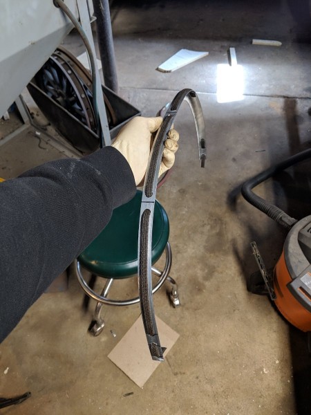

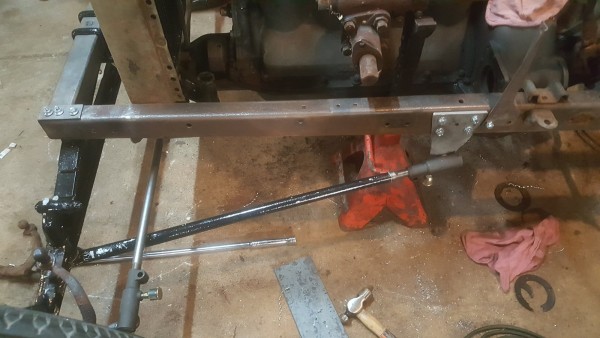

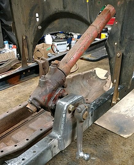

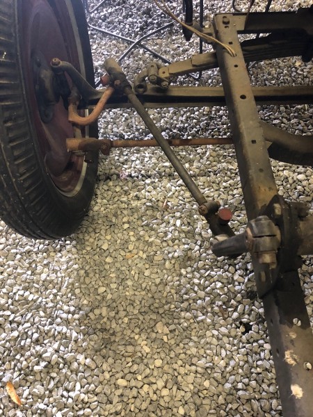

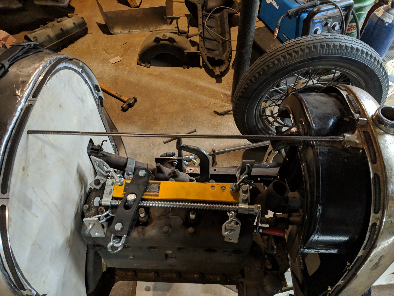

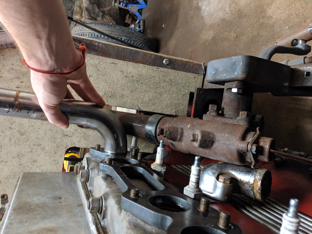

Here's the beginning of the split wishbone and mount. I'm using bolts temporarily for mock up. I will be using rivets later on for final assembly.
I cut the wishbone then inserted a good chunk of model a tie rod inside, then plug welded, welded the seam of the wishbone, and the end. I am going to install spring perches and welding another pipe to make them into a hairpin design for more strength. I made a 3/16 inch plate with a model a steering ball swedged and welded. I'll be modifying the mounts for a bit more strength in the future.
I picked up an old 2 tooth model a steering box and started mocking it up to figure out where it was going to sit and work. I want a real low steering column angle and tried to get it as close to the pedals while still being able to push them. Also, I am mounting the box as far inboard as possible. I really enjoy the early Sprint cars, but wanted a speedster to drive more casually as well. So this will be my iteration of a street able racer.

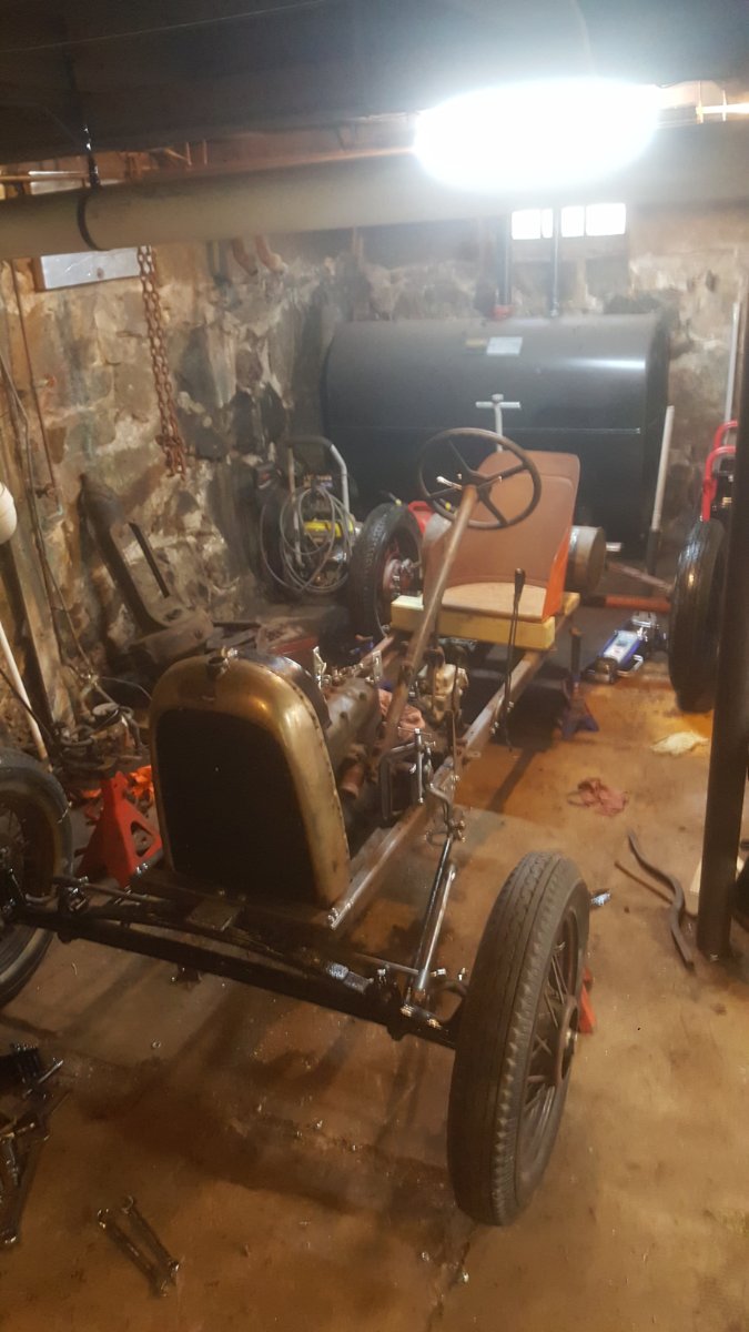

Post by Shane Lach » Tue Mar 05, 2019 9:00 pm

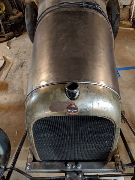

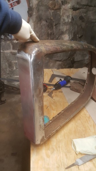

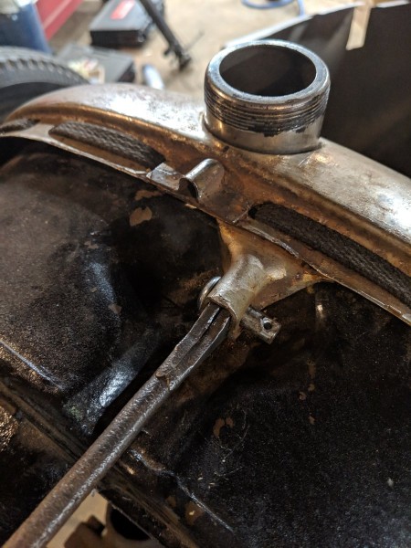

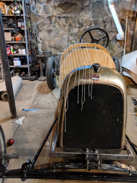

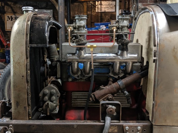

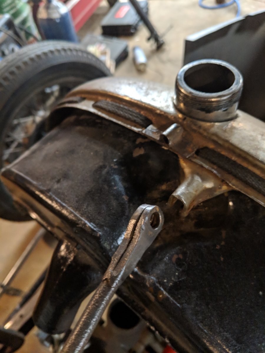

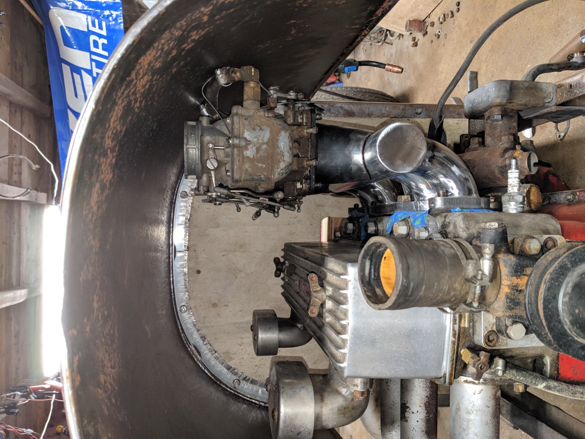

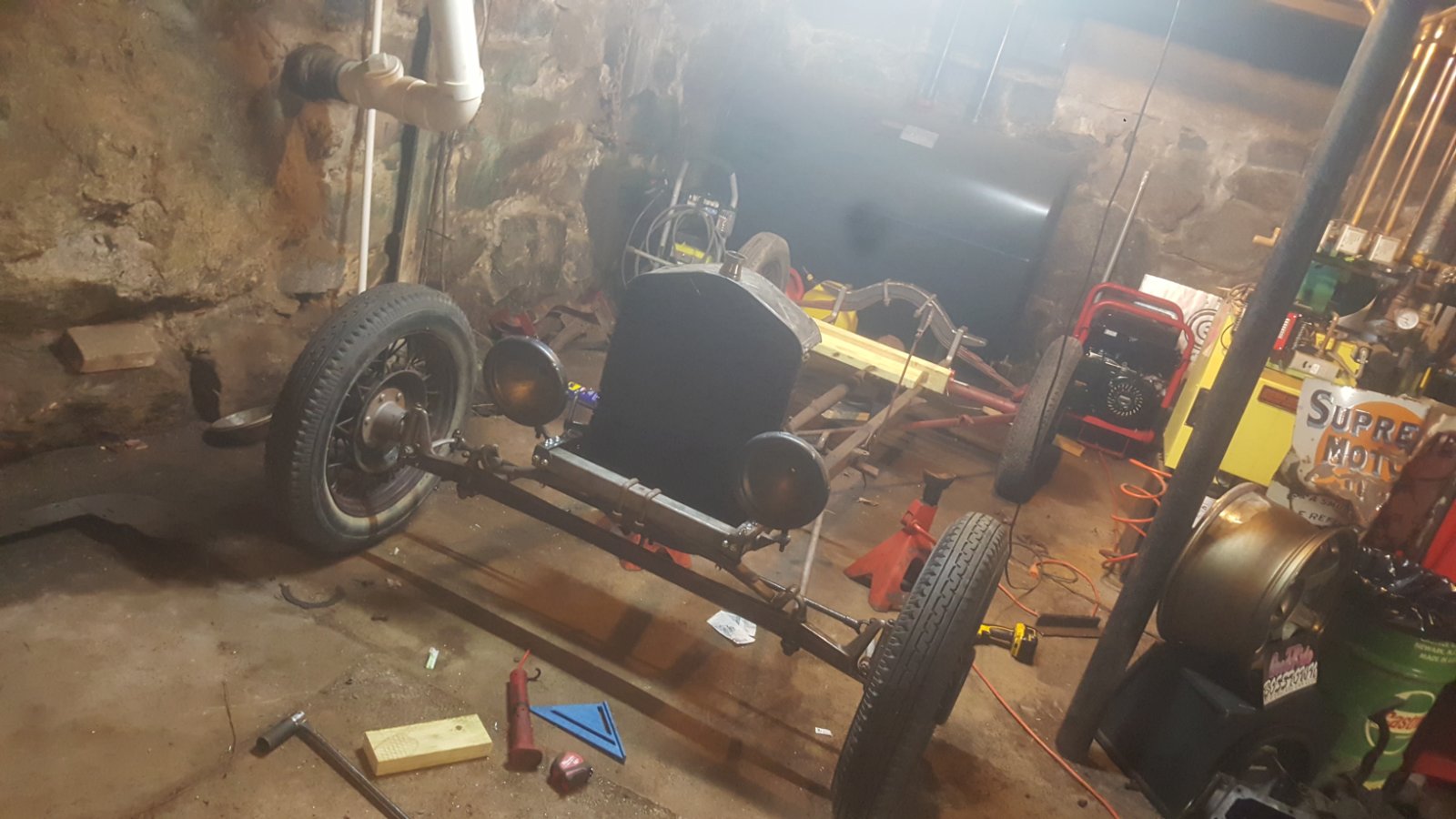

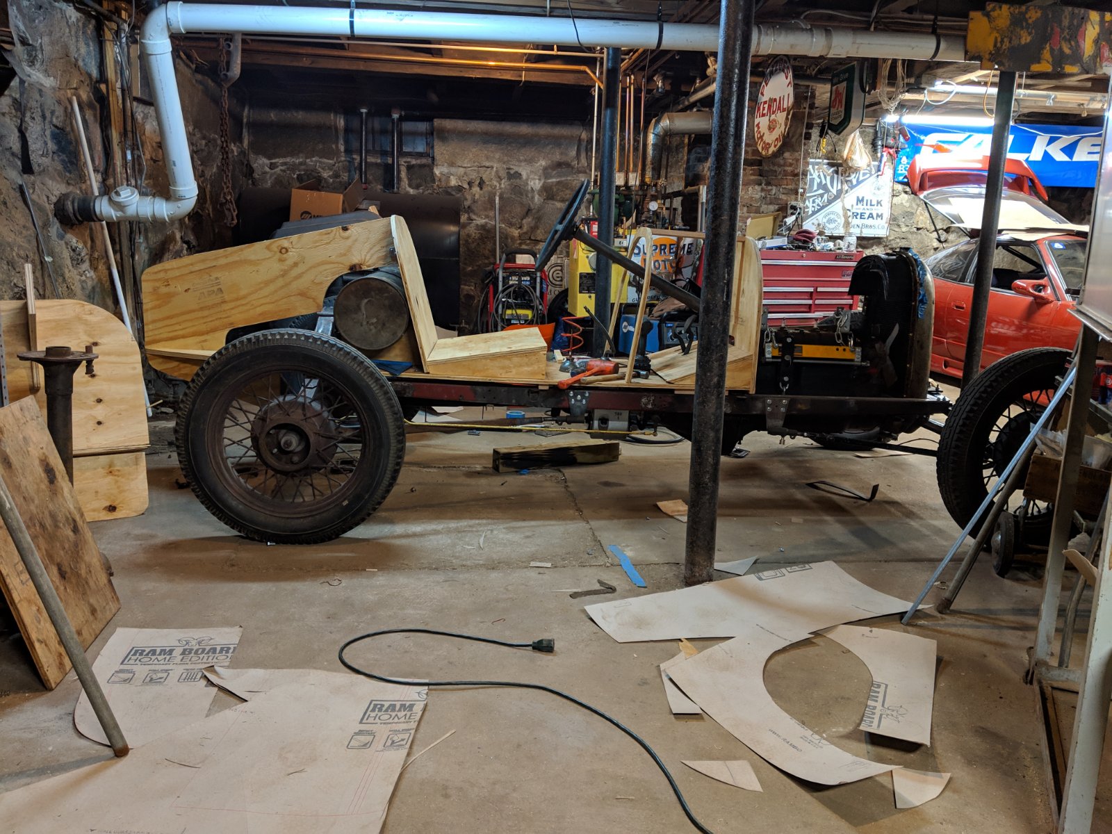

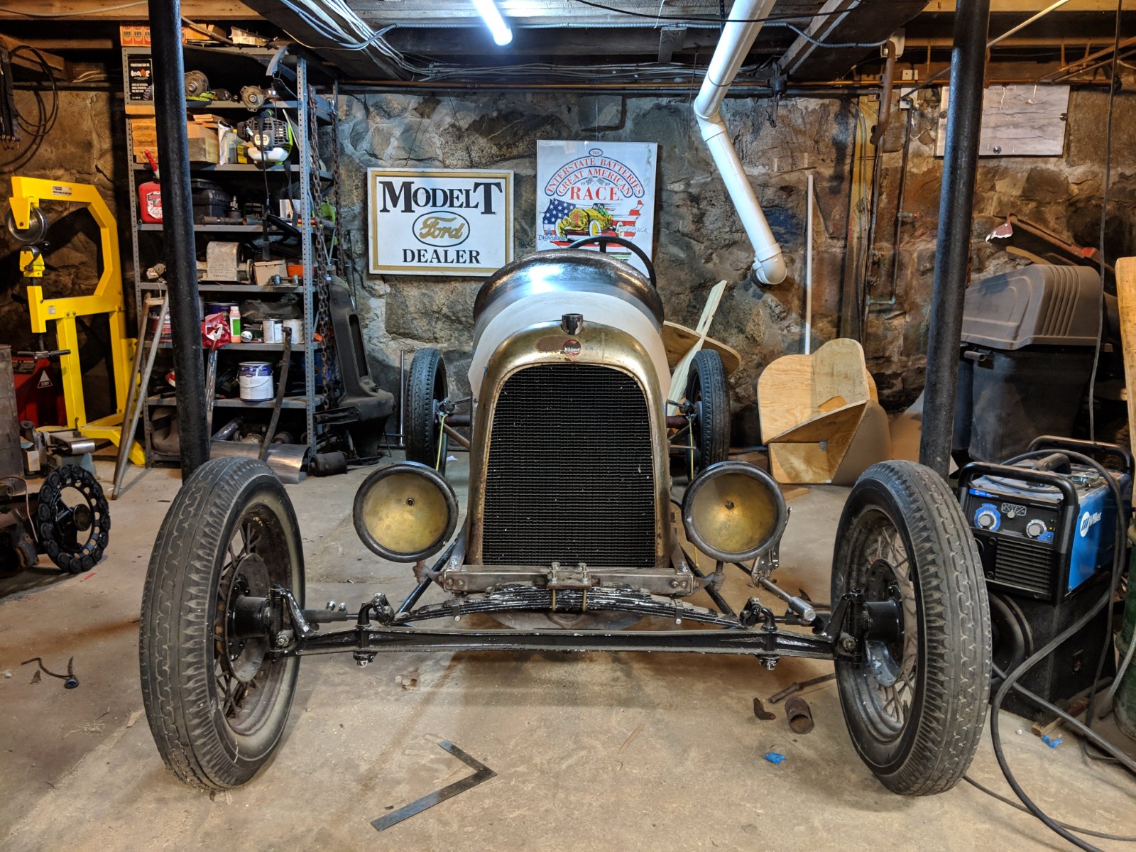

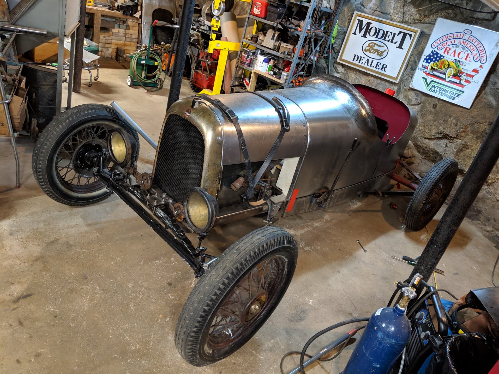

This is about when I met my friend Rob Weitzel. I had been posting here and there searching for a Whippet radiator. He mentioned that he had one. I bugged him about selling me one of his and he gladly did to help me keep my project rolling. Rob has been a key factor to this project and has been a ton of help.

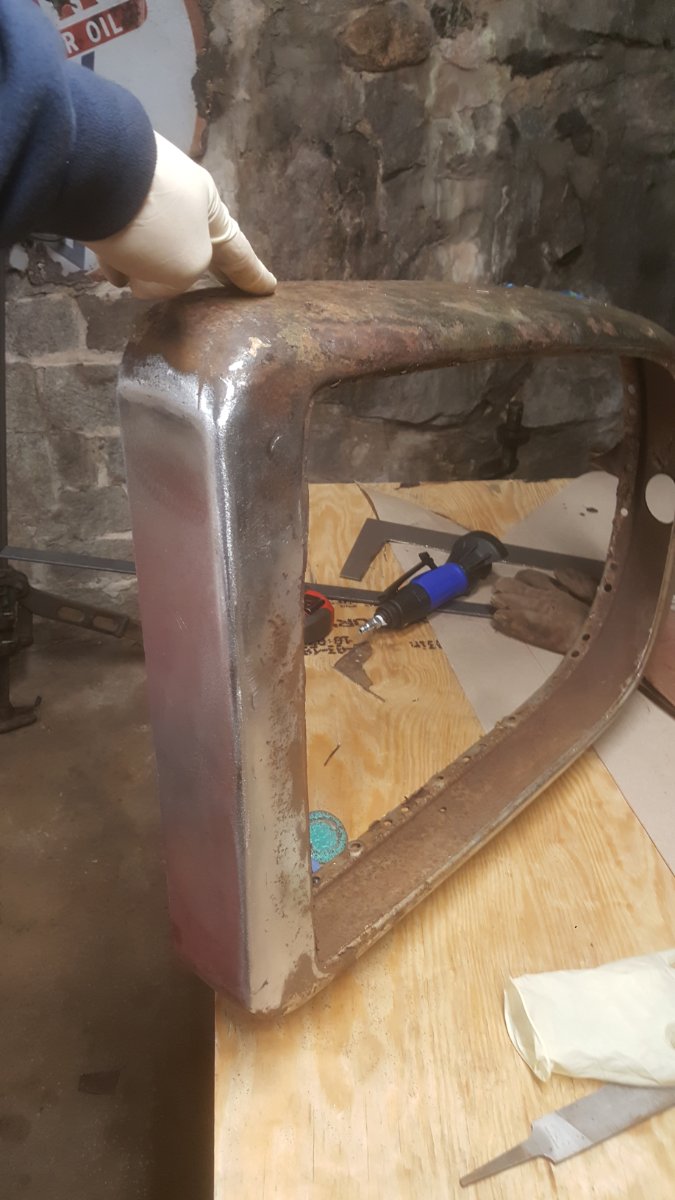

The shell of the Whippet radiator he sold me was crusty on the bottom. I cut it out, shaped a patch, and welded it up. I had just bought my first welder a week before so this was the first little welding project for me.
Here's a couple more column mock ups and the beginning of the body.

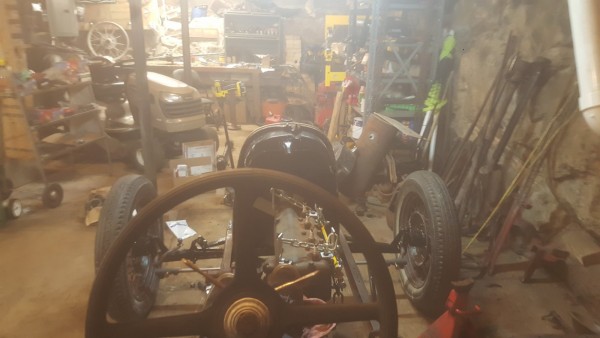

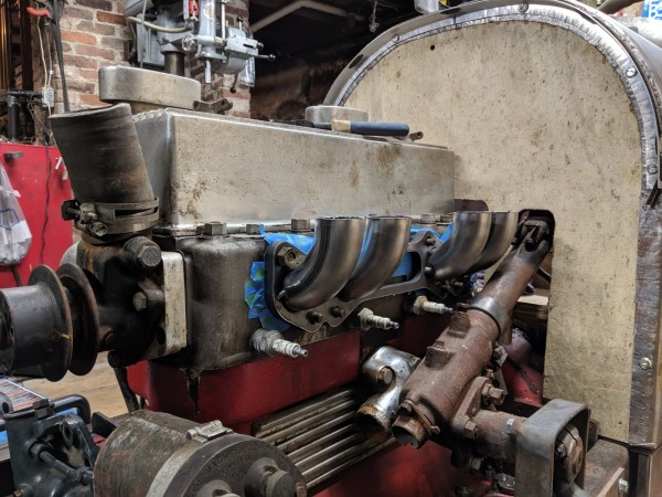

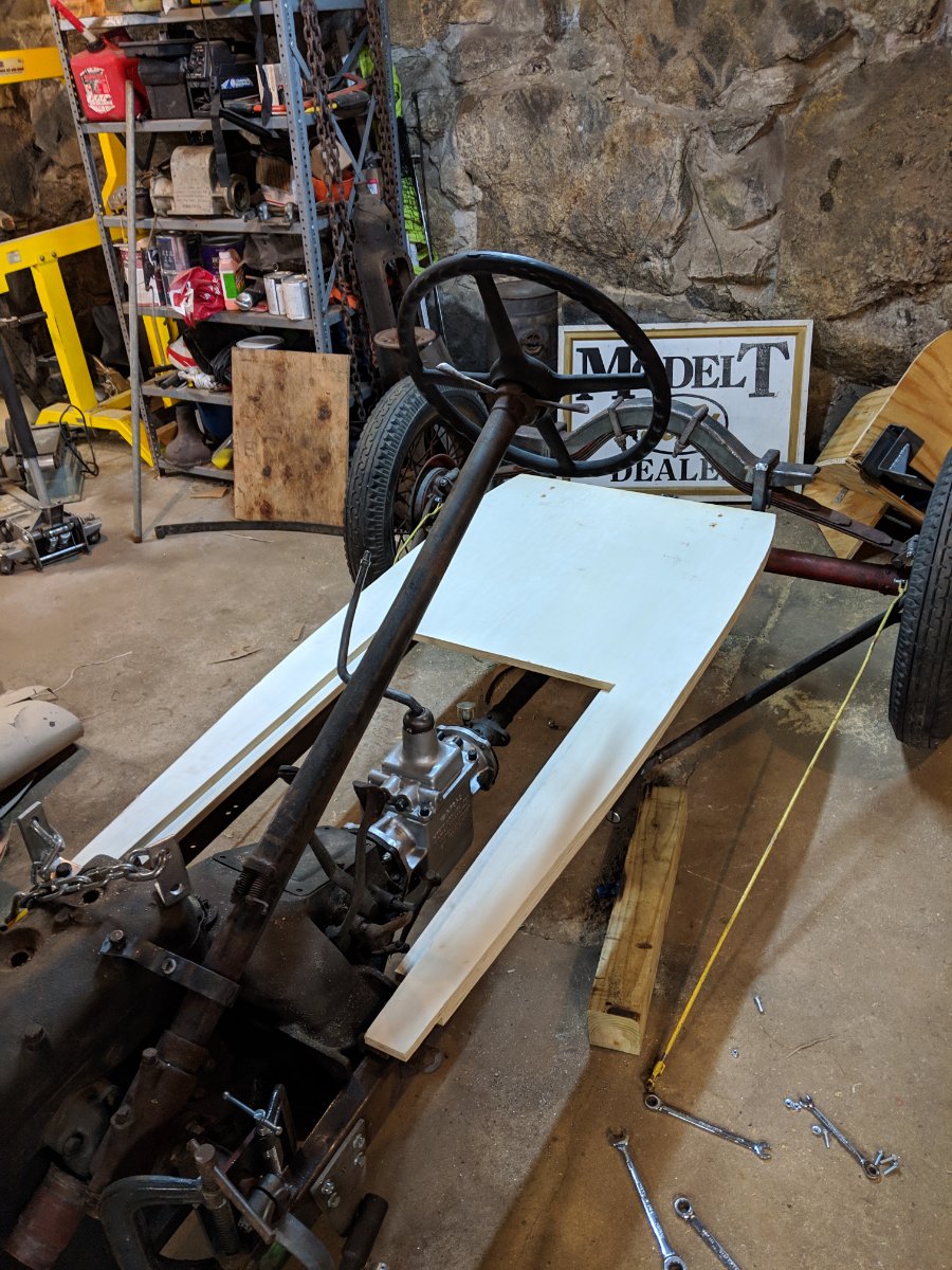

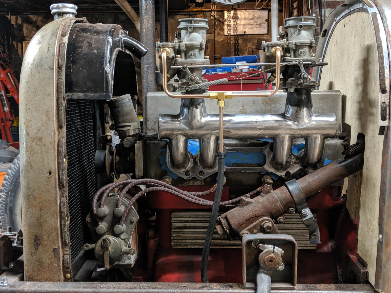

I will be running the 2 tooth box, model a drag link in a modified length, and model a steering arms in model T spindles. The arms bolt right in.
So there was a lot of measuring, cutting, swearing, creating fire wood, etc. Here's some photos of the prototyping.

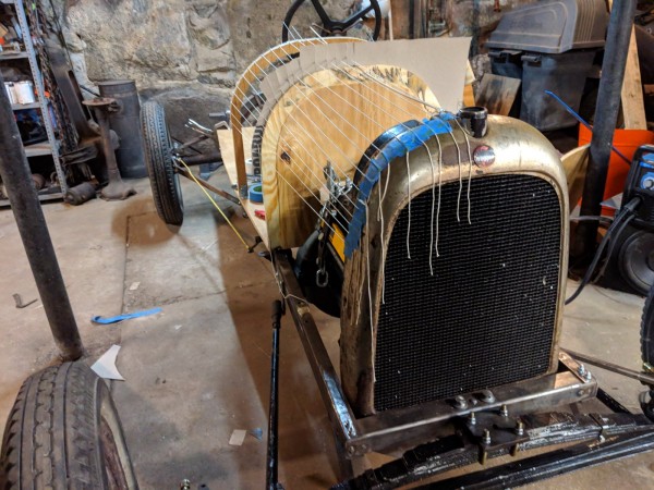

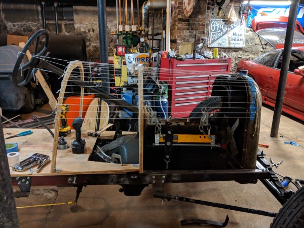

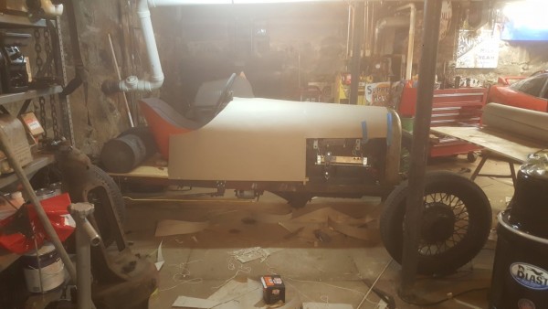

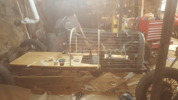

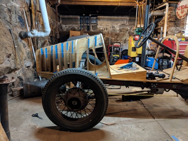

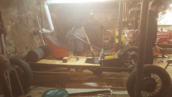

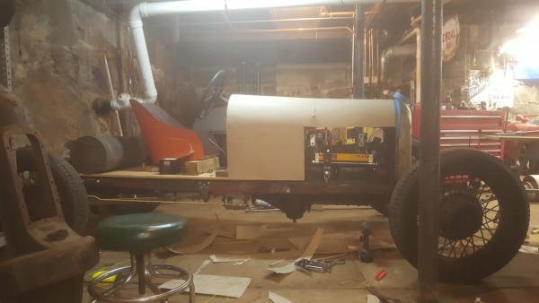

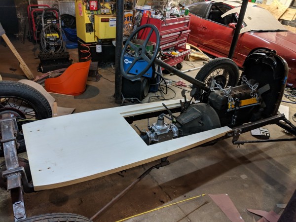

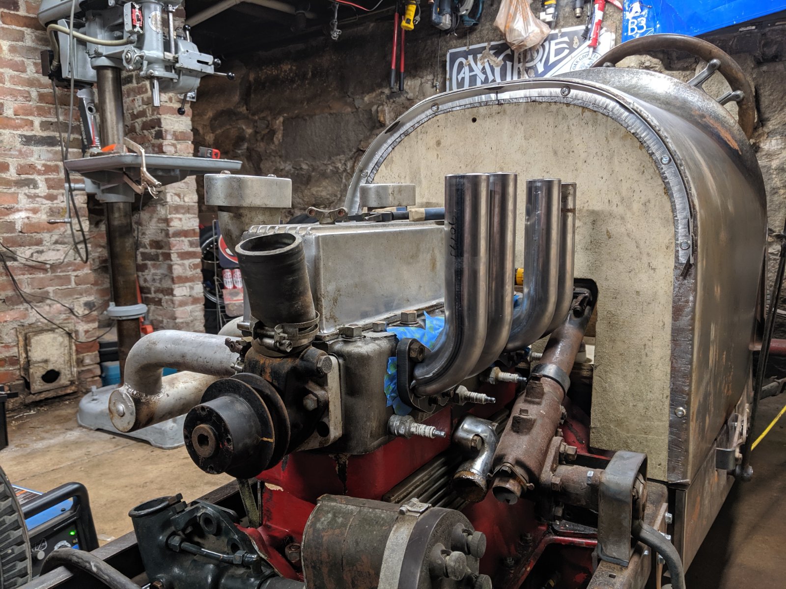

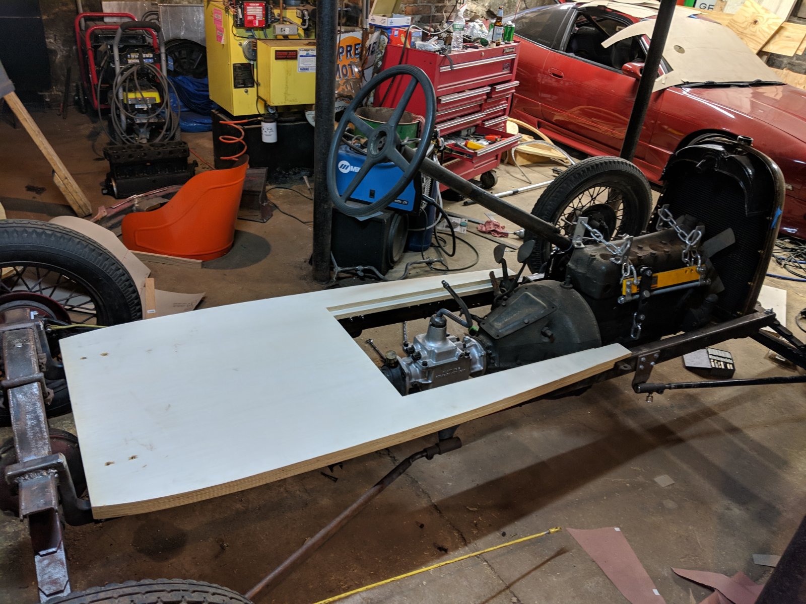

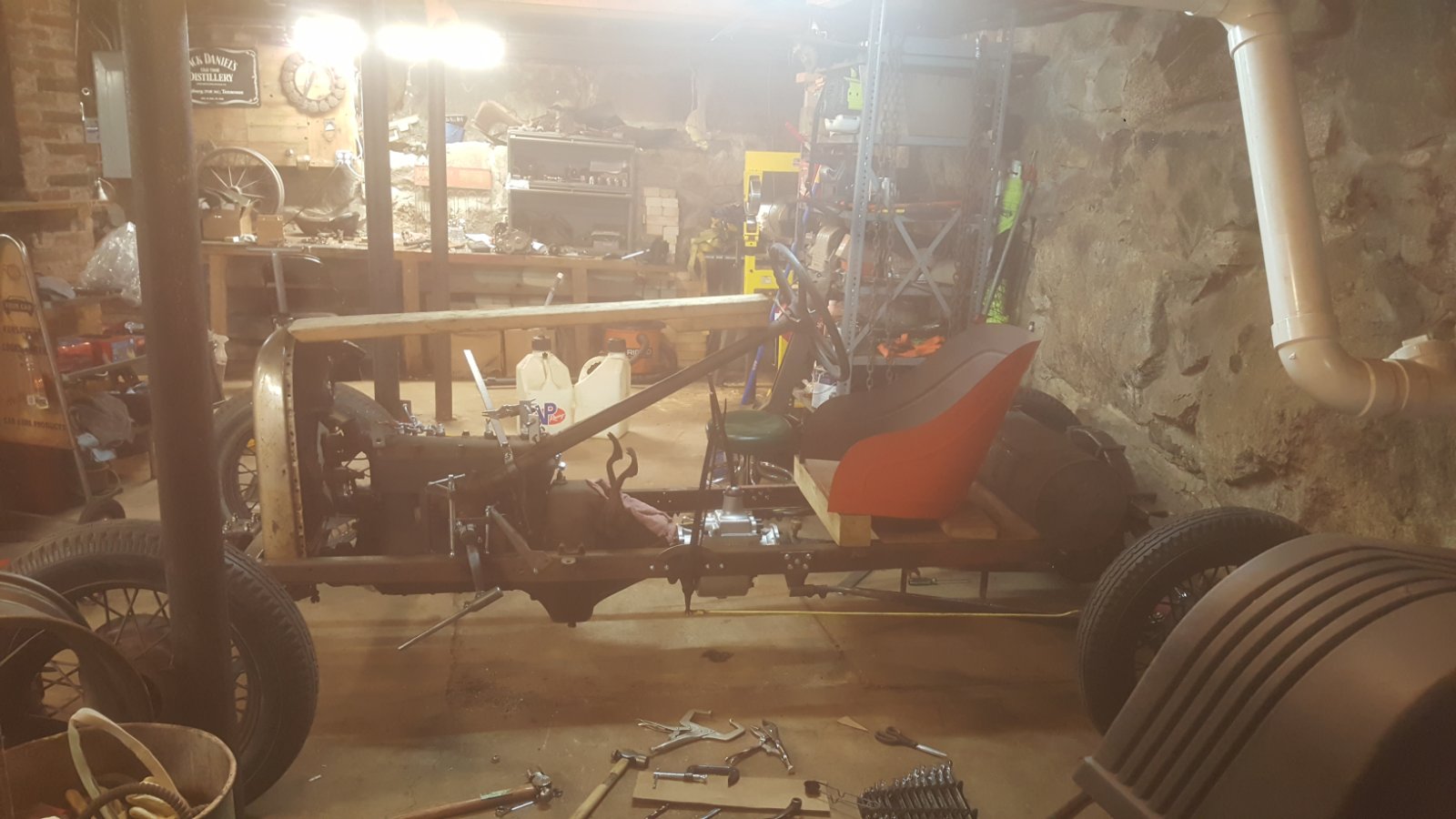

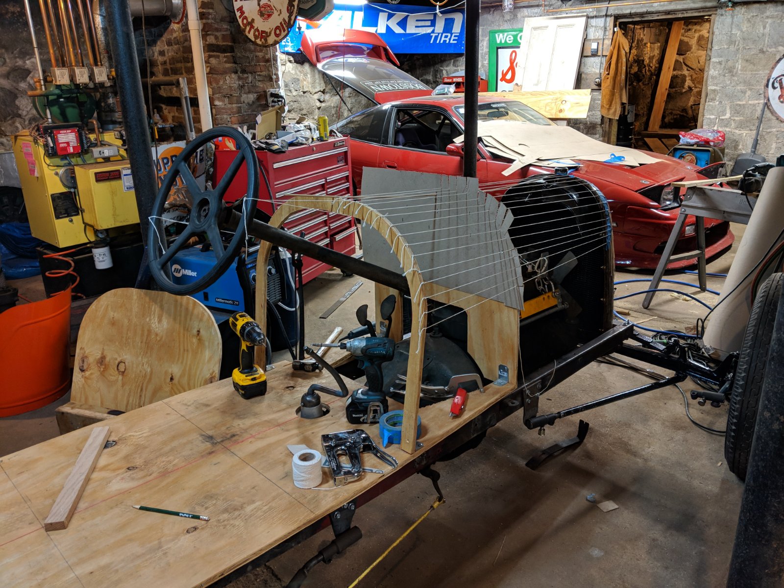

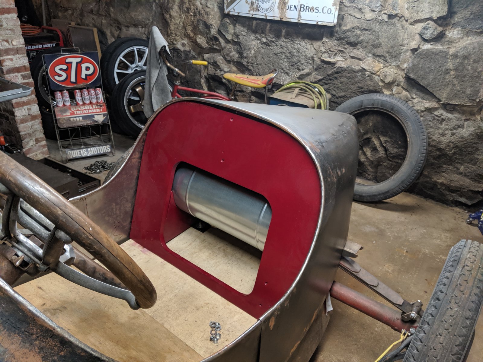

I created a dash, then mounted up a rough firewall. I ran strings from the dash to the radiator. I stapled a piece of cardboard to the rough fire wall then slit the cardboard until the string ran straight through while taught. Once I did this about 50 times I got a good half profile of the firewall shape I wanted after trimming the cardboard at each slit to flow well from radiator to dash.

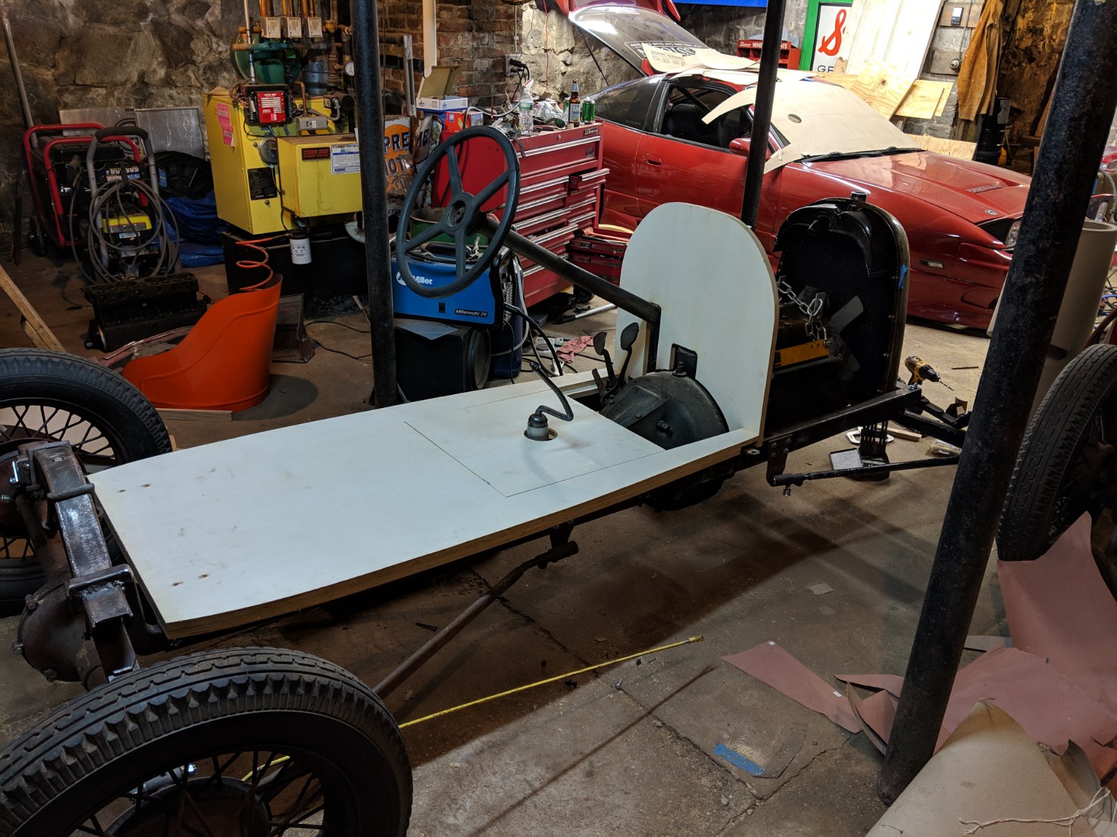

Here's where I got a new phone with a better camera.

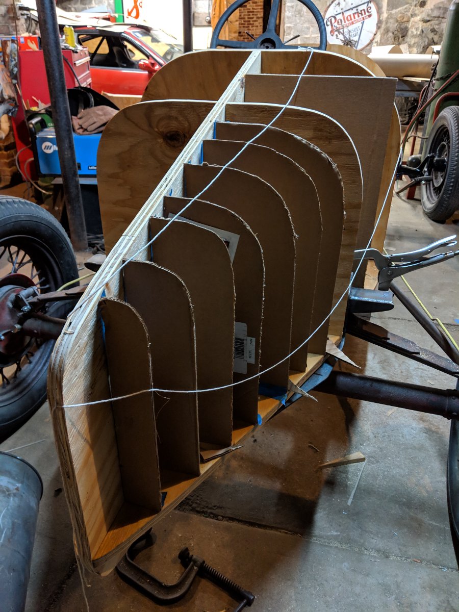

This is a clearer view on how I got my firewall shape. I ended up doing this multiple times because I didn't like the body shape. I spent a month playing with cardboard I think.

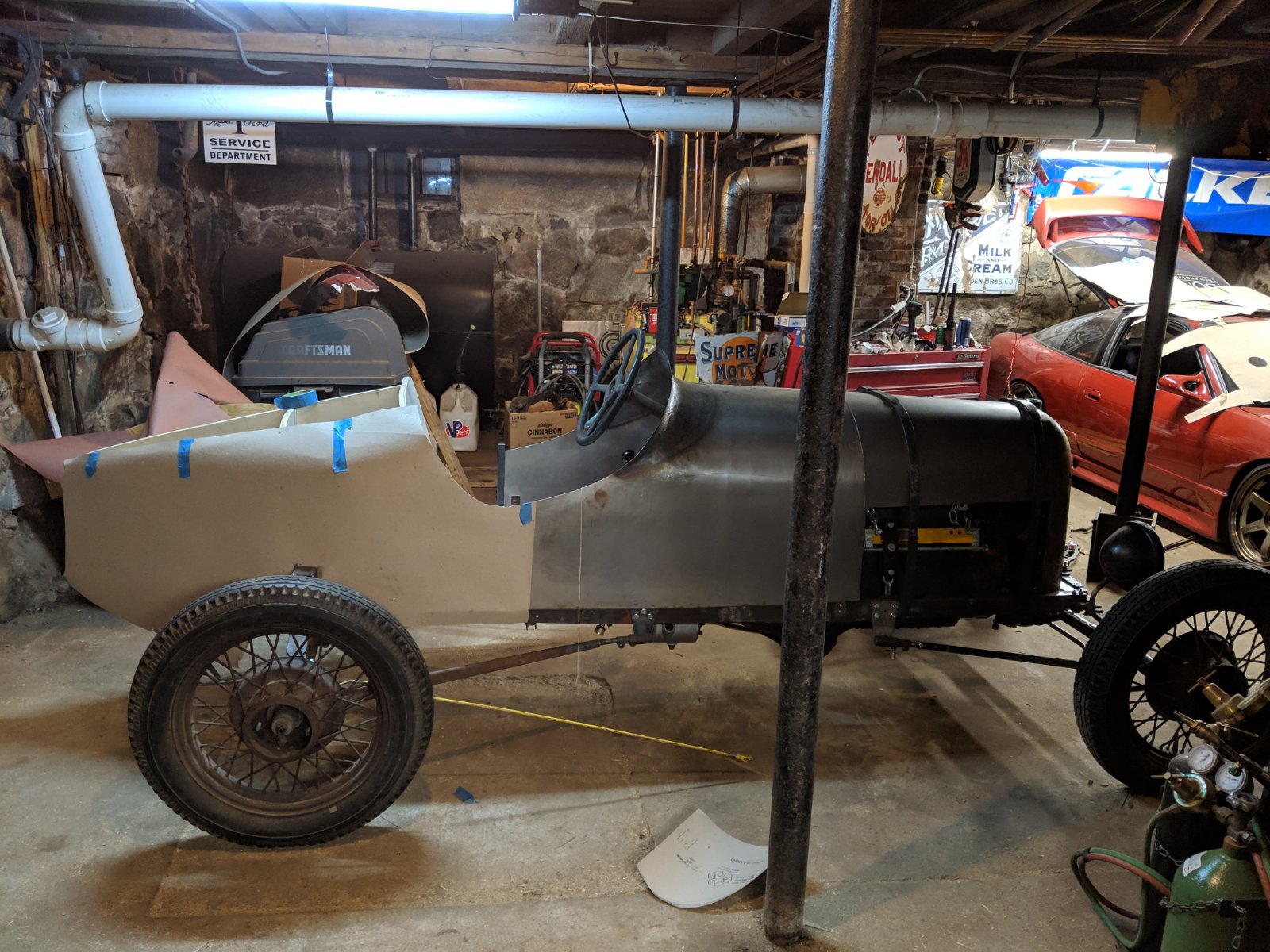

Post by Shane Lach » Tue Mar 05, 2019 9:21 pm

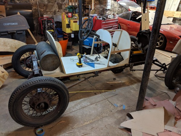

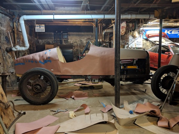

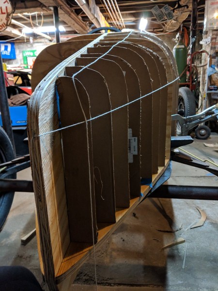

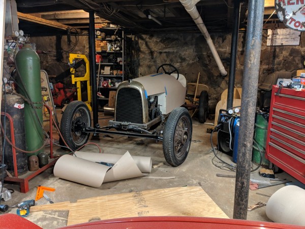

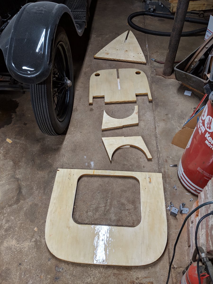

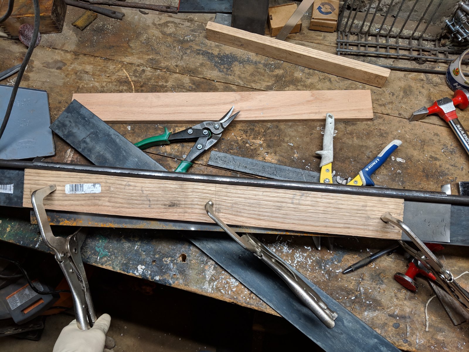

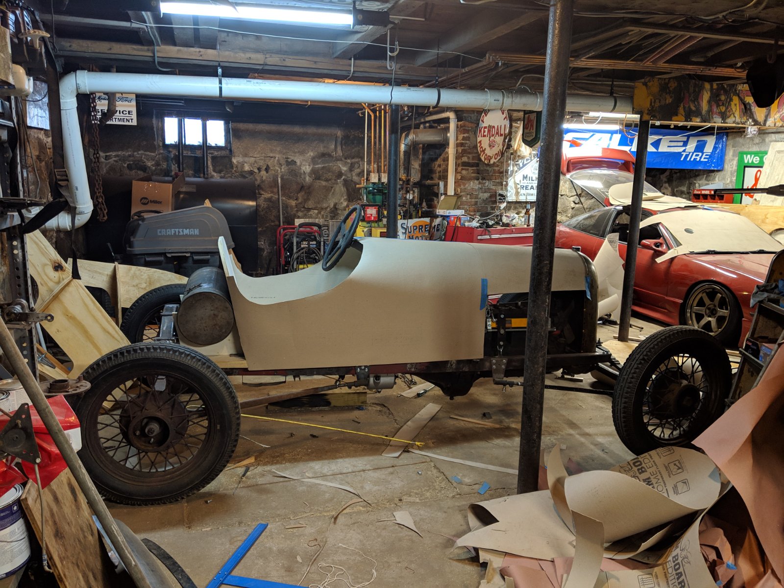

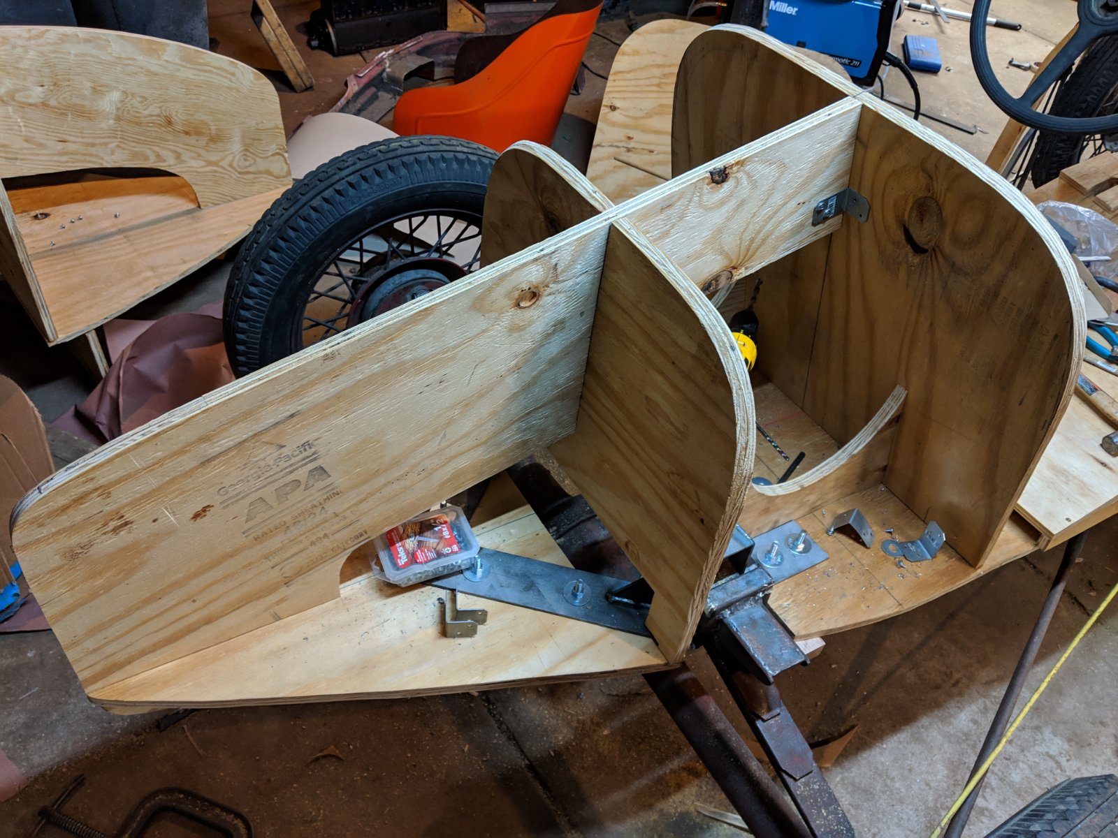

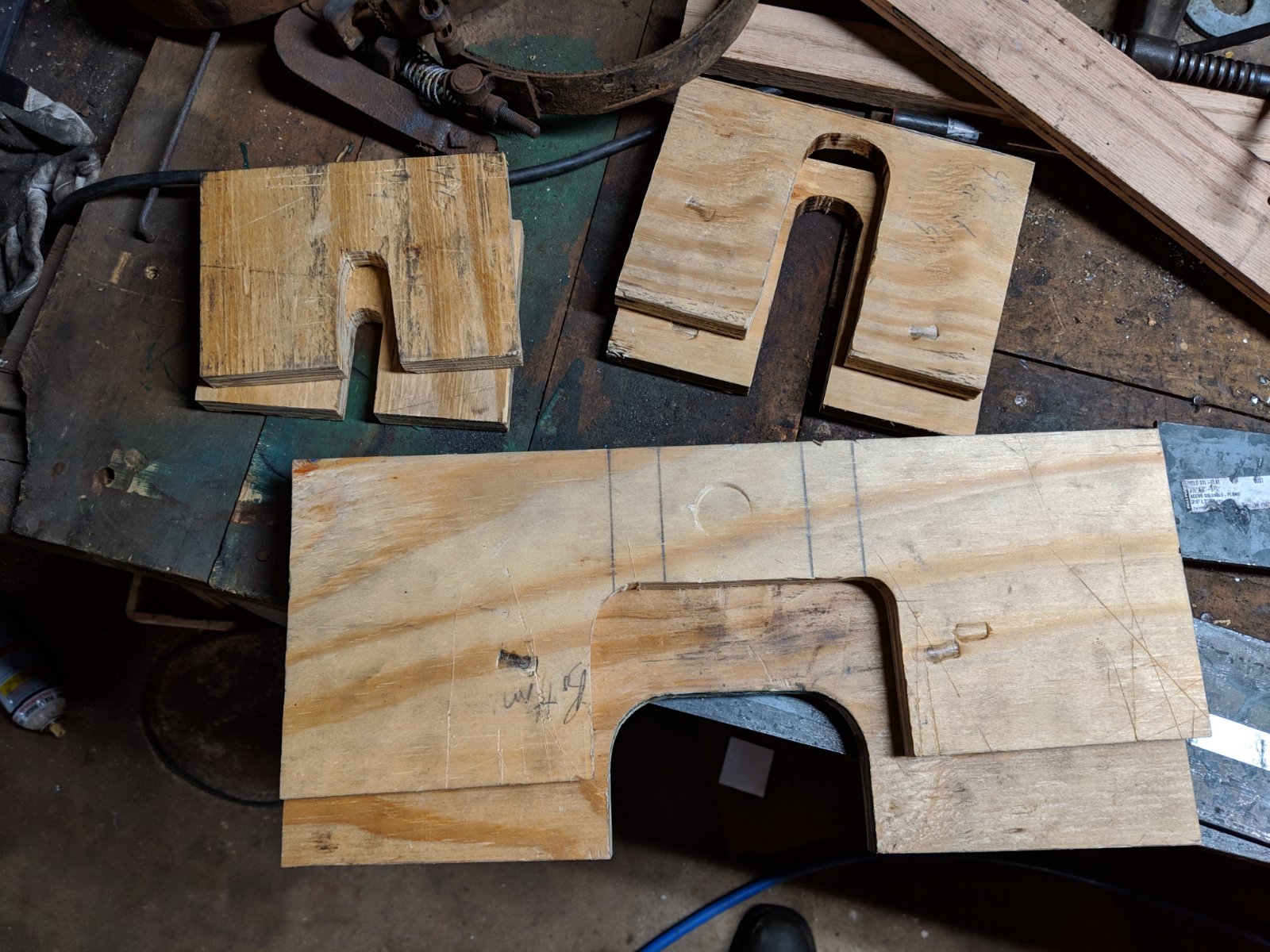

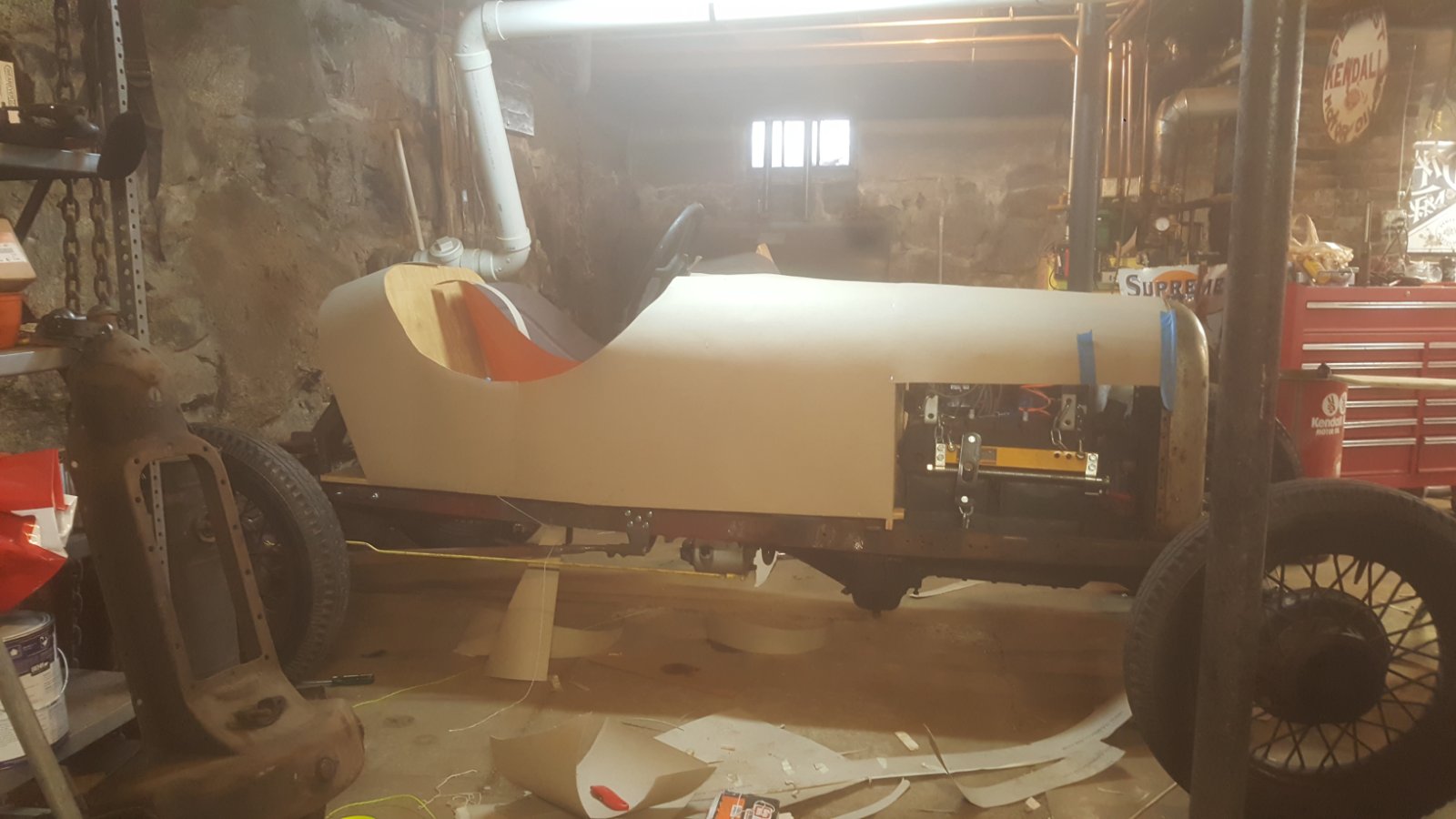

I spent a lot of time playing with cheaper plywood as well as card board and more string as I didn't want to waste good materials while I was still processing ideas.

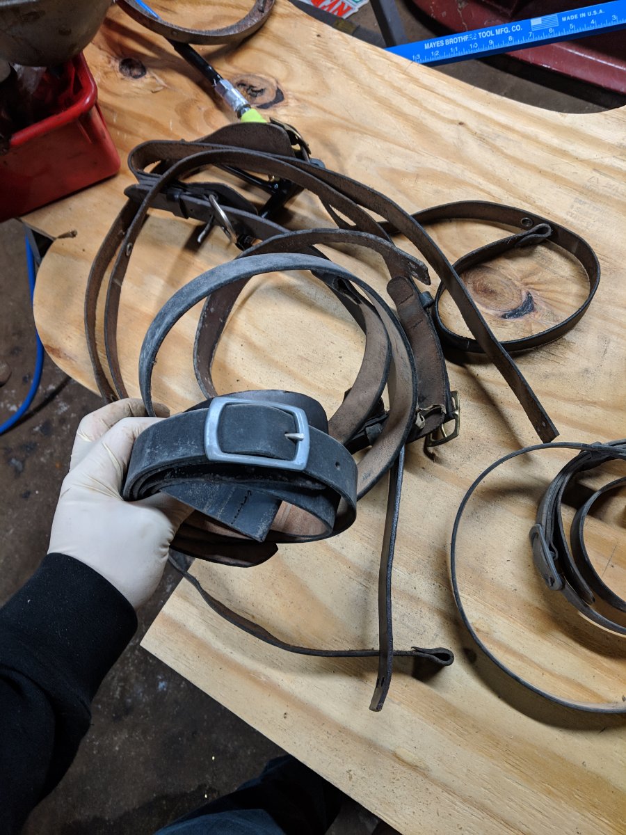

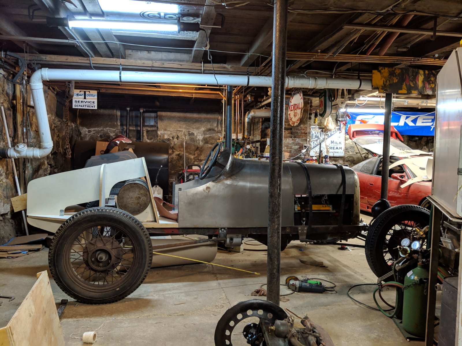

Found some sweet old hood straps for future use.

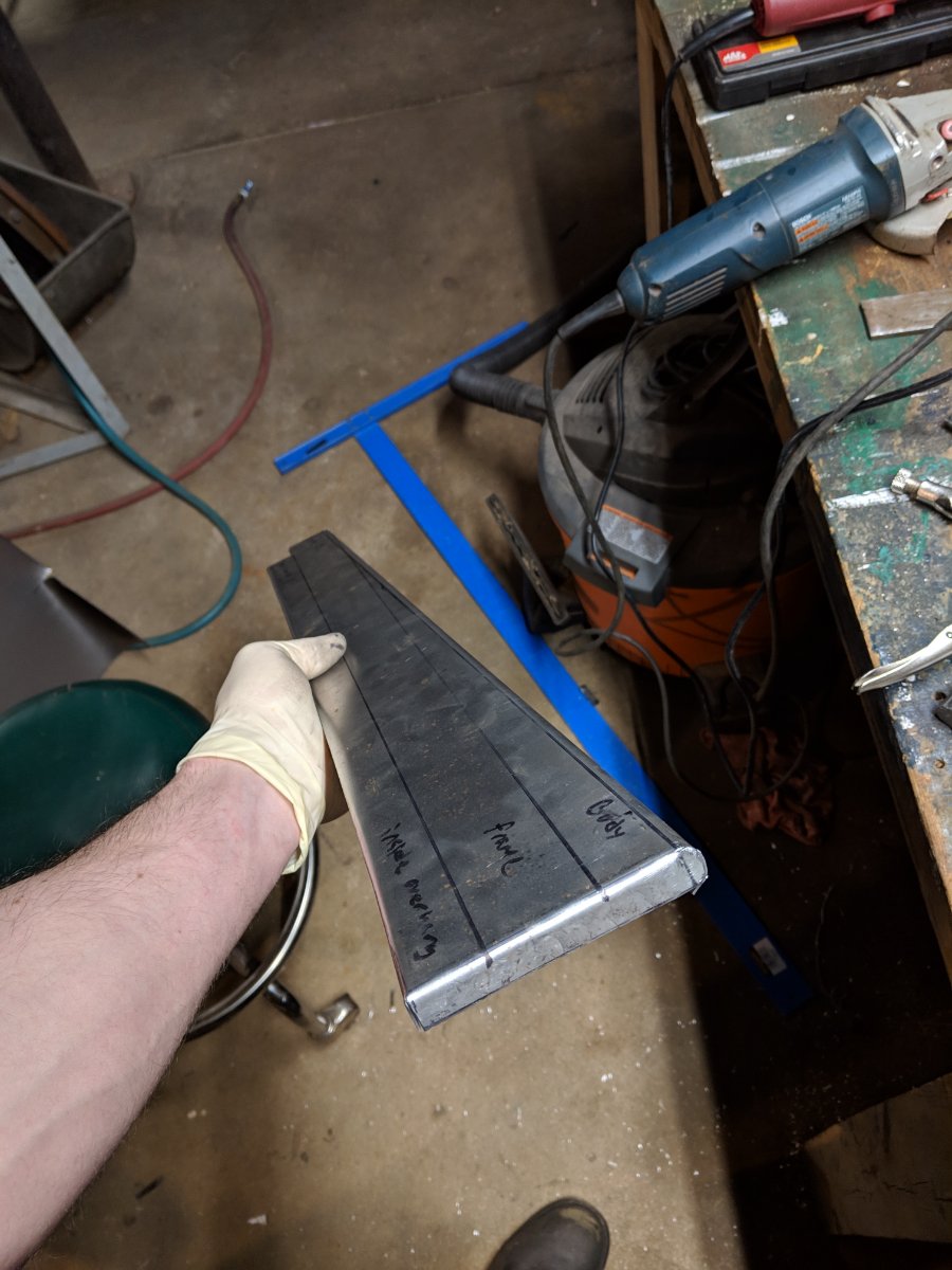

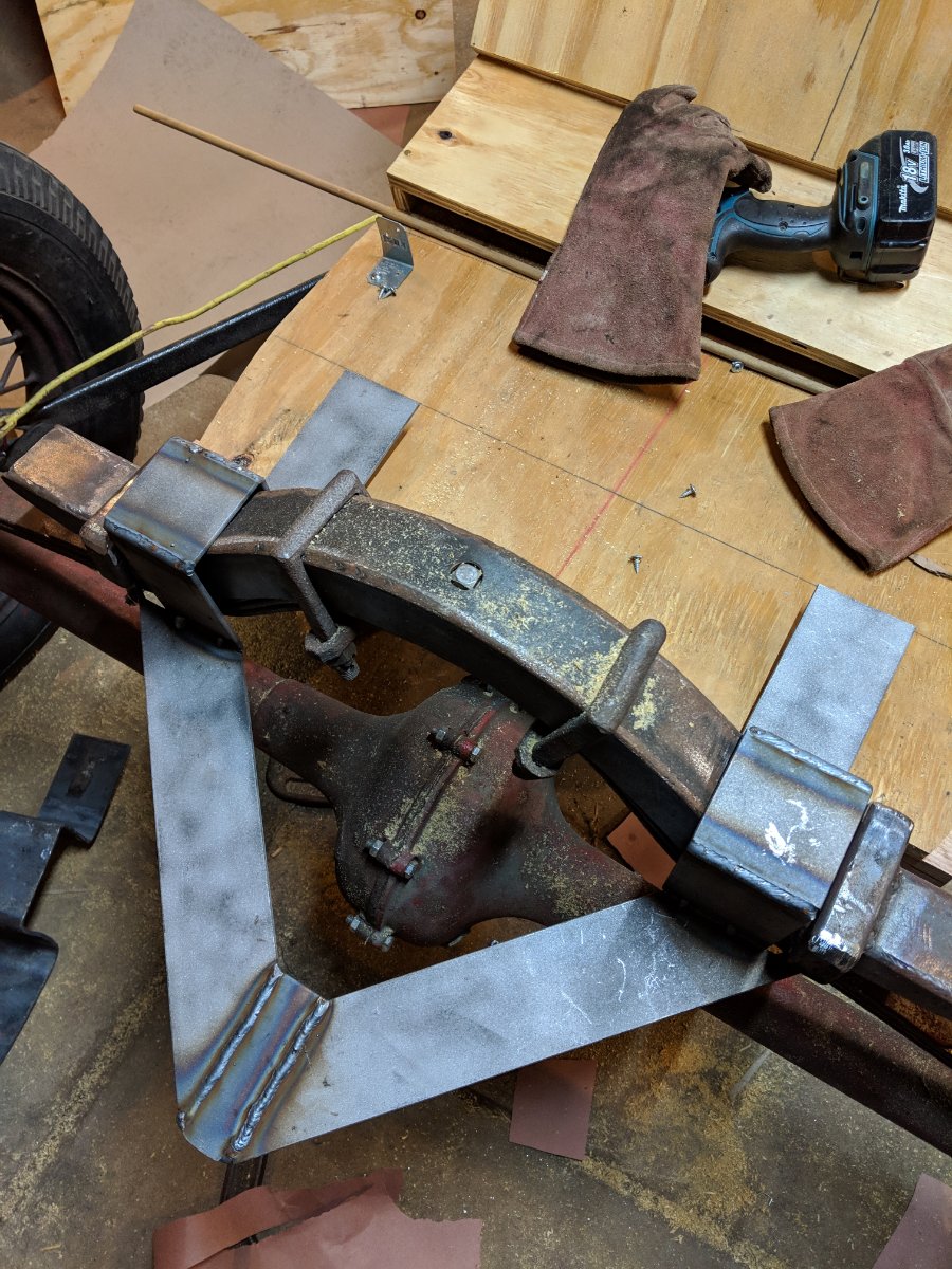

After a lot of modifying I ran a paper template I was happy with.

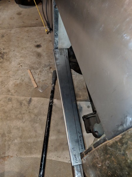

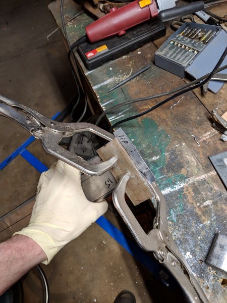

Because the rear cross member sat above the frame line, I had to come up with a bracket that supported the tail. Weld project number 2.
Shane Lach
Posts: 246
First Name: Shane
Last Name: Lach
Location: Milford, NH
Re: Model T Special build.

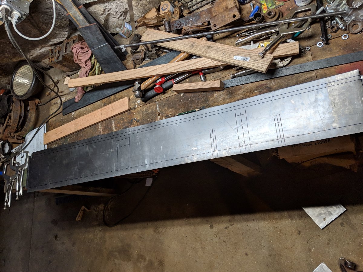

Post by Shane Lach » Tue Mar 05, 2019 9:30 pm

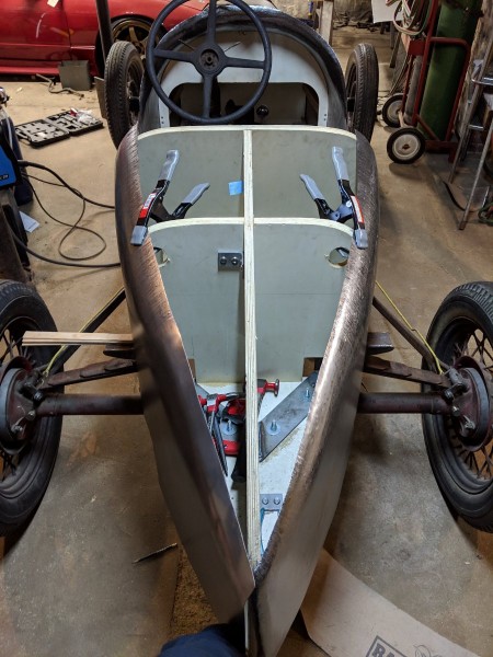

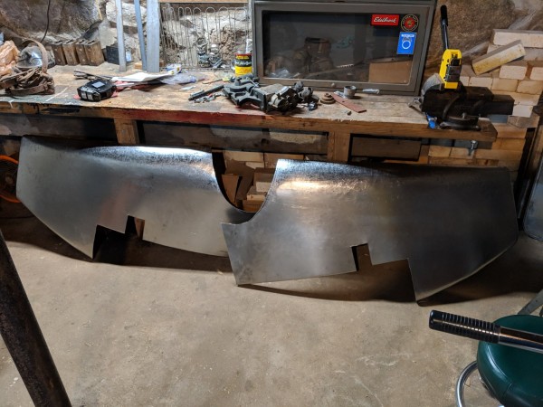

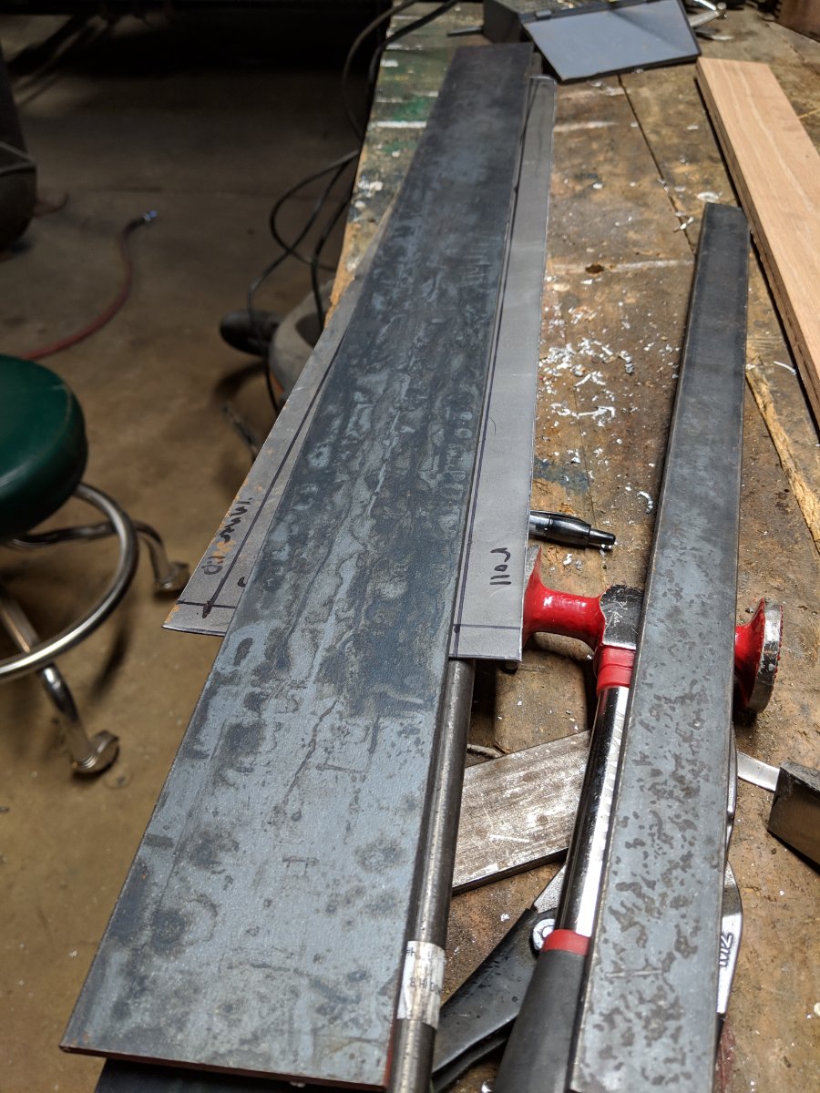

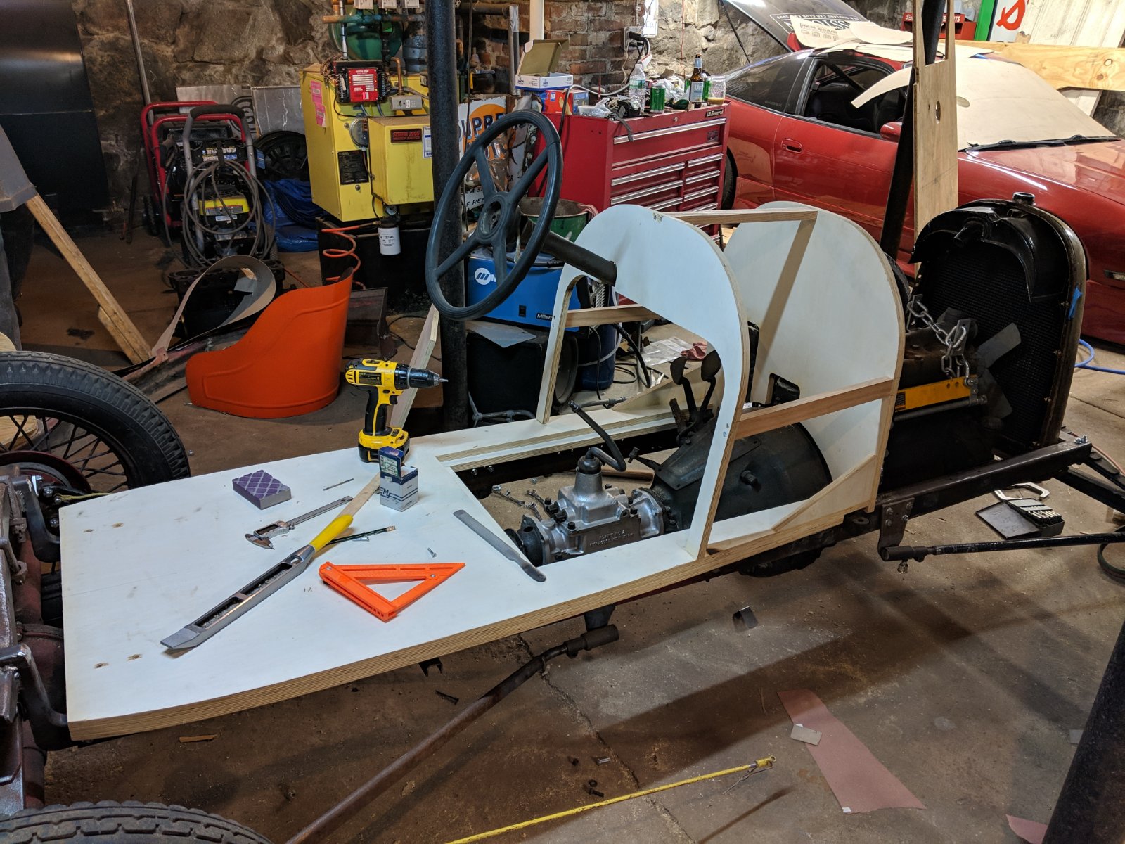

I then took my cheap plywood panels and transferred them to nicer materials.

Post by Shane Lach » Tue Mar 05, 2019 9:35 pm

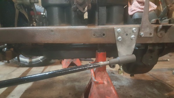

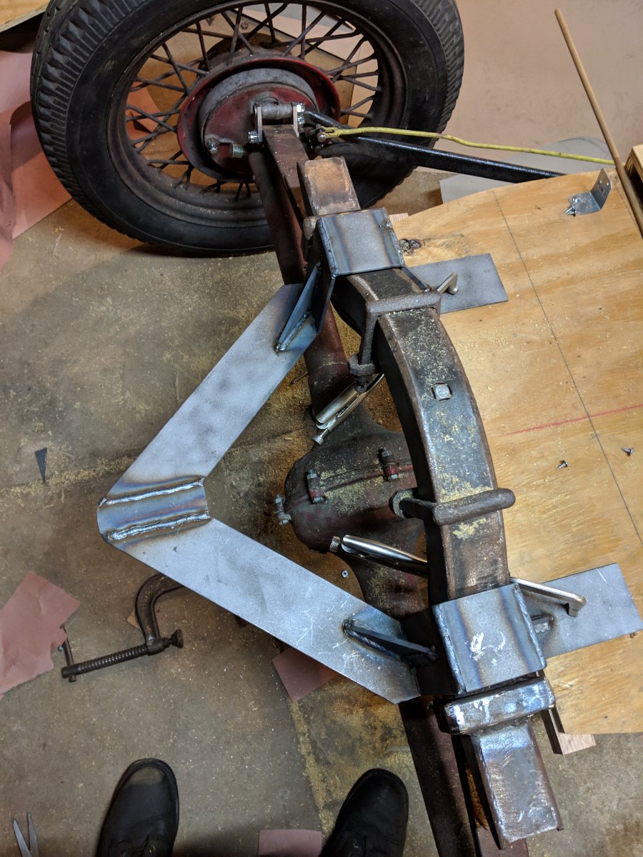

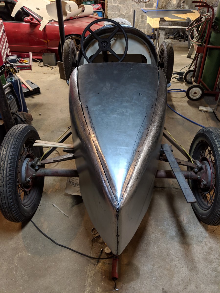

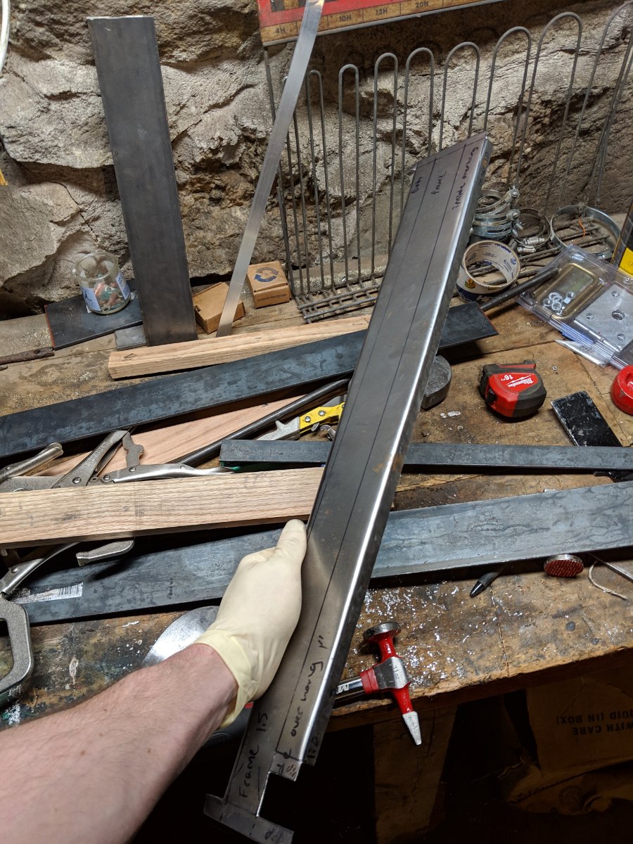

This shows the updated front lowering design. I did a Z bracket from the first cross member I made. The model T cross member has been set back 6" in the frame for a better balance and the raked out look of the old racers.
Shane Lach
Posts: 246
First Name: Shane
Last Name: Lach
Post by Shane Lach » Tue Mar 05, 2019 9:41 pm

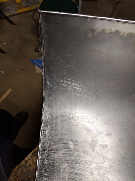

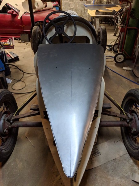

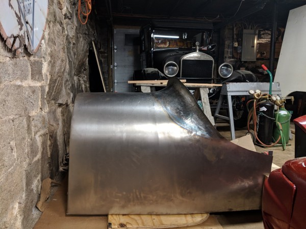

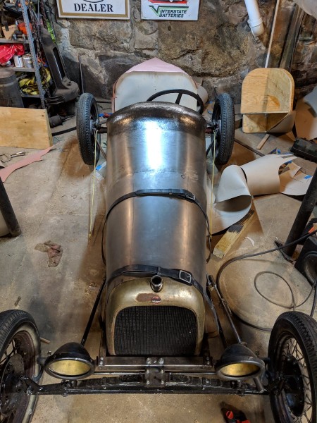

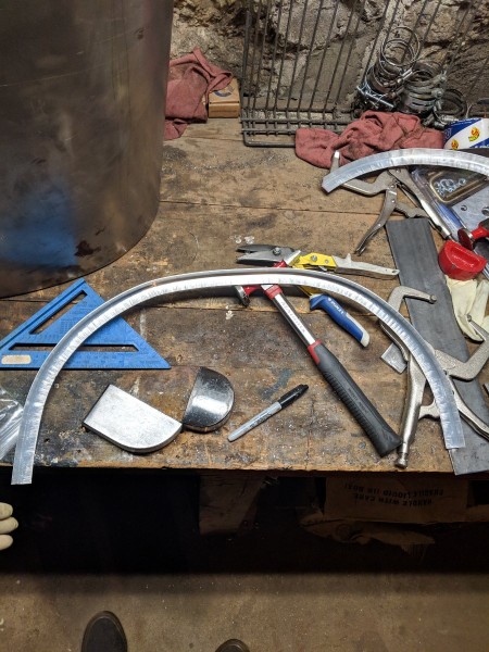

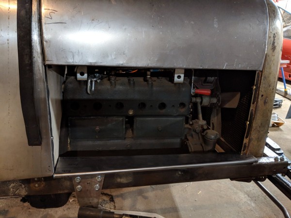

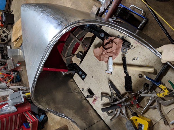

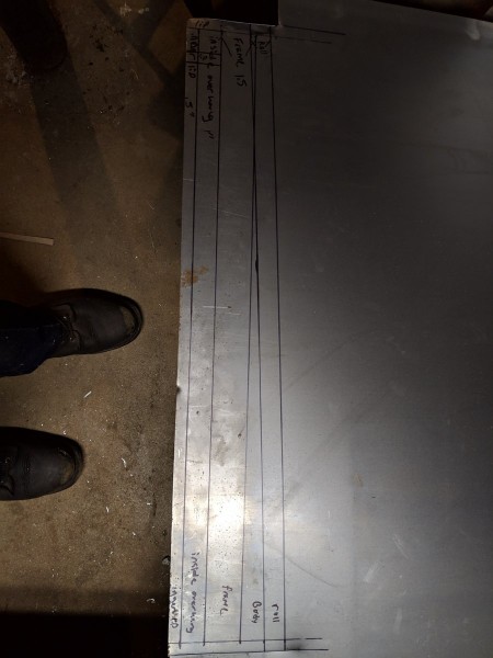

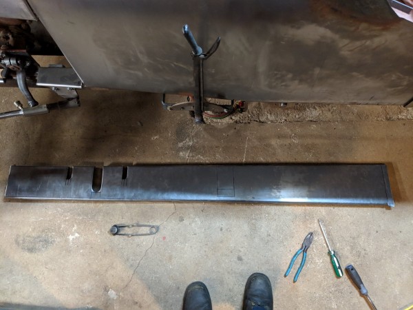

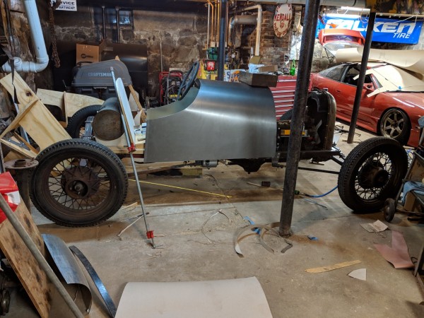

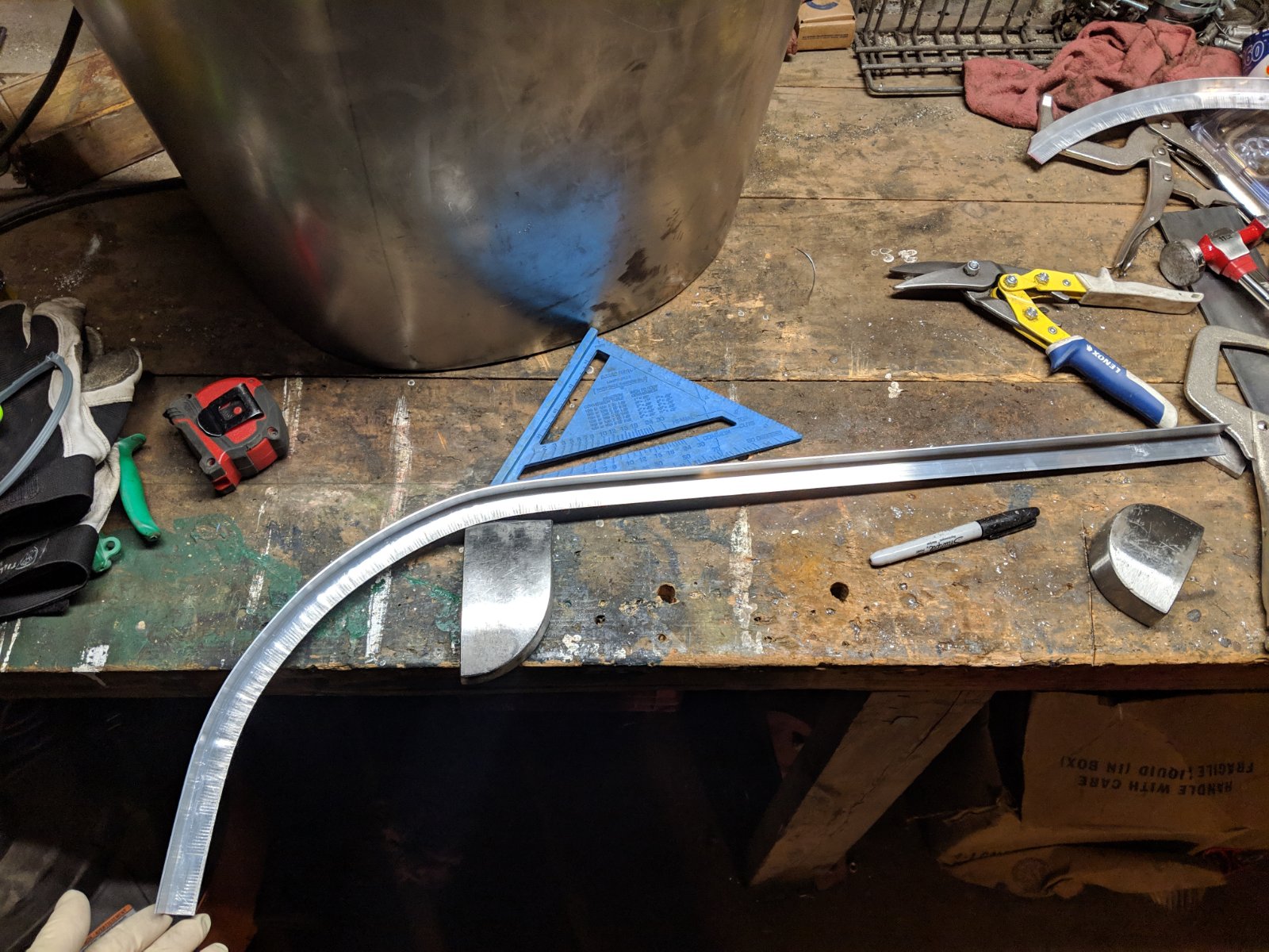

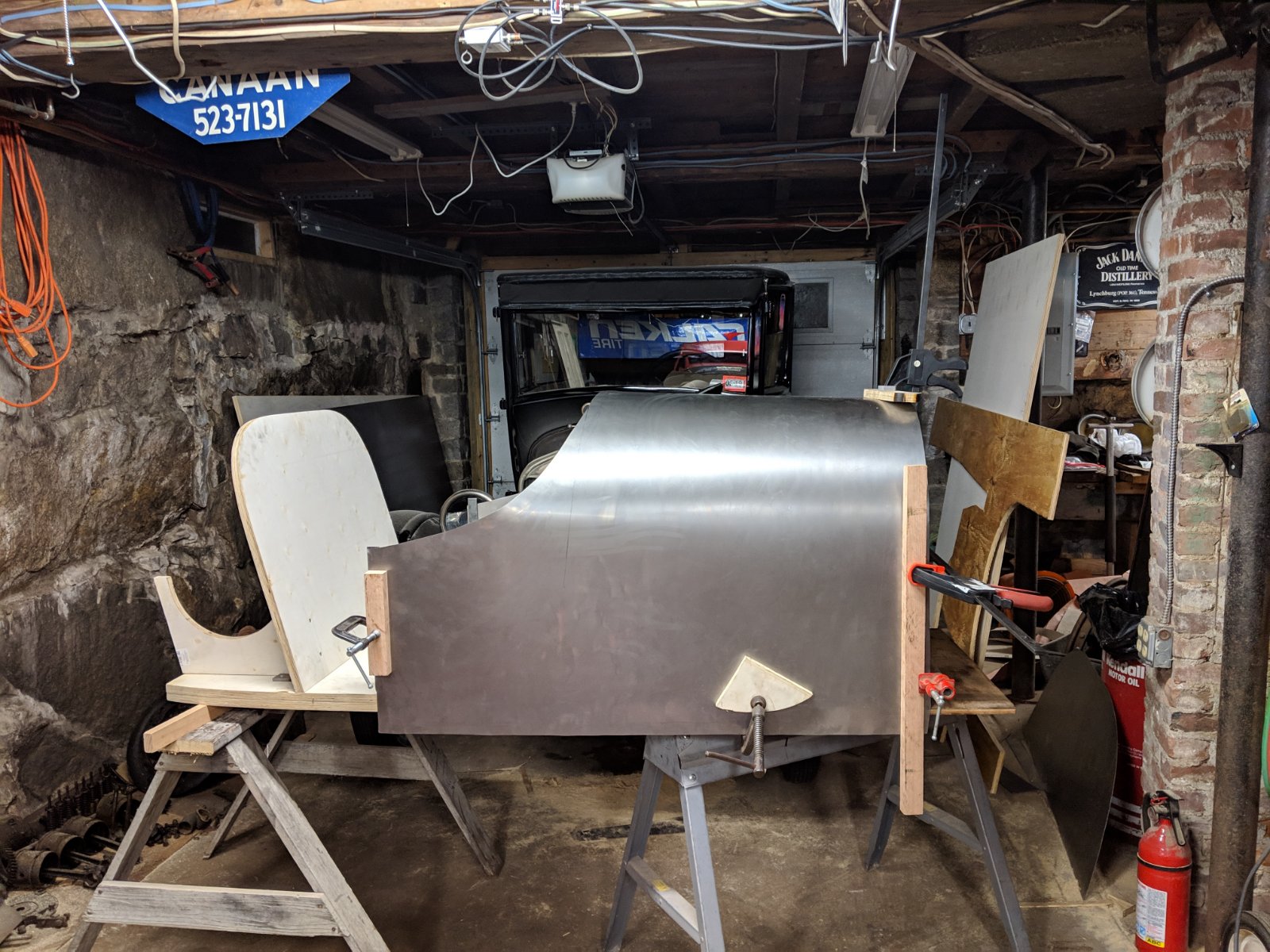

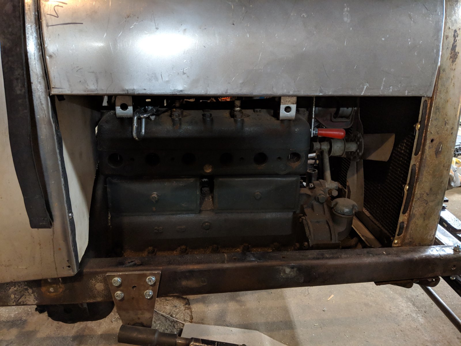

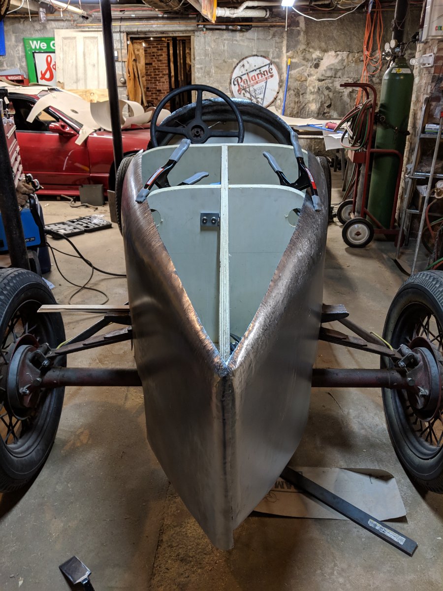

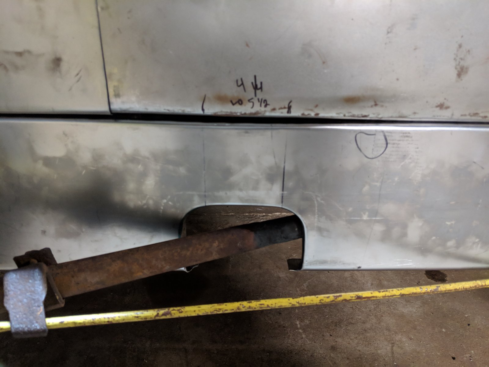

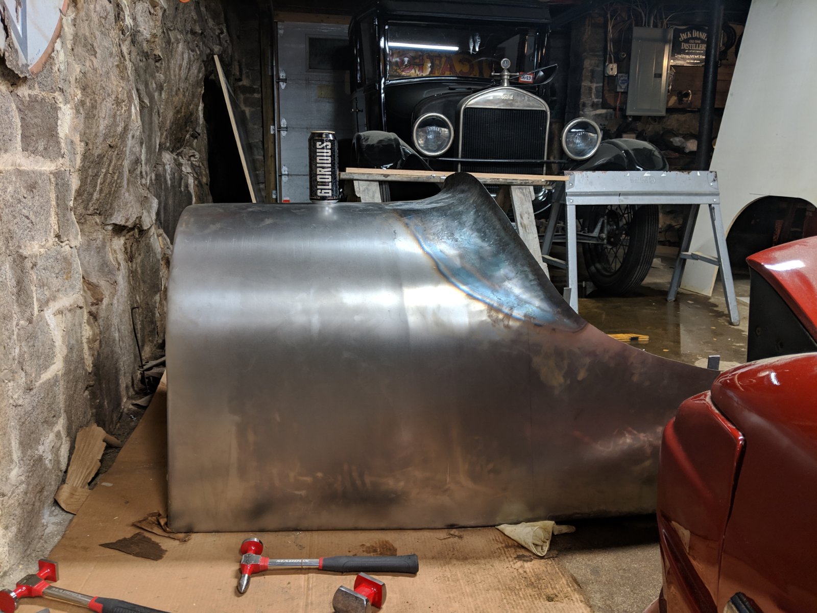

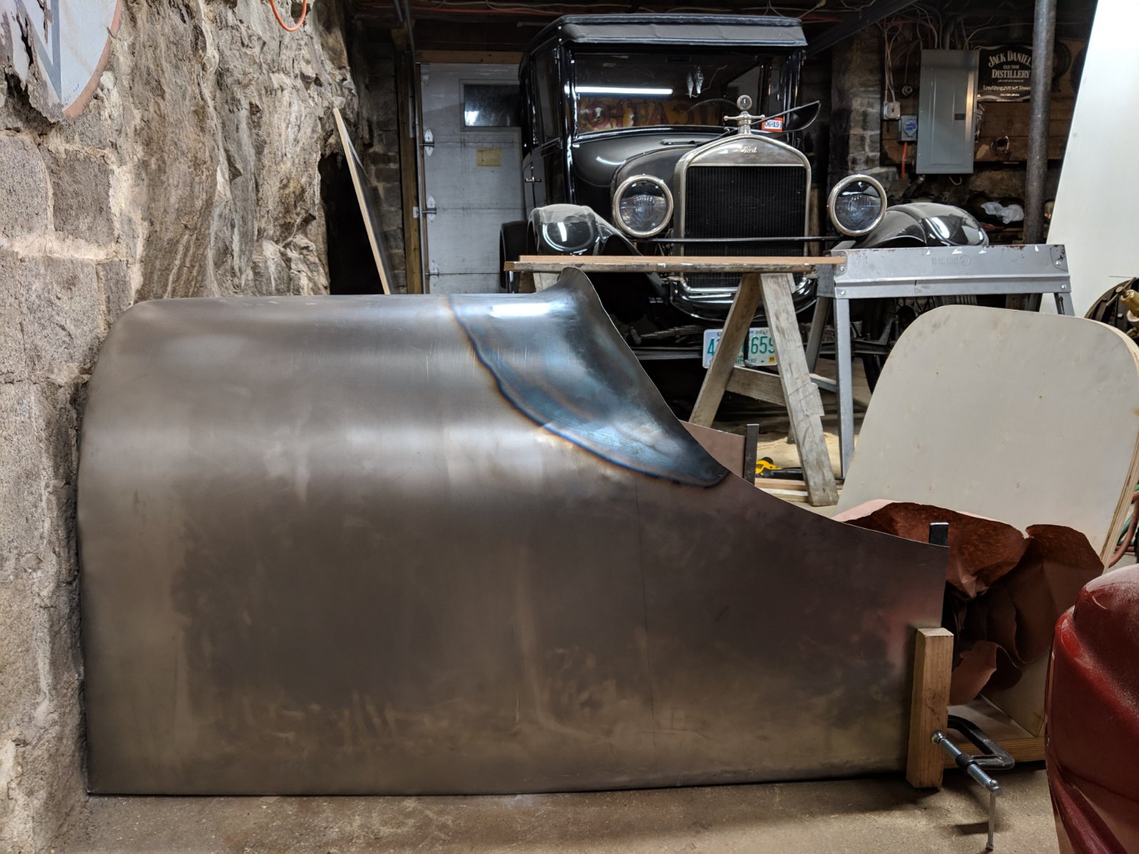

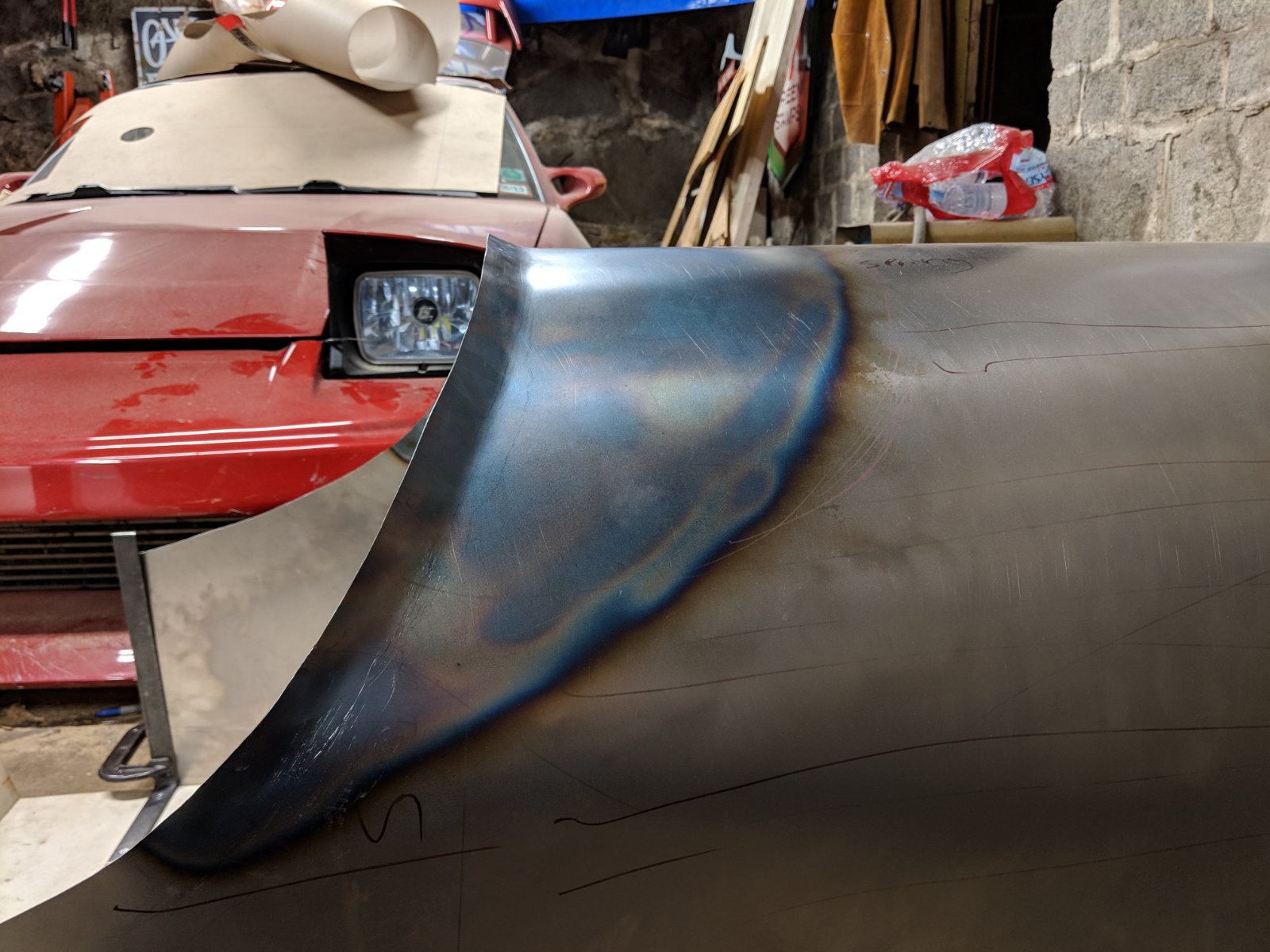

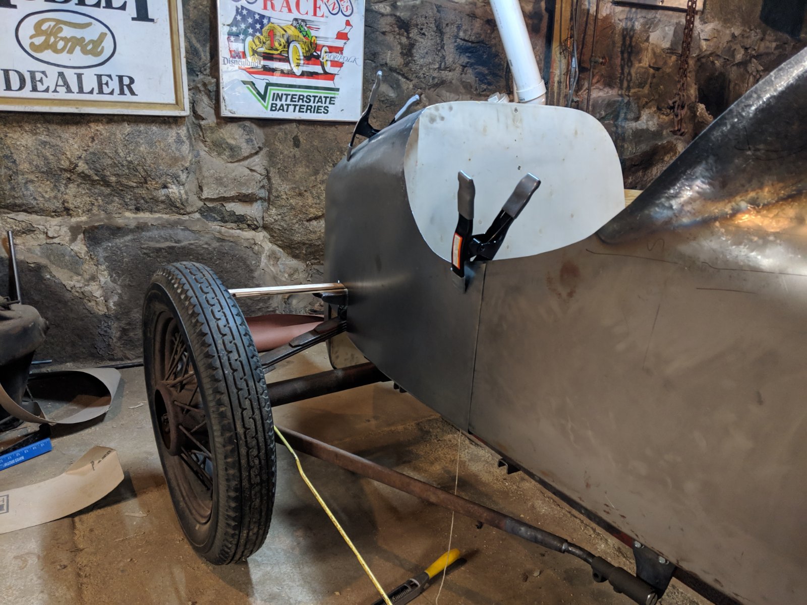

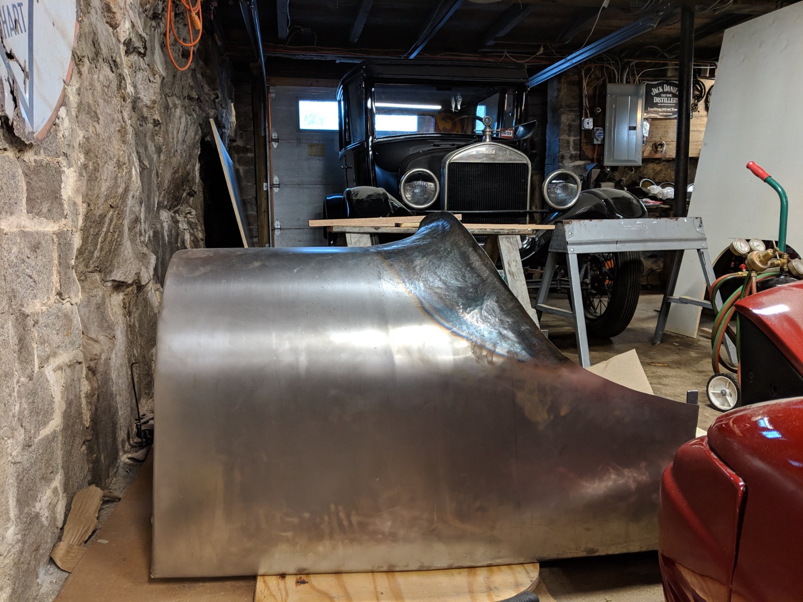

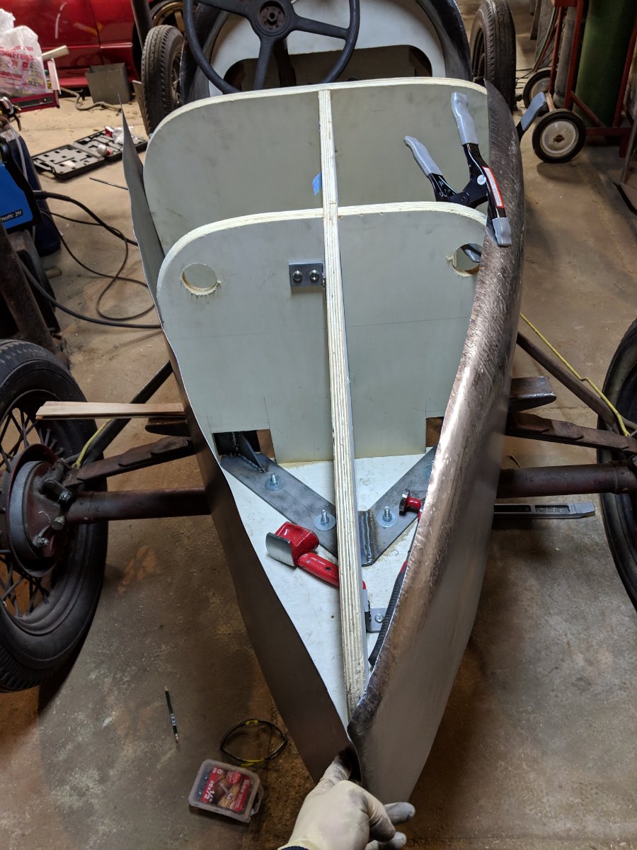

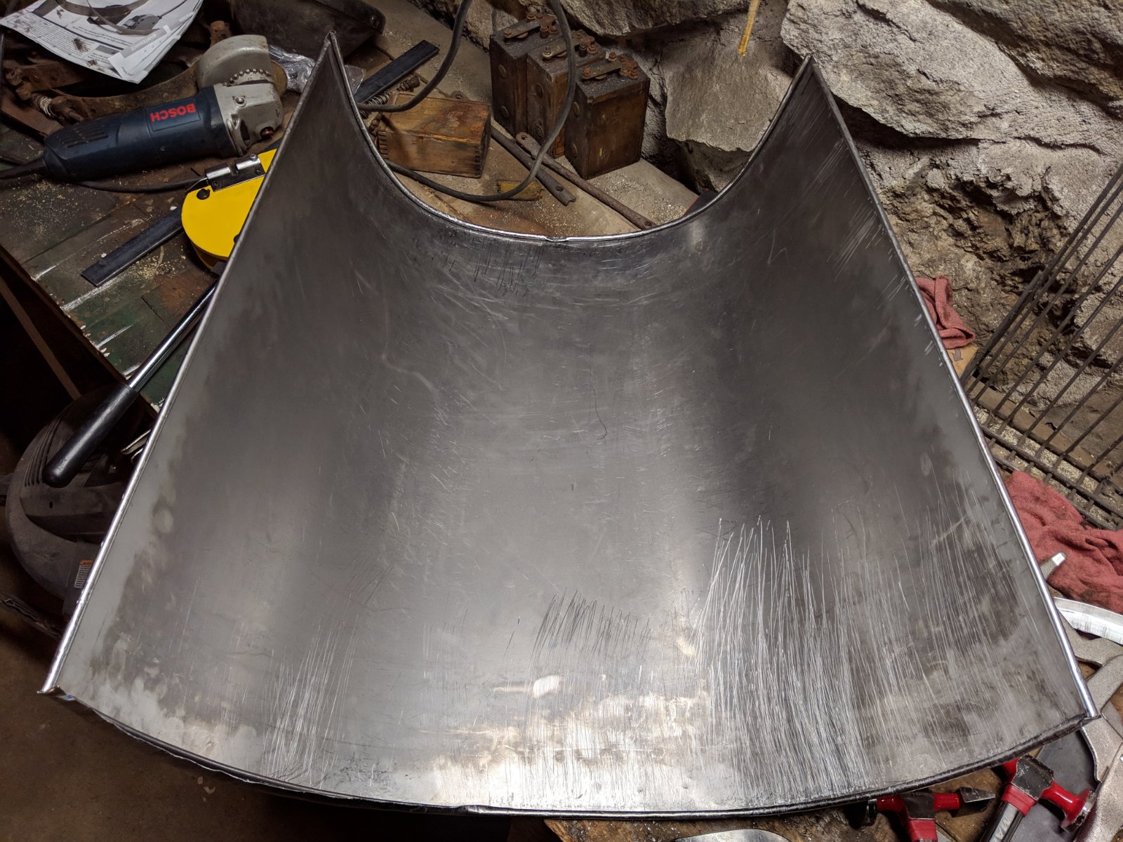

I then bought some sheet metal!

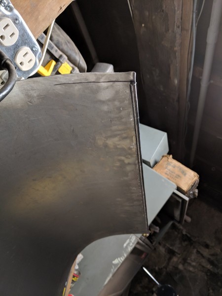

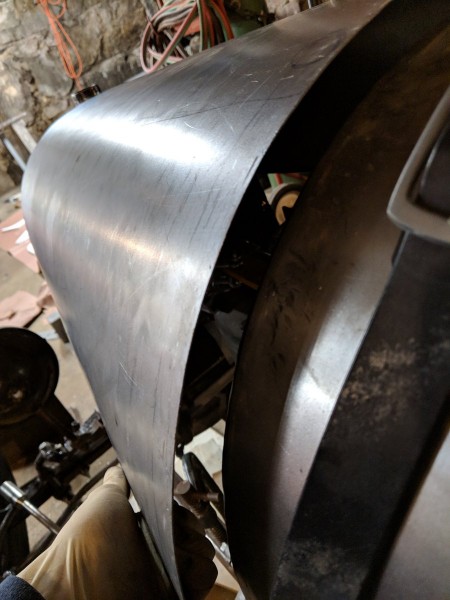

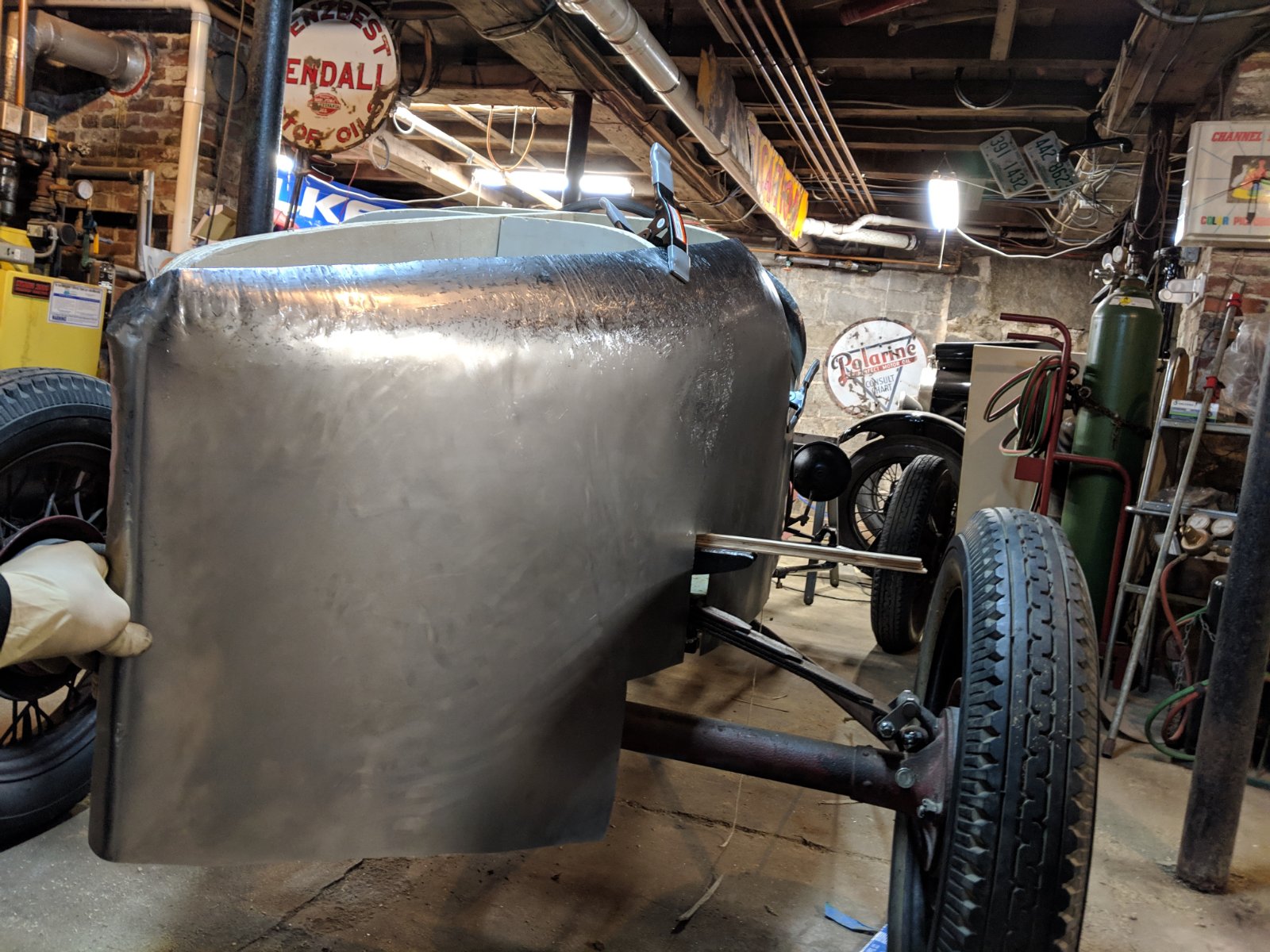

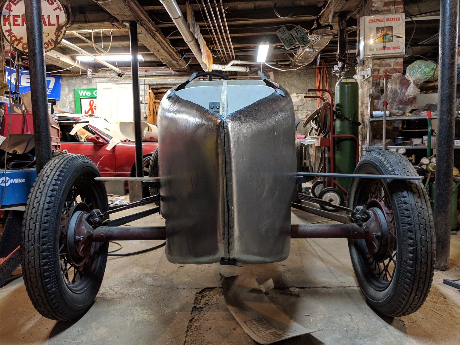

Began flaring the cowl. Do not use heat. That was a huge mistake.

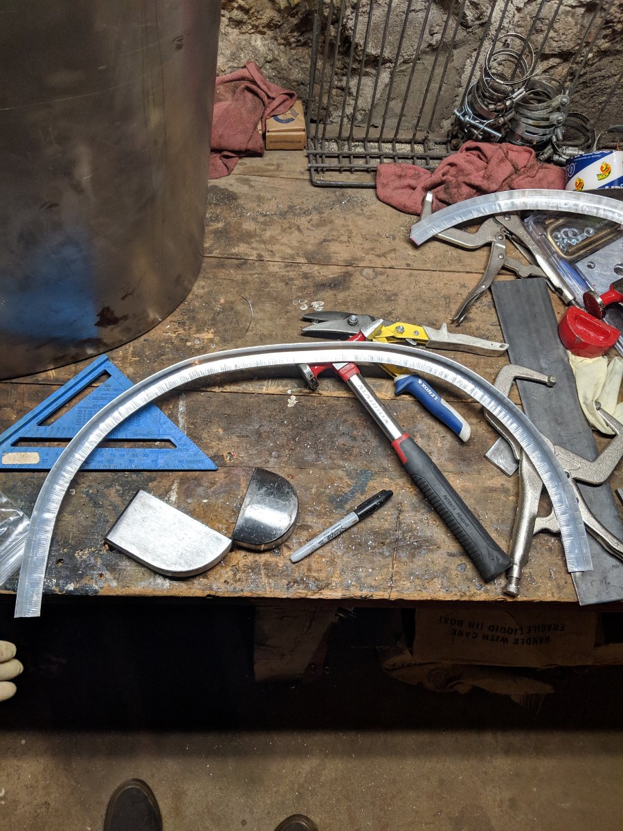

Post by Shane Lach » Tue Mar 05, 2019 9:43 pm

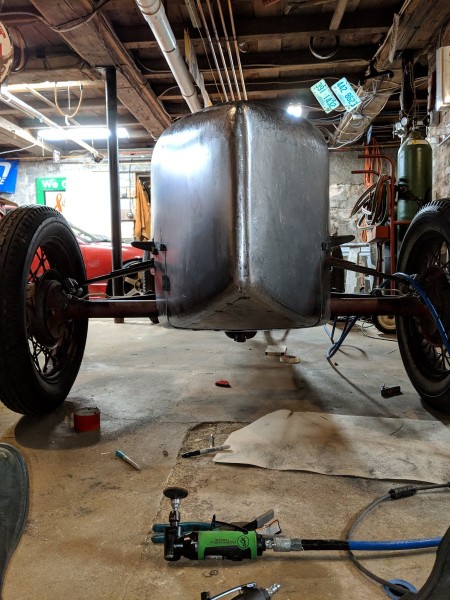

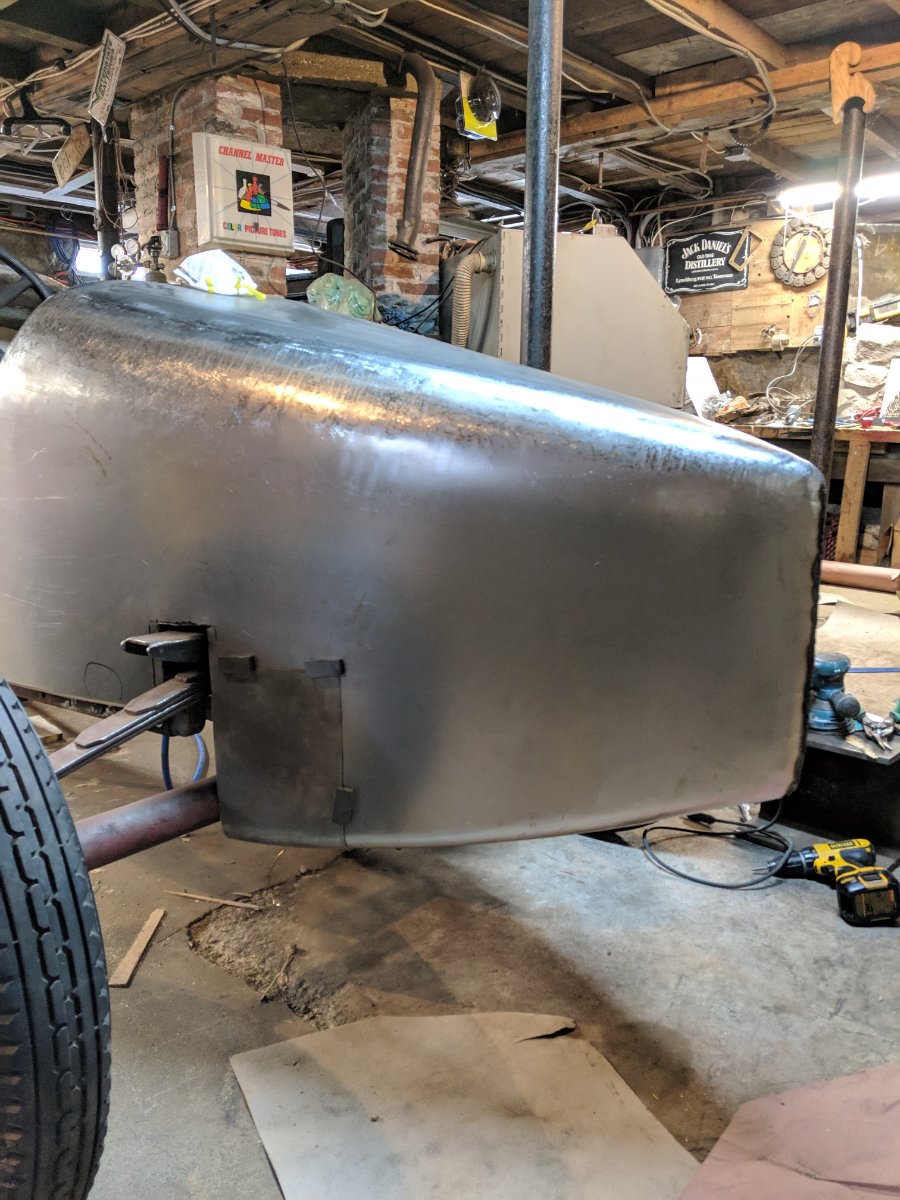

More flaring. All hammer and dolly. I don't own any nice fancy tools.

Post by Shane Lach » Tue Mar 05, 2019 9:48 pm

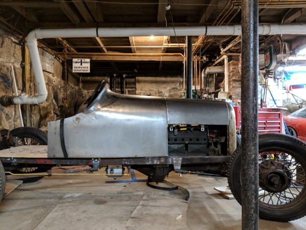

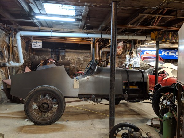

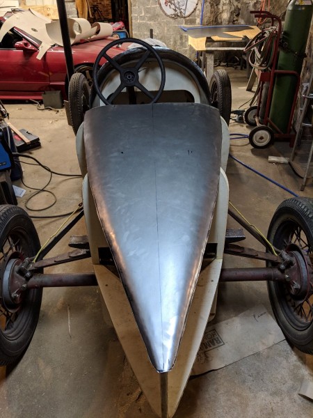

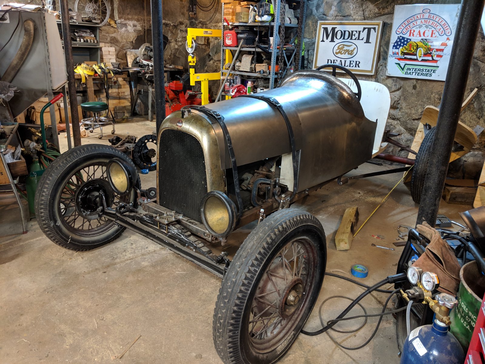

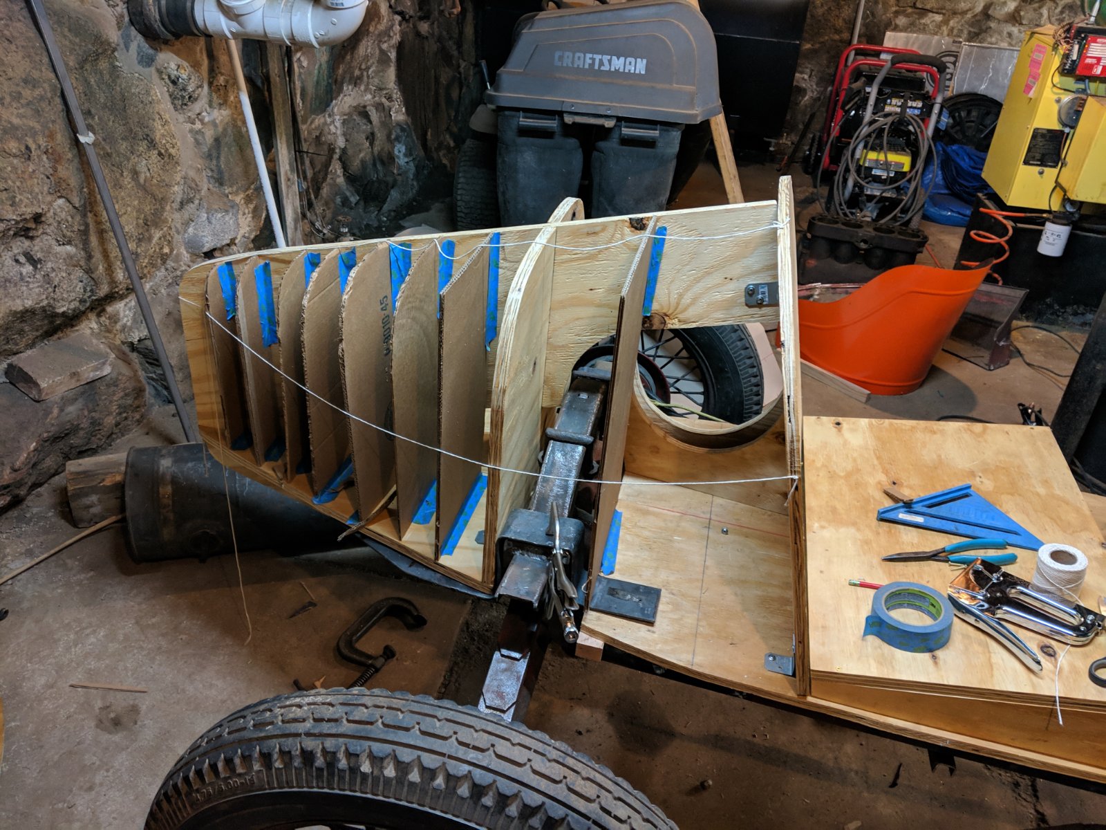

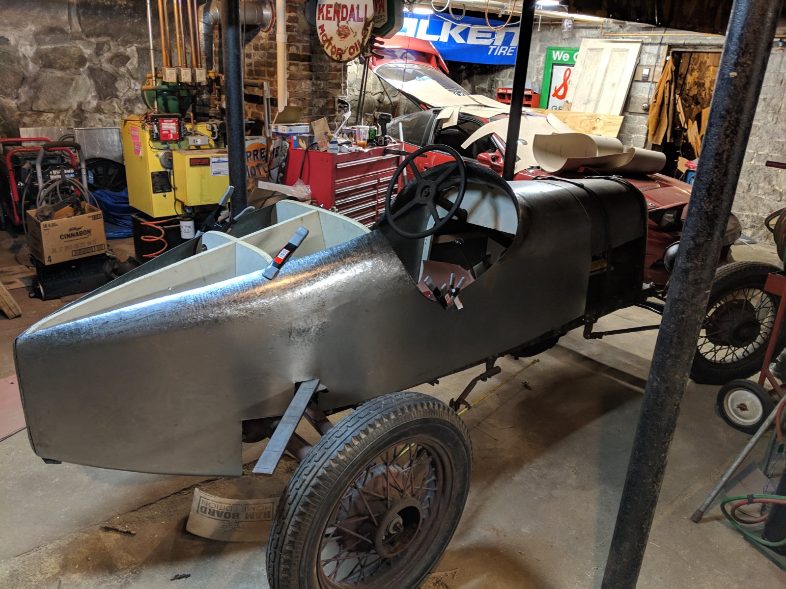

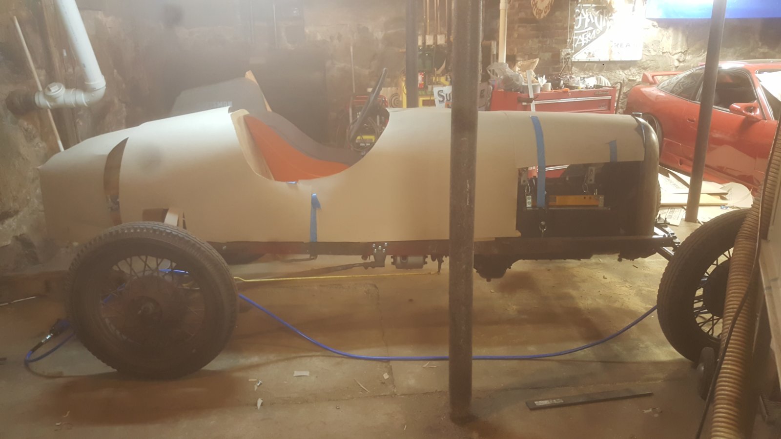

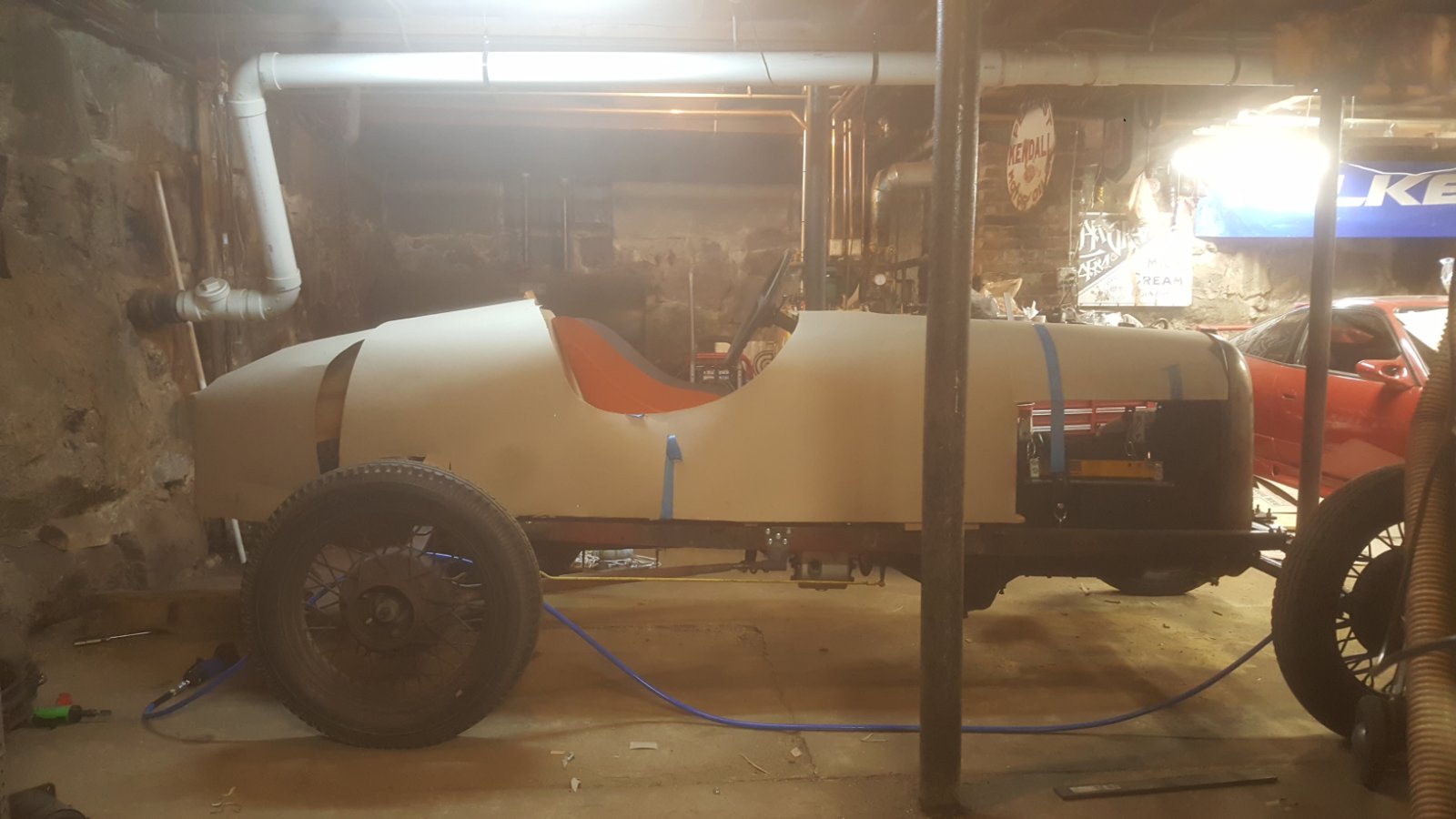

I whipped up a quick hood to lay on and had to throw the straps on obviously.
Then moved back to the tail skeleton/buck.
More paper and templates!

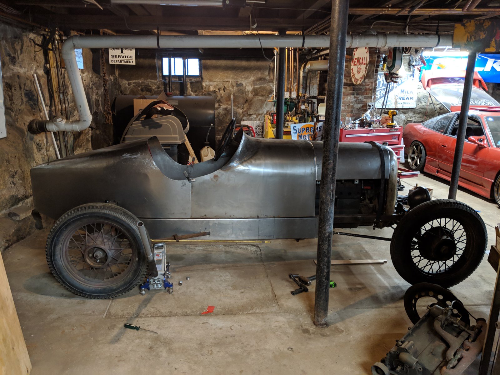

Post by Shane Lach » Tue Mar 05, 2019 9:50 pm

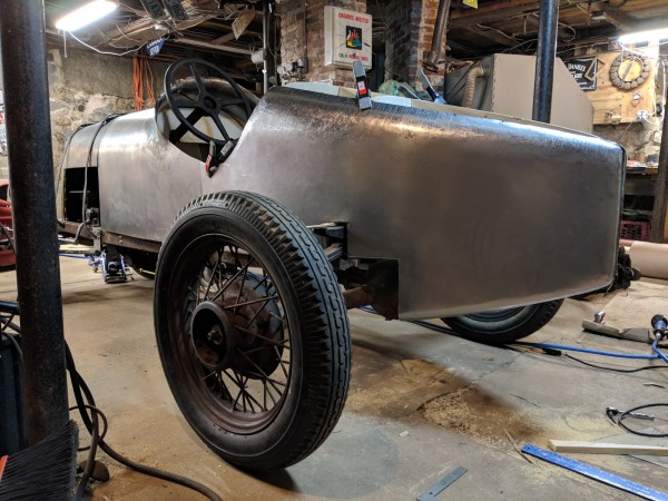

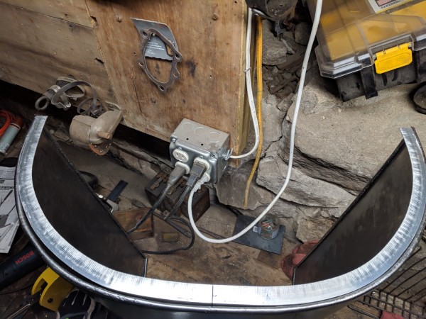

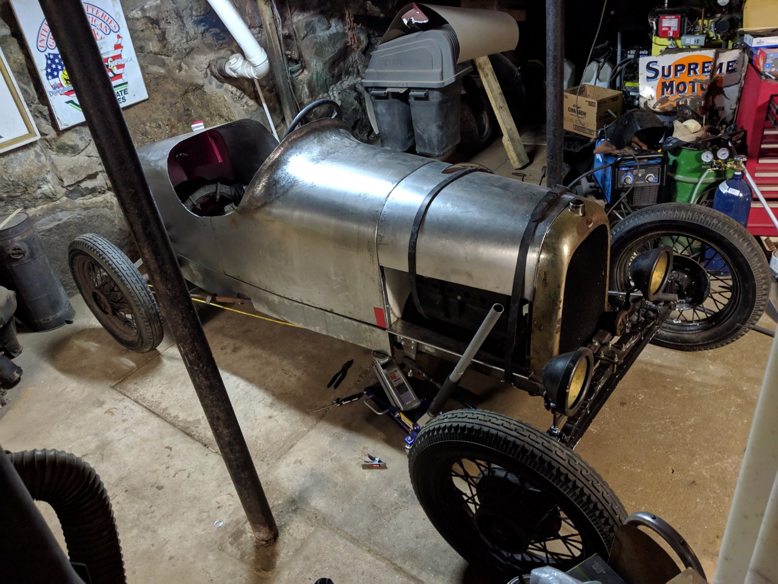

Performing some shaping and tuck shrinking
Shane Lach
Posts: 246
First Name: Shane
Last Name: Lach
Post by Shane Lach » Tue Mar 05, 2019 9:52 pm

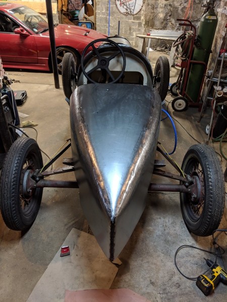

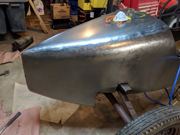

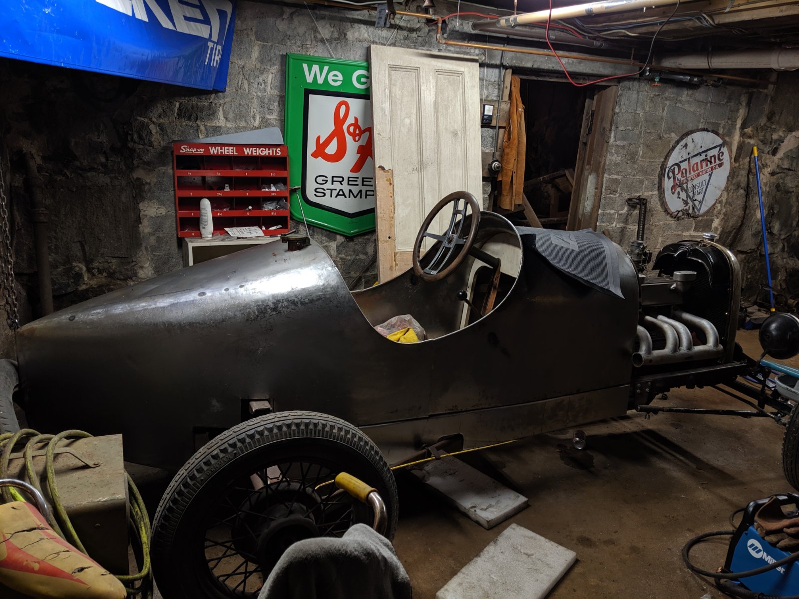

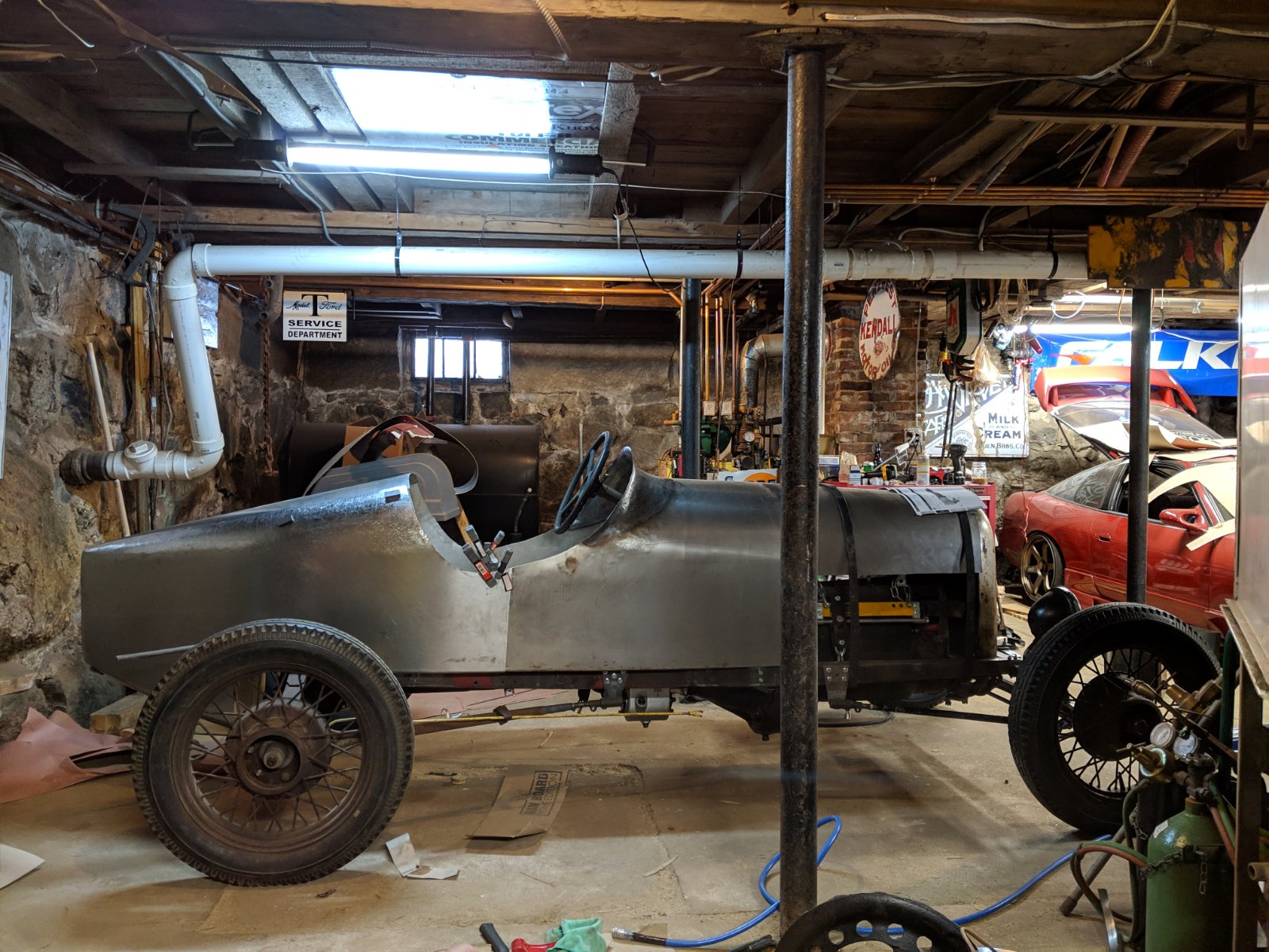

Not too shabby I guess for no sheet metal skill

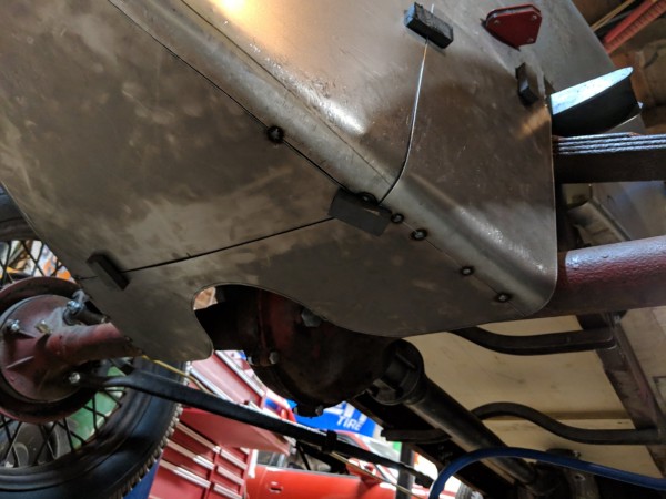

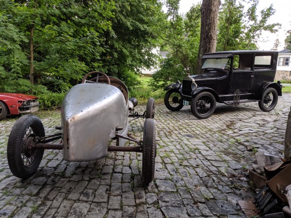

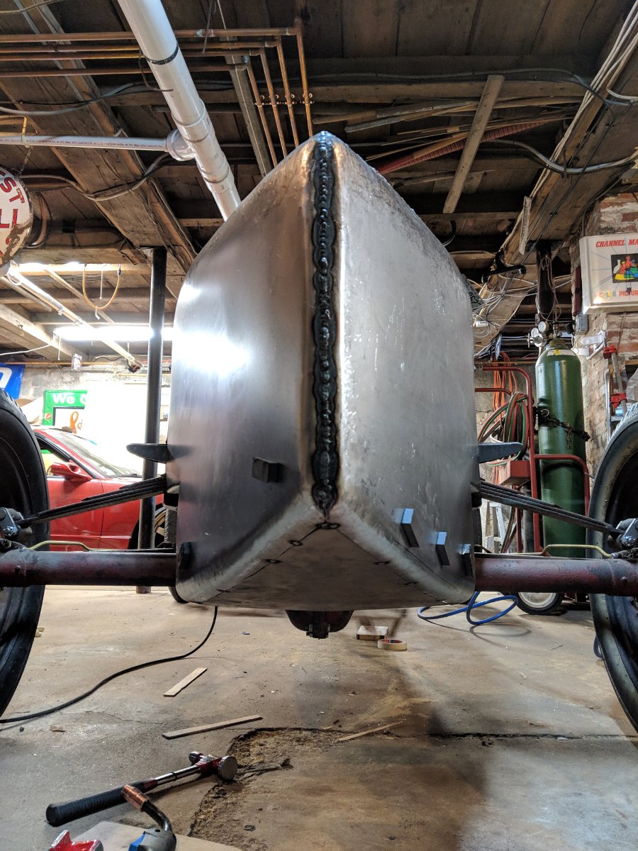

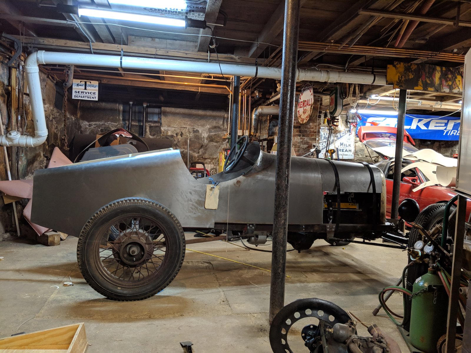

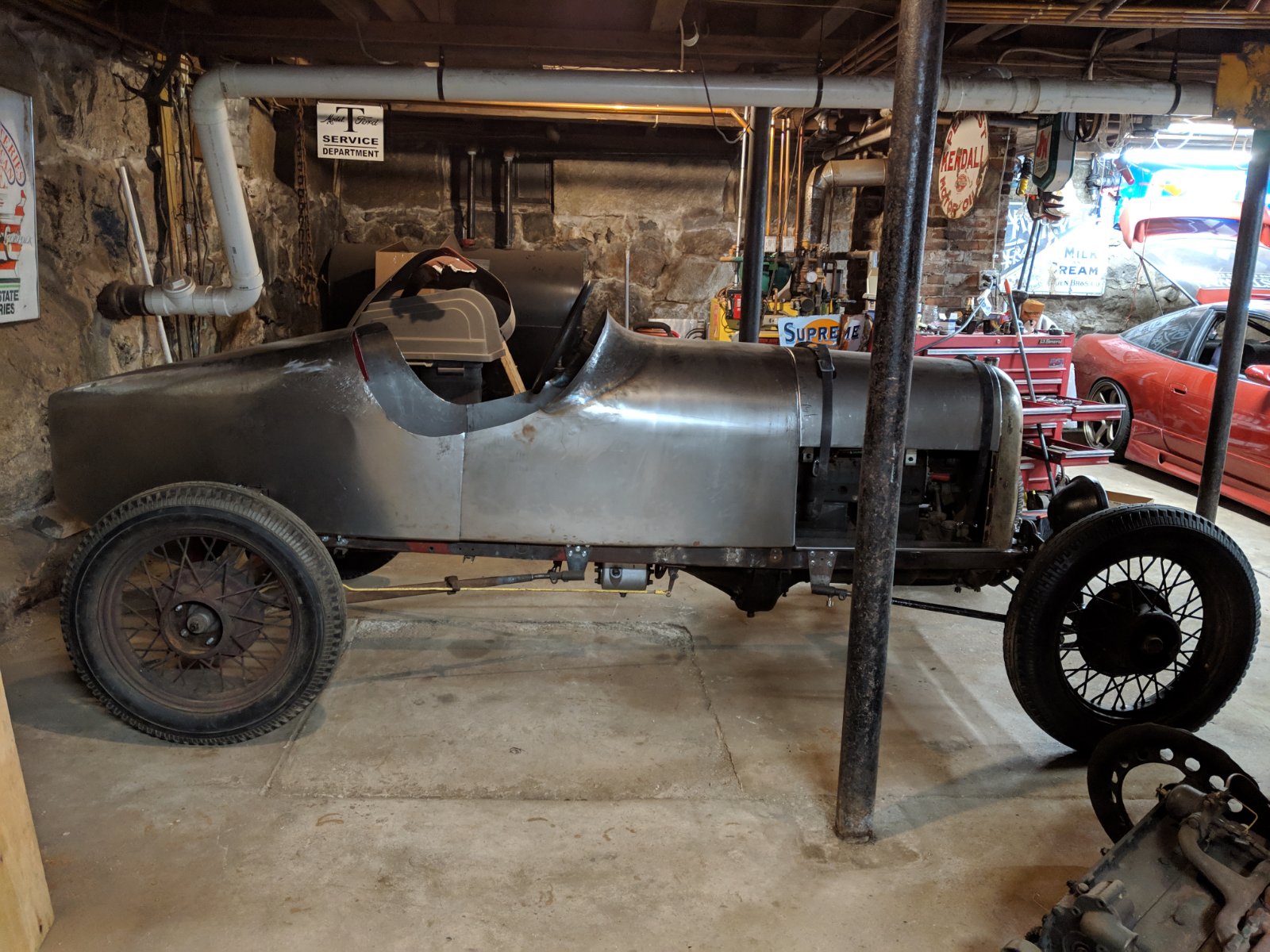

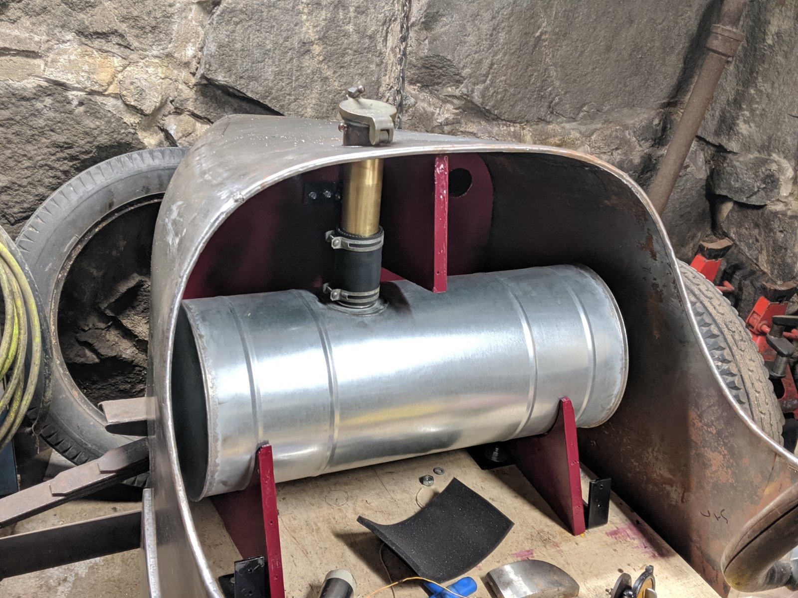

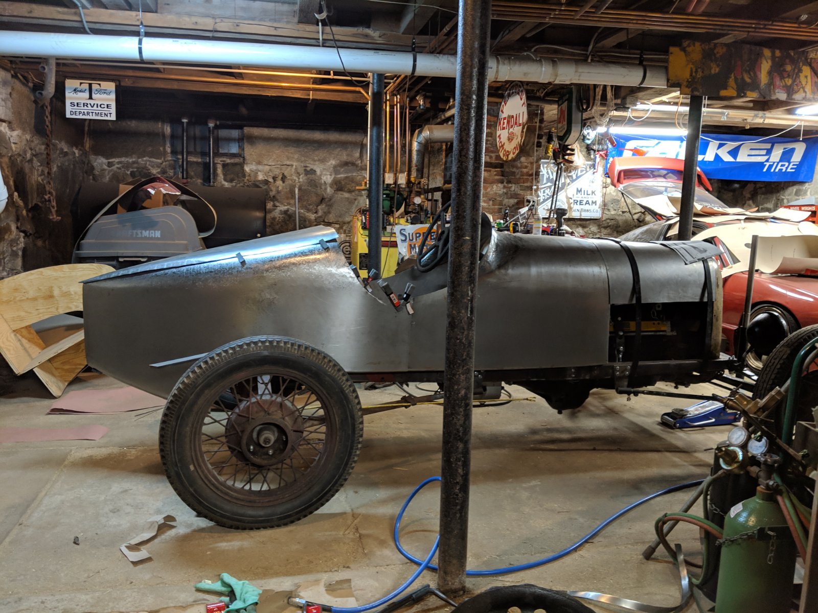

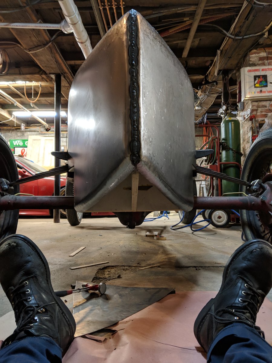

Modified the bottom of the tail for less downward sweep. The car will eventually have skirts and I'd like them to flow with the tail.

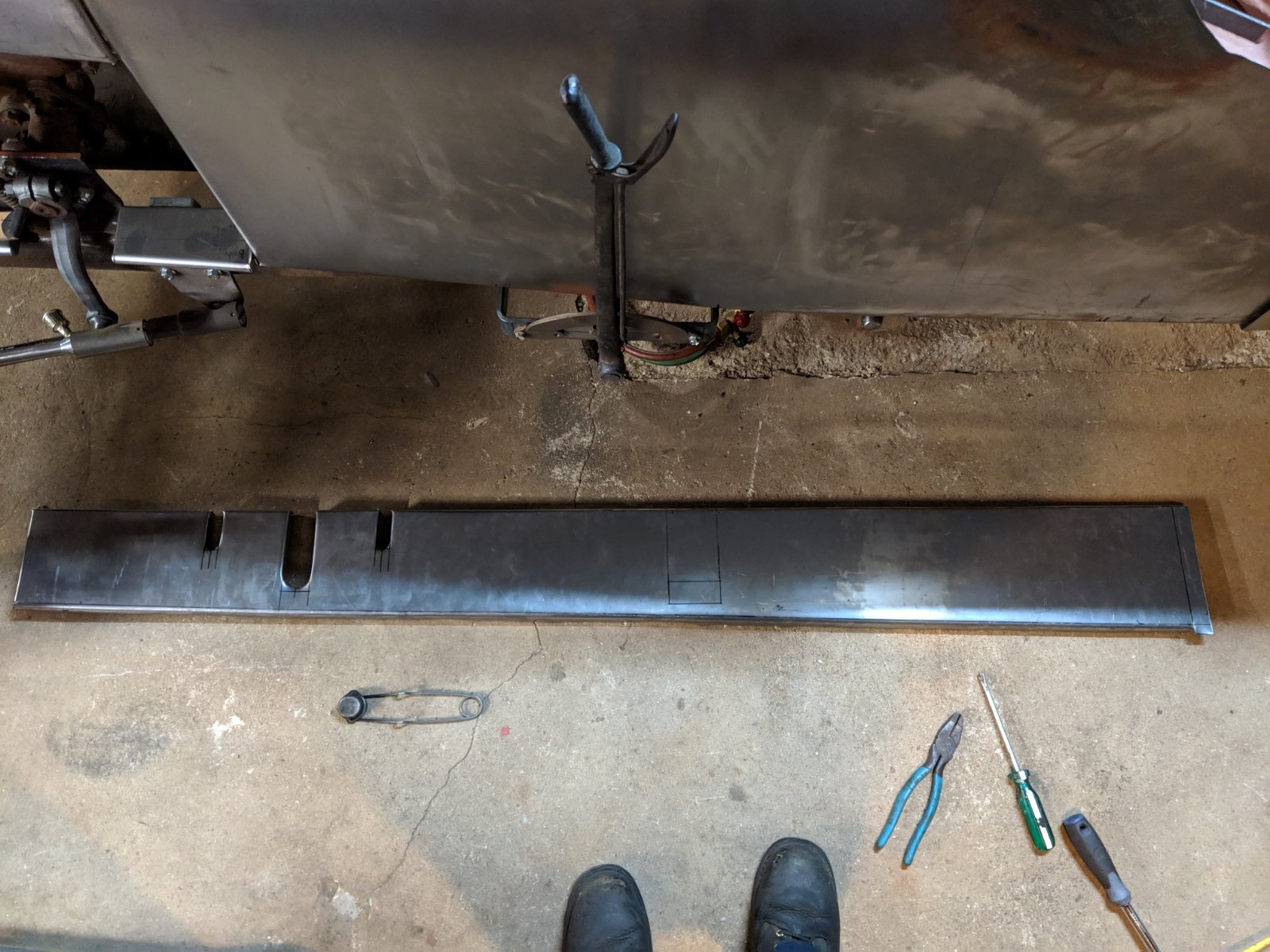

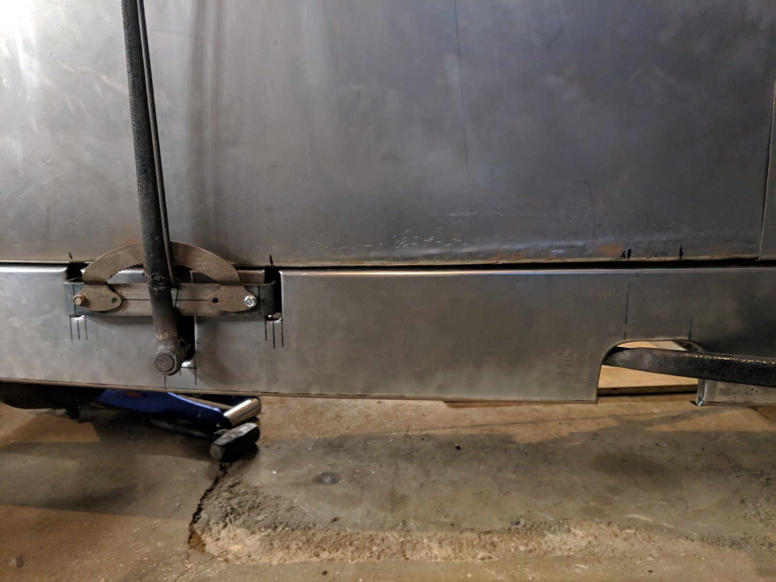

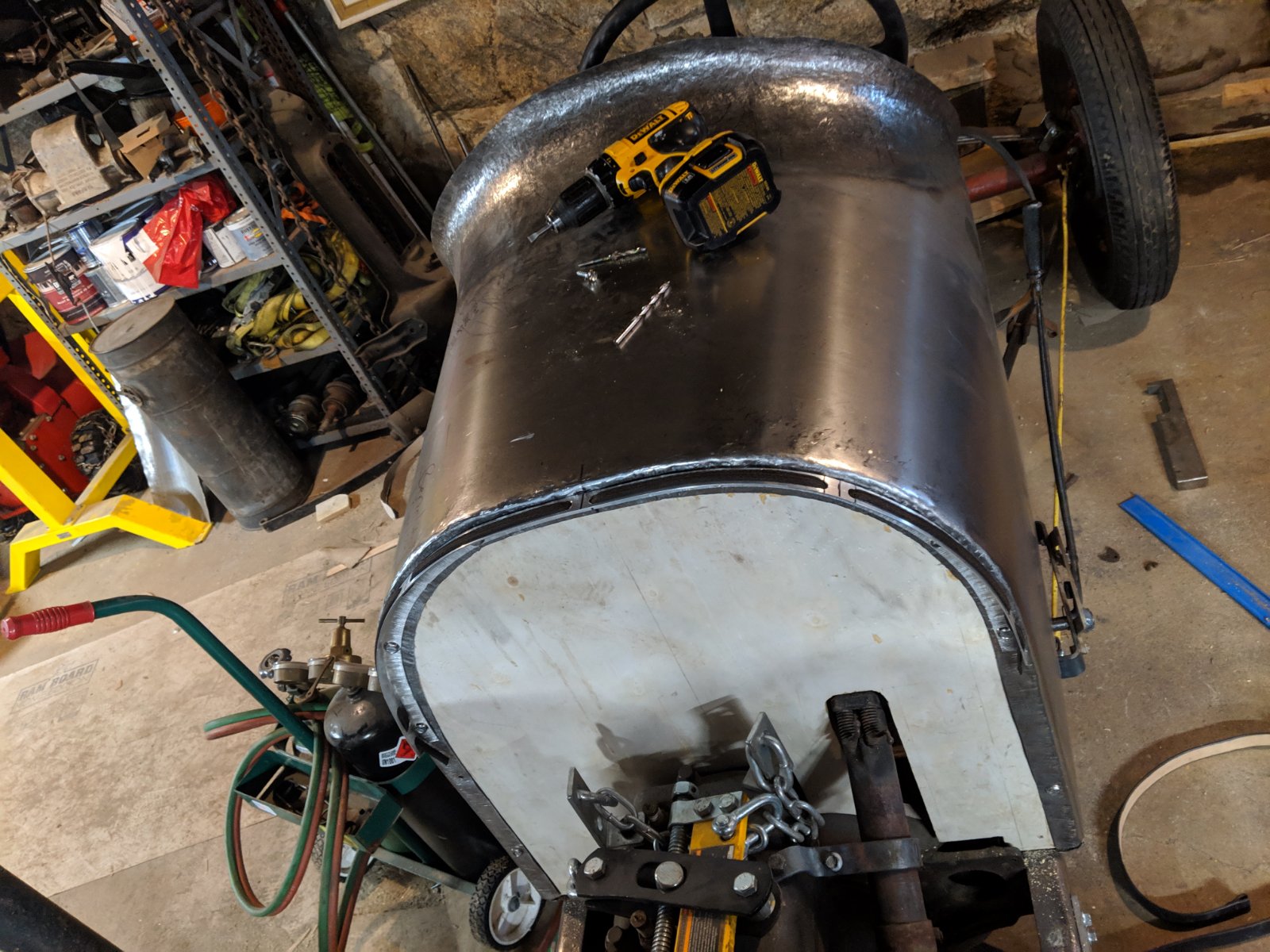

Making a tail finisher panel

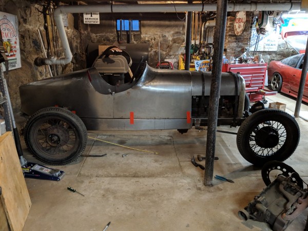

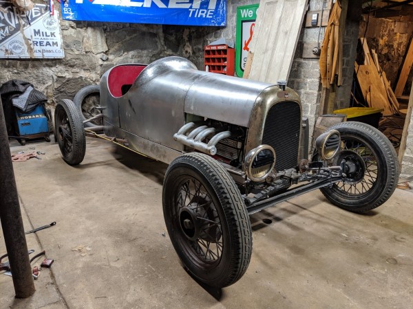

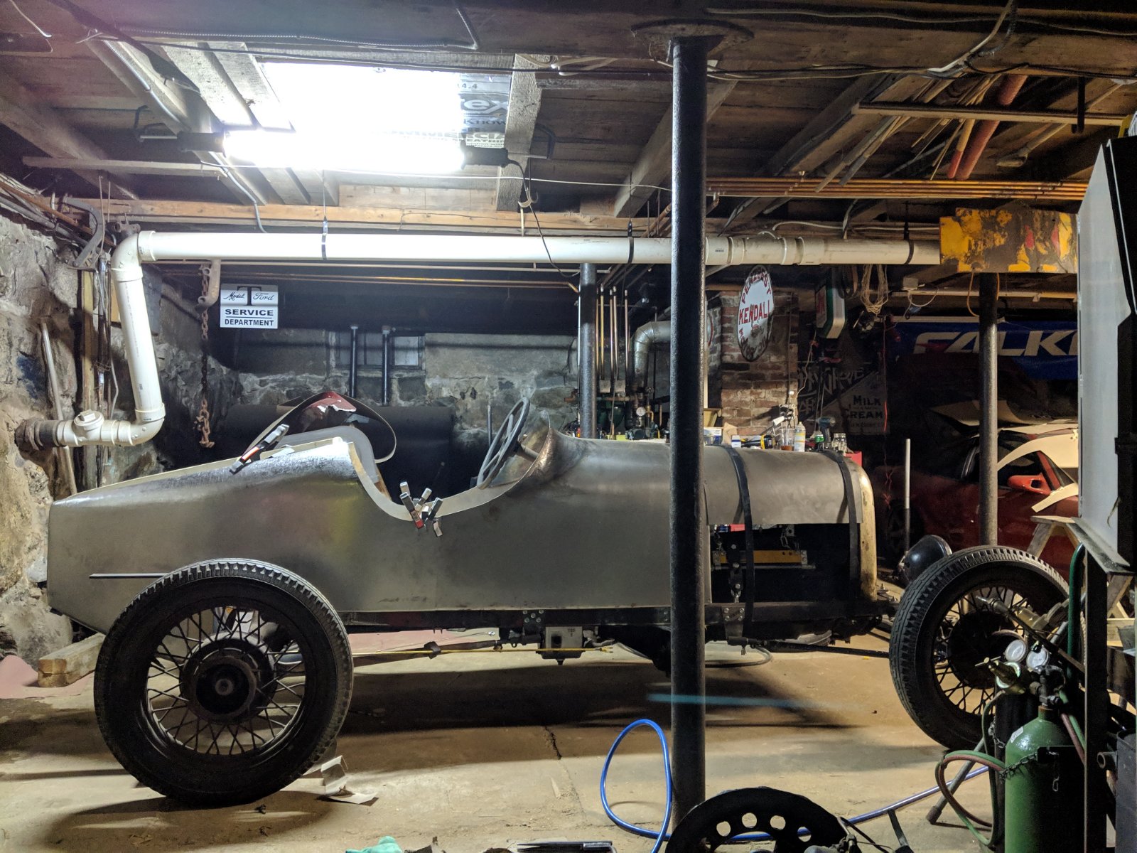

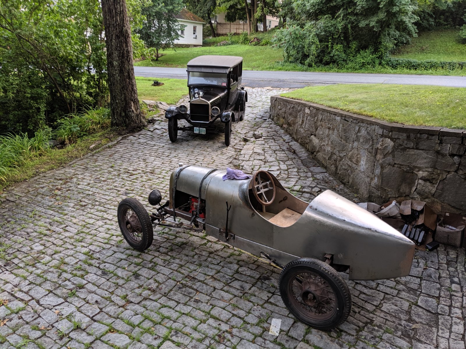

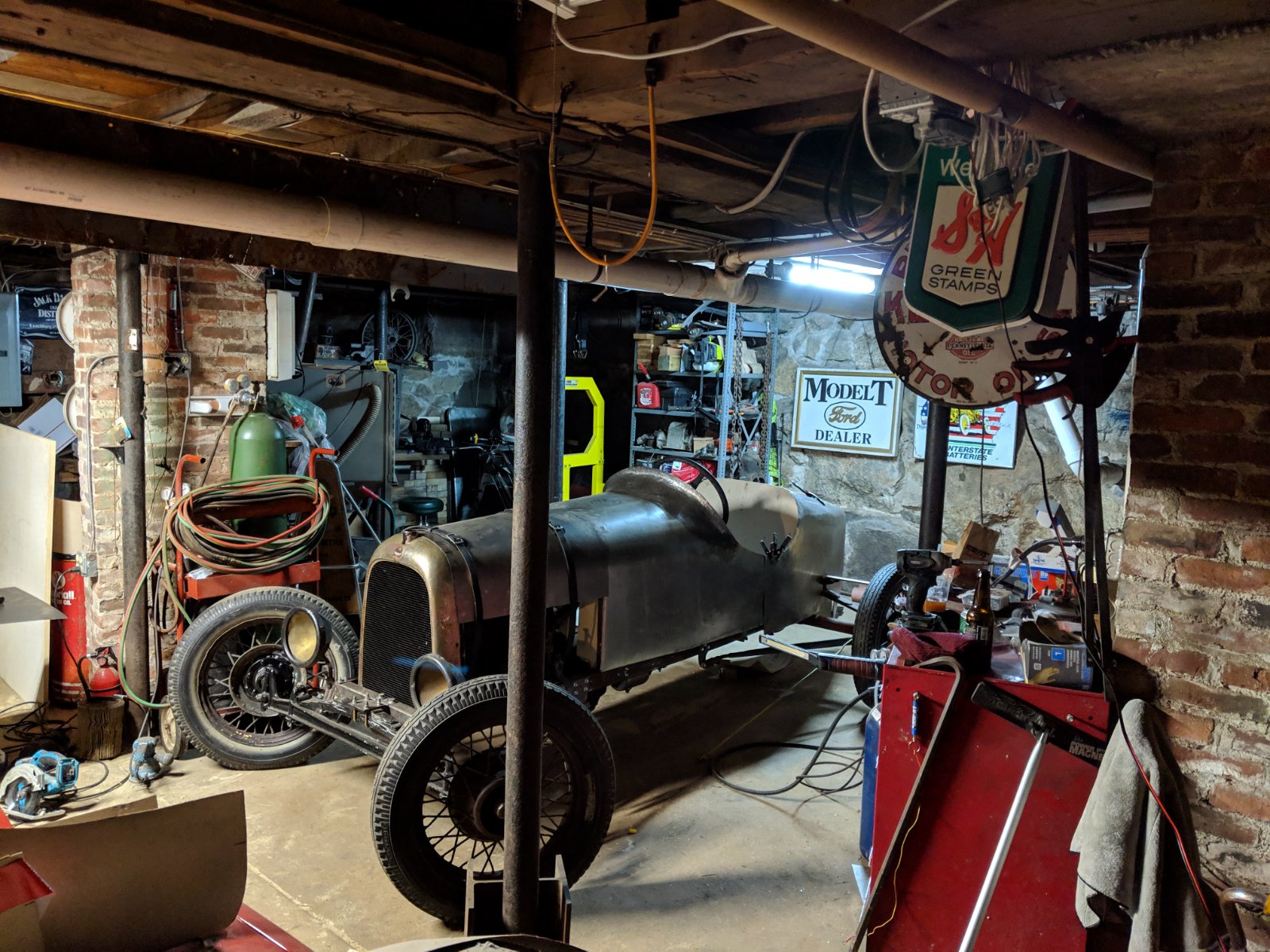

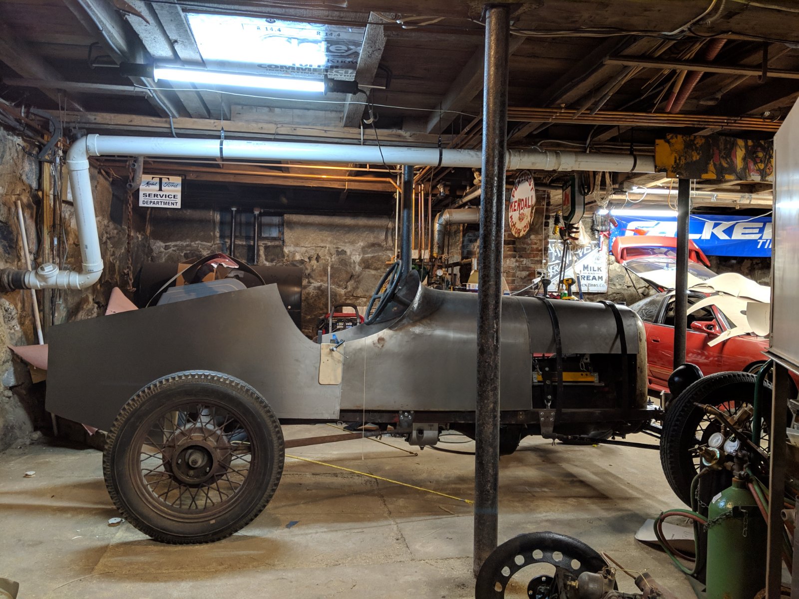

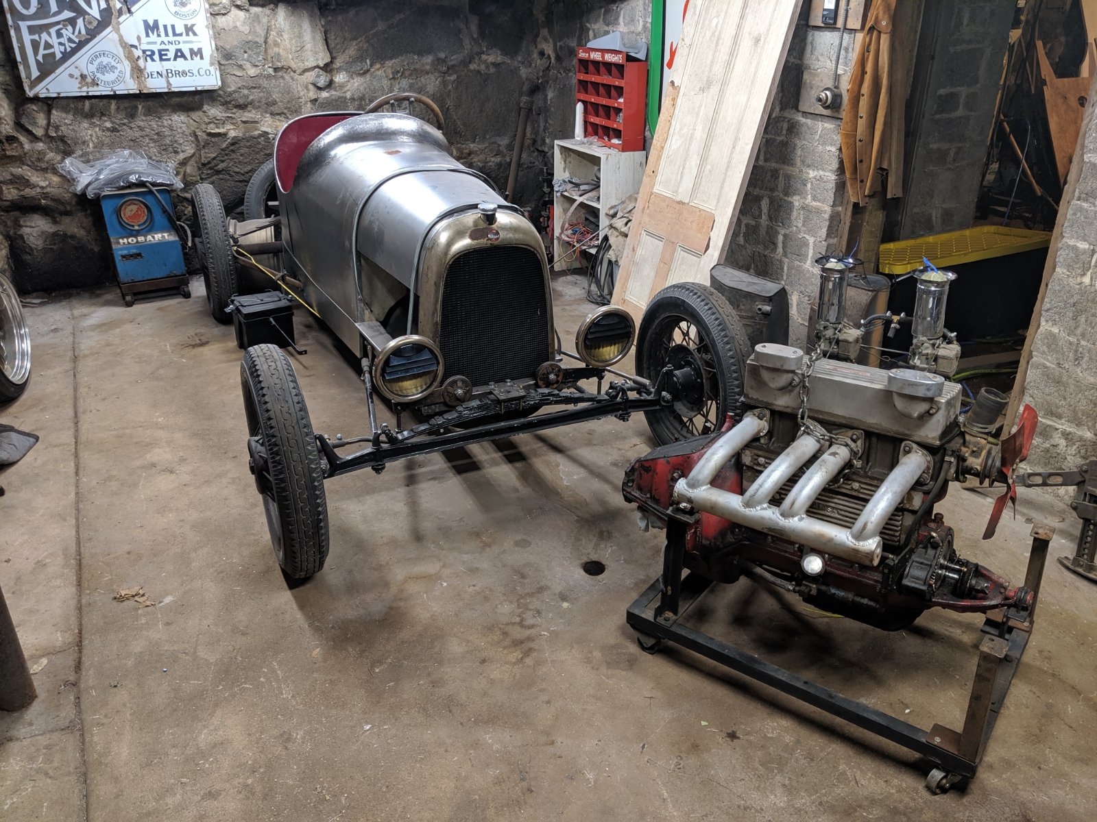

So yeah. That's about 6 months condensed into 2 hours of staring at my phone posting photos. That's about it for now. I hope to keep progress rolling along as well as it has been. Sorry I got less detailed as I posted progress.

THAT is the way a speedster should be built! I have a question though......you weren't clear as to whether using heat on the sheet metal was a mistake or not. Seems to me that heat would definitely be necessary in order to form the panels without distortion. Or did I read that wrong? (probably)

Heat was a big mistake for steel. My initial thought was to anneal but that really only works with aluminum (so I learned afterwards). Being a steel body, all I caused with the heat was a bunch of shrinking, buckling, and warping. Cold forming works much better.

Shane Lach wrote:
Wed Mar 06, 2019 11:21 am
My initial thought was to anneal but that really only works with aluminum...
Heat age-hardens aluminum.

Your build is awesome!!! Very cool field stone basement garage?!! Just asking.

I appreciate the kind words. I always wish there were more build threads, and then realize I'm guilty myself of not sharing my work much as well. I'm going to try to keep up with posting here.
I wish there were more younger guys into stuff like this as well but a lot would rather watch others do things on Instagram and YouTube. I'll keep in touch!

Michael Peternell wrote:
Wed Mar 06, 2019 7:23 pm
You got it! The house was built in 1880. I was told it was an old school which was disassembled and relocated here in Milford, NH. I bought it 3 years ago and love it. It has its quirks and takes maintenance but it's a labor of love.

A picture of the garage from the outside would be appreciated if you could. Guessing it will only add to your build thread.

I going to go out on a limb and guess.... I think that there is no garage. That is probably the basement of his house .... I also love the field stone walls. ... As to the amount of new "young guns" They are out there.... Im hoping the proportion of young car guys is at least the same as years ago.. When I was in high school 1972-1975 there were two guys in my whole school that could be considered "gear heads" me and a guy named Steve ... (not that Steve :) ). And there were maybe a half dozen car guys that liked old cars, hot rods, street machines, ect. But they did very little work on the cars themselves.... That was for me and Steve to do and be considered the "car gods" of Leslie Arkansas . :) :) .. So there was really not that many of the gear heads back then as often though. So it really makes me feel good when someone like Shane is out there carrying on the hobby ...... keep us posted on any progress ....

Speaking of smells, the past few days I have been applying resin to seal the wood of the tail. She wasn't quite the happiest :lol:

dobro1956 wrote:
Wed Mar 06, 2019 9:01 pm

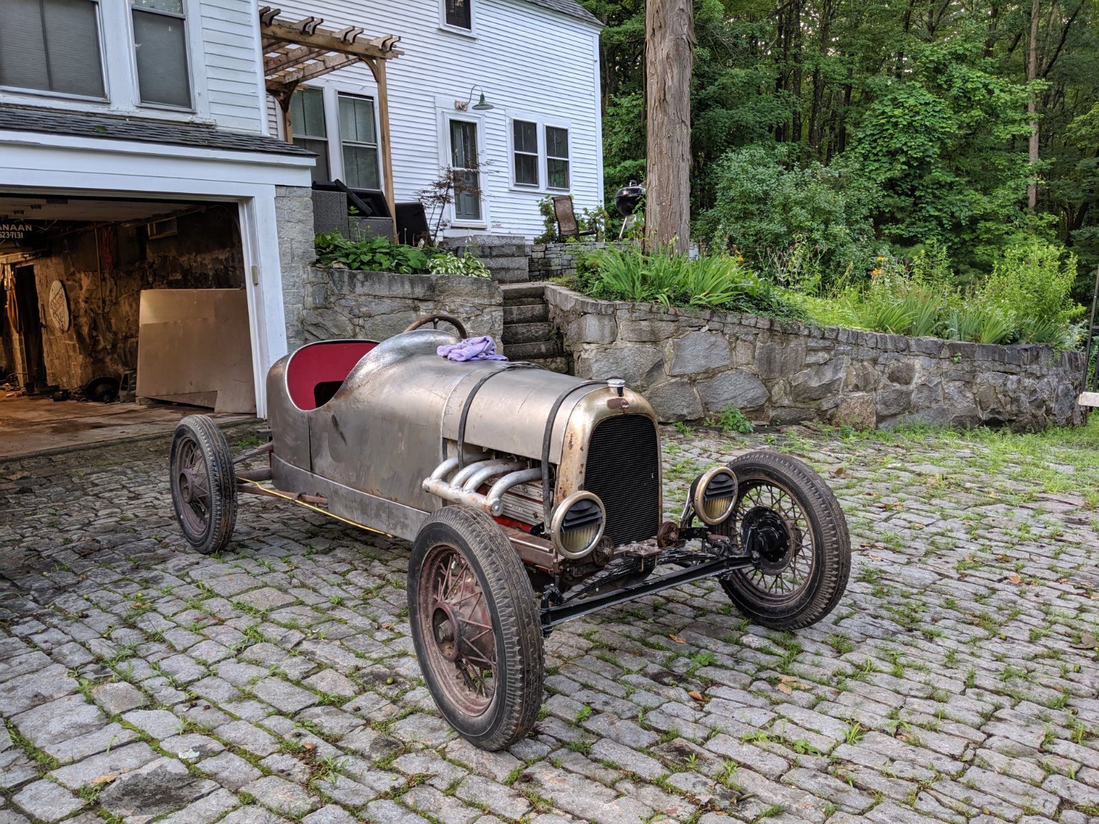

I don't have many photos of the house on this phone due to getting it this winter but yes. The garage is under the main portion of the house. I do have a photo of when I was doing some tree removal as everything was overgrown and growing against the house.
Here's the garage on the other side of the house and my 27 Tudor I went through last year.

So lately I have taken the tail apart for sealing and paint on the wood, and doing some finishing work on the hood. I am sealing the wood with fiberglass resin. The wood seems to soak the first coat up, then the second coat adds a nice protective layer.
Here is most of the panels while drying. They're currently drying after being primed. I used Rust-Oleum boat primer for fiberglass.
Here's the rear edge of the hood to give you an example of how it was before. I've been wire rolling the edges of the hood with 3/16 rod. I've been using a hammer and dolly to bend the edge to 90*, then using my shrinker to get the shape right. I then use a piece of thick flat stock backed by a dolly against the 90* to make it 180*. I then clamp the round bar in after pre shaping it to the panel. Just tap the 180 all the way around the bar a little at a time to get a nice rolled edge.
Partly rolled.
Front edge fit up to the shell sitting decent.
Rear edge rolled and fit nicely. This is just sitting against the firewall. I need to shape up a hood shelf and lace it. A project for another day right?

Post by Shane Lach » Wed Mar 13, 2019 9:32 pm
This shows the whole panel. Eventually all sides of the panel we're completely wire rolled. It added a lot of strength and is nicer to grab onto when removing than just sharp unfinished edges.

Post by Shane Lach » Sun Mar 17, 2019 4:51 pm
This weekend I worked on making a hood former for the firewall and fitting the hood nicely. I made it out of angle aluminum in the shrinker very little at a time. I found the stretcher tears the aluminum. That sucked when I ruined my first one.
I shaped it then drilled some holes to lace it up like a radiator shell.
Shane Lach
Posts: 246
First Name: Shane
Last Name: Lach
Here she is all test fit.

Post by Shane Lach » Mon Mar 18, 2019 7:45 pm
Not much but I was sitting on the couch contemplating going to the hardware store to buy steel rod for a radiator support. I decided to go downstairs and see what I had already. I found an old brake rod and thought it might work. After smashing it flat and a little grinding it fit into the Whippet shell perfectly. I just have to thread it and add nuts and washers.

Post by Shane Lach » Wed Mar 20, 2019 6:42 pm
Today I made a hood shelf! Well I made one yesterday but it was an inch too short :roll: .

Post by Shane Lach » Sun Mar 31, 2019 7:26 pm
This week I dug into the side skirts. I built a couple, didn't like the first design, and really enjoy the second.
Here she is with no side skirting.
Round one ended up too blocky for my liking. They didn't flow well with the natural taper off the car. They also sat lower at the front due to the rake.
This one I'm much happier with. The 1.5" taper rear to front really fits the body much better.
I made some measurements and cut out a couple pieces of wood. I then set the skirt between them and left the metal 1/2" proud. Next I shaped the metal to the wood form. I'll take a couple photos of that process on the next side.

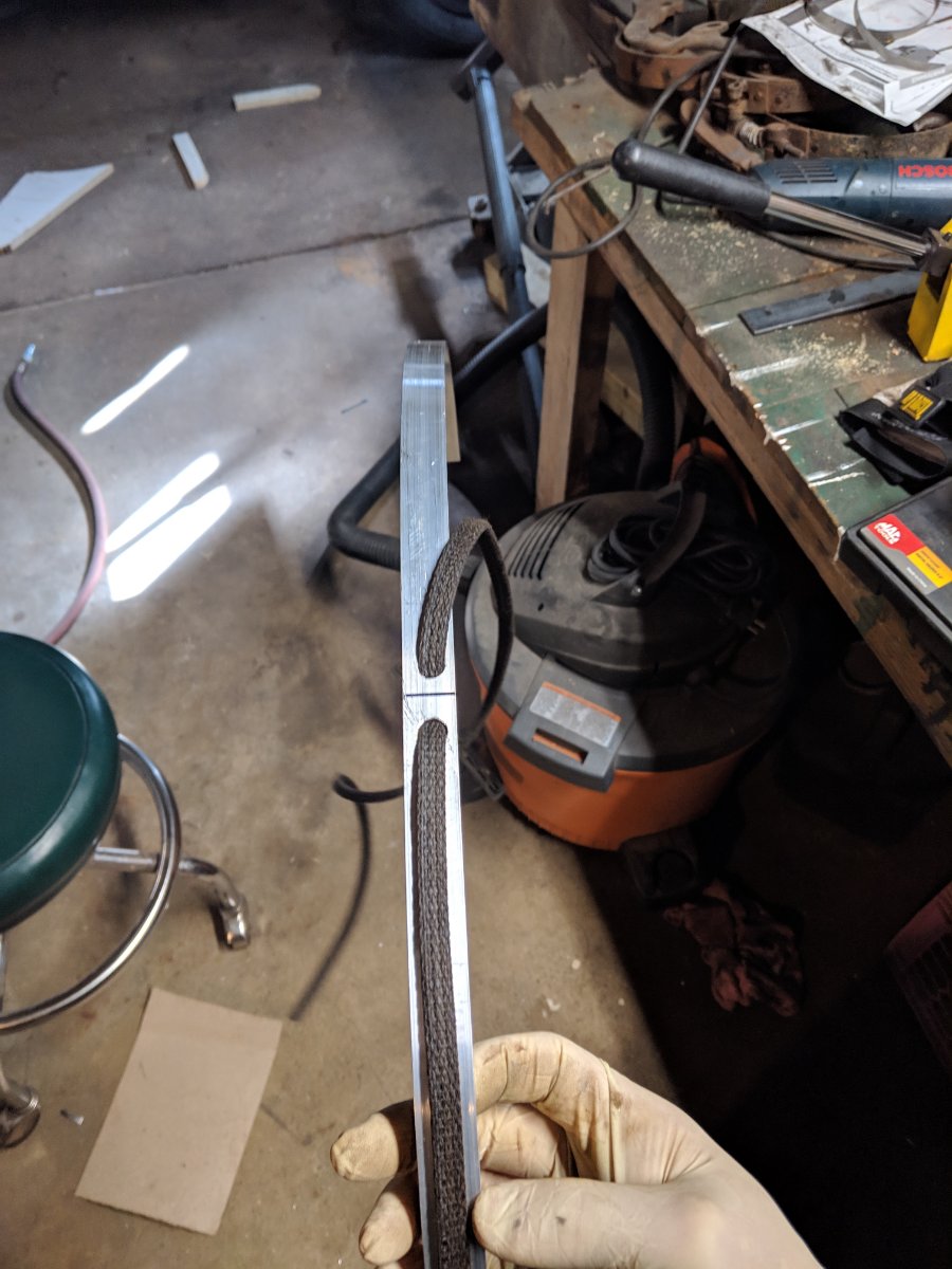

Post by Shane Lach » Wed Apr 03, 2019 6:45 pm
Moving on to the other side, I faced new challenges. I had moved the parking brake handle outboard and had to work the skirt around it. I did so by making some wooden templates to form the metal around. I'm pretty close to done making panels and it's almost time to move on to the fine tuning of them. It's exciting to see a car where once there was a pile of scrap parts I pulled out of someone's yard.
Skirt cut out and all measurements mapped out.
Folded the edges and began making the hand brake cut outs. I left the metal a half inch proud and folded it around these forms

Shane, I haven't been on here much lately, but GREAT JOB!
I had to chuckle at a couple of things you did, because the are in similar fashion to what I am doing:
Modified T frame, Model A steering, a happy accident that it came up through the same hole in the firewall. My column will be shortened though. I am also using an A front axle complete, but used Model T spring and perches. Some mods will follow as I may add front brakes. I have the parts to do a '28 Chevy overhead on a T block.

Chad, you may want to keep an eye on your steering mount where you welded it to the frame. that will be a prime place for cracks to develope from the frame twisting. Myself, I would have bolted it on. Nice job on building it though. JMHO Dave
1925 mostly original coupe.

d stroud wrote:
Thu Apr 04, 2019 1:24 am
Yes, I may even (probably will) box that part of the frame to help that issue. I had the front half of a A frame I was considering splicing in at one point, but those rails were riddled with cracks on both rails--especially all in front of the steering box mount. I choose not to bolt it in because these cars have enough steering slop everywhere else, and I wanted to raise it some to try and gain back some geometry lost during the lowering of the front axle....hopefully it all steers ok in the end. I also chose to flip and further bend the pitman arm to try and correct some of the steering rod angle, as well as shorten it 1" like the aftermarket ones that are offered--again, mostly to gain back some geometry lost in the front end lowering. The mount itself is 3/16 plate that goes right to the bottom of the frame rail and fully welded in every possible spot front and back. And if I remember right, the steering box to front axle distance is only 2" shorter than a stock A, but the T frame is a little narrower.
Sorry for the Hi-jack of your post Shane.

Chad,
David is correct on your welding there. Not getting in anyone’s business, just concerned about safety (yours and others). You could install a piece of channel under the frame by means of bolting. Just trying to help. And your project is looking Great!
Shane,
Sorry for my highjack too. Just trying too assist you younger fellas!

NO, NO, NO, Chad, DO NOT box the frame!!! I have posted this many times on here. When the frame is boxed in a short section as you mentioned, that makes it into a rectangular tubing basically which will not flex as the original frame will when in a twist. That will cause cracks to develope at the ends of the boxed area, I've seen it happen many, many times in the last 40 years or so. It is a common misconception that a frame needs to be boxed when spliced, all that is needed is to put a channel (frame channel, not channel iron) inside as Henry said. Make it a snug fit and a few inches longer on each end so the stress is spread out over a wide area and definately bolt it in. Anything that is mounted on frame rails should be bolted or riveted, that allows for some "give". It's a bit late now, but you would have been better off bolting the bracket to the frame. Not trying to rain on your parade, just trying to point out possible(probable) problems down the road. Dave

Chad with total respect, we have walk down the paths of failure and do not wish this on anyone.
All the Best,

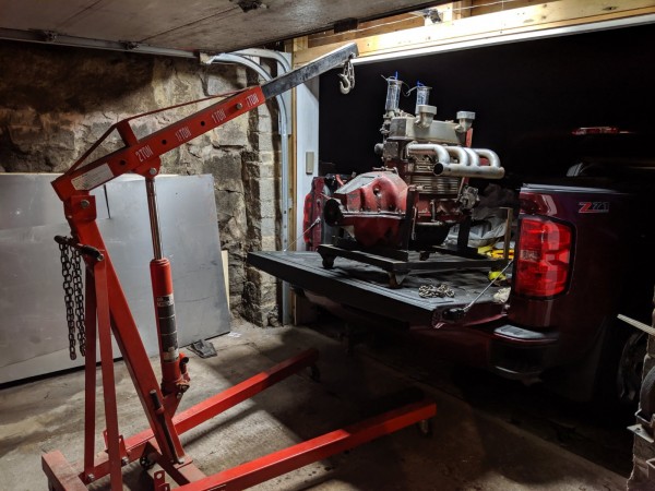

Post by Shane Lach » Wed Jul 10, 2019 9:36 am
Alright guys. It's been a while but I'm back on track. With spring hitting I had a lot of household chores to focus on, as well as my wife is pregnant so a lot of my time has been consumed with other priorities. I've been making it a point to put in an hour or two a day again.
A while back I purchased a wallowed out Neville steering wheel. I needed an adapter made to fit my model a steering column and reached out to Hank. He explained that he was proud of the work I was putting forth and this was my reward. He managed to mill the hub face and create a collar to insert in the wheel. I appreciate all the help he has given me.
After this, I began working on wire edging the circumference of the cockpit. I used 5/16" steel rod. I welded a piece of rod to the end of vise grips, and a plate to the other jaw. I gradually clamped and rolled the edge until I formed a 180* pocket. Then I formed the rod to sit in the pocket, clamped it, and hammer/dollied the sheet metal over the rod.
Last month I traveled from New Hampshire to Nebraska for the speedster reunion to execute a long planned transaction with my friend Rob. We had been talking and worked out a deal on a special engine he had and wanted to sell me. He drove from California and we met in the middle of the country.
Here's a photo of the gang. Rob, his father, Bob Middleton, my wife and I. These guys were great and it was cool to meet after months of phone calls and mentoring.
Here she is. This is Rob and I after we dragged the powerplant to my truck bed after a combined 3,000 miles of driving. I'm honored to own this piece of automotive history and happy to give it a new home.

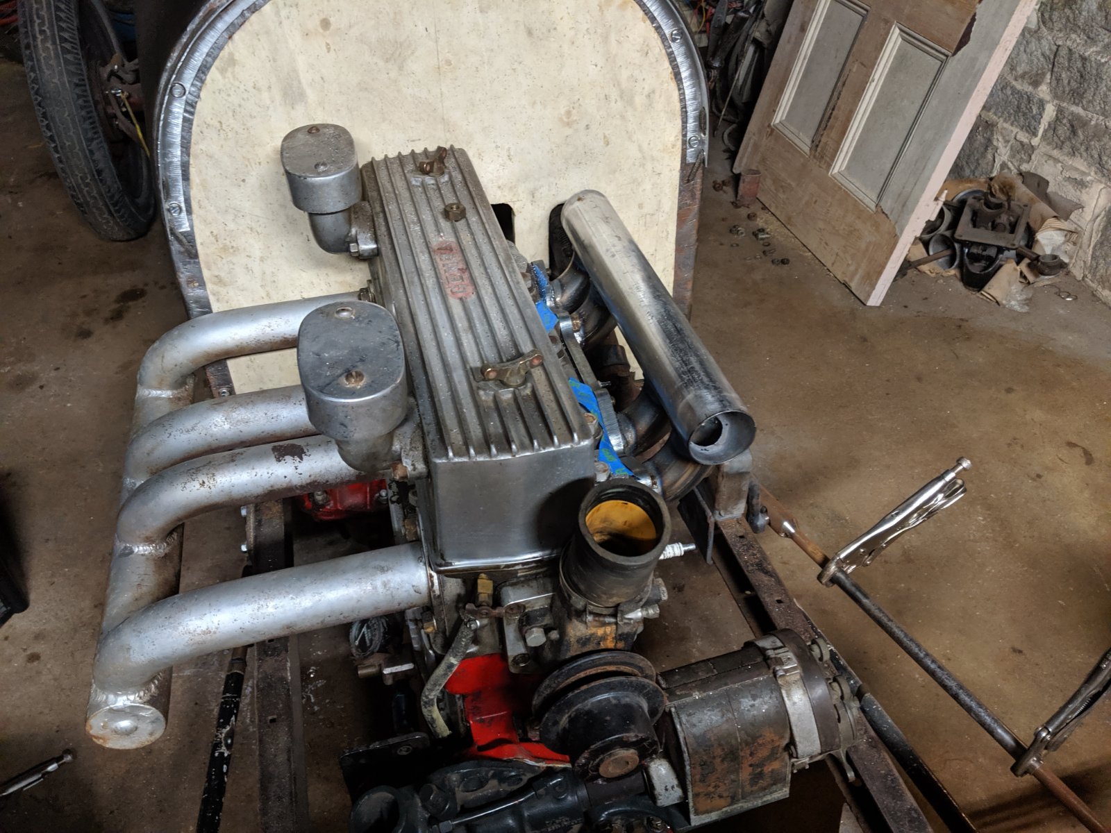

Post by Shane Lach » Wed Jul 10, 2019 10:01 am

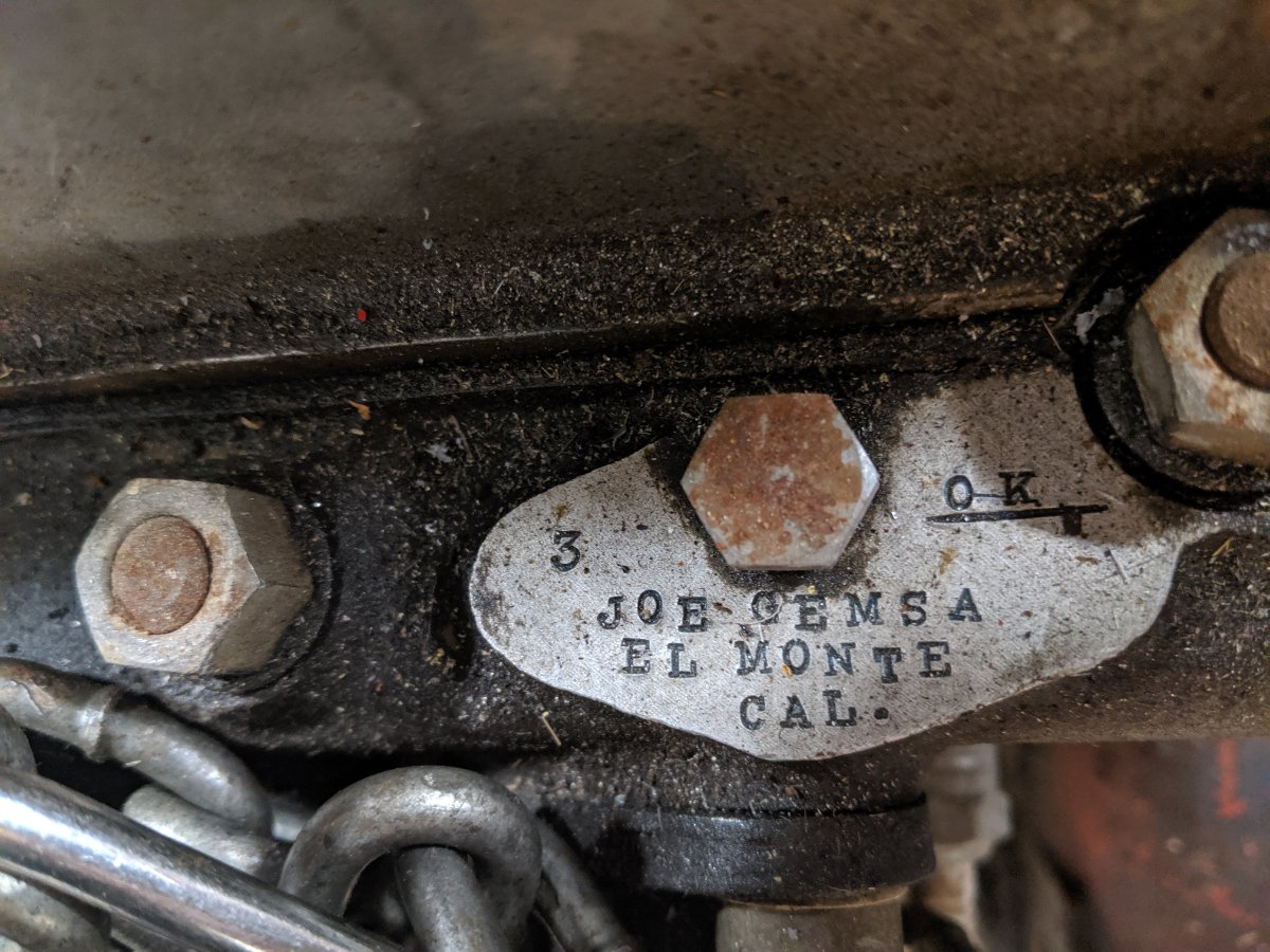

Onto the details. The engine is a model t block, Gemsa 9:1 cross flow head, model a crankshaft, pressure fed oil system, dual downdraft strombergs, etc. I'll change a couple things here and there but the goal is to get it fit and running mocked up. I will be installing a splitdorf crossdrive mag setup on the front as well.
I found some sweet old louvers for model t headlights you can see above also. Couldn't pass those up.

Post by Shane Lach » Tue Sep 10, 2019 5:32 pm

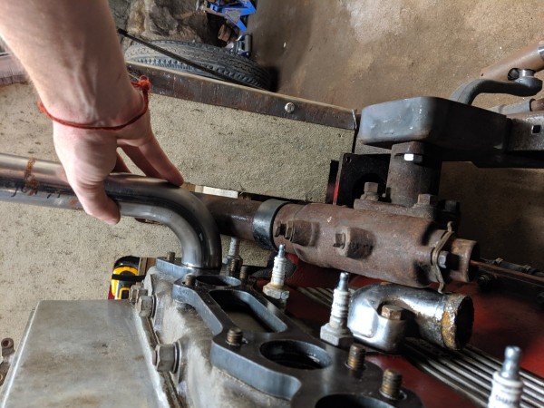

So as of recently, progress has dialed back a bit due to my wife and I having our first baby! But I've been sneaking in some work here and there. I'll share some photos.
I rolled the car outside for the first time ever a month or so ago to get the juices flowing again.
So back to the engine. The intake manifold that came with the engine came straight out of the head and contacted the steering column. Therefore I had make one which entered the head at 90*. I purchased a flange from Rob and got to work.

I then began working on the fuel system. The gentleman who builds the reproduction T tanks made me a custom one which is 3" narrower and sits behind the seat nicely. I then got a fuel fill adapter which threads into the tank, a fuel coupling, some t radiator hose clamps, a brass pipe, and a cool old brass flip top filler and created the filler neck. I used a harbor freight hydraulic knock out punch to put a perfectly round hole in the body. I also soldered the filler cap on because the tank will be pressurized.
[attachment=4]IMG_20190814_164531.jpg[/attachment]
[attachment=3]00000PORTRAIT_00000_BURST20190902151226754.jpg[/attachment]
[attachment=2]00000PORTRAIT_00000_BURST20190902151904705.jpg[/attachment]
[attachment=1]IMG_20190902_151627.jpg[/attachment]
I then began running fuel line from front to back. I purchased a repop sediment bulb and installed that. I modified it by drilling it to accept a 5/16 fuel hardline to supply the dual downdraft carbs. The line material I used is Cunifer which is a copper nickel hybrid material. It had the old look but is more resistant to cracking/hardening. There is a short length of rubber fuel line between the tank and frame, frame and engine. That should relieve strain on any hardlines.
[attachment=0]00000PORTRAIT_00000_BURST20190908153306682.jpg[/attachment]
Shane Lach
Posts: 246
First Name: Shane
Last Name: Lach
Post by Shane Lach » Tue Sep 10, 2019 6:34 pm

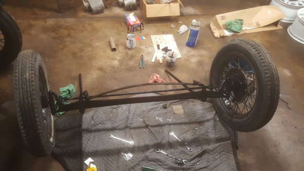

Here's the fuel line photos.
I also found time to make some plug wires for my high tension magneto!
I have to send this out and have it serviced/rebuilt but I'm out of cash for a while. Next up is running an air line from the dash mounted fuel pressure pump to the filler neck. That way I can push the fuel to the carbs. Once these things are complete, I should be able to start this thing. Much thanks to Hank for the starter and generator which will be added in my next post.
