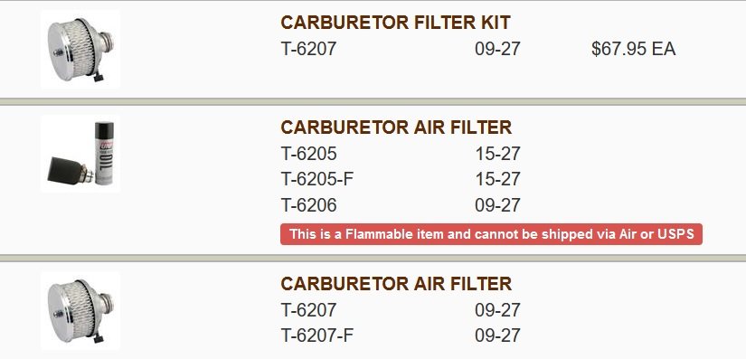

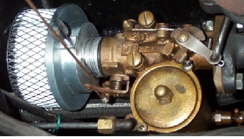

Will any of the currently available from vendors, air filters fit a Stromberg OF-!?
- Posts: 6573
Re: air filter
Searched MTFCA and found this post http://www.mtfca.com/discus/messages/17 ... 1298811126ModelTWoods wrote: ↑Fri Mar 19, 2021 12:31 amWill any of the currently available from vendors, air filters fit a Stromberg OF-!?
By Michael Pawelek on Wednesday, February 23, 2011 - 08:56 am:
I bought this set up from Snyder's a few years back and it works perfectly. I drive a lot of dusty back roads with my '19 and for the huge expense of having the engine rebuilt would never consider running any engine without an air filter. With the Stromberg OF carburetor and "Z" head this engine purrs at idle to 45 mph. Snyders listed lots of styles Model T & Model A https://www.snydersantiqueauto.com/Sear ... r%20filter
Would guess that this is readily available from other sources like autparts stores
