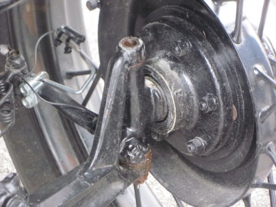

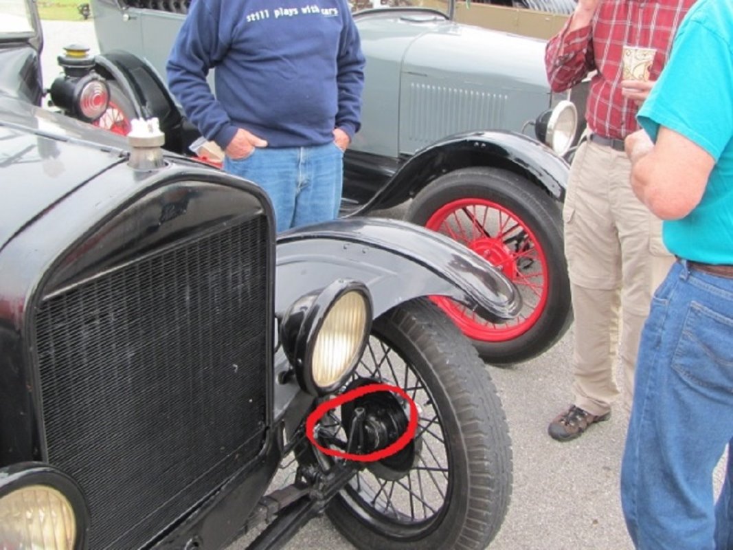

On a recent tour I parked next to this T that had adapters made to fit wire wheels to wood hubs, as I was casually looking over it,
spied this event.
Told the owner, and he and friend got fast on the repair.

Dan, I reckon I'm a little blind, not sure exactly what the photo shows. An explanation of what we're looking at would be helpful. And, good on you for helping out !! We are our brothers' keepers !

Sheared spindle bolt.

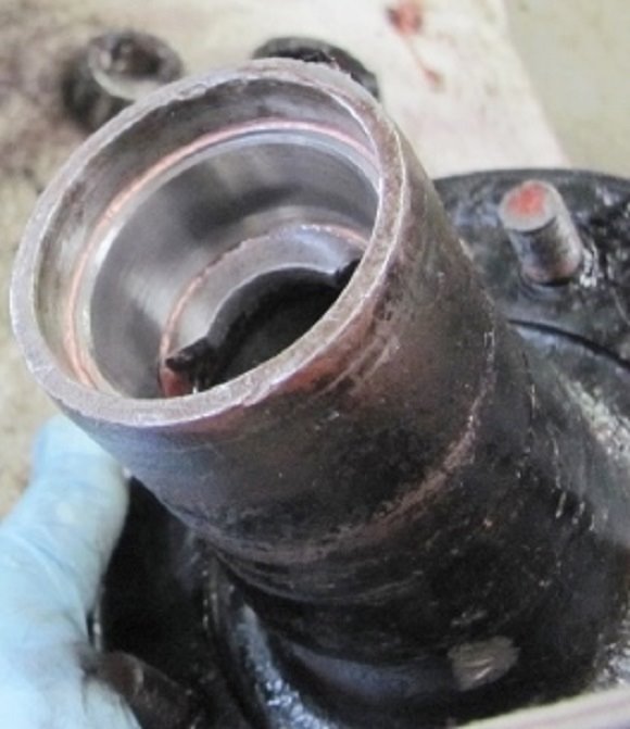

Yes, that was a sheared off spindle bolt, the upper part was gone. The spindle body held by just the lower part of the bolt.
Fix was to reverse twist out that threaded end, quite a chore, but success. Trip to auto parts store found a long shaft better grade bolt to make tour repair until new king pin bolt was replaced.
Cause unknown. Could have been worn out and cracked kingpin, or loose bushing, or maybe? extra stress? on the spindle from the adapter plate used for mounting Model A wires, there isn't the outer hub support like that given by the design of the long nose Model T wire wheel front hub, fitting sung to the taper "Dixie" cup outer of the Model T wire wheel.

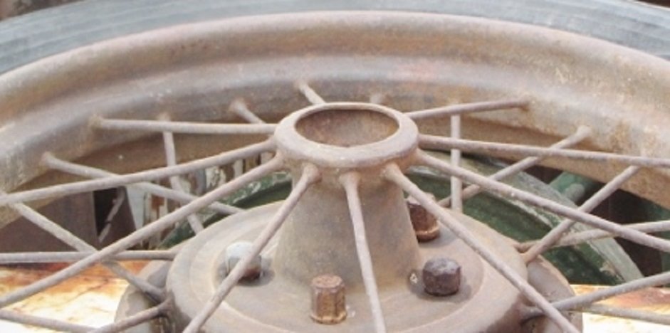

I couldn't see enough detail on the original post either until I 'clicked' on the photo and got a blown up view. Could then clearly see the top of the king pin was missing. Didn't know about clicking on the photo for a blow up until I did it by accident. Maybe others didn't know either.
