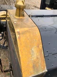

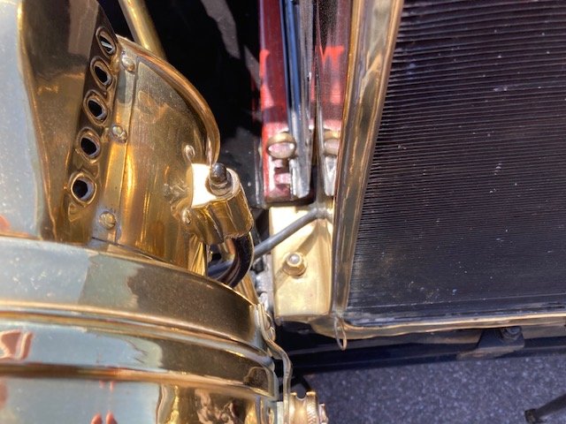

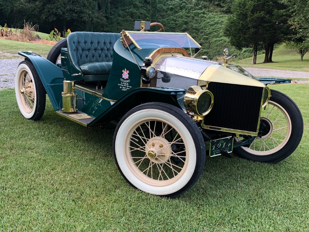

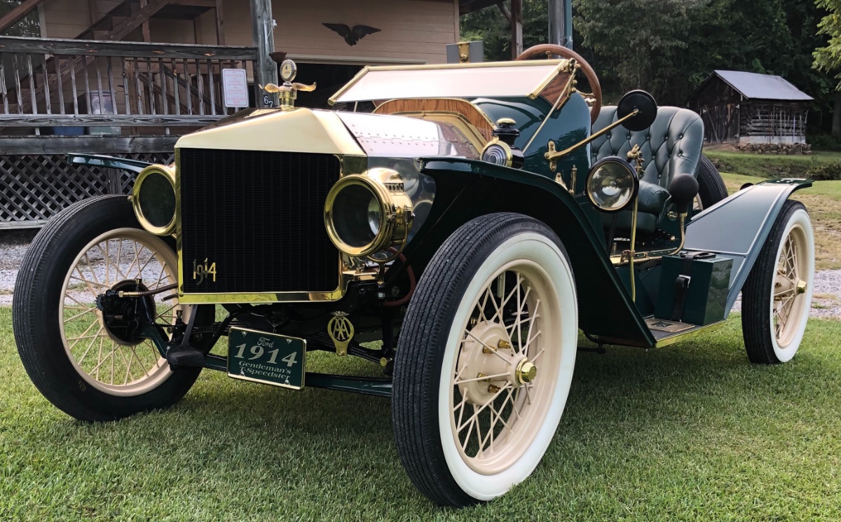

At Chickasha I made several brass acquisitions for Hay Wagon to speedster project. These are pictures of the very brass T at Chickasha. That is a lot of brass. So how does one keep all that brass shiny? Does it tarnish? How do you get into the tight spaces to keep it shining? How often does re-polishing have to be done?

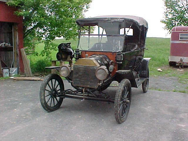

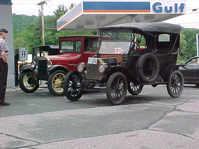

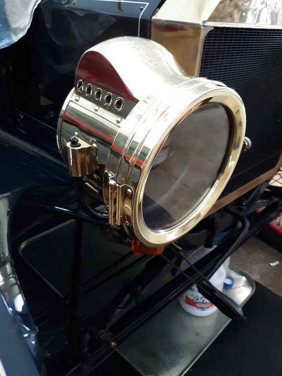

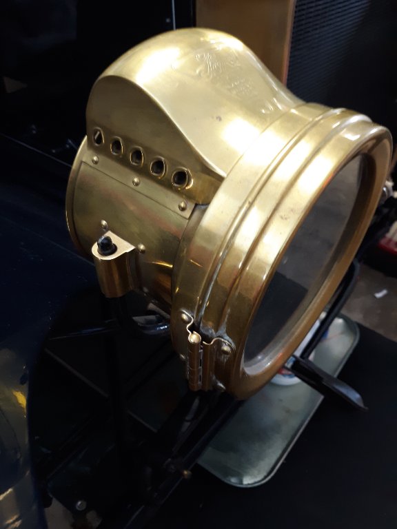

Ha ha Bill! Welllll....maybe. I DO have that stupid horn looking pretty good...now if I can only get it to HONK!! LOL
Ignacio...I've use Blue Magic most of my "brass tenure". I've tried the NeverDull that Jonah mentioned and it was crap.
I've tried other stuff, keep going back to Blue Magic.
Advice...do NOT coat the brass. Even the best of a coating will eventually "breathe" in oxygen, and that's why tarnishes.
Once that happens, you'll regret it as you will have a mess on your hands.
I will try a coupla "before and after pics" here...I gotta re-size them, as this site always rejects them due to some pixel issue. Ugg.
I see I don't have any of that stupid horn! It really did turn out nice! Maybe some other day.

So far Blue Magic is the winner. I tried it versus Nevr Dull. Blue Magic was much faster. Blue Magic has a strong ammonia odor so I wonder if that is what does it?

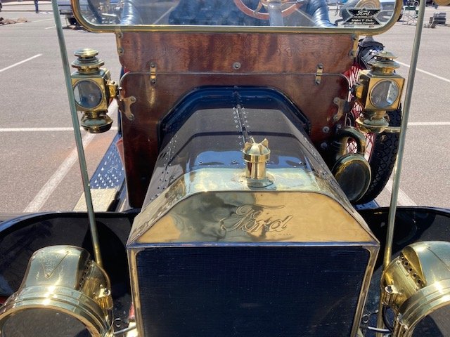

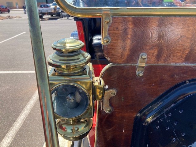

Ammonia ? Yup. I'm quite sure it is effective in dissolving tarnish. Brasso (back when it worked) smelled strongly of ammonia, so does Blue Magic, which I also find to be very good. I've noticed bird droppings (also containing ammonia) noticeably remove tarnish when washed off.
There's a certain charm to tarnished brass; I'm about due to make Lizzie "less charming". Polishing brass can be therapeutic - fun for some, not for all ! I enjoy polishing brass, but obviously I'm not exactly "OCD" about it.

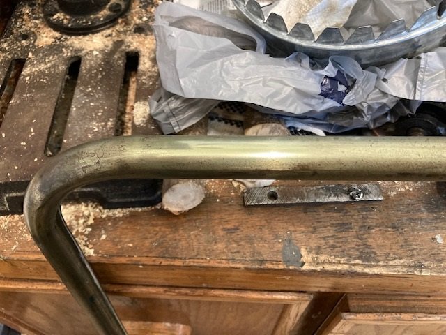

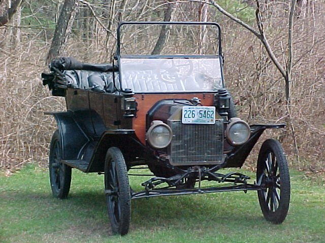

I applaud all of you who invest hours of effort polishing all of that brass, producing sore muscles, cramped hands, and brilliant, glittering, spellbinding radiators, lamps, and all.
I just don't have the time.
As found.
After washing off the dust and pigeon poop.
As found.
