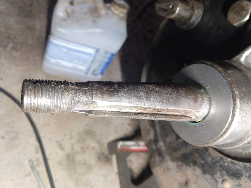

Just wanted to say "Thank you" to all those who made suggestions. Here is a photo of the axle end and keyway. When I took off the wheel, it was very loose and the key fell out. I put in a new inner seal and replaced the wheel bearing and sleeve and noticed that the upper edges of the keyway were raised.
So I used a hammer and metal shaping dolly and dressed down the raised edges. This made the new key fit better, though not a snug fit. So the next thing I'll do is try Locktite quick metal and epoxy in the key. Anybody have any concerns with this. By the way, the axle housing dust cap didn't fit very well; and I had to really hammer it in, which distorted it a bit. Anybody have any similar issues with these dust caps??

The key way is the least of your problems. The threads are shot, too. Those nuts are supposed to take 100ft lbs. Back before torque wrenches, that was tighten until just before they break. If you decide to fix it as you mentioned , make sure your insurance is paid up. In case you need more bad news, from the looks of the axle your hub is probably shot from being pounded by a loose axle. Again, JMHO

Your axle is no good. Your patch will not work. In good conscience I wouldn’t recommend anything but replacement. I hope no one gets hurt when it fails.

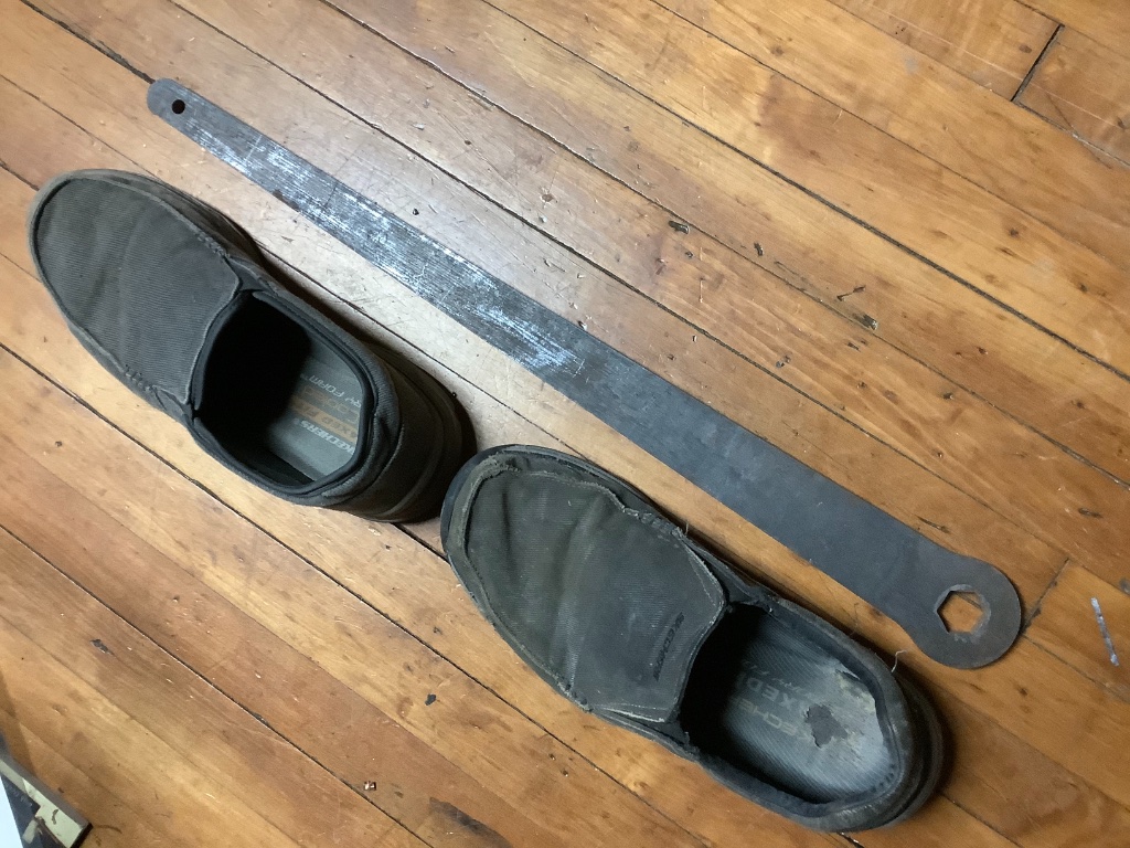

One of my friends, Joe Andulics, made me this copy of the rear axle nut wrench, used back in the day by ford mechanics to tighten that nut. That was their “torque” setting. I’ll bet most those skinny guys back then stood on it. It’s 26”long! If the nut or axle failed, they would get another $5 job out of you to replace it.

I have an original Ford Z tool for that nut - I'll get a photo tomorrow !

NY John: As others have said, you definitely need to replace that axle, just make sure everything else inside the differential/drive train is in good shape and safe. The condition of the axle suggests the rest of the differential may be well-worn too. And if the axle thrust washers are babbitt, make sure you replace them with modern brass ones.

That axle shaft is junk. Your brakes rely on the fit between the axle shafts and wheel hubs. A failure here means no brakes and possibly losing a wheel. Any repair short of replacing the axle shaft is an accident waiting to happen.

There is no magic fairy dust that will make that shaft anything other than dangerous. No glues, pastes, putties, epoxies, shims or center punching of any kind, will adequately replace or repair the streteched and fatigued metal that's still there.
As Tim states, I'm also done here, as I can't state it any more clearly that the axle shown here is junk.

John, the photo is most helpful. Had it come earlier, I would not have suggested Quick Metal as a fix. The damage is down to the wheel being loose on the taper, so the keyway, key and hub will all be worn.
When everything is in order, the key does nothing. The axle is held on the taper and it is this taper which transmits the driving/braking forces, just as it does on taper drills/chucks on a lathe tailstock. The key is there as an insurance policy in case things get loose. The hub should not exert any force on the key, either in braking or under driving. If the taper on the axle and that in the hub are in correct fit, that will be the case. This all depends on the axle nut maintaining that tight fit.
Various products, Quickmetal included, are quite satisfactory in ensuring a correct fit, but they are not meant to be a repair medium for flogged out parts.
