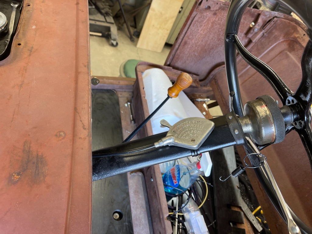

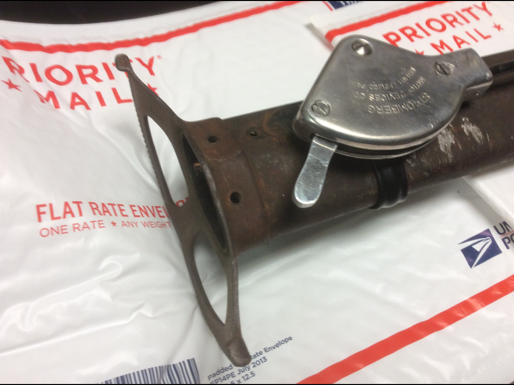

Has anyone mounted one on a 26/27 yet? Column has horn wire channel which is right in the way of clamping it . :cry:

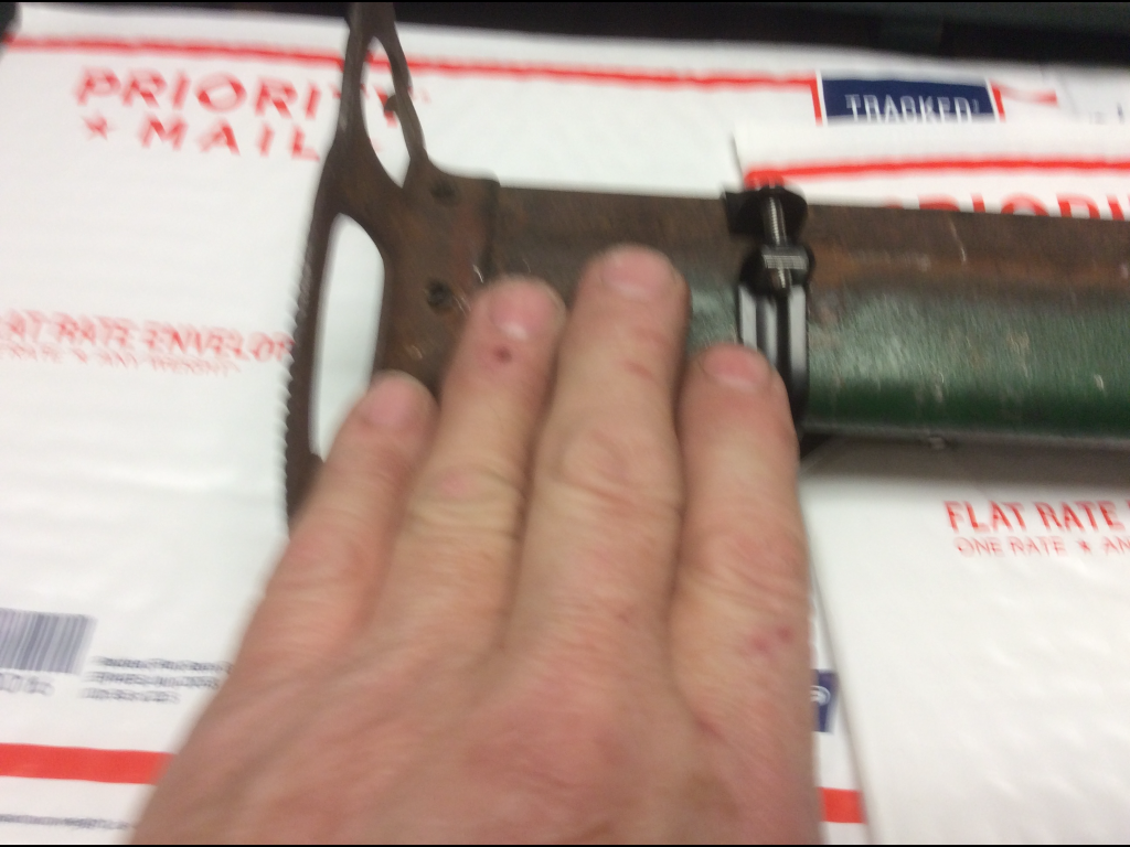

4 or 5 fingers down from the quadrant is about right Danny. I can take a picture of mine, it’s on a 1926

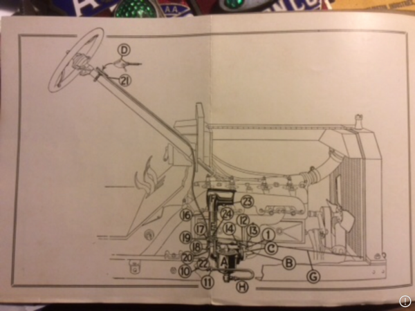

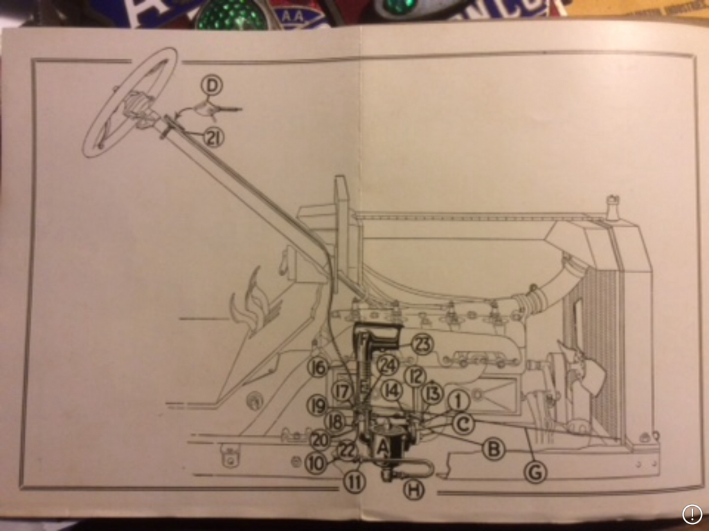

The instructions say about 10” below steering wheel nut

Cool
So right above the horn trough! Gotcha

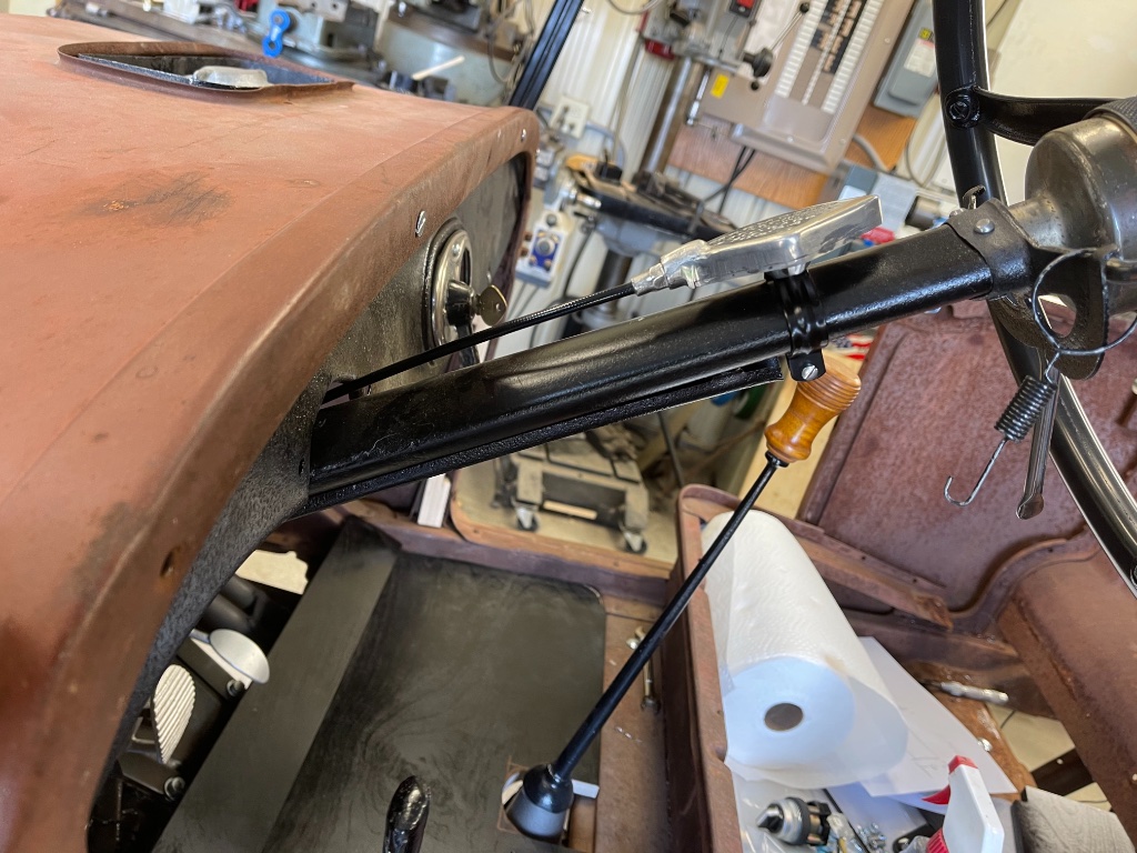

Cable on choke arm 😁
Little things make me happy

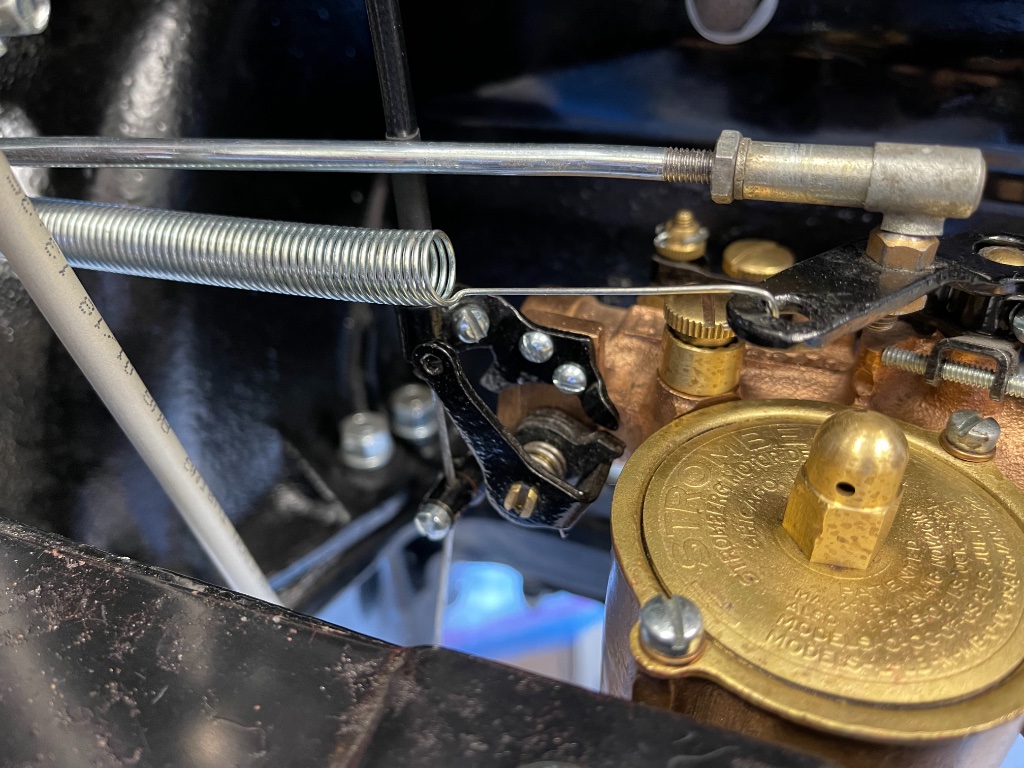

dmdeaton
Posts: 732
First Name: Danny
Last Name: Deaton
Re: Tim’s stromberg choke remake
Post by dmdeaton » Wed Apr 14, 2021 1:27 pm
Thanks Tim
I am liking this a lot, it actually works too!
